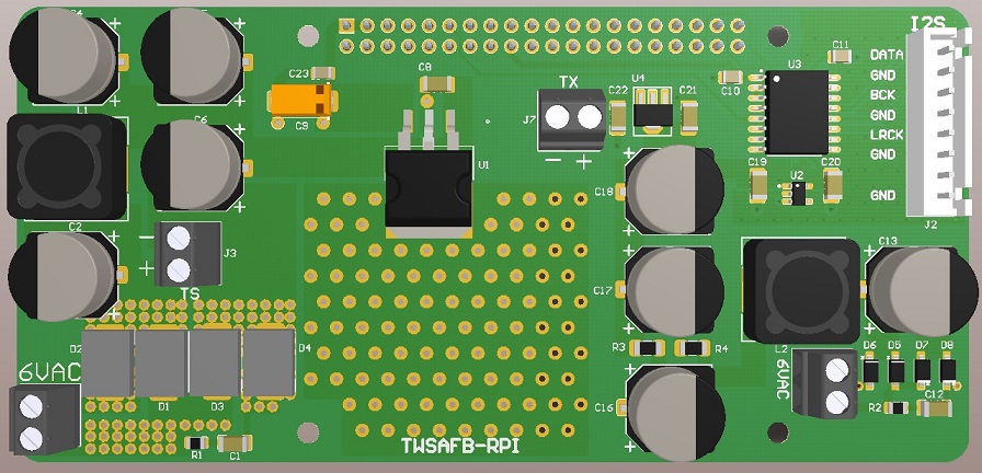

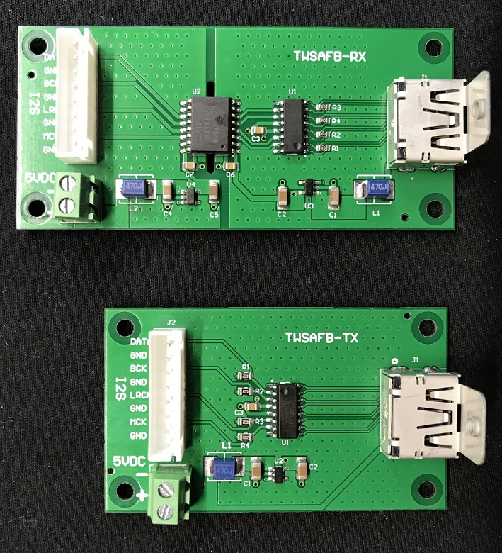

Raspberry PI as standalone source
Since we are planning to implement a Raspberry as a standalone source for our audio system, we have developed a few boards to interface it with our new FIFO.
The source includes the Raspberry PI, the 7" touch screen and an expansion boards to connect a SSD.
The SSD expansion board is stacked under the RPI.
The first board (TWSAFB-RPI) is an interface to the Raspberry and it's stacked onto the RPI. It provides power supply for the RPI and the Touch screen, and also a rail to supply the I2S transmitter. The I2S output is isolated from the Raspberry.

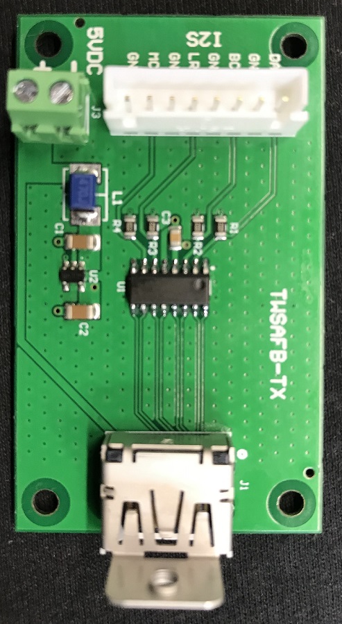

The second board (TWSAFB-TX) is the I2S LVDS transmitter powered by the TWSAFB-RPI.

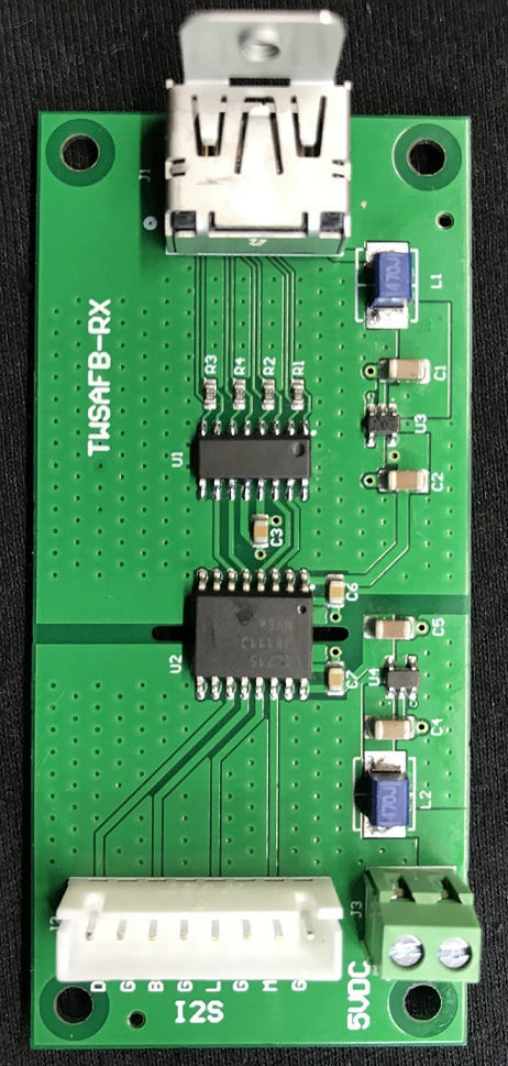

The third board (TWSAFB-RX) is the I2S LVDS receiver to be placed far from the Raspberry and close to the FIFO. Its I2S output is isolated from the trasmitter to avoid any EMI/RFI interference. The input part of the receiver is powered by the transmitter, while the isolated output has to be powered by the FIFO.
An ordinary HDMI cable is used to connect the transmitter to the receiver.
