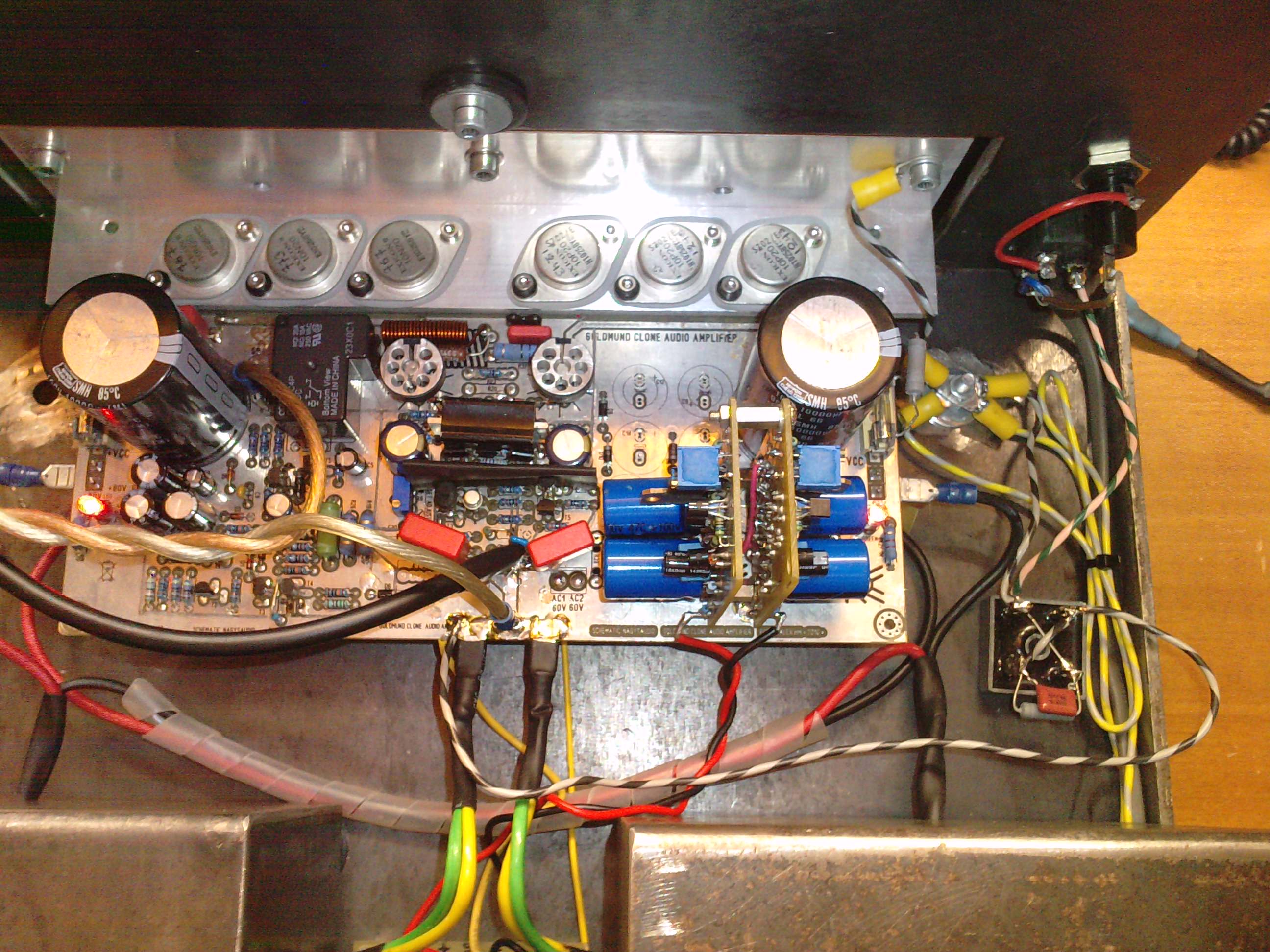

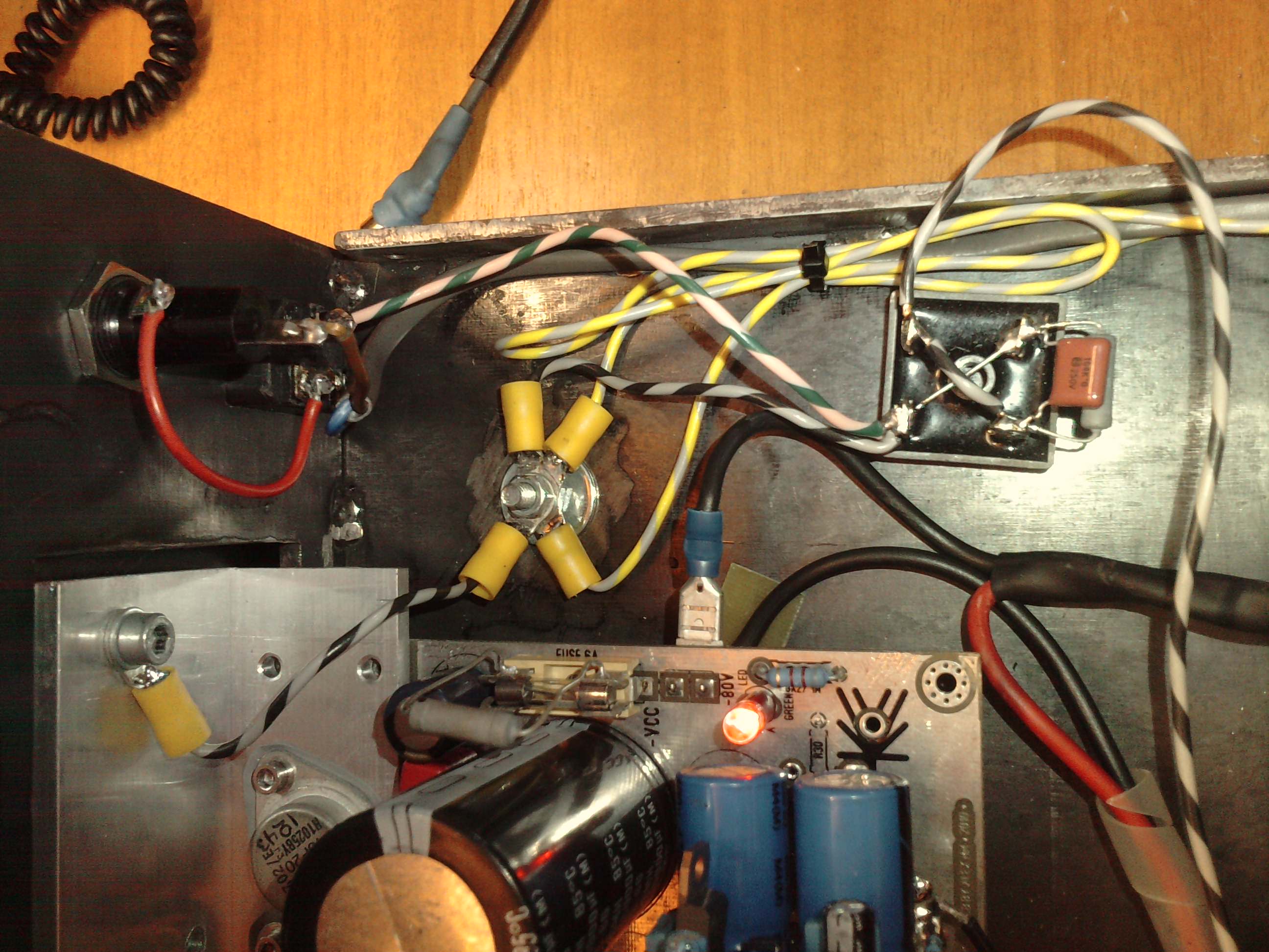

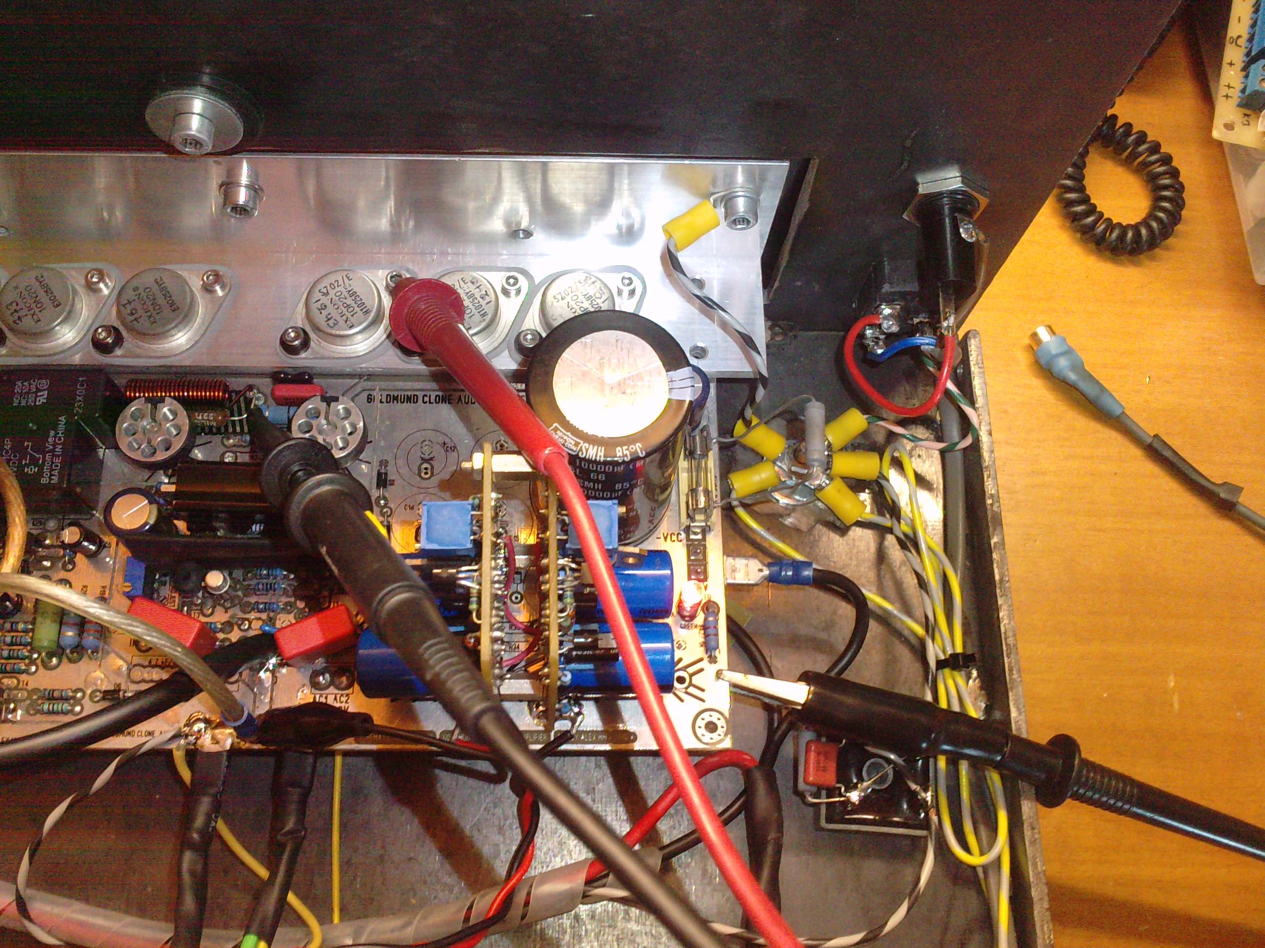

Re: Golmund clone
All the problems are gone ...
The photo shows clear the setup ...
Everyone nows this setup.!!
No voltage ~ between 0 PSU and chassis( ~4mv). No voltage ~ between 0 PSU and L profile.No ringing at all when i connect at L profile with earth GROUND
The sound more neutral clear .
TOMMY1000 thanks for your clear position .
Regards Nikos

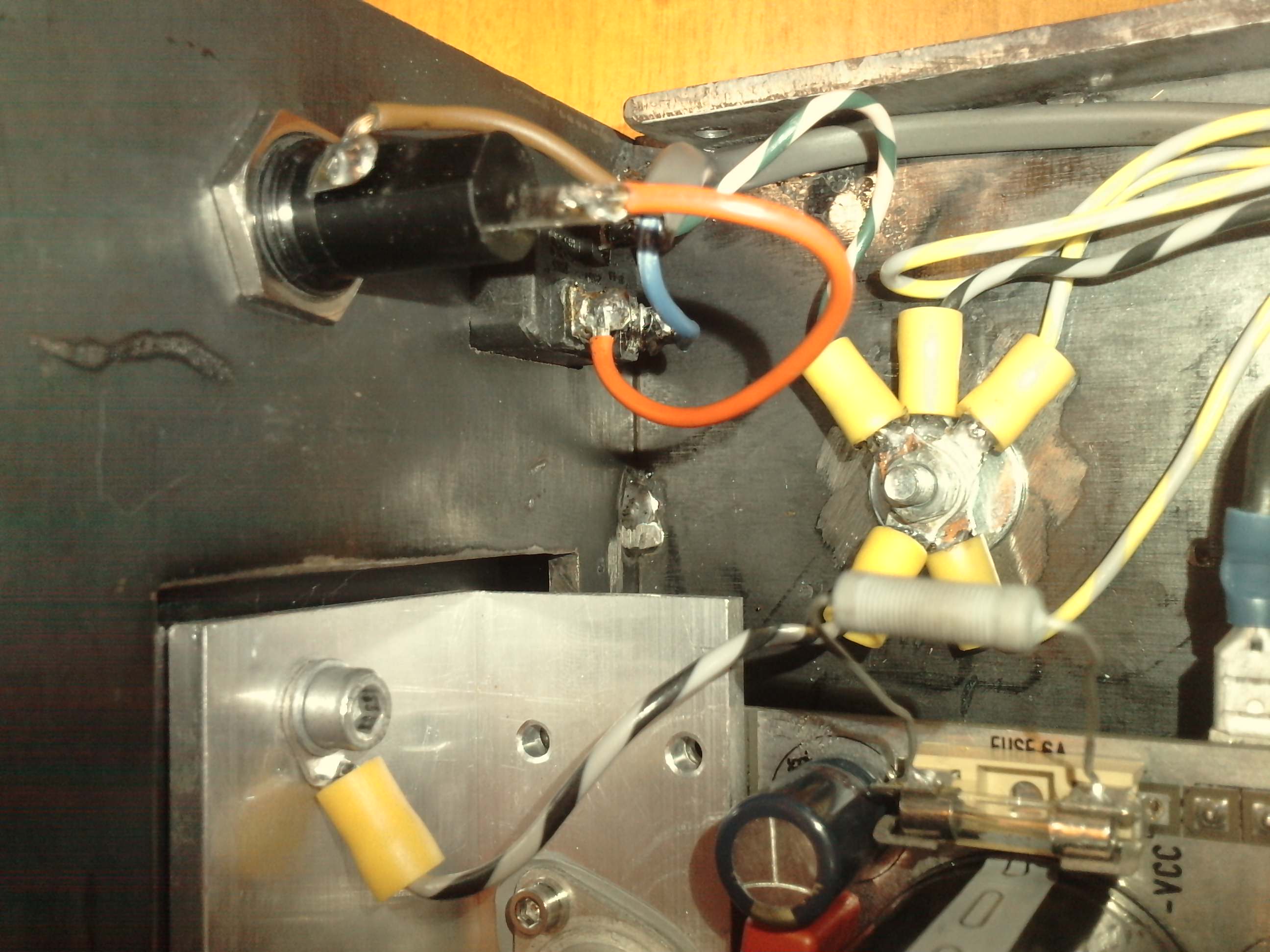

post2484, right pic:
Is that the Mains Power input socket I can see?
The top pin looks like it is the PE terminal.
That PE terminal MUST have a direct mechanical fixing to the adjacent Chassis. This direct connection should be a green/yellow cable.
Nothing else is allowed to interfere with this SAFETY connection !!!!

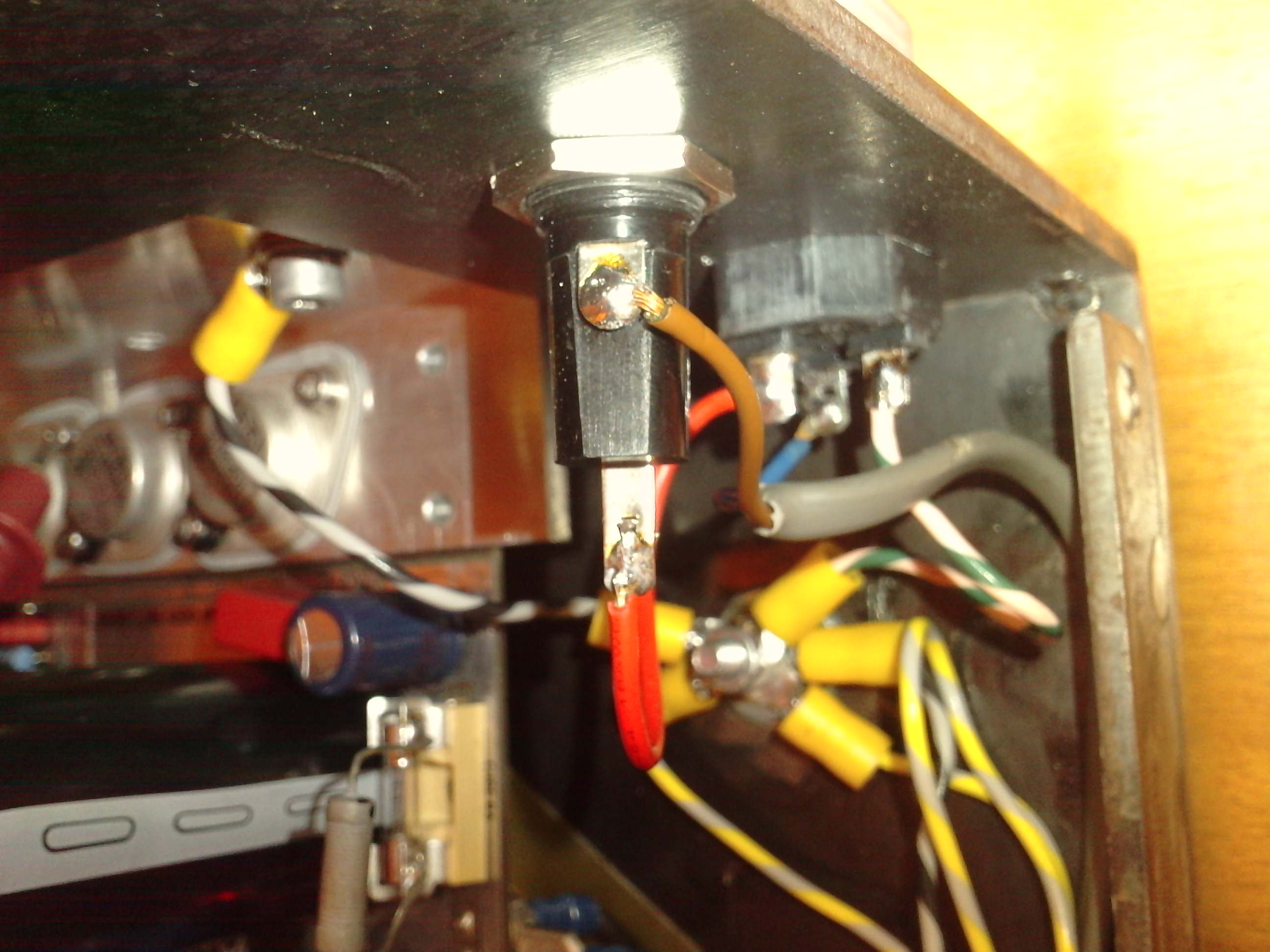

Is that the Mains Fuse Holder?
The Mains Power MUST go to the END terminal of the fuse holder.
The power OUTPUT from the fuse holder MUST come from the side terminal.
Who wired up this "Very Best Amplifier"?
They deserve to be put in prison !
AntrewT
Image confusing.
The top pin it is ΝΟΤ the PE terminal
And you confuse us.
The next time you want to say something clean would have to show us a plan how wired the amplifier.

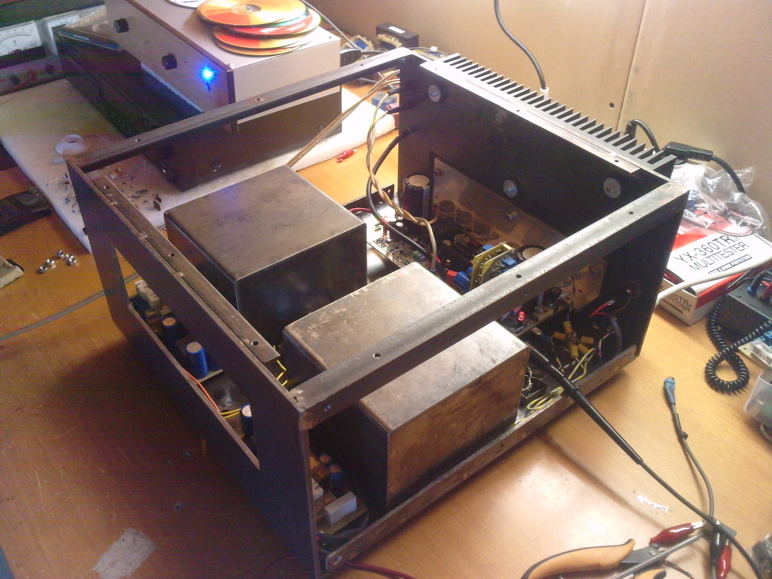

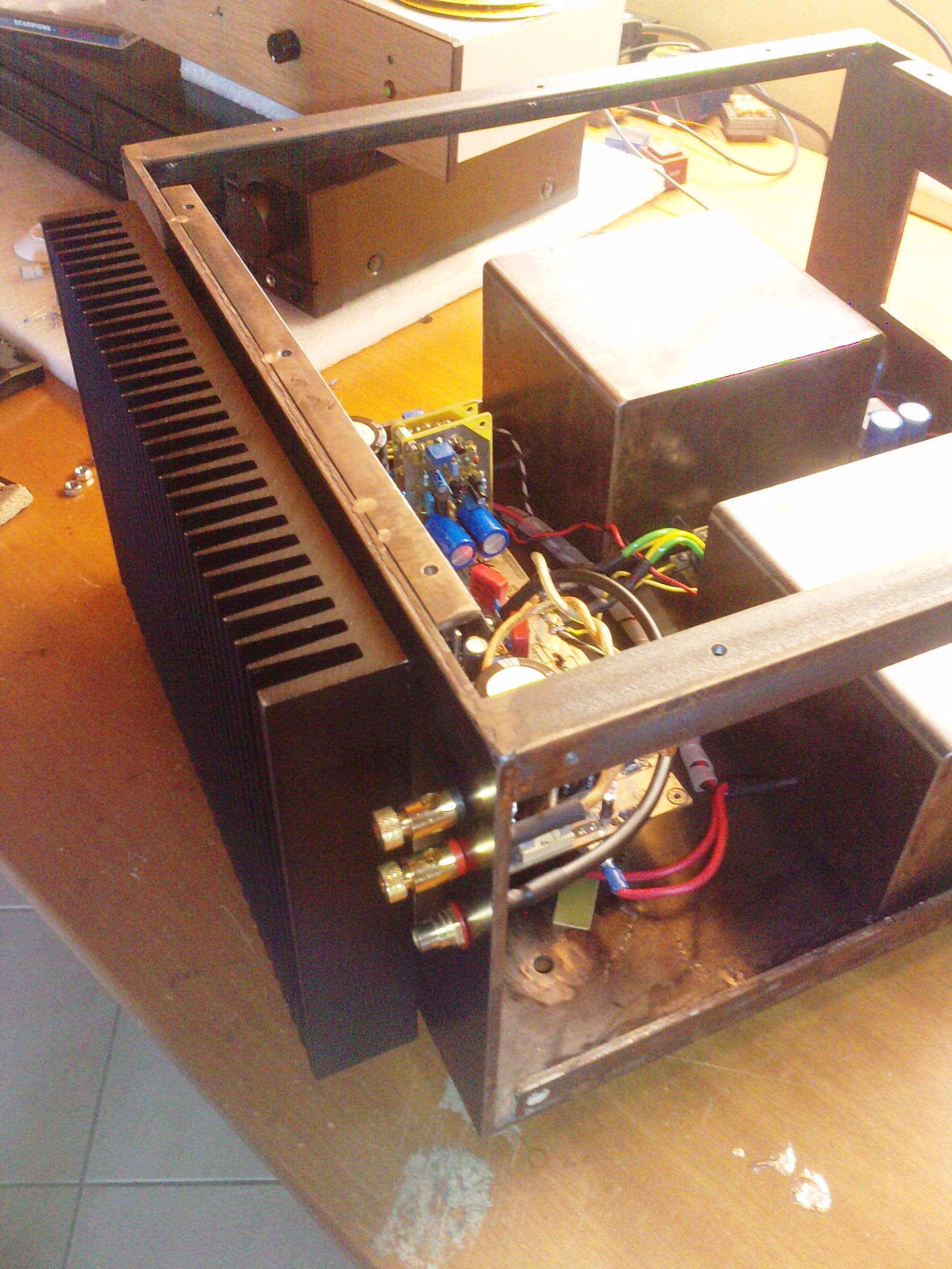

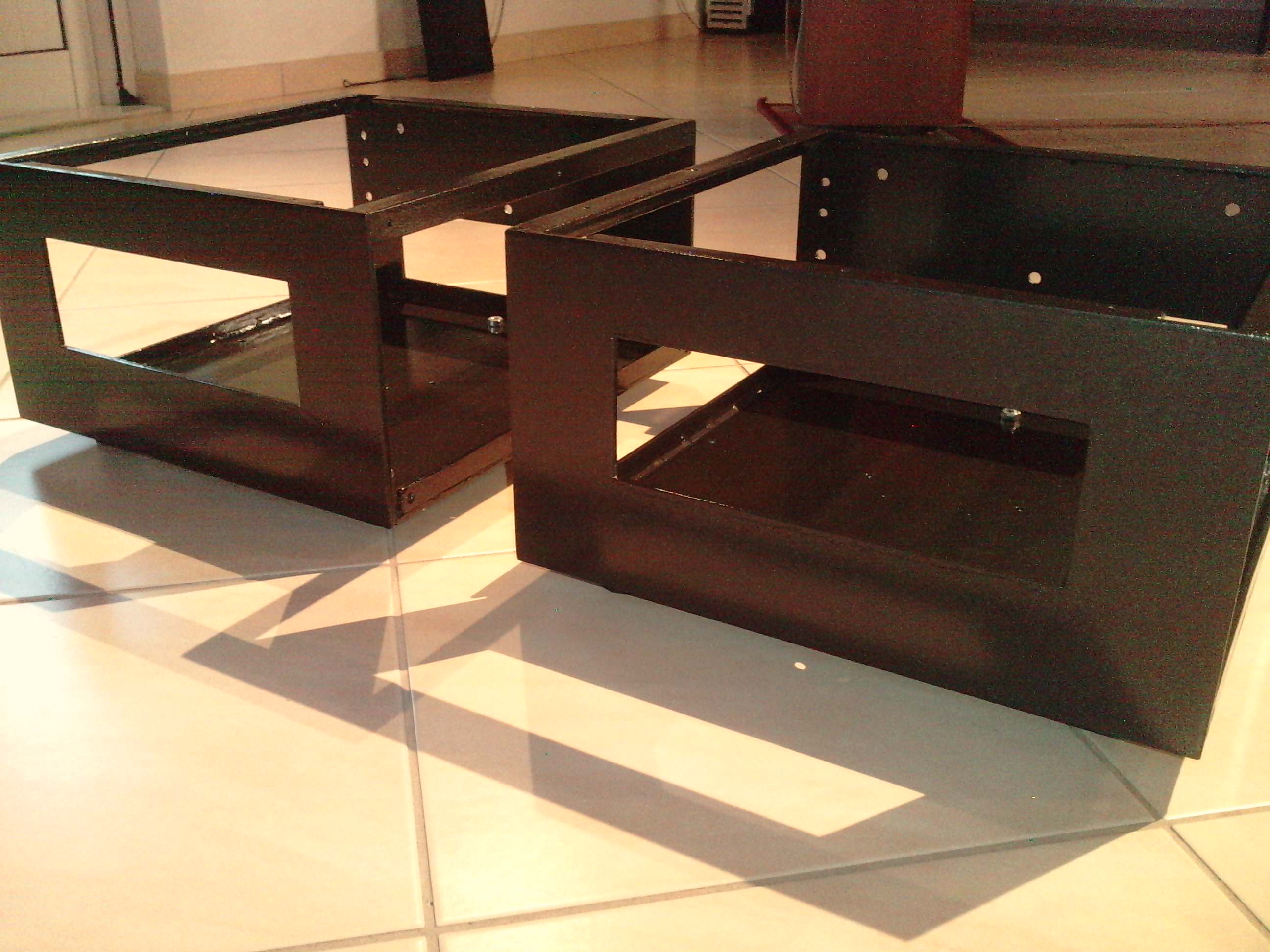

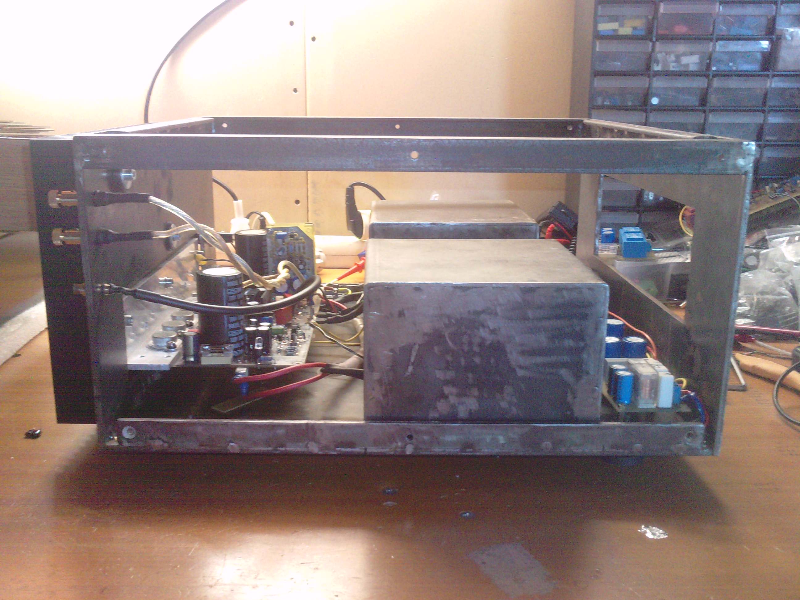

Re: Golmund clone
Golmund clone box
The construction is in the research stage and was not installed insulation in critical parts.

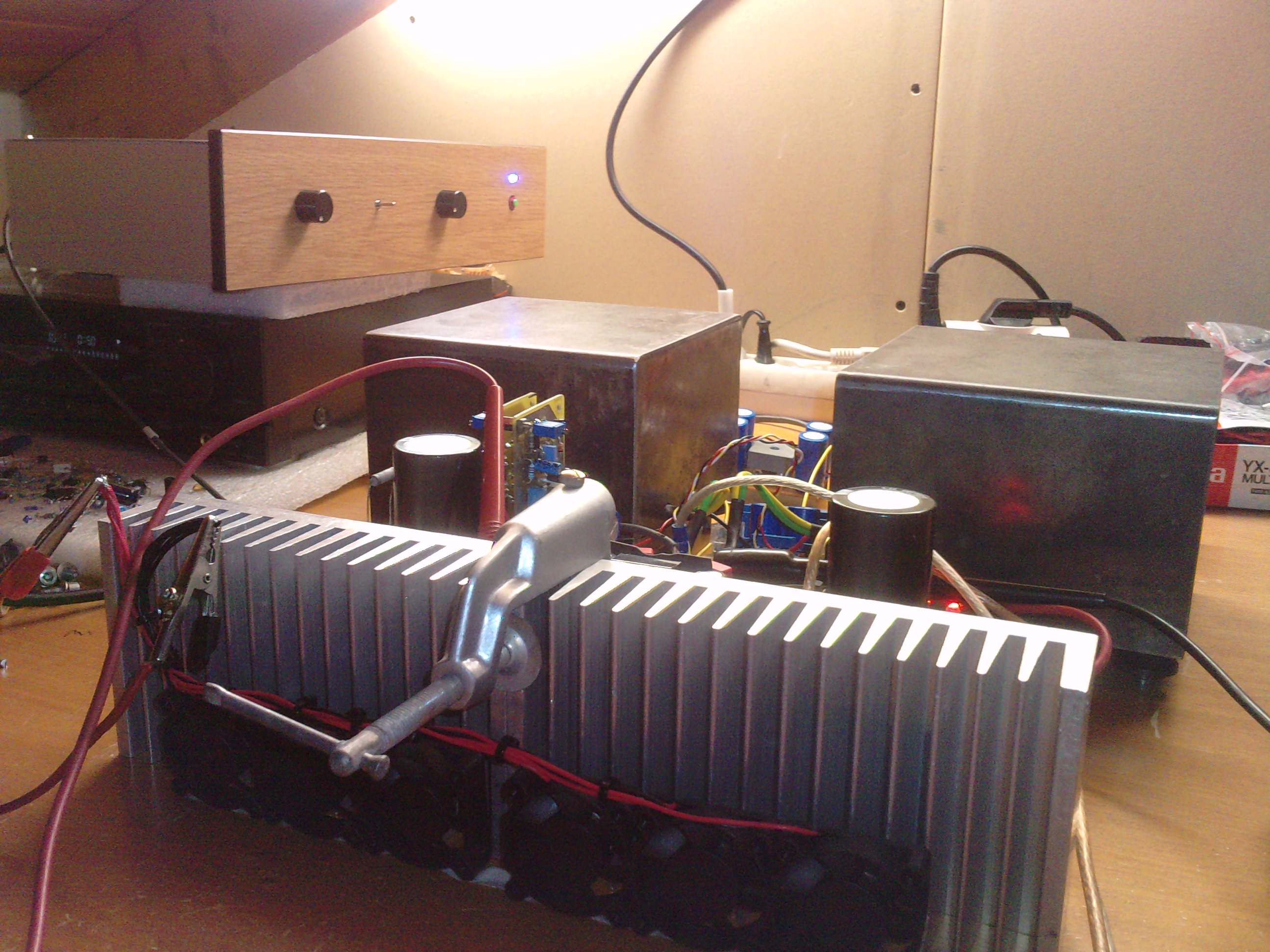

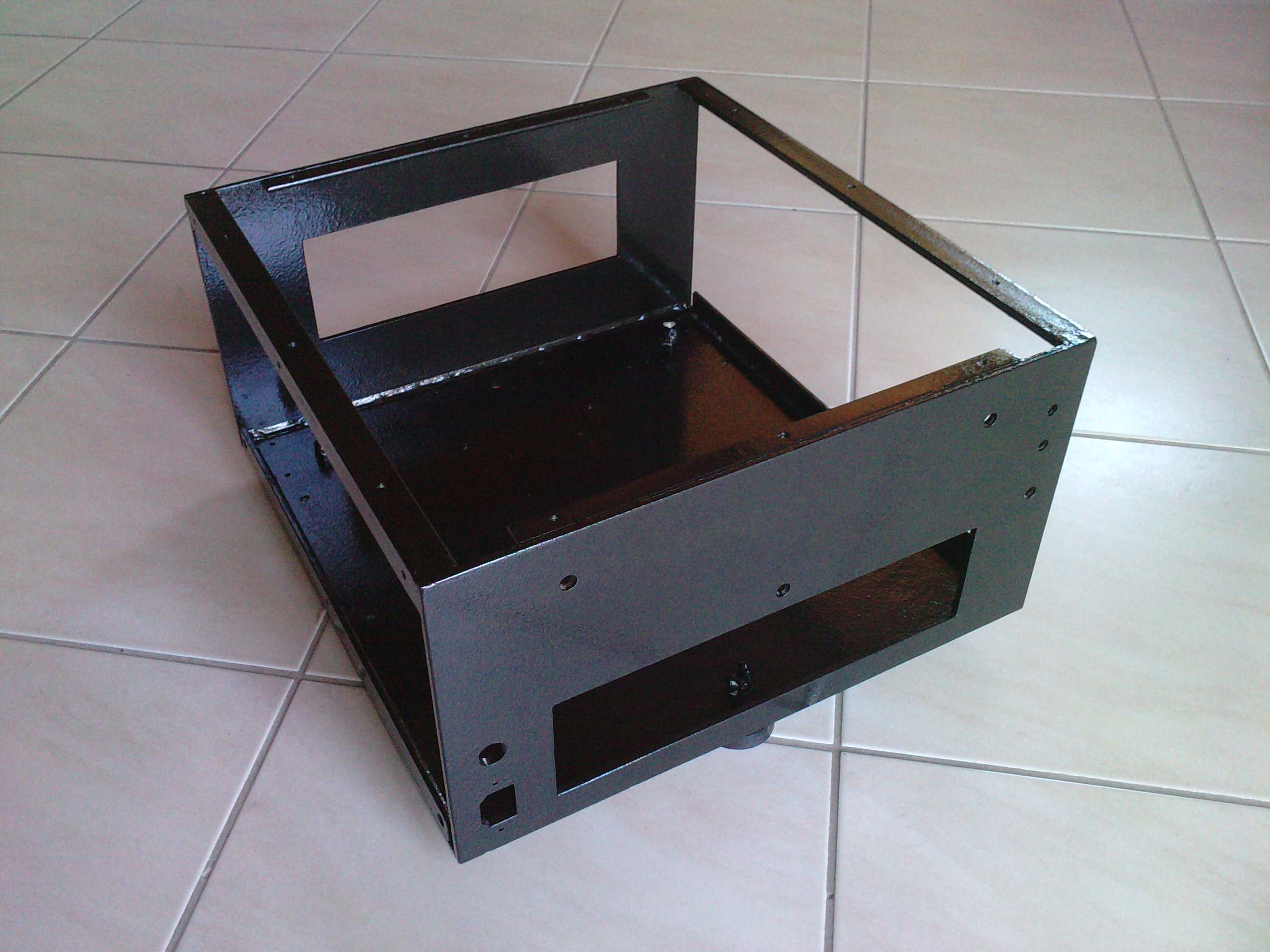

Goldmund 9.2
The boxes have been painted
The amplifier on the bench for the final tuning.
