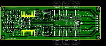

I've worked in the audio industry for more than 10 years, this is by far the very best amplifier I have ever heard and I've heard them all.
The topology is not unusual.
There are amplifiers which are almost like that.
There are 3 things I notice are a bit special.
- The use of a DUAL JFET in input.
- The triple paralleled 2SK134/2SJ49 lateral MOSFETs in output.
- The separate regulated input/VAS supply.
The last point, the separate regulated supply for Input/VAS
is something I have recommended many times.

I completely agree with you regarding the regulated power supply for the input stage. I haven't seen this kind of topology in other amplifiers, per se. Which amps are almost identical?

Nice PCB layout Alex

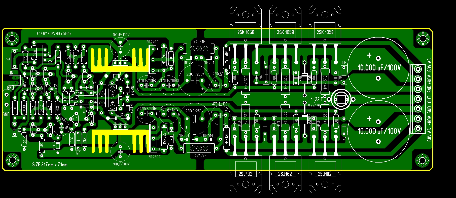

Is the PCB accurate enough to etch? Can we get the layout files?
What kind of power and rail voltage can we expect/use on this?
Power rating is approximately 250 watts (2-8 ohms).

The gate resistor value seems quite low (100R). On lateral mosfet amplifiers that I have rebuilt recently I have used 1K for the N channel and 680R for the P channel. The 2 differing resistances helping to compensate for the different gate capacitance values.
