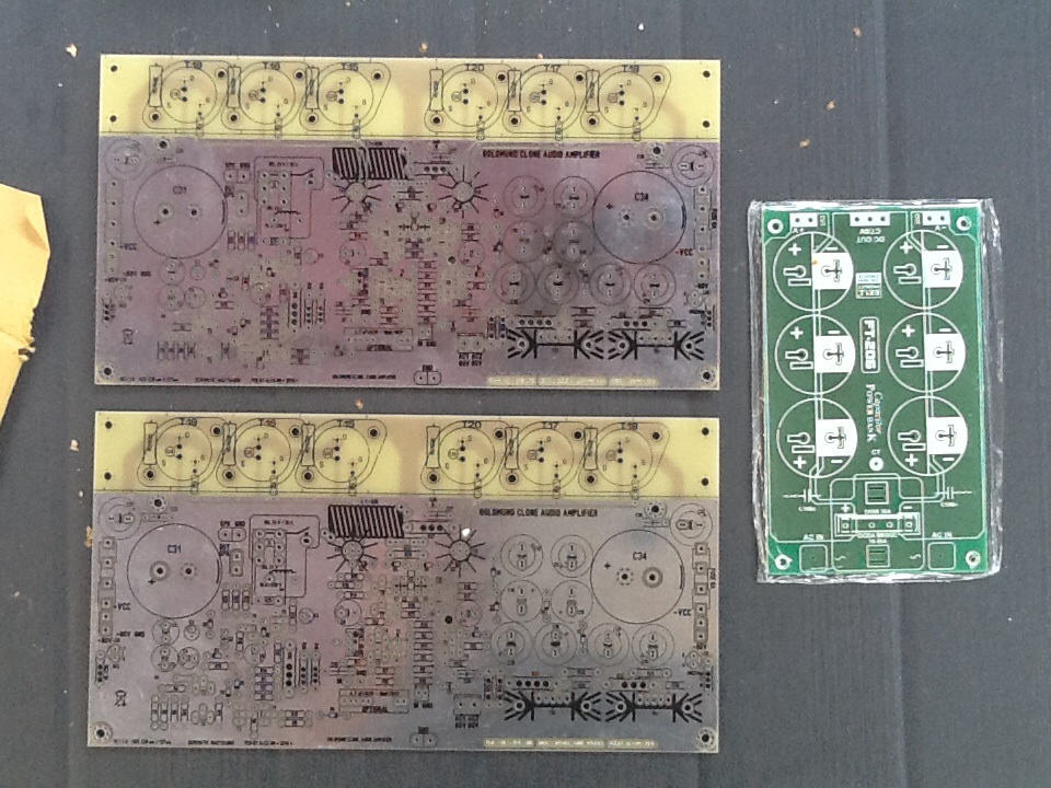

Good to be matched, it improve the sound definitely.
But it will work with out matching if it has source resistor you know the 5W 0.22R or 0.33R etc. value.

Ah ok, thanks!
I saw that Nikoskey wrote some numbers on them... I guess that will be HFE?
Cheers!
Cheers!
.... no ,it's not Hfe , mosfet's are voltage controlled and BJT are current controlled . I think are gate-source opening voltage ,or something like this....😉
B.R.Alex
B.R.Alex
Alex means the Vgs value at identical source currents.
In this case, in the order of 150mA. (Nikosokey biased his output stage at 120mA per device)
Thanks guys. I hope they are close enough. Not cheap those Hitachi 2SJ50/2SK135 mosfets! 🙂
I will match Vgs as suggested. Thanks!
