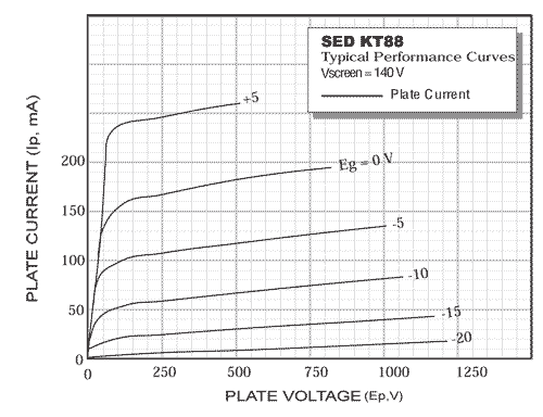

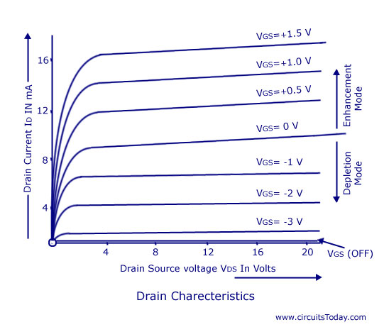

Output characters of BJT,FET and Tubes are attached .From that you can see what are VC,CC devices.why they are called So.
BJT - IC Vs Vce @ constant Ib
FET - Id Vs Vds @ constant Vgs
Tube - Ip Vs Ep @ constant Eg
