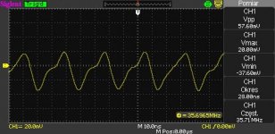

I got it, amp is working! But i got some oscilation on output. I had to change the value of some resistors, like R32/33 to 1.9k, Vcc jumps to 82V, on each R32/33 I have 25,5mV. And connected signal gnd direct to main capacitors. R20 changed to 330ohm, on 2sk1058/2sj162 is almost 100mA on each, I do not have enough transistors to match them perfectly, pair has 80mA, some 104mA. I have ordered 15 pairs yesterday, so it will be work to do. Dc out about 1mV. Vas transistors on same litle heat sink.
No signal connected, heat sink connected to ground.
Have somebody have same oscilations?
