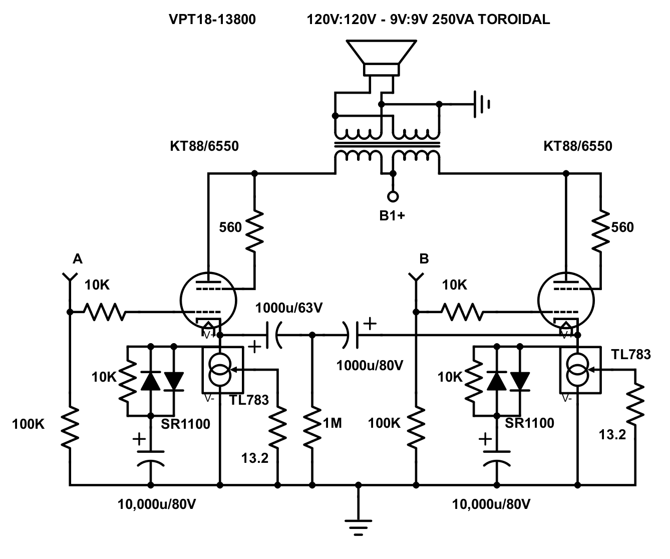

Then I must ask GoatGuy his take on the following? It's based on Broskies design without the Zeners (that just explode anyway).

Now that is a curious design. Using a back-to-back low VF 860 mV Schottky diodes to cut out the effect of the capacitors-in-parallel to the constant current adaptive voltage bias source during low signal conditions, then slewing the caps in or transients. Seems - just to me of course - like a pretty nonlinear response nexus. It isn't clear what Broskie was attempting. With or without the exploding Zeners.
Its also curious to see the 500 μF (total effective capacitance) from cathode-to-cathode. Truly floating, it is, with a bit of charging current thru that 1 MΩ to-ground resistor. Time constant of what, 1000 sec? Kind if ridiculous: would be better to use a 15 kΩ resistor (still 15 second RC) and get the big caps charged up in a reasonable amount of time. 15 kΩ also isn't egregiously loading, nor equally alarming local-negative-feedback extent. But that's just a value-tweak. 1 meg is fine, too.

Ah. I=E/R → ²⁰/₃₉₀ → 51 mA. OK'…

Thanks​ for​ the​ schematic​ capture.​ ​ It​ helps​ to​ know​ just​ exactly​ what​ we​ both​ are​ considering,​ balancing,​ talking​ about.

He was attempting class A with brief excursions into AB. In the circuit, the SR1100 has a VF of only 340 mV. (GG: wow!) There isn't enough current to increase the VF beyond 340 mV, … The 1 MΩ is because Broskie thinks polarized caps sound better with a polarizing voltage across them.
I wouldn't argue against that last position. Aluminum oxide is a weird insulator: in the biased ("charged") direction, it is an excellent insulator nominally. However in the reverse direction, it acts as a preposterously ill-behaved semiconductor. Capacitors … used in passing A/C signal … of the electrolytic type, need to be charged up, to have any voltage swing(s) across them be entirely inside their Al₂O₃-as-insulator regime. Its good to see that Broskie agrees with that, even tho' we didn't exchange notes (LOL) 😉

For post # 83, if one tube starts to run away, the other tube will too (and they will cause each other to run away faster).
(Positive Feedback Bias).
Be sure to use grid resistors that are no higher resistance than specified for the tube you use.
Since they are cross wired, it will likely need to be lower resistance than the normal self bias specification, i.e. if the maximum grid resistor for self bias is 200k Ohms, you may have to use something like 150k Ohms or 100k Ohms.
