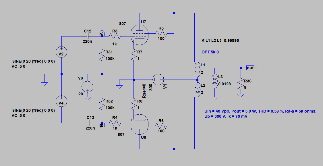

I boosted a 6922 dual triode to 30w using Transistors in p-p config. 12AX7 provides enough gain to get full power from 500 mV input.
...5 Watts. 6L6 is very inefficient at low +Ub and triode mode.
Bias voltage will vary from tube to tube. If you're not using cathode bias, you need to adjust the bias voltage while checking the current. For what it's worth, I've built amps with 6P3S in triode and in regulated tetrode. The "typical" datasheet implementation for class A push pull will give you 15W and still have quite low distortion.
Thanks for this. One day I'll learn how to use SPICE instead of just building and testing the circuit. Can you adjust that SIM for 400V? Does it make closer to 10W?
