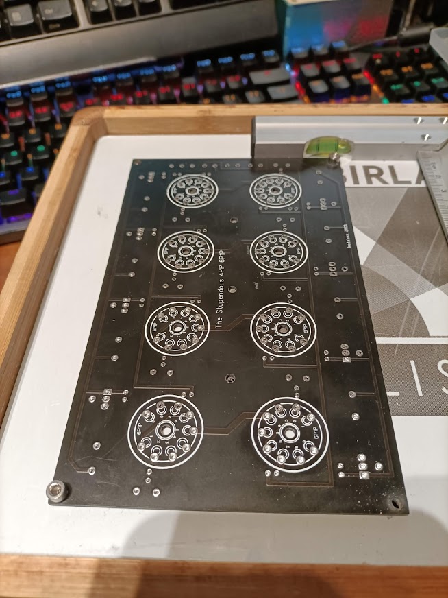

The "Stupendous" 6P1P 4PP amplifier!

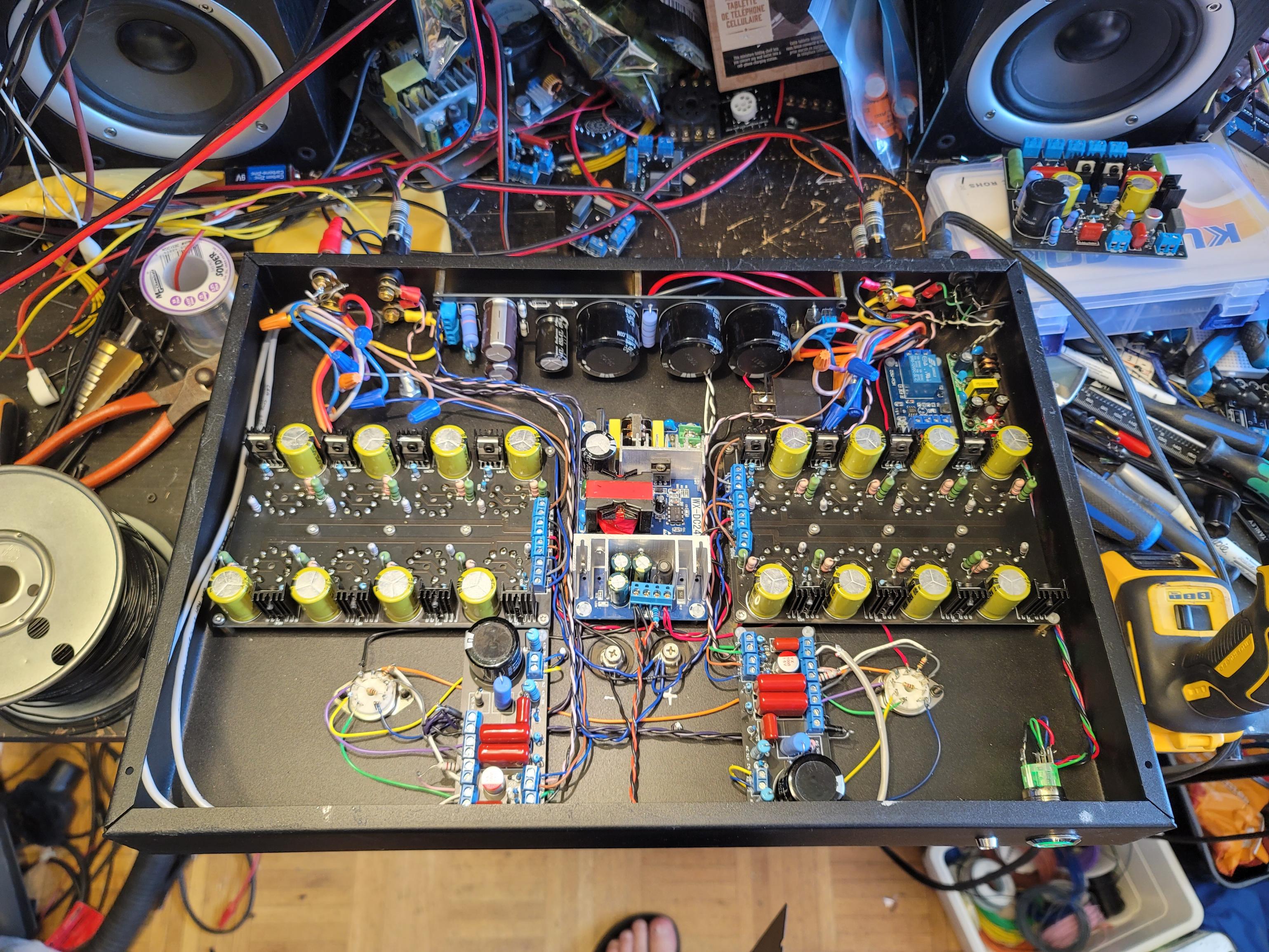

It sounds pretty damned good though. Doesn't even need a compensation cap in the NFB loop - 1k resistor is it. I'm driving it with my 6F12P VA/PI board.

The usual speakers I use (karlsonator with two parallel connected Faital-pro 3FE25-16 per channel) are pretty efficient, my flea amplifier ran them great for usual use, only straining at bass heavy loud use. I think four 6p43pe triode per channel will be plenty.
I built an amp with parallel 6N6P - I ended up going 6P15P pentode in that one.
When I build with 6P43P, I use one pair and still get more power out than with this 4PP 6P1P 🙂
1 pair into VPT12 (~2k2@6R load) works wonders. The same load at I'm using on this stupendous.
BTW there's nothing stopping people from using this board as an 8SE amp. Just parallel in and out and find an SE transformer that likes 320mA idle current...

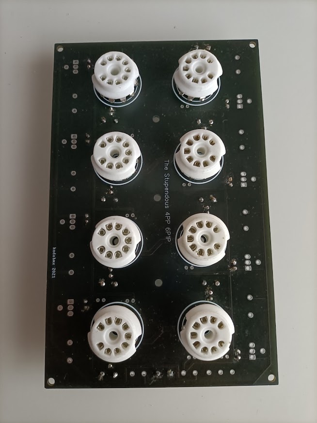

The board has no driver or plase splitter. It can be used as 4PP or 8SE (or less by removing pairs)
6P43P is a different tube type that is similar to an EL86. When connected as a triode, it's quite a linear capable tube.

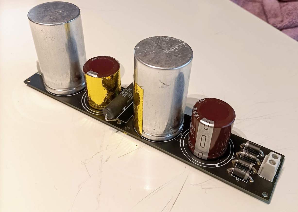

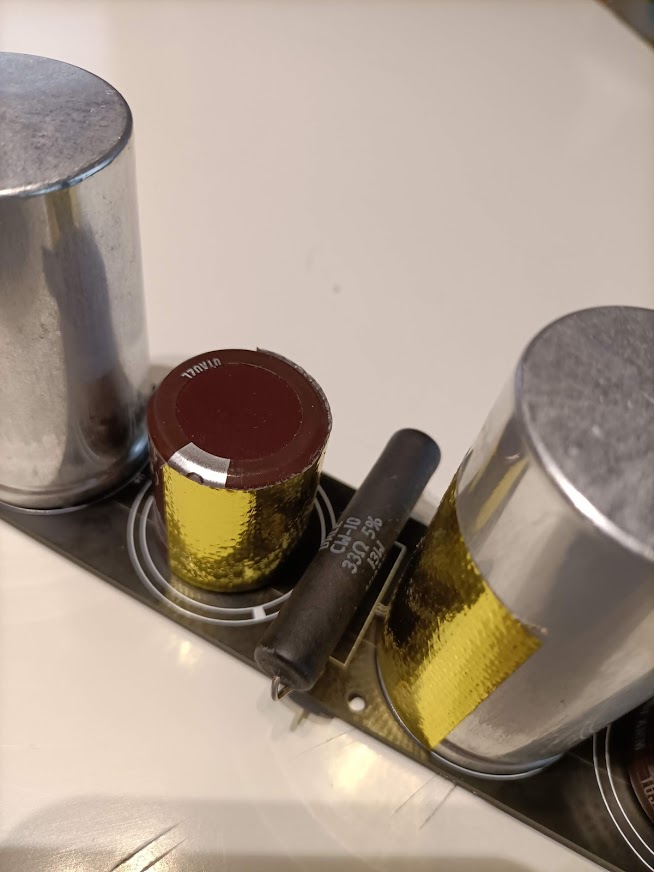

Remember you suggested I run my 6p1p a little less (38mA) for the output transformer. So it's going to be 304mA per channel. Comes out at a 10Volt drop and 3.05 Watts dissipation. I played around with PSU designer. And liked what I saw going up from say 10R. Plus I had these nice fat 33R/13Watt resistors lying around.
I forgot you're going dual mono...
I use one PS board in a stereo amp 🙂
