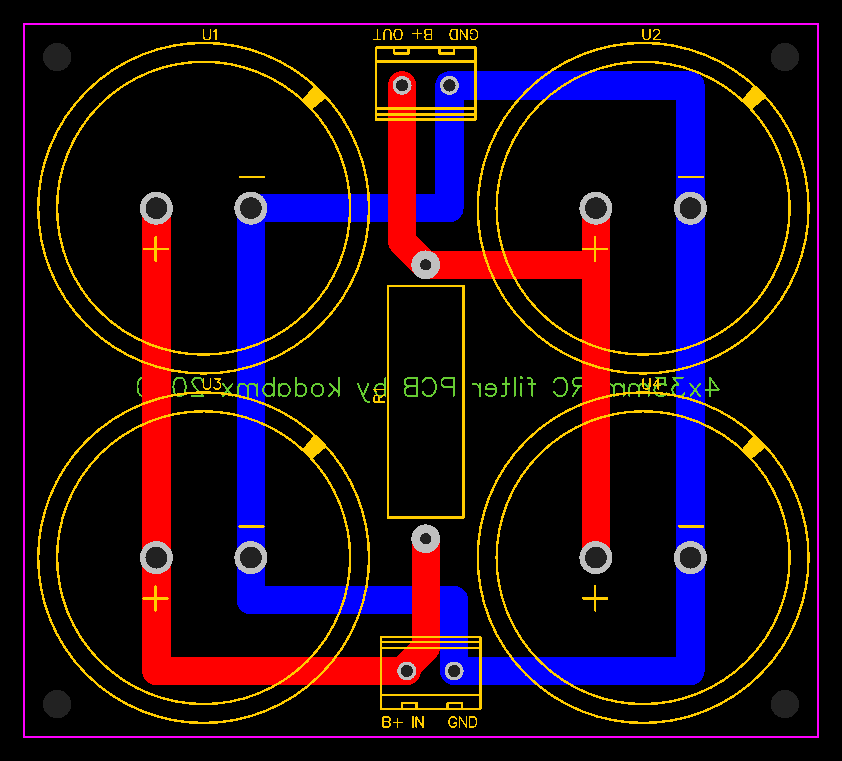

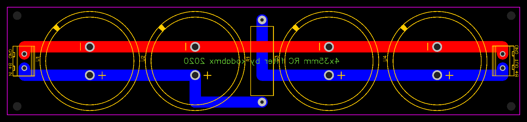

I have PS RC filter boards that might interest you. Nothing fancy, just 2 35mm caps in parallel, a resistor, and two more 35mm caps. Right now, I have one set up with 4x330u, and 5R1. I have two designs, one is square, the other is long rectangular. Cap spacing is for 10mm snap-ins. 5$ a piece.

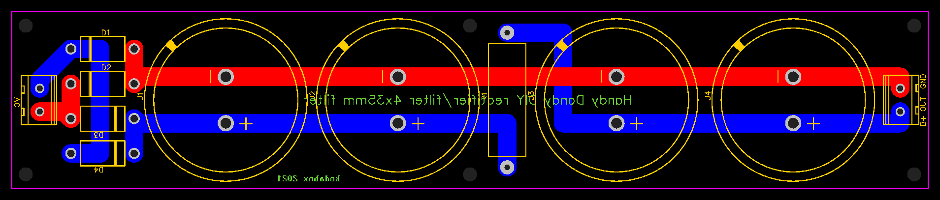

I'm also gonna send this one off if you prefer to have the diodes onboard. It'll cost 10$ though since it's longer, but I'll throw in the diodes?
It'll arrive with the other boards.

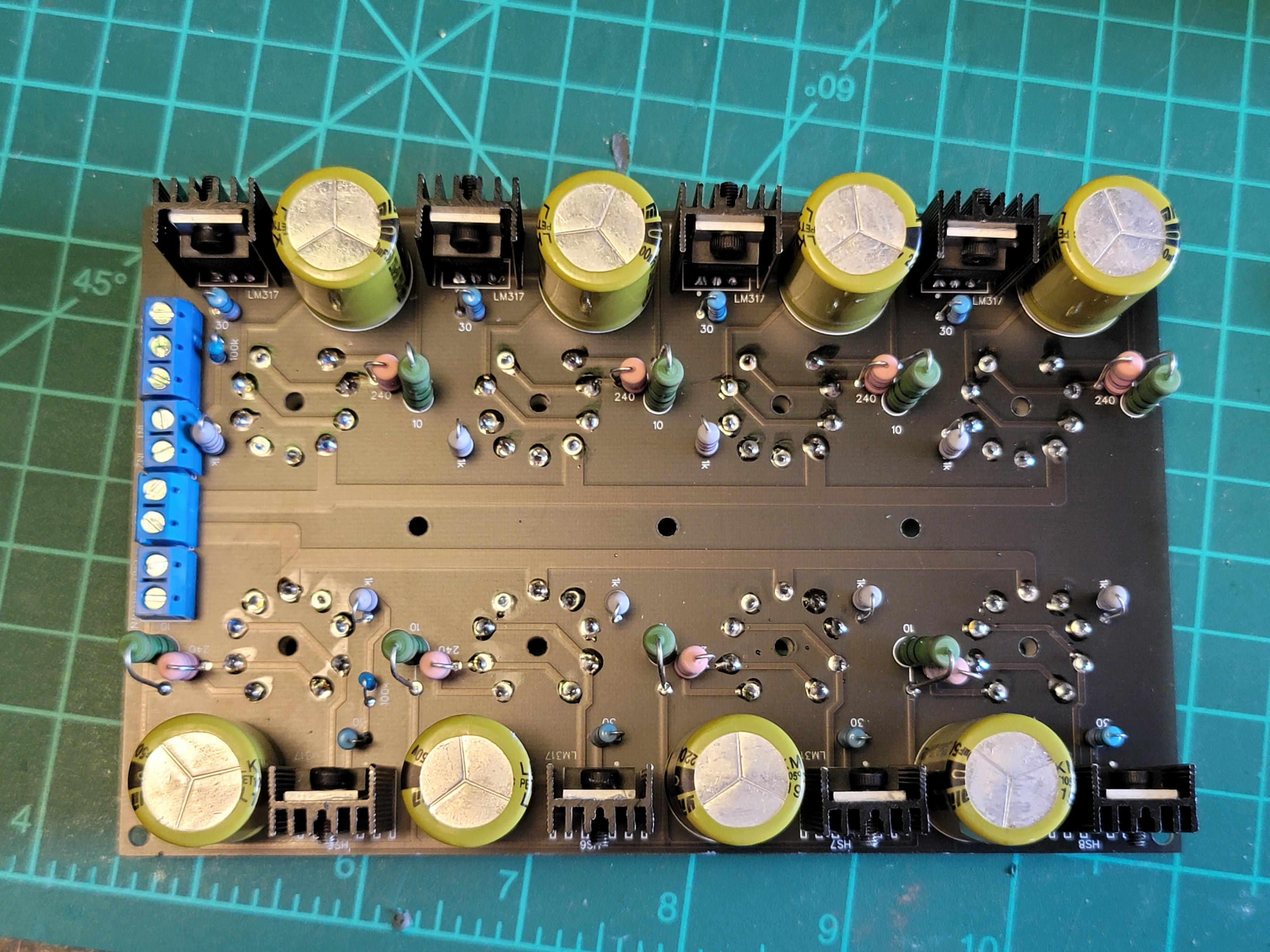

If anyone is interested, I designed the output stage into a circuit board.
Want a pair?
crawls out from under a rock
NICE!!!😎
Did you do that with EasyEDA?

Also, I just realized I didn't answer Linwendil's question. Yes, I'm using EasyEDA.

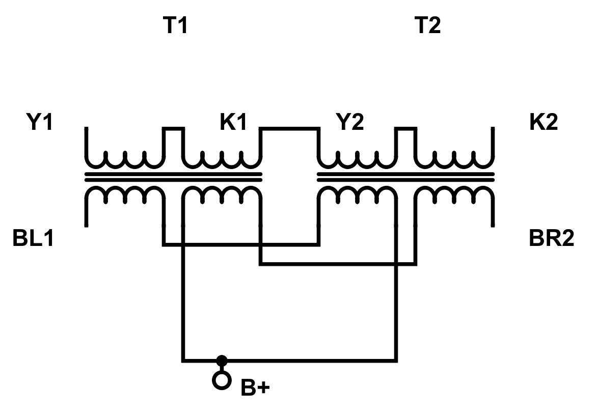

Consider trying the interleaved OPT method using a pair of toroidal PTs.
For 160$CAD plus tax, you get iron for both channels, great response, low DCR, and low phase variance (more gNFB can be applied).
Can you point us to an explanation of how to do this? Do you use two toroid PTs per channel, so four toroid PTs required to wire up the OPTs for a stereo amp? How do you wire those to get the desired result?
I was thinking of simply having Edcor or Transcendar make something, but Antek or other toroidal PTs are certainly an interesting option. I'm up for an experiment...
Yup, two per channel.
Here's how I wire them.
The nice thing about it is if you don't like them (I think you will - I can at least vouch for the Triad coils), you can use them for heater power 🙂
