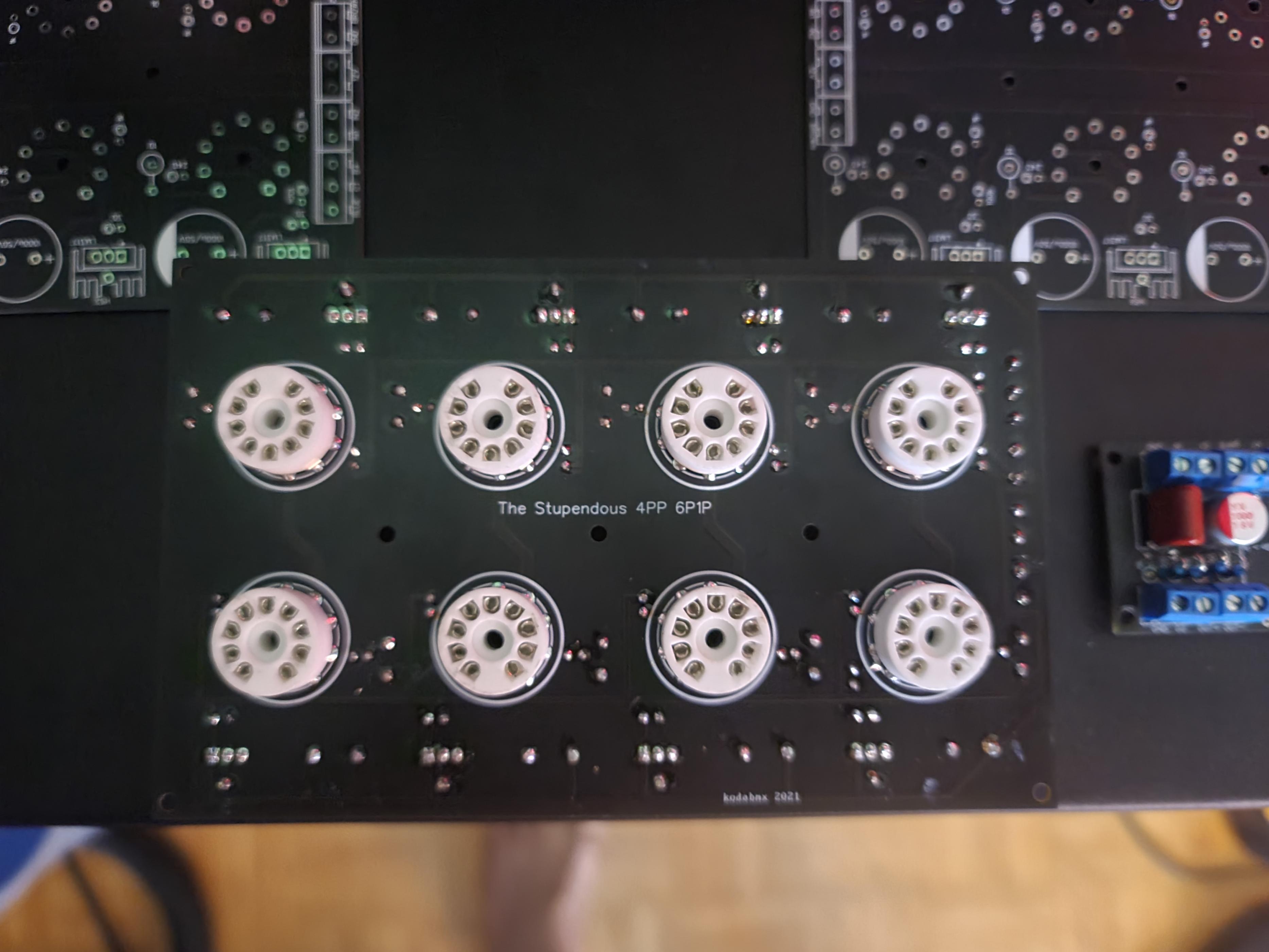

I was thinking about the appeal of your PCB as a “Universal board”. May I suggest that you consider adding jumpers to separate the halves of the board, so that one could use the boards as originally intended in pairs, but also to just one board for a stereo PPP amp. And add what is needed to enable the use of the boards in triode, pentode and UL mode. I don’t know if it is feasible, but believe there could be interest in such a PCB.

Using the double/tripler/quad board I made, 124V in give 320V out, and (480V or 640V (unloaded))
6P1P running 320V B+ /38mA a piece... (about 10W)
6F12P will do VA/PI with 480V and about 10mA each I think.

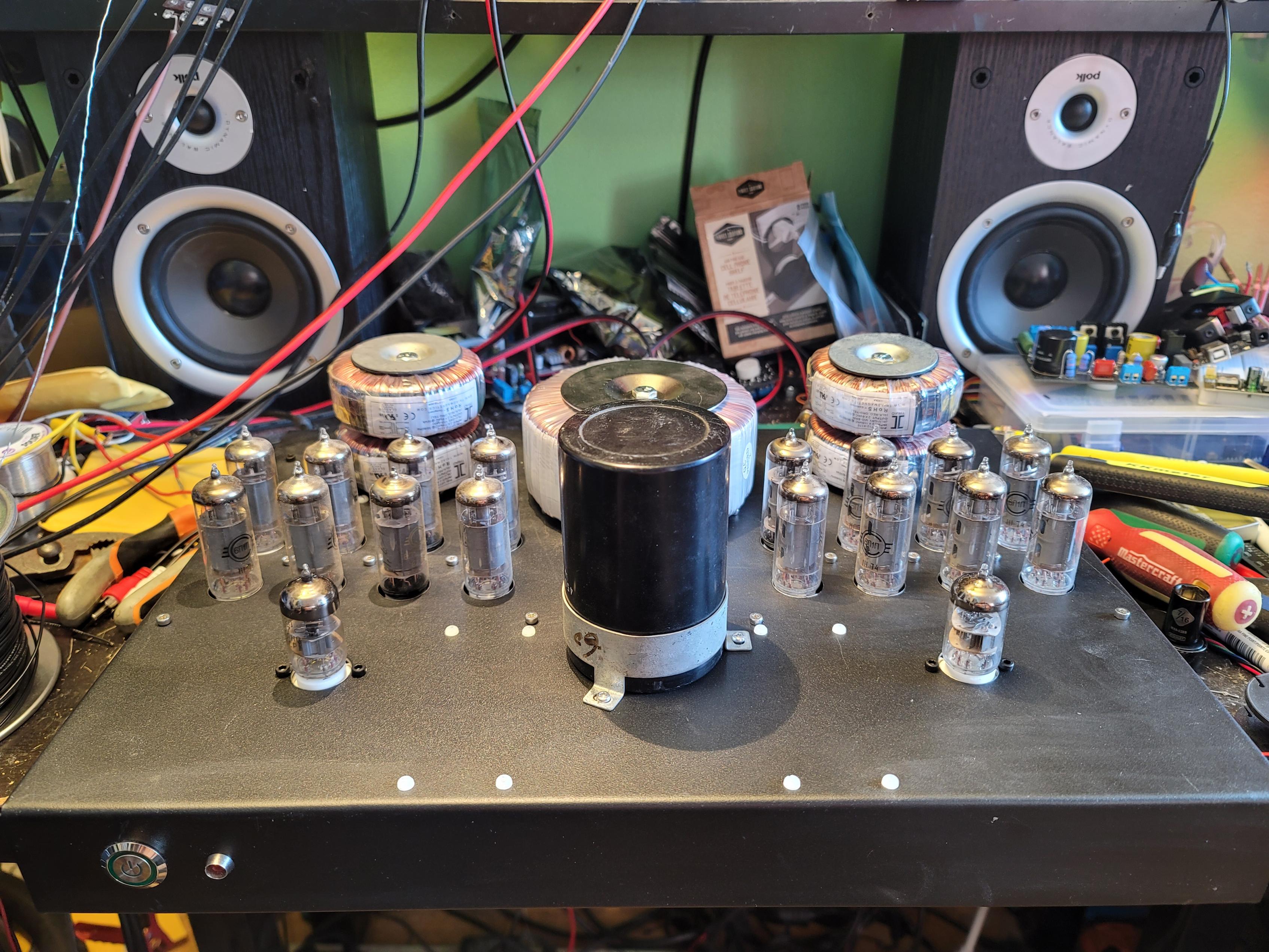

Well it's finished... Now for the smoke test when my other half wakes up (works evenings)...
EDIT: Passed the smoke test - the boards work as expected!
