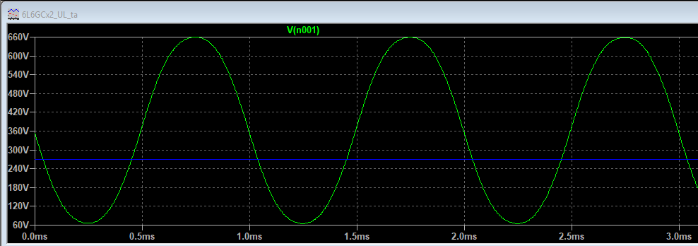

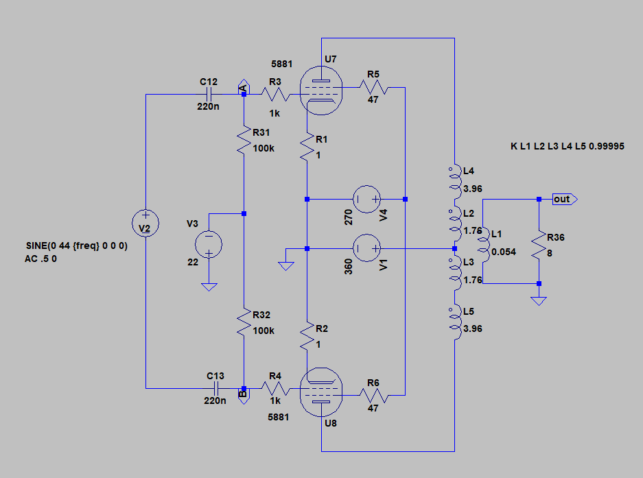

6L6GB / 5881 in pentode mode and with recommended values; Ua = 360 V, Ug2 = 270 V.
At full power plate swings down to 65 V and screen grid stays at fixed 270 V, i.e. at 205 V higher.
This is the condition suggested by the tube manufacturer.

Nice schematic and graph. That is a good mode that will work very well for music.
Do not do any square wave testing with that amp that is also mistakenly turned up to clipping levels. 50% of the time the screen will be at 75mA. 0.5 x 0.75 x 270 = 10 Watt screen dissipation on a 2.5 Watt screen (5 Watt screen on 6L6GC).
