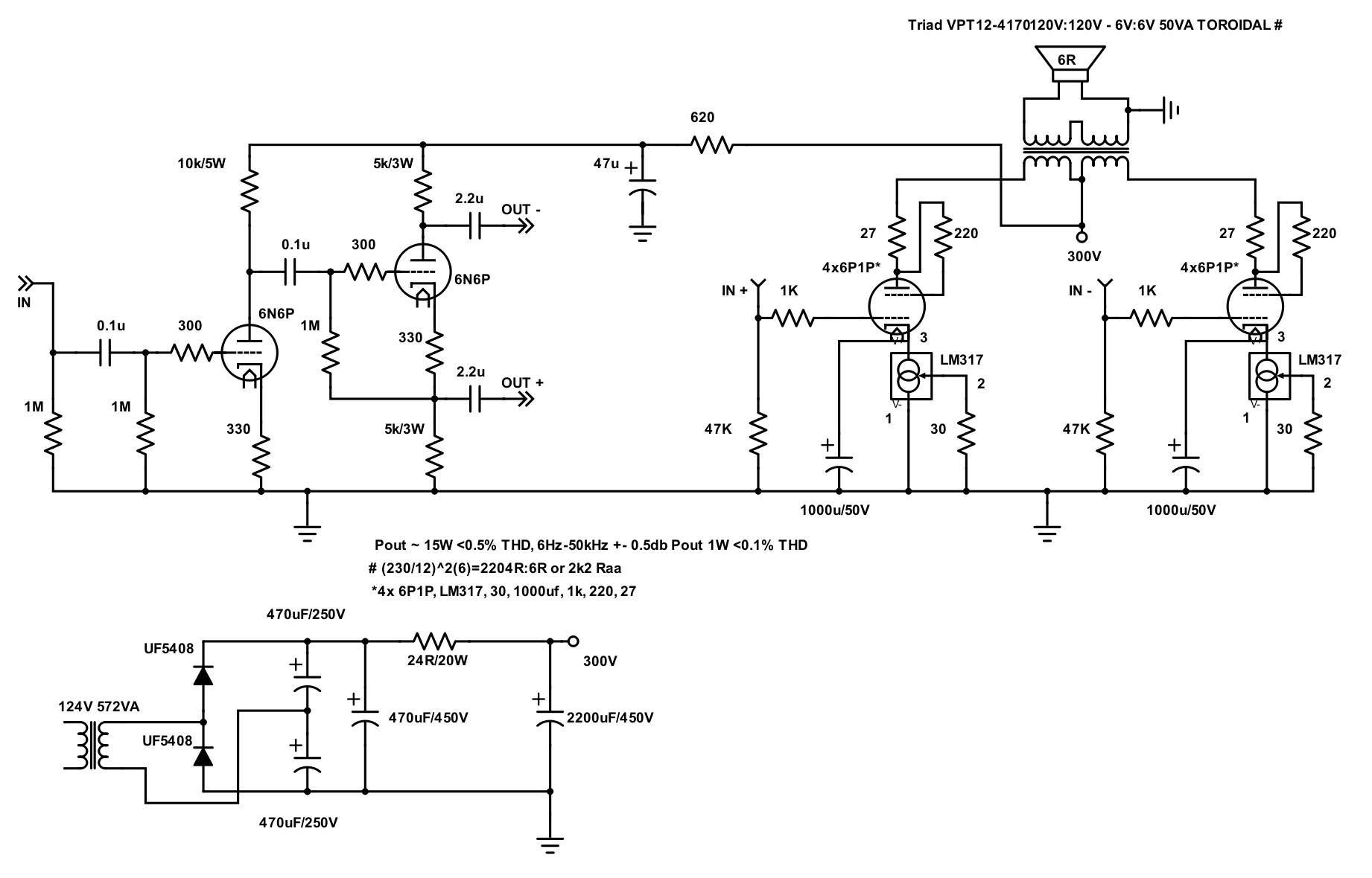

I think it should be fine, but I suppose it wouldn't hurt to up it to 100k in this application. Since you are CCS biased there's very little chance of runaway, and 4x parallel tubes using 1/4 of the max grid resistance of 500k would be 125k, so you would still be within spec.
Could always use a TO220 mosfet for the cathodyne device, slap a heatsink on it, and run it nice and high current, it would work pretty good too. But that's a bit too much heresy for some to handle... I like the idea but can never bring myself to actually do it!
What's your cathode voltage, anyway? Something like 20~25? It shouldn't take much signal to drive those triode connected anyway, assuming 25 volts across 47k (and the grid capacitance) you're looking at only a bit over half a mA anyway, so I wouldn't worry really all that much, but building up from scratch I would pencil in 100k grid resistance.

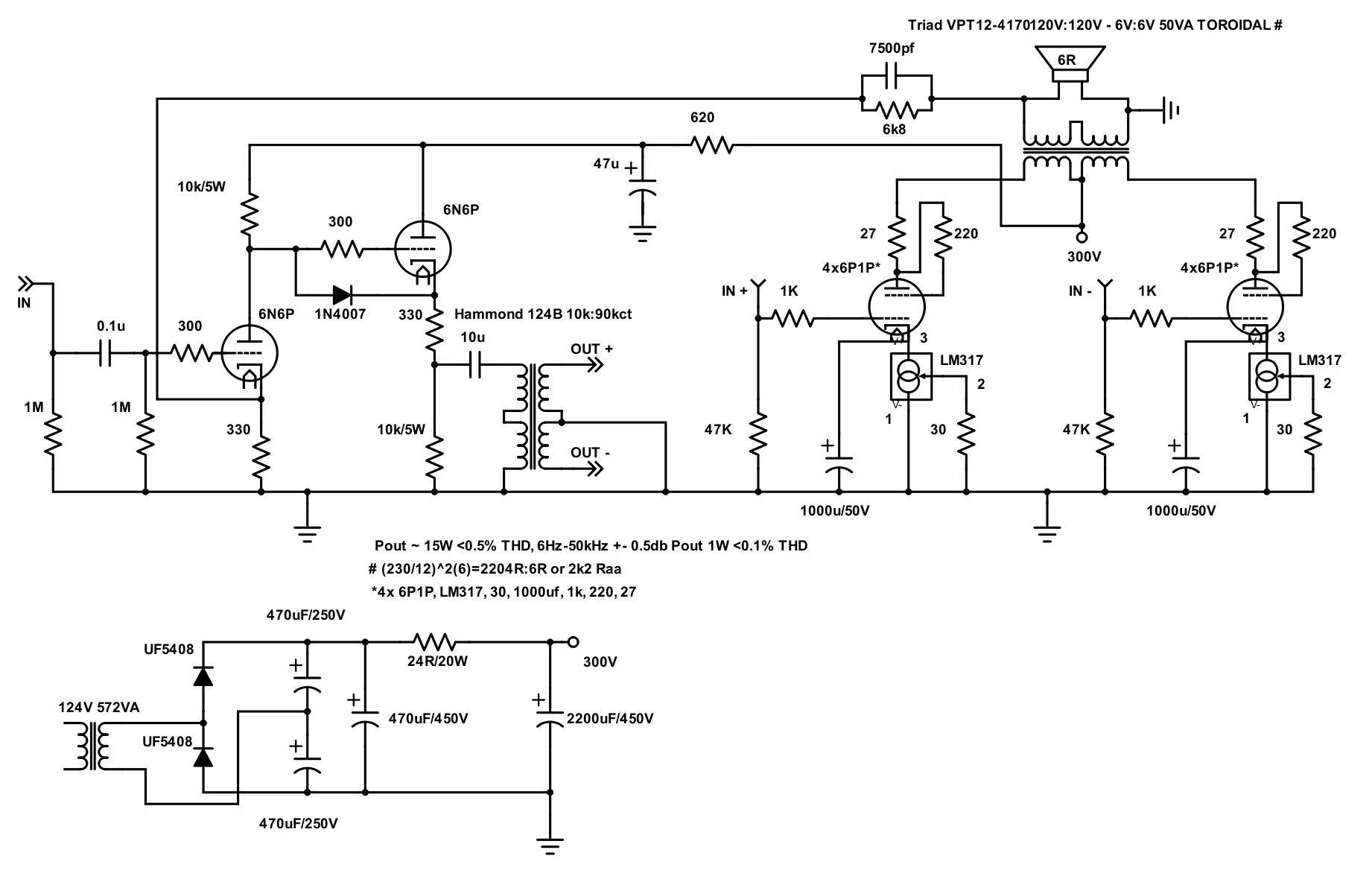

It was 47k for the loading of the 124B. It still is, and without gNFB the square wave is MUCH better. Anyone wanna buy a pair of Hammond 124B? LOL
There isn't enough gain for a gNFB loop now, but if I can find space for one more tube socket...

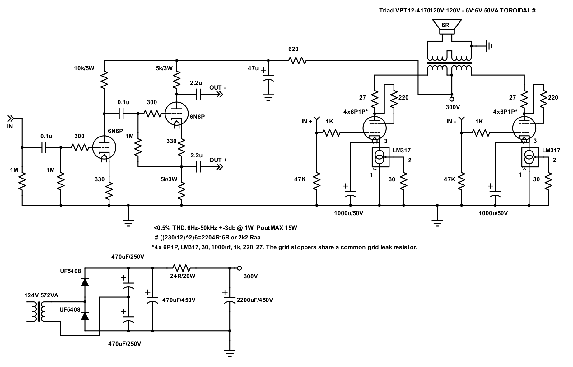

I modified it a little from your idea, here's the current schematic:

Looks good!
If you want a smidge more gain throw an LED under that first triode, should work about the same as bypassing the resistor with a nice cap. Maybe even throw a CCS on the plate, or swap that first triode out for a 6n2p, but that's all up to what you want to do. Triode outputs don't always need much feedback, but I like to run it when feasible.

The first triode is biased at ~4.7V so two LEDs in series... Or a battery in series with the input for that matter. 4.5V is easy to find. Without gNFB there is enough gain though... Ya I thought about using a CCS plate load, too. Like a DN2540 perhaps but for now it's good as is.

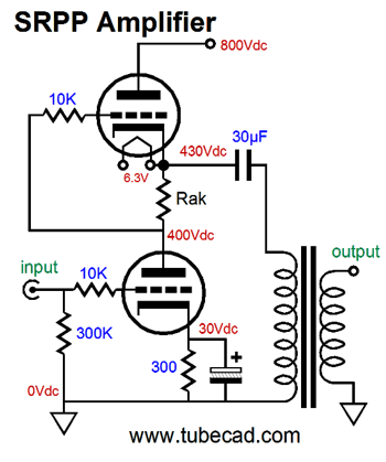

Why not do an SRPP+ power stage with them? Say 500-600V?
Cathode-Follower& SRPP Power Amplifiers

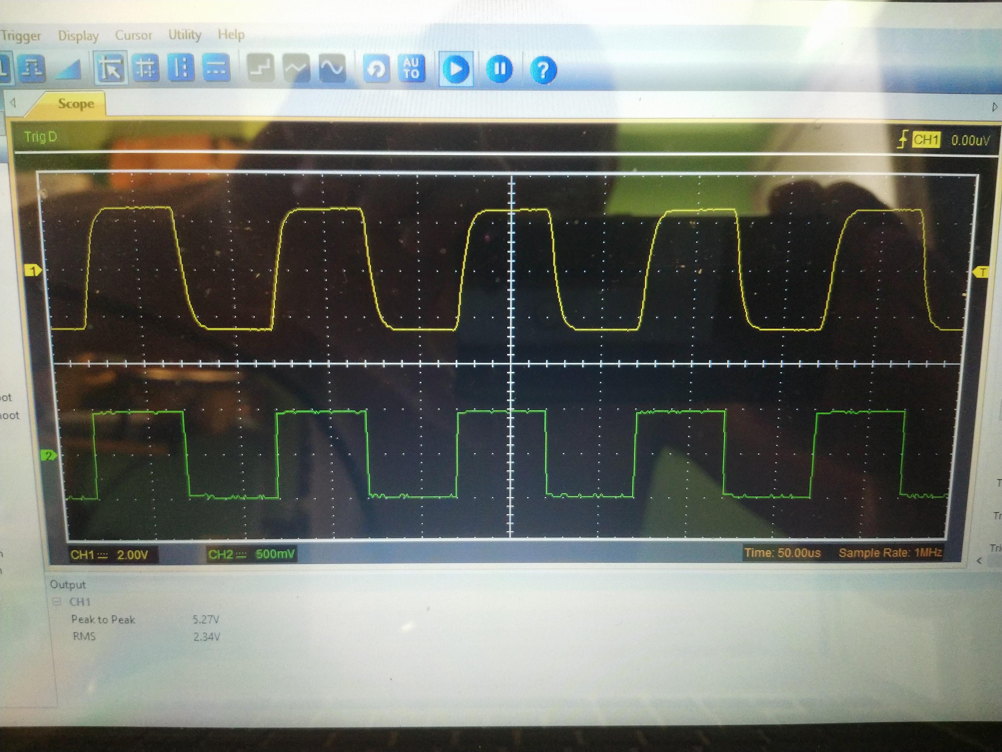

I just scoped the output at 10kHz... This is what open loop triode with 640ma total plate current looks like driving a 50va toroidal power tranny
Not bad if I don't say so myself!
Curious to see how it looks with some global negative feedback. Either way it's pretty good.
