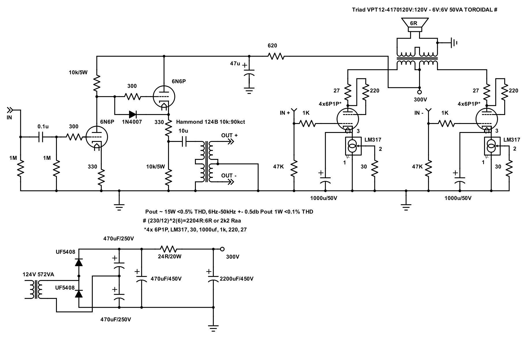

Then your symbol is strongly misleading: You've marked the pins V+ (which most probably correlates to Vin), V- (assumingly Vout), and an arrow pointing into the device, respectively. As this arrow presumably means that a signal applied to this pin does somewhat within the device, it presumably has to be correlated to the Adj pin.
Best regards!
The symbol is marked, I didn't mark it. To me, V- = cathode (in this case ADJ), V+ = anode (IN). If the LM317 was marketed as a CCS rather than a voltage regulator, I feel that ADJ would be the adjustment pin, not OUT. Go figure.
I've added the LM317 pinout to avoid this confusion.
It's more of an estimate based on simulations with Push Pull Calculator, and simple measurements with a scope and a DDS. Output inverted and laid on top of input to leave only the distortion.

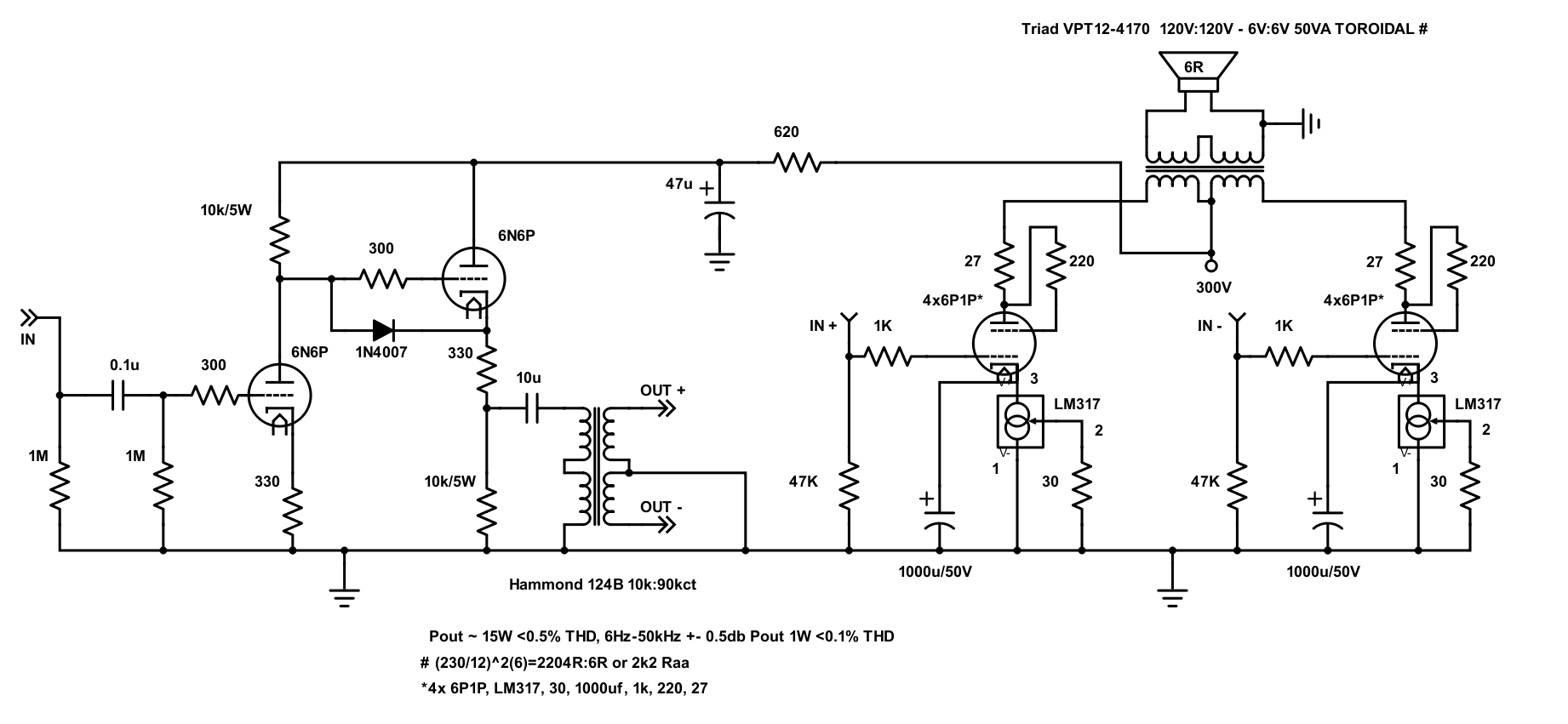

I thought I'd add the final schematic complete with power supply. Enjoy. PS: I used this transformer and doubler because I bought it as surplus for 20$ CAD. The heaters are powered by a 12V 20A SMPS LED supply from ePay, and all wired in series pairs.

Nothing wrong with voltage doublers and cheap transformers, they're a match made in heaven for builds like this! The SMPS is a great idea too. How is it on noise? I heard some can have high frequency hash issues.
You've really got me itching to do a big parallel 6P6S (6V6GT) build now, but I had 6N8S(6SN7) in mind for the next parallel build. Decisions decisions.
How does the power supply work out for him? You don't have much filtering but it doesn't take much with push pull outputs. I've had some issues with hum on doublers with triode connected builds in the past, and fixed it by going pentode mode with regulated screens, since I already had a regulator made up and ready, and wanted to try more power anyway.
I've got ten 6P6S with the same date code sitting here, and another four I could throw in, and eight "matched" 6N8S on the way, with another four on hand. Either way it's going to be AB2 capable with source followers... Do I want a big-@r$e baby amp, or a rock-the-house space heater? Either is tempting...
No measurable hum or hash components, but you're right. Years ago I used an unfiltered, unshielded SMPS for heaters and figured out there was a 43.7kHz oscillation when I blew a pair of tweeters.
The driver is a CCDA so it doesn't need much filtering.
The switcher is good enough. It's a cheap eBay 20A supply and it starts into the cold heaters. It doesn't look like much filtering on B+ but the 24R/2200uF filter works surprisingly well. PSUD2 simmed it at under 150mV. There is no filter for the heaters other than the built in filtering caps in the SMPS.
FWIW I thought about building this with 6P3S instead but it wouldn't have fit in the chassis!
I went with the 15W output with triodes because I already built a KT120 amp that's around 100W with the 250VA Triad VPT18 series. This one was for transformer phase splitting and linearity while running in open loop.
BTW I wrote Triad to inquire about the primary primary inductance of the 50VA model used in this in case anyone is thinking the LF response is down from low inductance: 192 to 444H @ 230V, 50Hz (primaries in series). 283H average from 15 samples.
