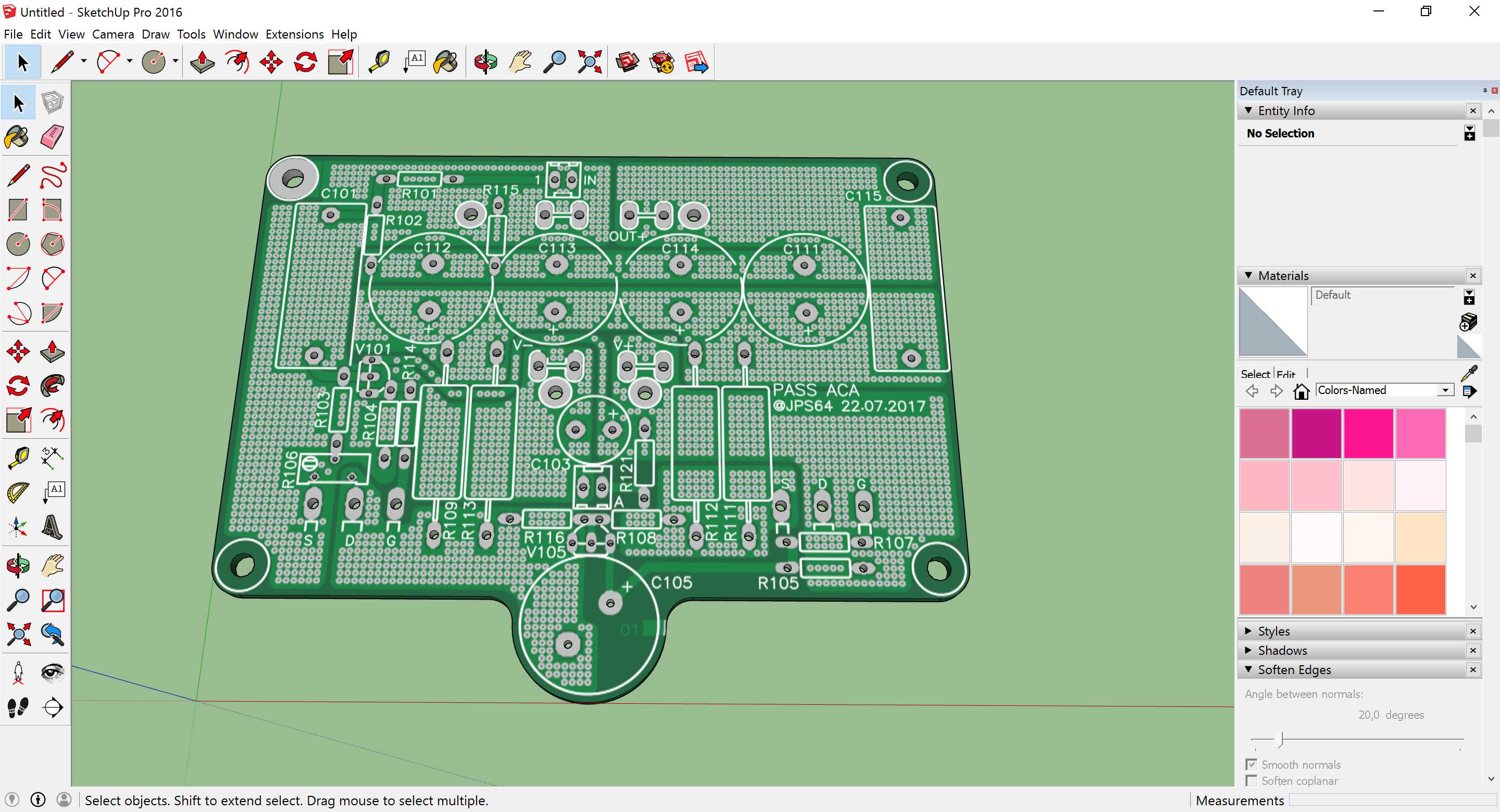

Just wanted to remind folks that if they are interested in a state of the art implementation of the ACA, JPS64 has a very nice board already made and ready to go. Of course, with the signature JPS64 via stitching and impeccable star ground strategy. One can pair this with the already available and proven SLB Single Rail PSU, and you have a superb SE Class A solution. The SLB uses an Aksa developed CFP topology cap Mx, which has been shown to achieve 1mV rms ripple at a load of 3A and 37v.
Plus the SLB SR PSU:
The SLB SR is convenient in that it has flying leads with quick connect to allow easy mounting of the power transistor. Also, two boards makes for more flexible mounting options.
