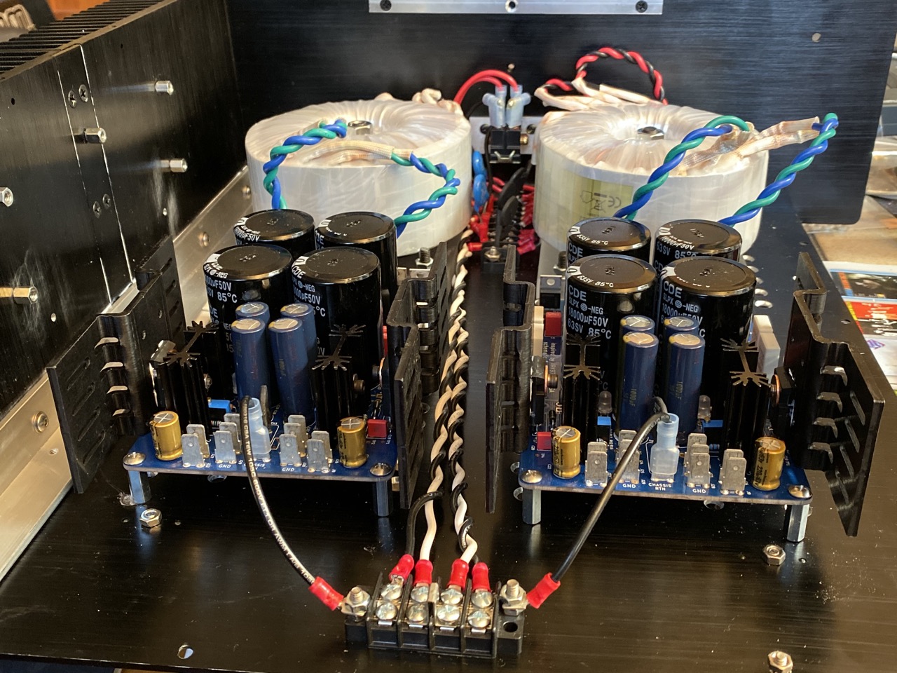

Here are a couple SLB supplies getting ready to power up an F6. I had two Antek AS-3222 transformers on hand, and have been getting a solid +/– 26.1V into a 1.7 Amp (15 Ohm) dummy load. The actual amp will probably draw less current to manage heat, but I'm still shooting for about 1.55 Amps to tickle a set of FQH44N10 Mosfets.
I have a 500VA 24v transformer on hand, can it be used comfortably for this project?
If I can get 28.5v with a 600VA, you might be able to manage 26.5v to 27v with a 500VA. So yes, I think it can work!

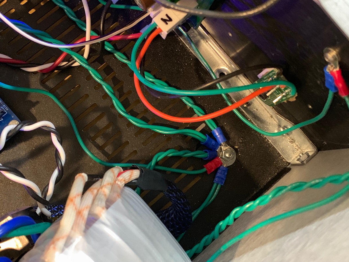

Hello and please forgive my ignorance.
In a number of build pictures with the SLB and various Alpha amps, I see people are running ground lines to the chassis heat syncs. What is the purpose of doing this?
In particular, Vunce's wiring of the Alpha Nirvana here, it looks like he has a double twisted ground wire from the SLB board to the chassis bottom, a double twisted wire from the IEC plug to the chassis floor (hard to tell in the picture), then a ground line from each audio board to the heat syncs. I can't tell where those heat sync ground lines go from there, but it looks like they may be also connecting to the chassis ground on the floor of the amp. Why are the audio board grounds not connecting back to the power supply star ground lugs?
What is the second double twisted ground line going to the chassis rail for?
When I built my M2 and Aleph J with standard CRC power supplies. I had a ground from the IEC plug to the chassis, a ground from the power supply to the chassis lifted by a CL60, and the audio board grounds ran back to the power supply ground plane. I am confused by these additional grounds tied to different points of the chassis.
Thanks for anything you can do to aid my understanding.

Those green wires are PE, protective earth, "ground" for the chassis and are different from the RETURN (aka ground in the US) of the DC power and audio signals. I think it's awesome to see DIYer using that type of PE wiring. It is common practice for high wattage power supplies to have PE connection to each panel.

Hi Aljordan,
The main idea is to have all things like chassis and heat sinks (parts of chassis) to go to IEC earth/mains ground. This is not only for safety in case something goes and conducts live to ground, it is all safely shunted to earth/mains ground. But also for reducing RFI pickup, tying chassis and heatsinks to ground makes for a quieter amp. The heatsinks if not grounded can act as a capacitor with the MOSFETs and add noise or oscillation. So we to them to a convenient earth ground point on the chassis. A double twisted wire to reduce impedance.

Regarding 0v analog and power ground, this is lifted from the “PE” protective earth or (dirty) earth/chassis ground by an NTC (CL60 or 8D-20) and bypassed with a 22nF film cap. This is provided on the SLB between the clean 0v analog and power ground and the “PE” power and protective earth ground connection which goes to the earth/mains/chassis ground point.
You want to control where all your ground points touch or connect. Using a star topology helps prevent hum/buzz.

On some amps (like M2X) I found that having the RCA jack ground go to the SLB star hub was quieter. Similarly, having speaker return go to the SLB star hub was quoted on M2X as well. But on Alpha Nirvana, which has a 10ohm ground lift for the input audio, and a few other ground nodes, it seems RCA ground should go to the amp itself.

The heatsinks in my Proto build are resting on wood and therefore have no continuity to ground, that is the reason I ran a wire from the ground lug to each heatsink. When using a proper metal chassis, all panels and heat sinks will be grounded so there would be no need for the individual direct wires.
Hope that helps clear up where some wires go in my spaghetti mess 😀
