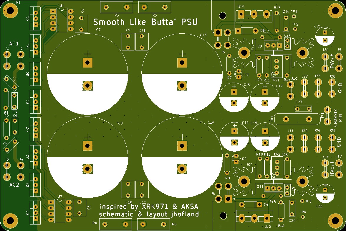

It’s been brought to my attention that some of the pads on the SLB near the PE NTC and capacitor seem to be contaminated or something - so solder is having a hard time wetting the pads. Please let me know if you run into similar issues. Note that this board is thick 2mm and has thick 2oz copper solid pours. It needs a big iron and a big chisel tip to fully melt the solder.

Sorry, X - in terms of the dual rail SLB (PCB image attached), where is the "PE NTC and capacitor" located?
Andy

The pinouts for J6 & J14 don't make sense to me.
After some testing with the ohmeter:
Looking into J6 (female on the PCB)
Pin 1 or 3 can go to the base of 2SC5200
Pin 2 goes to the collector
Pin 3 goes to emitter
Then the same is true for 2SA1943?
Actually ignoring the J6 J14 schematic and looking at the print, it makes sense, but looking at those with pins to J17-18-19-20 etc, is just confusing as hell for us newbs lol
JT
JT
This is tricky and the best way to do it is to use an ohmeter between the pads for where the pins would go if they were PCB mounted in the underhung position, and check the Molex jack for continuity. Note that two of the pins are parallel (redundant). If you look at my photo above, you will get a sense of what I am talking about. Even if you followed the schematic, the final double check by eye needs to be done with an ohmeter just like I describe above.
