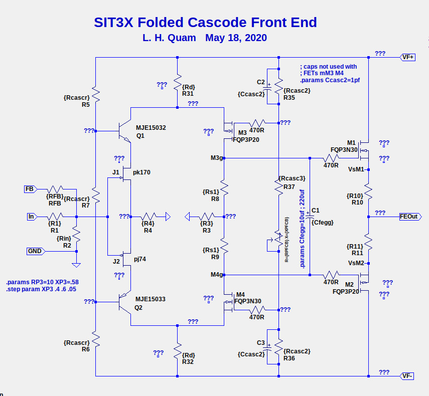

Going back to around post #184 SIT measurements, Mu Follower, and amplifier build in the "SIT measurements, Mu Follower, and amplifier build" thread, I have been trying to get the folded-cascode FE to work with FQP3N30, FQP3P20, and alternative TO-120 BJTs for the cascode transistors. I can get good results with the FQP and the 2SA1837 2SC4793 BJTs, but not with TIP31C, TIP32C, MJE15032 and MJE15033 BJTs. Bummer. Of course the problem could be with the SPICE models. I have not yet tried the alternate BJTs with the 2SJ313 and 2SK2013.

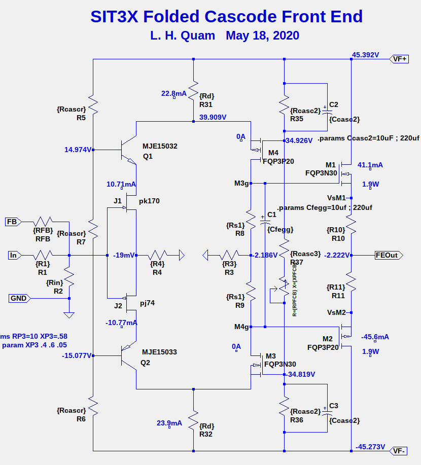

I found the problem(s) with using the alternate BJTs in the folded-cascode FE.
First some important facts. The transistors in the 2nd stage of the circuit (before the FE output FETs) are not cascode transistors. They operating common-base (or common-gate) voltage gain devices, and consequently will not behave quite the same as in cascode mode.
I discovered 2 things wrong with the 2nd stage:
Better yet, use FQP3N30 and FQP3P20 FETs in the 2nd stage instead of the BJTs, as shown below:
- A capacitor (10uF is enough) is needed between the gates of the FE output FETs.
- Capacitors (10uF is enough) are needed between the bases of the 2nd stage devices and the rails.
Eureka! This all makes sense. Especially the extra caps C1, C2 and C3 to help stabilize the bias voltages.
I would tend to use a larger value, up to 220 uF, for C1, and would leave C2 and C3 at 10 uF.

We seem to have arrived at the circuit previously discussed in post #179SIT measurements, Mu Follower, and amplifier build of the original thread. At the time we were considering other alternates to the 2SK2013/2SJ313. The common base / cascode devices might also be ZVN3310A/ZVP3310A, which are small and readily available.

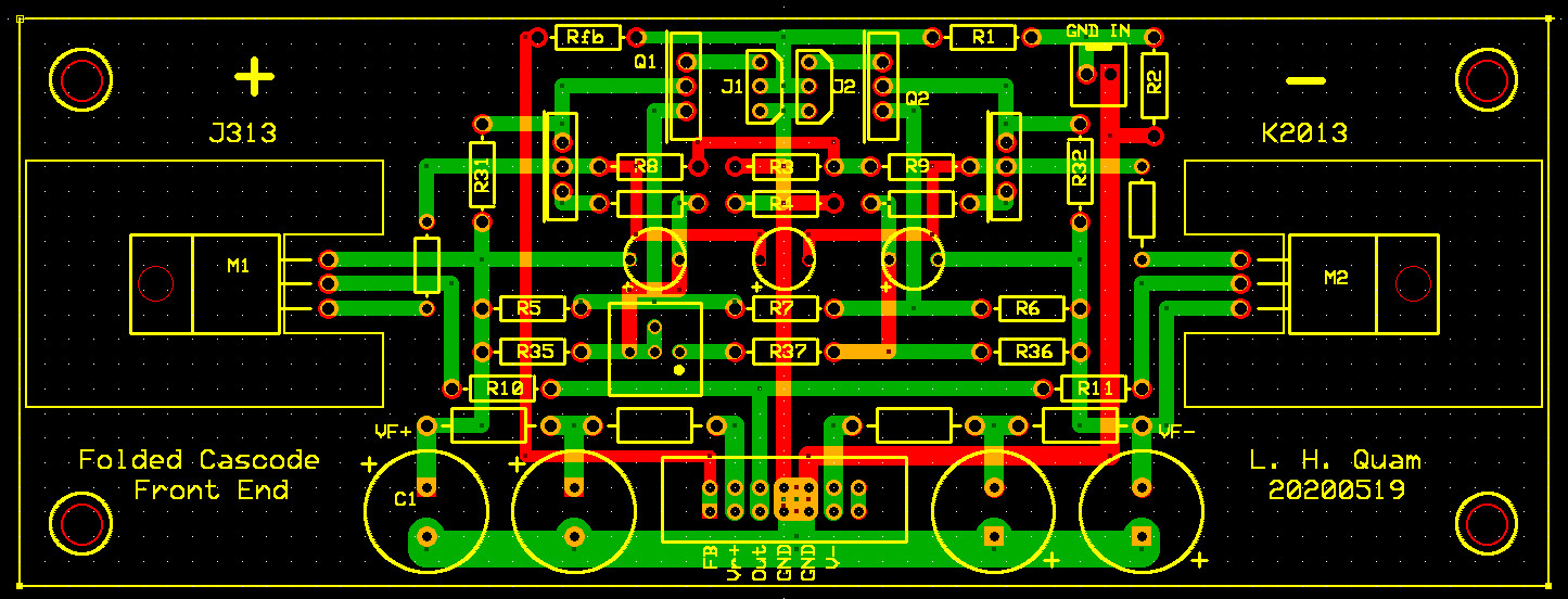

The FQP3N30/FQP3P20 FETs are cheap ($0.90US), readily available, and more than adequate for the job, but the 2SK2013/2SK313 are even better. The transistors on the JFET drains can remain as BJTs and only dissipate about 300mW. The 2nd stage transistors can be either BJTs or FETs, need to have Vce (Vds) of 80V, and dissipate about 600mW. There appear to be advantages with FETs. With TO-220 devices, the same PCB layout allows either BJTs or FETs as the 2nd stage devices, with some changes to resistor values.

You are probably right about cascode vs. common-gate. After thinking more about the folded-cascode FE, the primary difference in operation between the 1st stage and 2nd stage cascodes is the voltage gain. There is essentially no voltage swing on the drains of the 1st stage BJTs, but a voltage gain of about 10X from the input on the 2nd stage transistors. This could explain why a broad range of BJTs are acceptable in the 1st stage, but not the 2nd.

When you go to build this with fets in the folded cascode, include the option of
gate resistors.

What about gate resistors on the FE output follower FETs?
