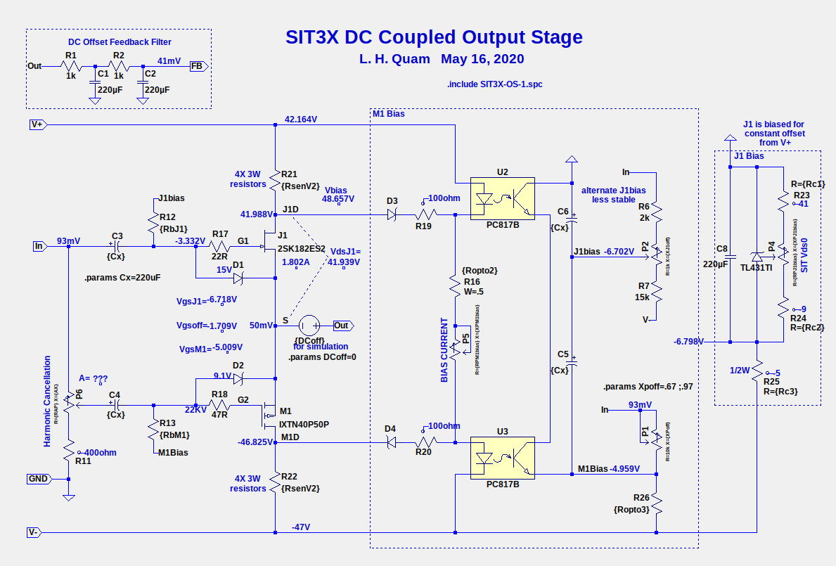

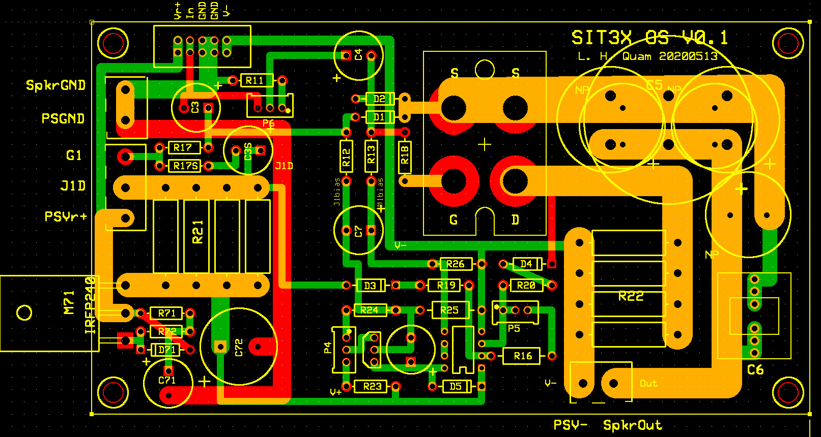

I have PCB layouts I was about to send out for fabrication. Then I discovered some circuit modifications that would eliminate the output capacitors as follows:
I do not know if this change will really improve anything or not, but it is an interesting result. I am still making tweaks and I will post the circuits soon.
- Add low pass filter of the OS output to create a DC offset FB signal.
- Add one resistor from the FB signal to the JFET gate node of the folded-cascode FE.
- Several minor modifications are required for the J1 and M1 bias circuits.
I guess not.
Whatcha think? Is it really worthwhile to pursue eliminating the output caps with the risk of having possibly poorer bias stability?
I don’t mind output caps so much. The DC feedback into the front end might cause more problems than the one it is trying to solve.
Which of the PSU configurations is recommended? I was already working on a 90V supply for the Singing Bush, so it would be straightforward to convert to –90V. Or I can still use that Antek 1000VA transformer with quad 34V secondaries for +/– 47V.
I am planning on the +/-47V supplies with the simple cap. multiplier on V+, but the OS circuit and PCB can be used either way. If you go for a single -90V supply then the FE with need its own power supplies, and the OS PCB will require a few different caps and a jumper around the cap. multiplier. I see no advantage with the -90V version.
Then it is +/– 47V. The cap multiplier on the positive rail should keep the FET sources at a negative voltage as the bias begins to stabilize. I would still use 50V electrolytic output cap(s), but don't see a need for bi-polar.

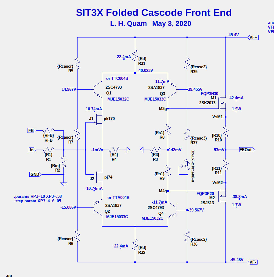

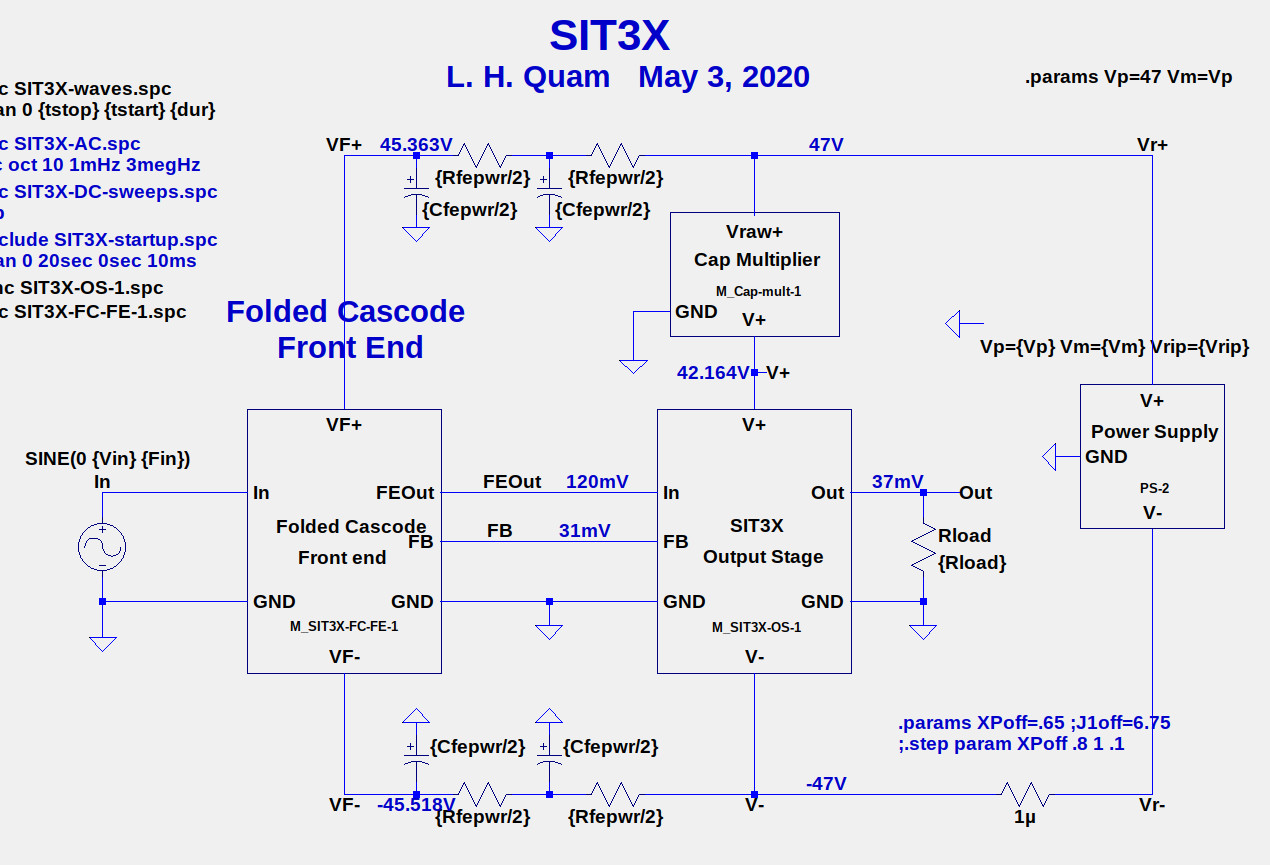

What is your plan for the FE power? Last I saw, it was using +/– 45V.
I use a simple 2 stage RC filter of the main power supply voltages as shown here, where
- Rfepwr=22R
- Cfepwr=2.7mF 50V

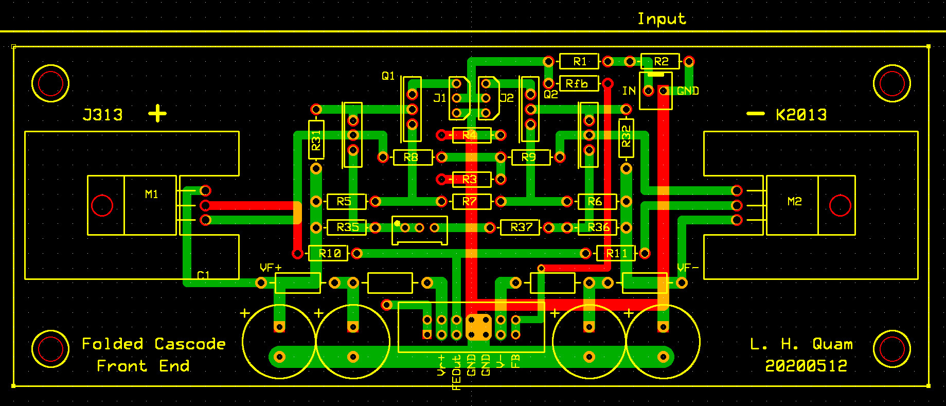

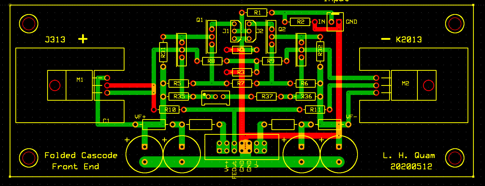

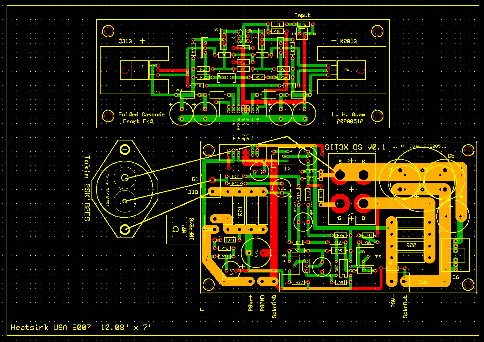

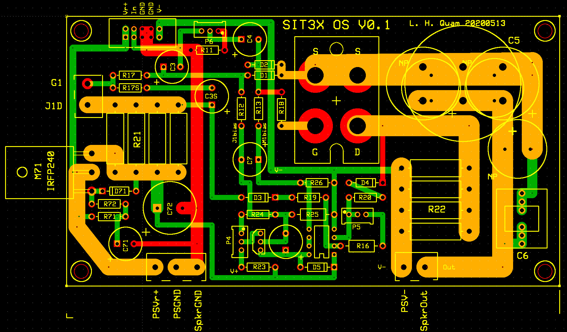

Here are the current PCB layouts for the non-DC coupled version of the SIT3X. You will see the the folded-cascode FE board actually has the DC feedback provision, but it does not need to be used.
Unless errors are detected, these are ready for fabrication.
