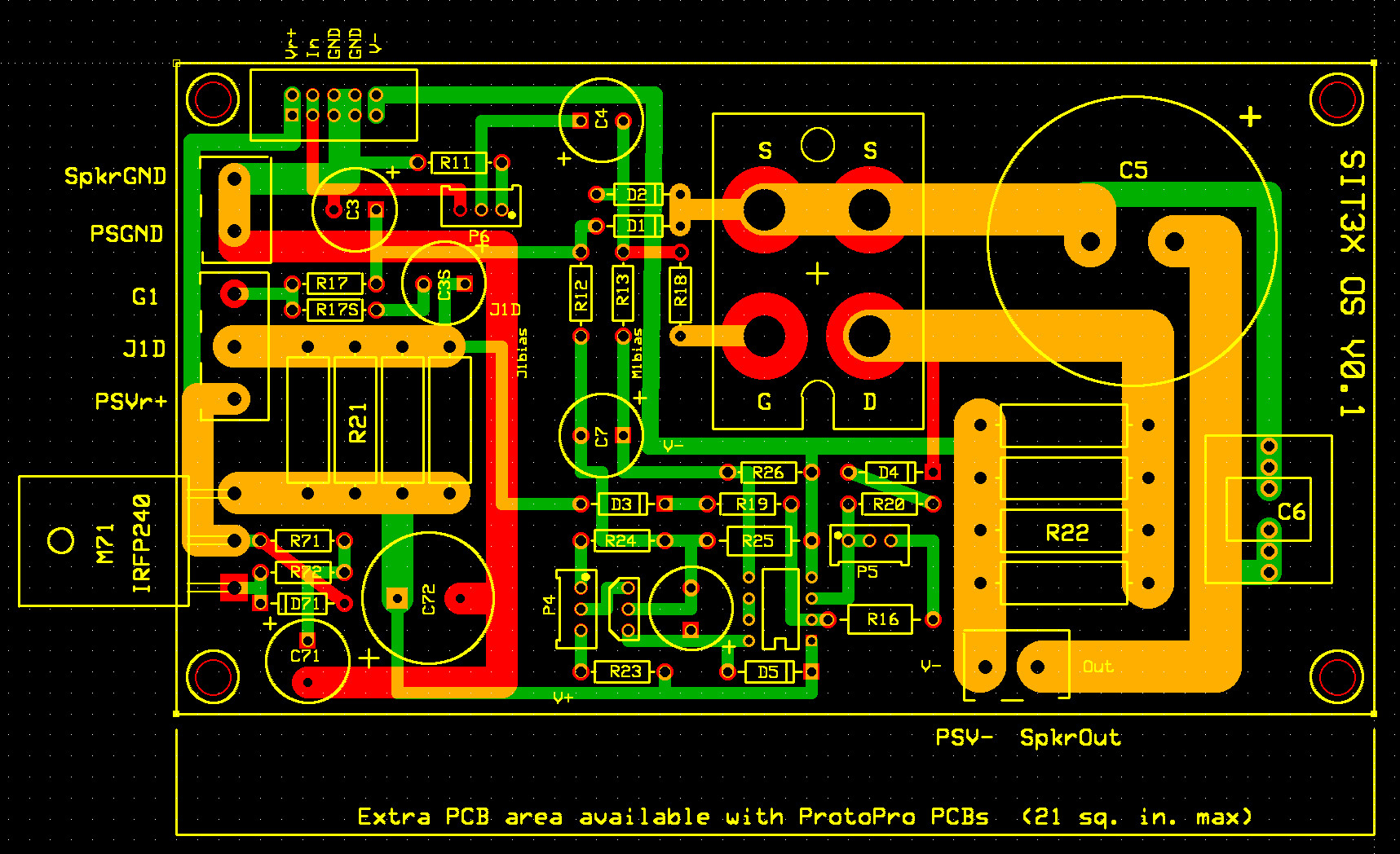

My PCB fabricator (ExpressPCB.com) has a size limit of 21 square inches for the ProtoPro category of boards that I order. The PCB is currently 5.5" x 3.1" = 17.05 square inches, so there is room to expand it a bit. However I view that extra space as for emergency use.

Here is a PCB layout expanded 0.2" horizontally, and showing the extra space available at the bottom at the 21 sq. in. limit. Other trade-offs are available, such as making it wider to the left. Clearly there is a fair amount of room available if there is a really good reason for it.

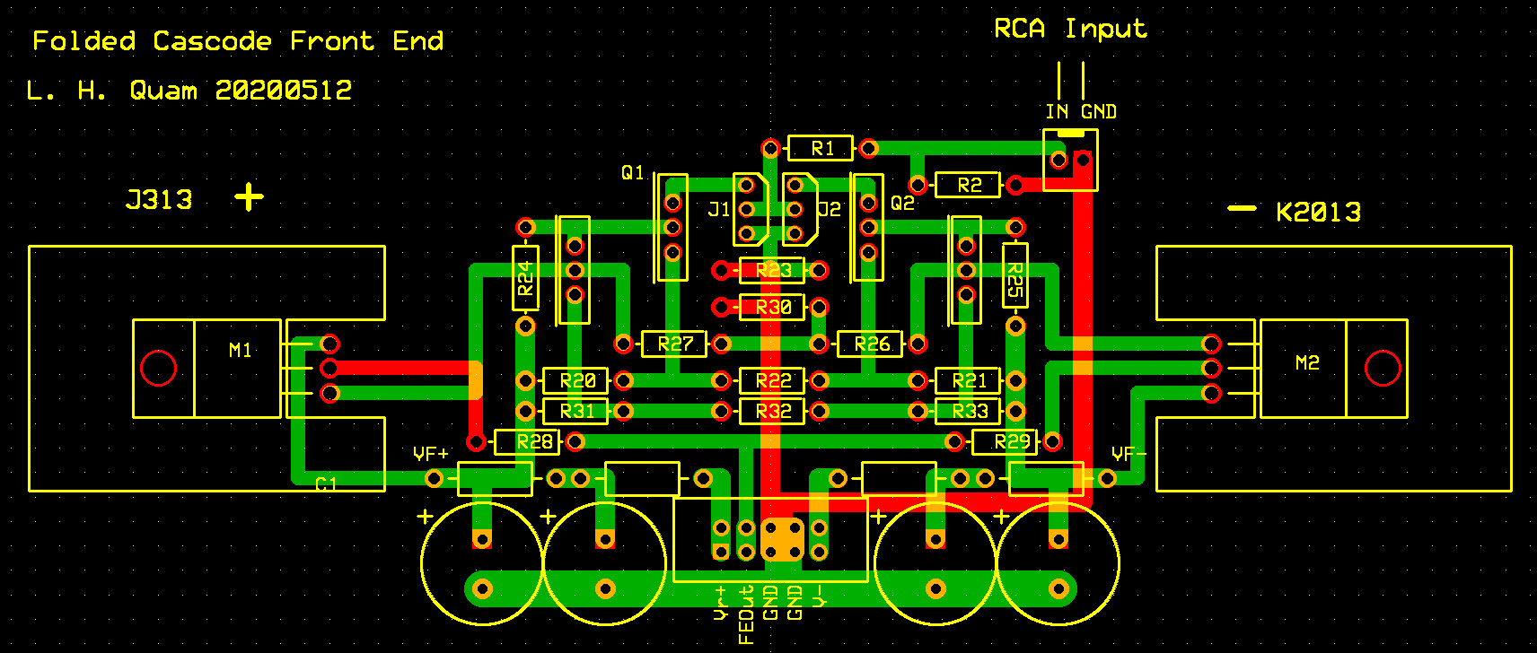

Shade circuit & IXYS NFET
Is the plan for the board to accomodate both the 2SK182ES circuit and the alternative Shade circuit/IXYS NFET?

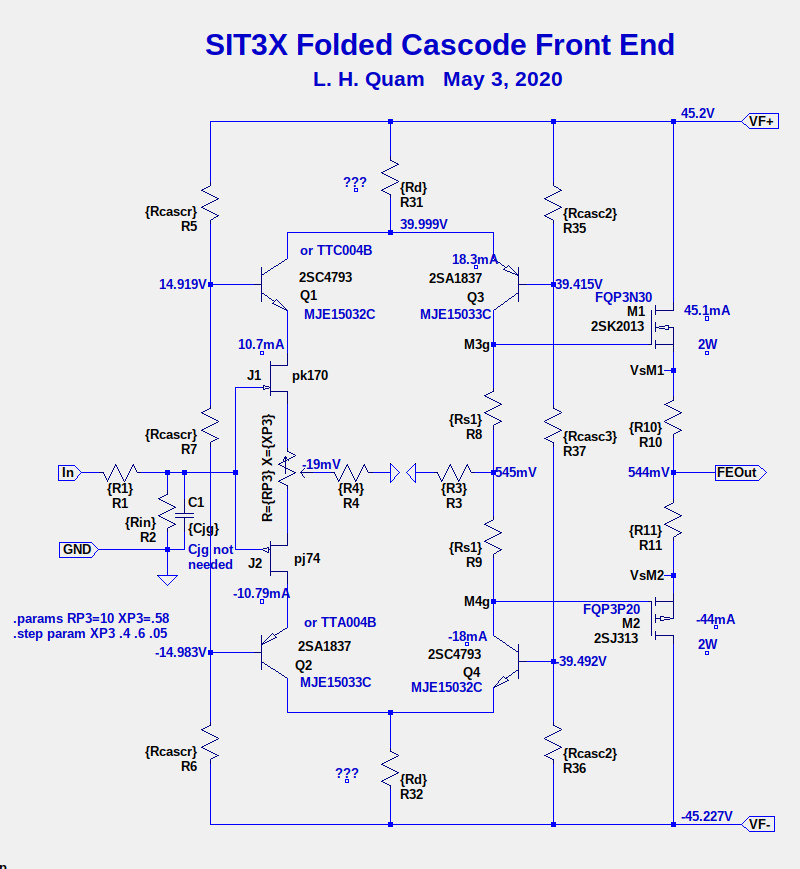

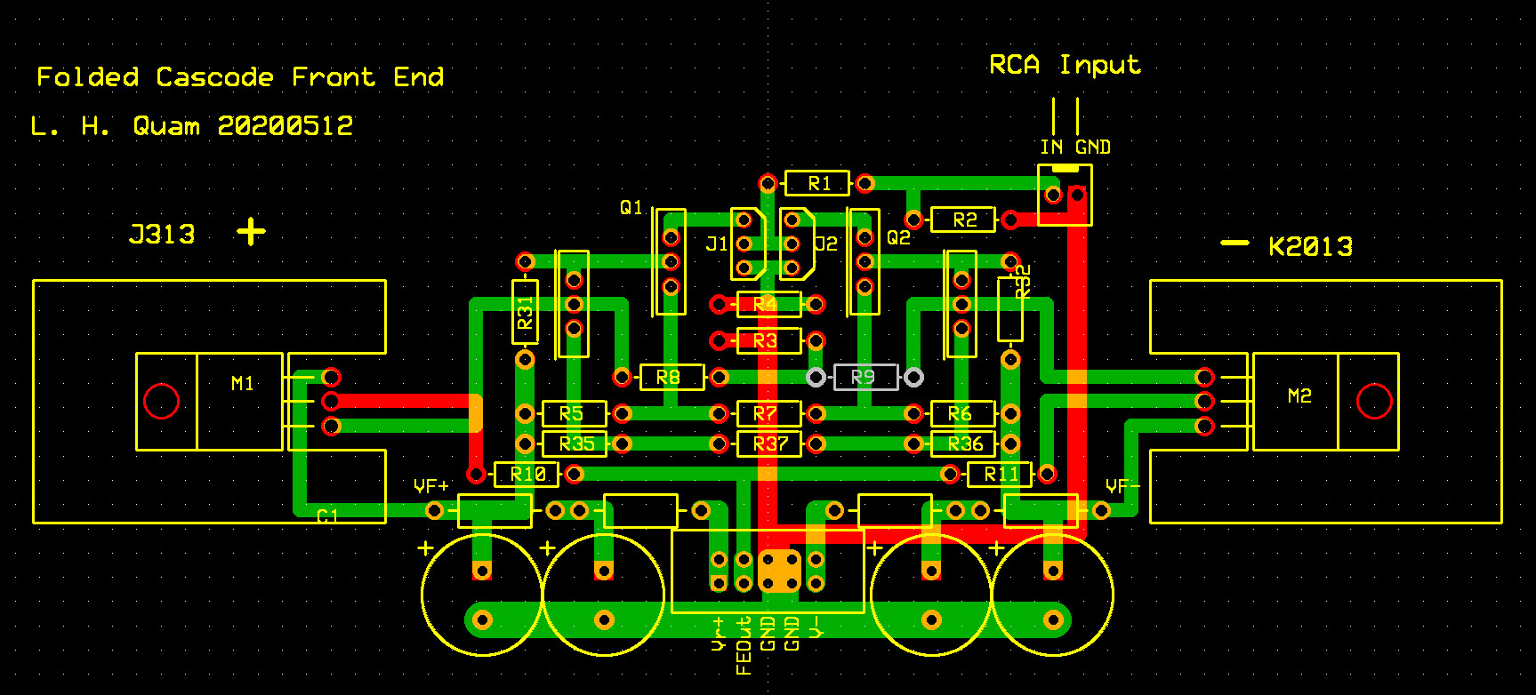

You are right. There need to be pot adjustments associated with with either R8 and R9 or R31 and R32.How is the Vgs bias set for M1 and M2?
Maybe one pot with R37 would do it.

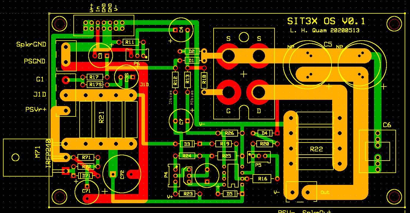

The SIT3X output stage can be used in two modes:
Is a pair of 4.7mF capacitors preferable to one 10mF capacitor?
Below is a PCB layout that permits either choice.

What should used for the output capacitor? Option 2 clearly calls for a 50V or higher electrolytic. For option 1, would a 10V non-polar capacitor be preferred to a 50V electrolytic?

First let me thank you for sharing all your work with us. Outstanding job, as usual.
I am not a wizard, but according to the Richard Marsh/Walt Jung cap research back in the 1980s, we should allow on the board bypassing of the large electrolytic cap with 10 mf+ 5 MF+ .5 MF Polypropylene and Polystyrene caps. Lately most people are using just one 5 MF Polypropylene, but we should have some space for bypassing.
Your question was about one or two caps and I am guessing two caps are better than one, but the cap choice may be more important than how many, ripple current, ESR, other parameters that I don't fully understand are in play.
Thanks again for sharing,
Rush
This is going to be a can of worms. The only non- or bi-polar electrolytic caps that I trust are the Nichicon ES series. Unfortunately, these top out at 1000 uF. That's why you don't usually see the bi-polar parts being used for speaker output coupling. The recommended minimum voltage rating would be 16V, and 25V would be better.
Polar electrolytic can be Nichicon KW or KA for wire leads, or Nichicon KG and KS series for snap-in leads. I think it's Ok to use either a single 10,000 uF or a pair of 4700 uF parts. Most folks will want to bypass these with high-quality film caps, though I have gone both ways (w/ and w/o) on this.
I would think the -94 volt supply could use a 100v polar cap. The +-47 needs non-polar.
