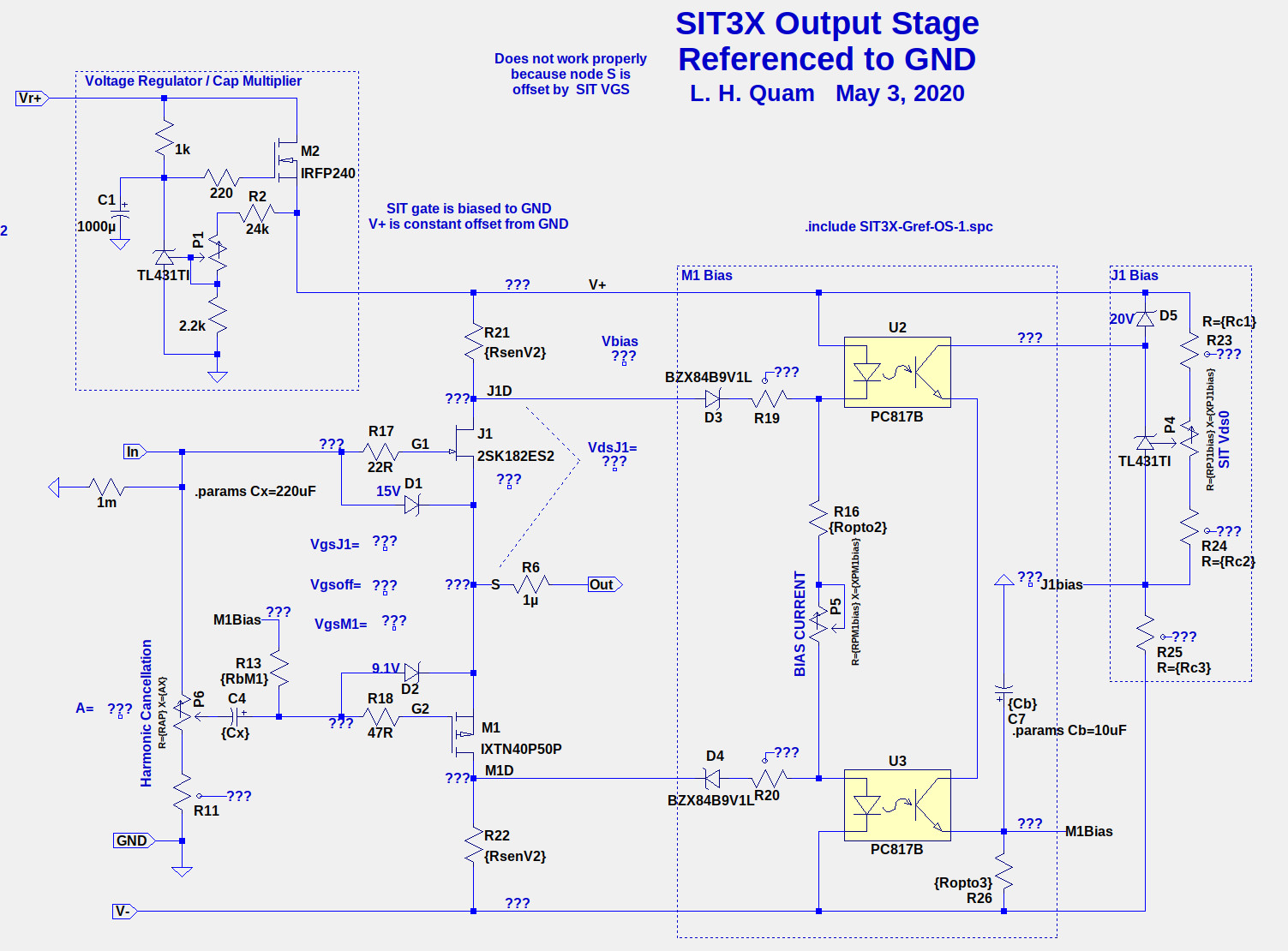

My guess is that the main issue with bias current and tempco would be with the optocoupler LEDs. The TL431 is controlling the (idle) Vds of the SIT, where is little bit of drift isn't a big deal.

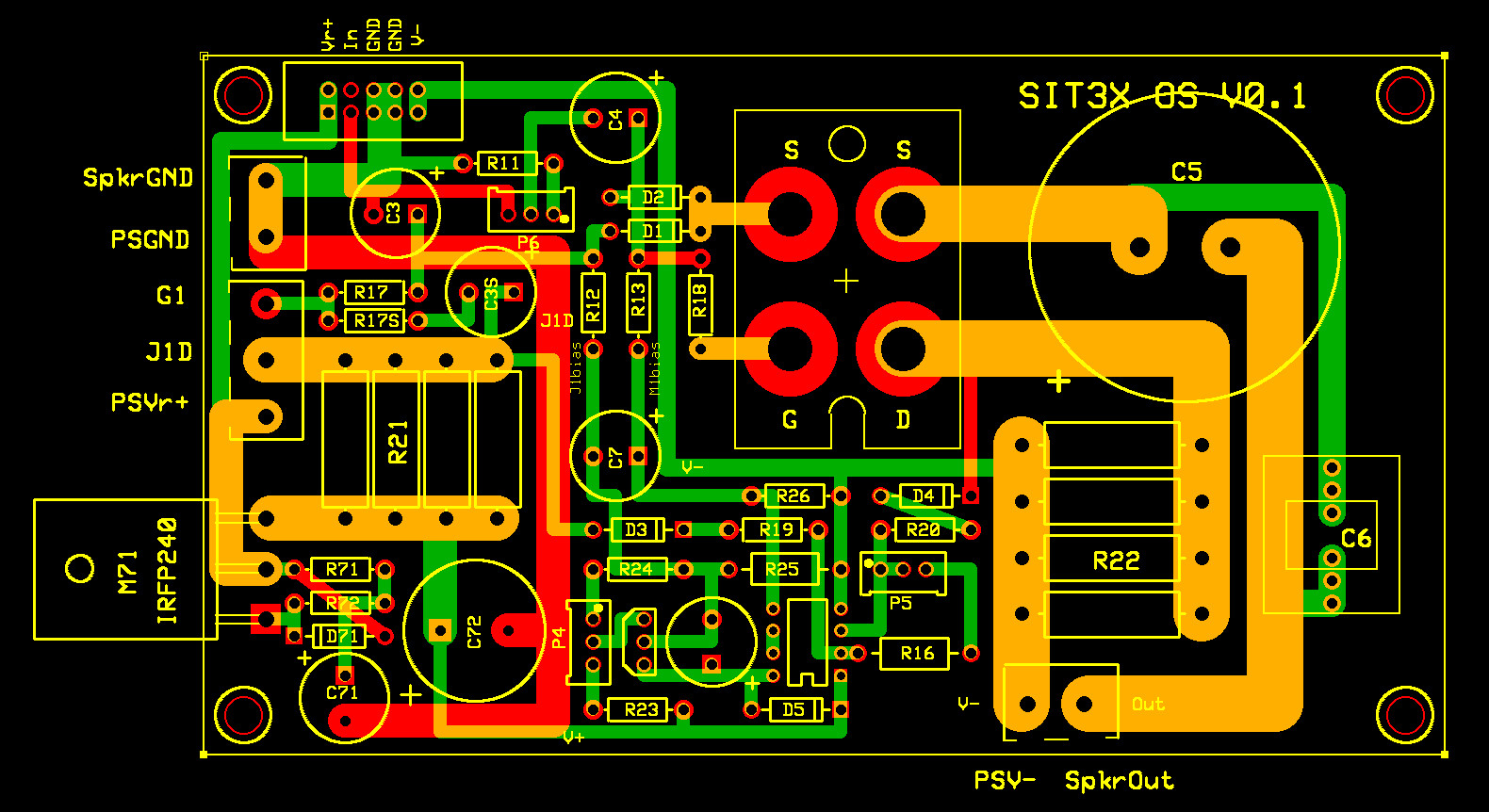

Here is a first cut at a PCB layout for the OS board, including the cap multiplier.

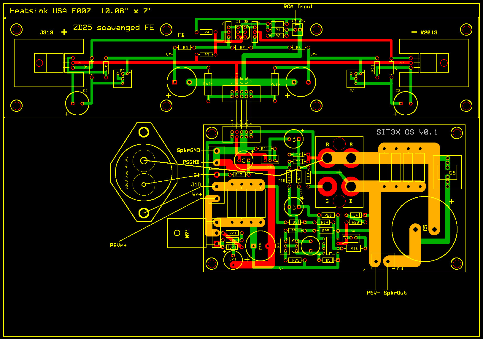

The second image shows how I intend to place the OS, FE, SIT, and PFET on the heatsink. The FE board is a "scavenged" version of the FE that I used in my ZD25 approximation of a XA25. The layout shown hasn't received much polish.
The OS board could probably be cleaned up by making it narrower and taller.
It might be convenient to have some voltage adjustment at the output of the cap multiplier. That would allow different Vds settings for the SIT, independently of the Vgs bias.

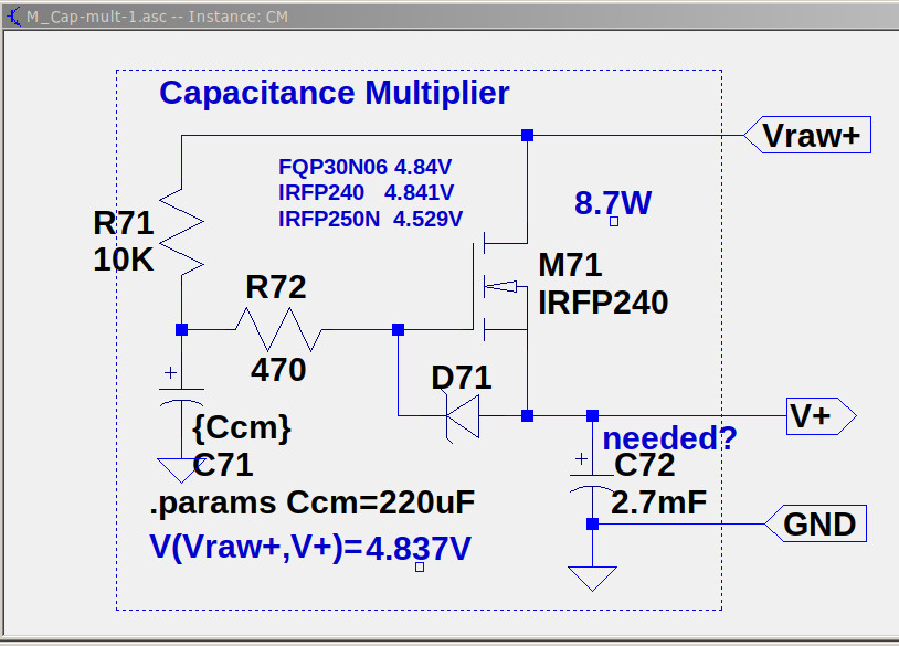

Funny that you mention that. Here is a variable voltage cap multiplier circuit I tried, with the intent to eliminate the output OS output caps, and the input cap for J1. The cap multiplier was good, but the V(Out) will be V(FEOut)+ Vgs(J1). In order to make this work would probably require an output offset servo controlling the output offset of the FE, which introduces more complexity and potential problems.
Probably best to leave the final output coupling cap in place then. The intent is to allow a little more variation in the SIT parameters to get some harmonic cancellation with a greater range of devices.
Those output caps eat up a lot of real estate on the PCBs. That's ok.
I have been playing with the Shade circuit with an IXYS NFET in place of the 2SK182ES. It only requires adding 1 resistor and 1 cap to the PCB, and reversing 1 zener. I ran simulations and only a couple of minor parameter changes were required to get good results.

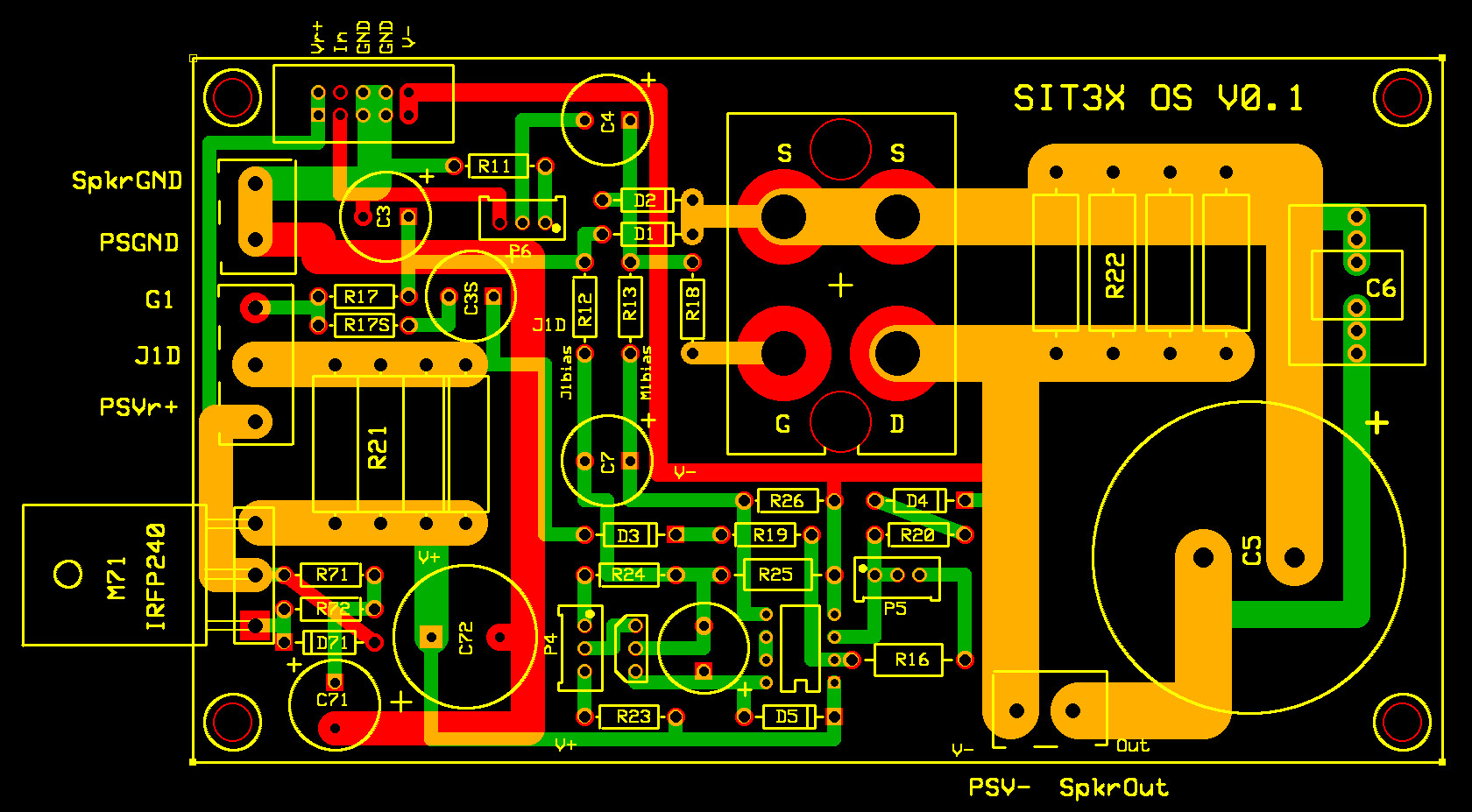

More refinements to PCB layout, including a Schade feedback option, with components R17S and C3S. The TL431 now has a capacitor across it and a polyester capacitor has been added across the output cap.

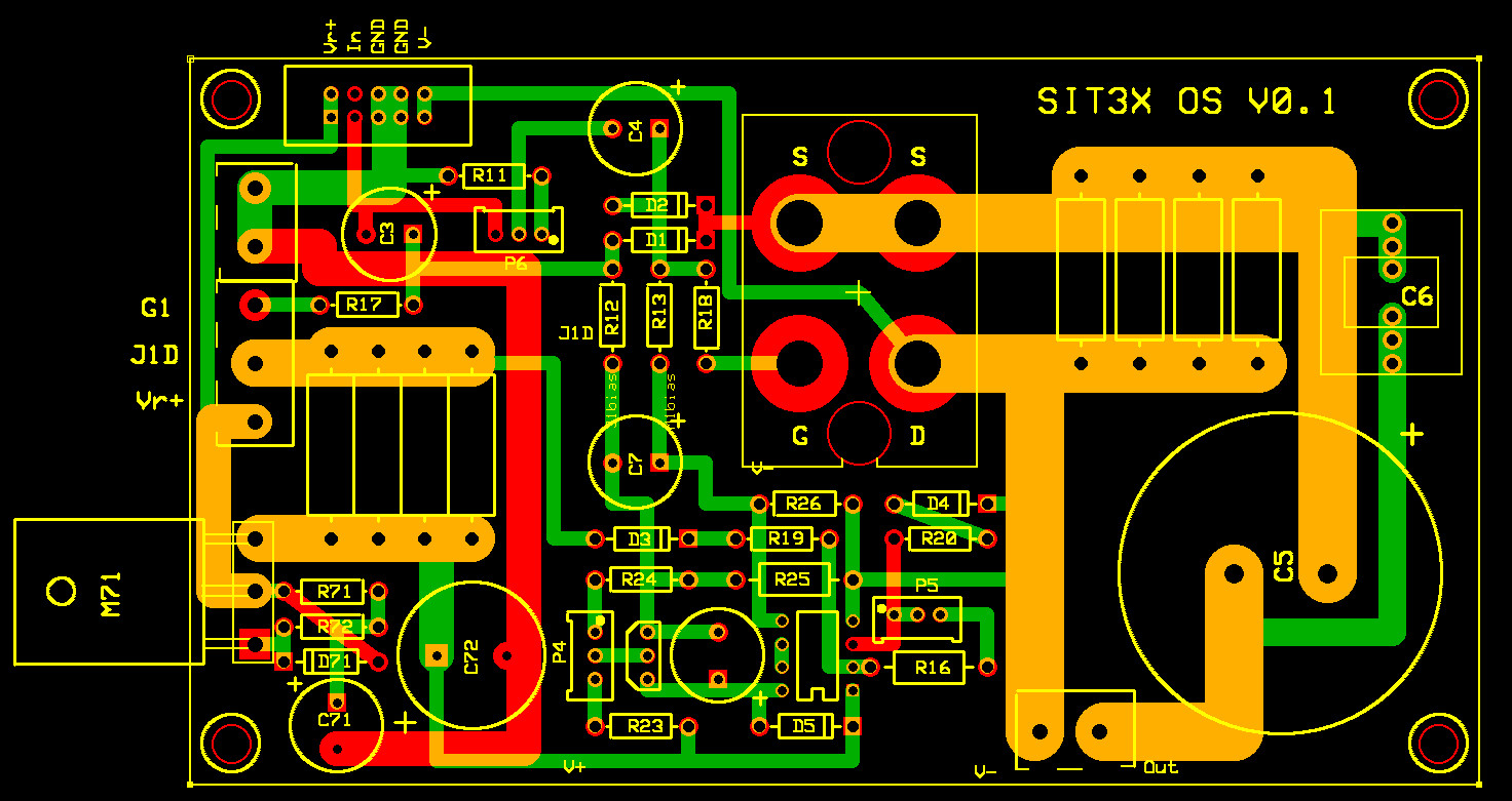

It looks bad. In a major PCB edit I totally screwed the connections of M1d, V-, and S. The stuff on the right side of the PCB must be redone. She looked so pretty, and then I discovered what she really was. 😱
Haha. Yes, more better. That sort of thing happens sometimes. I wasn’t looking closely at the right side of the board.
What is the max diameter of C5? Looks like snap-in leads, 10mm spacing?
C5 has D=35mm D, LS=10mm.
There are some issues about polarities of the input and output electrolytic caps. Originally the polarities were based on the drain of the SIT being at ground, but with
V+/V- power supplies, the nominal DC voltages across them are close to zero. With the loss of V+ headroom because of the capacitor multiplier, the source node should probably be biased negative to maintain equal positive and negative headroom. In which case, all of those cap polarities shown in my schematics and PCB layouts need to be reversed.
