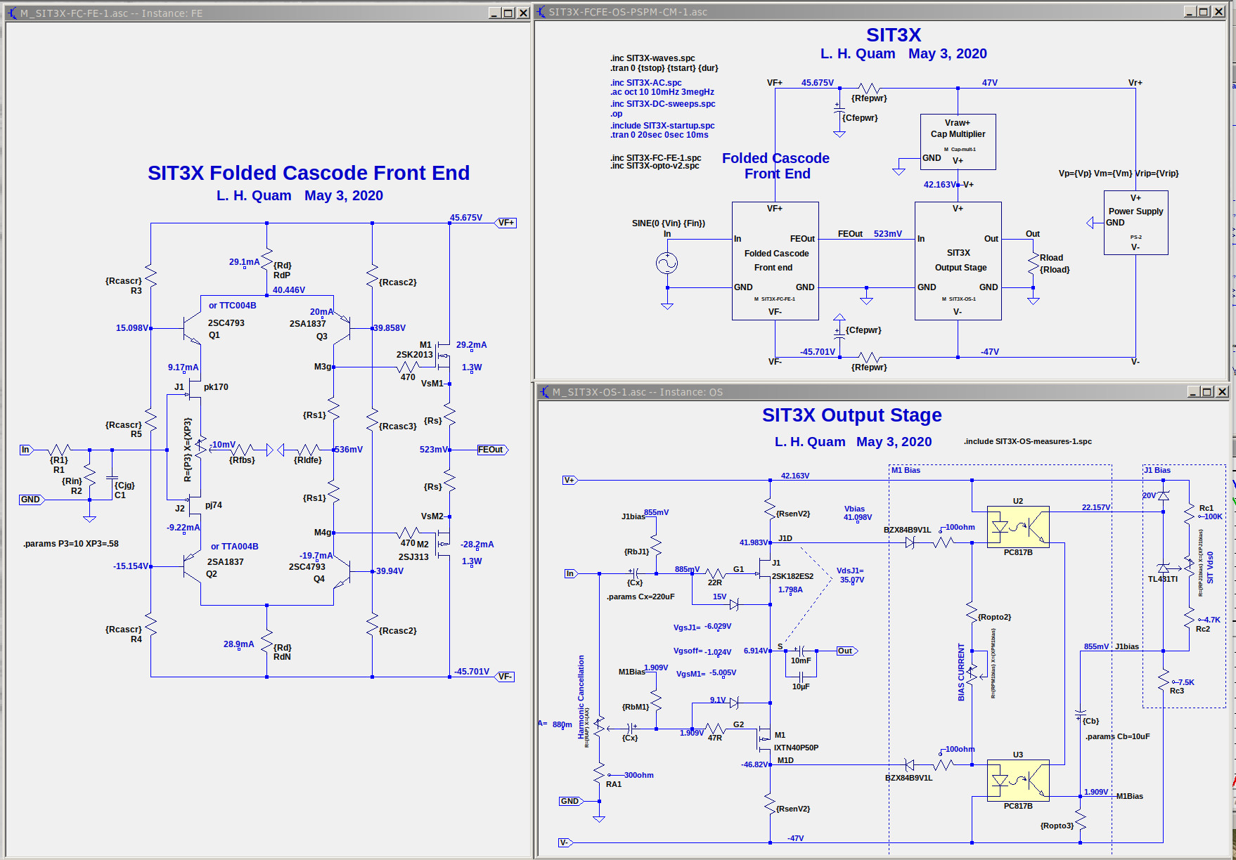

Well finally finished the SIT-3X, fantastic amp, my best, thank you Lynn
Cover is not present in the pictures

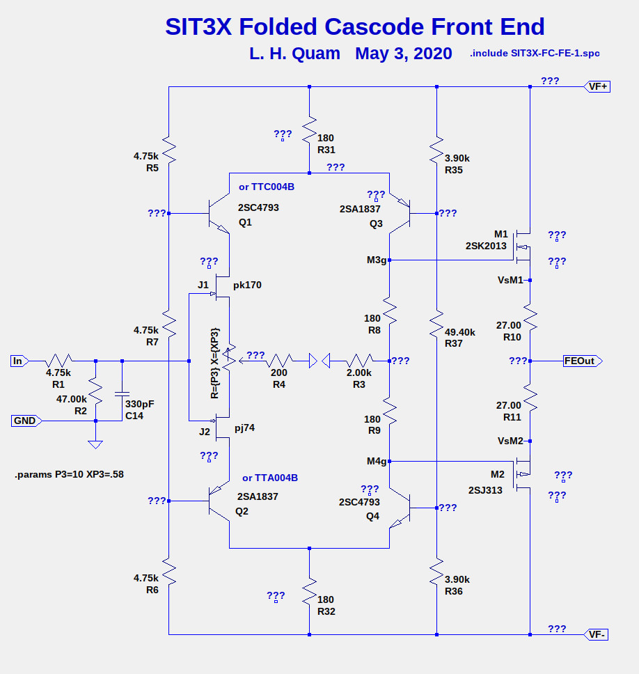

Here are some interior pictures, I settled for the build guide recommended X-pot setting as I am experimenting with some tube preamp topologies at the moment.
There is a relais start up board, and speaker protection as I had a some startup peak at the speaker.
Reactions: 2 users
There is a safety mistake in the last picture which is corrected 😉
I had LT4320 based rectifiers at one point working but they gave me some oscillation and at one point one of the 4 broke, so I replaced them with conventional diode rectifiers
