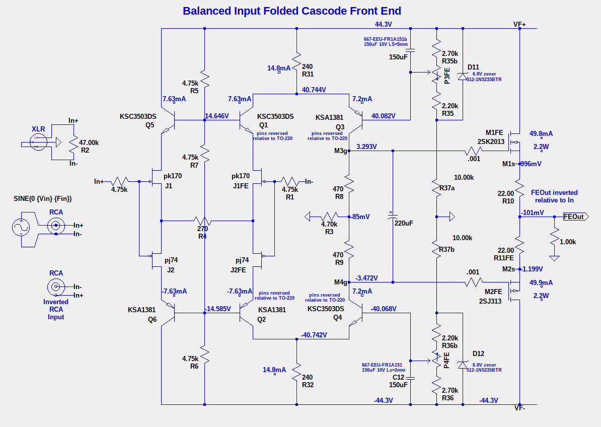

The SIT-3X Amplifier
Rush pointed out in an Email message that I posted the wrong schematic in #739, in which eliminated the cascode transistors for J1 and J2.
Here is the schematic that I intended to post.

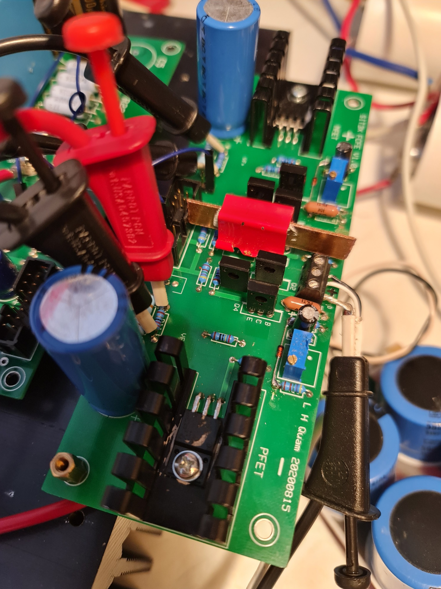

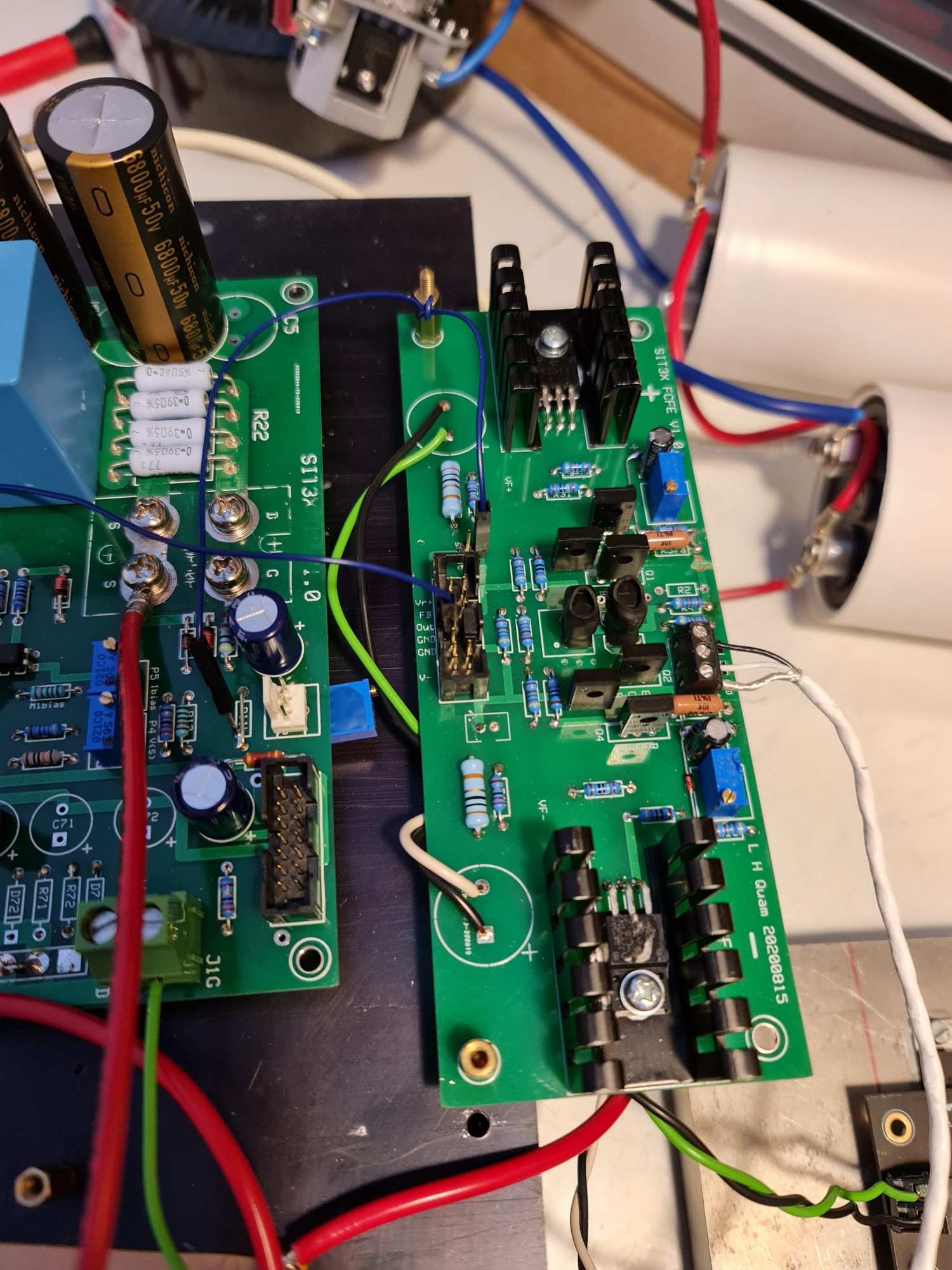

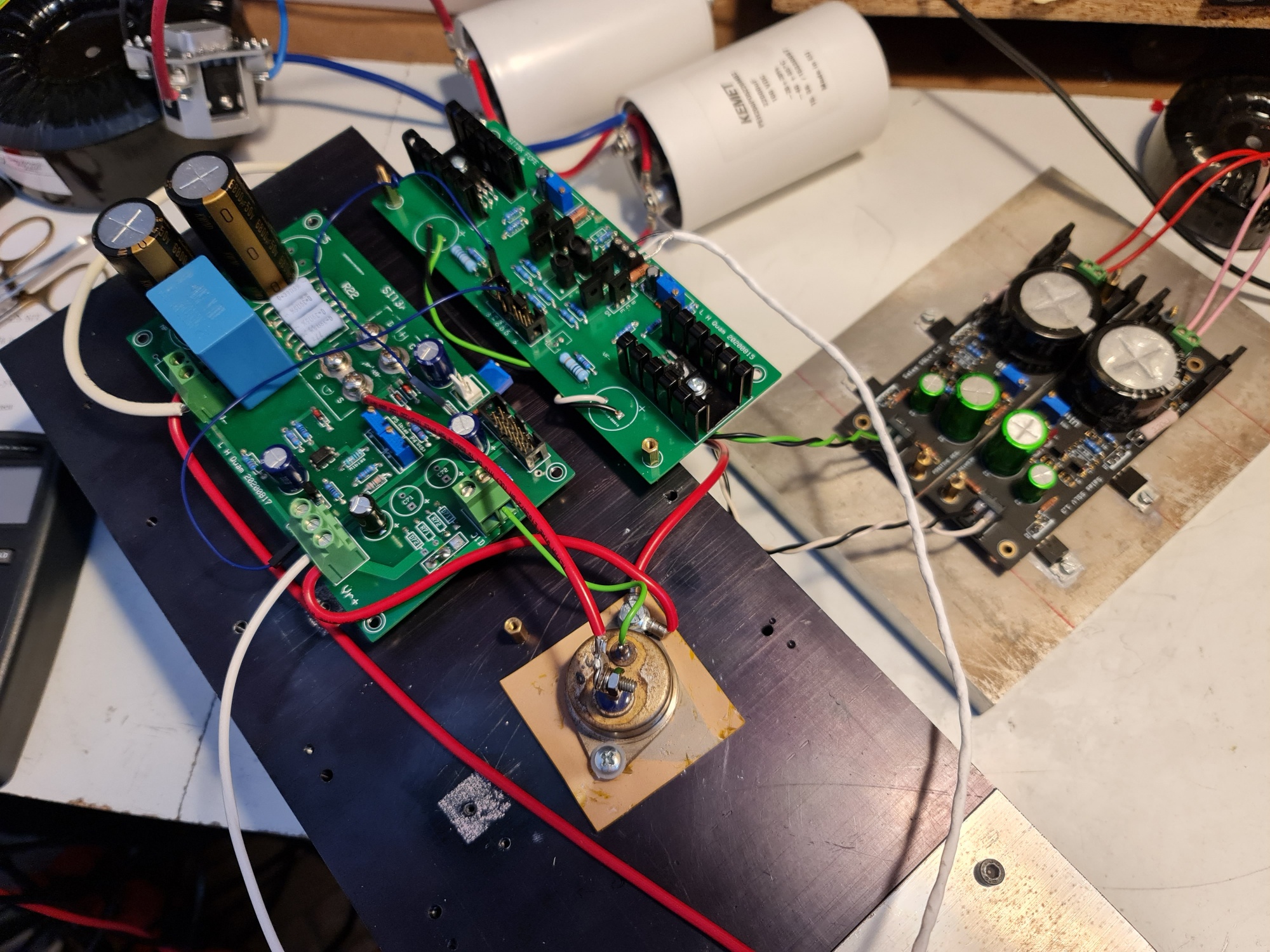

I managed to finish the Balanced version for FCFE.
It works perfectly with divine music!
And very happy that now I have no noise in the speakers, it's completely quiet. With the RCA version I had a little noise.
I still have to work on some adjustments and tests🙂

Wow, I am impressed. I didn't expect the untested balanced FCFE to work well without some tweaks, I guess I need to generate a PCB layout for it.

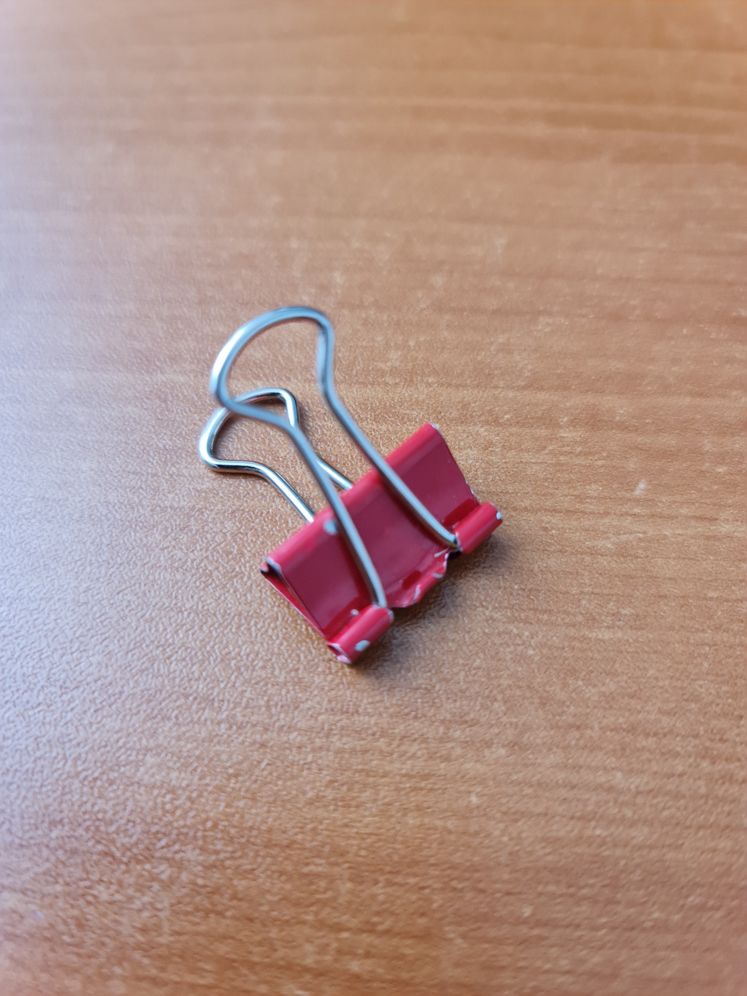

I had some problems with the drift of tensions, but after Lynn gave me some suggestions, now everything is perfect.
I put a small copper plate between the JFET and fixed it tightly with a small pliers (red piece)
Now all tensions are "dead", not changing by a hundred.
The sound is gorgeous! And once again I want to say - there is total silence in the speakers, I don't even know if the amp is on or not.
Lynn, thank you so much for this amp and for all your help!
I am going to assemble everything in a beautiful case.

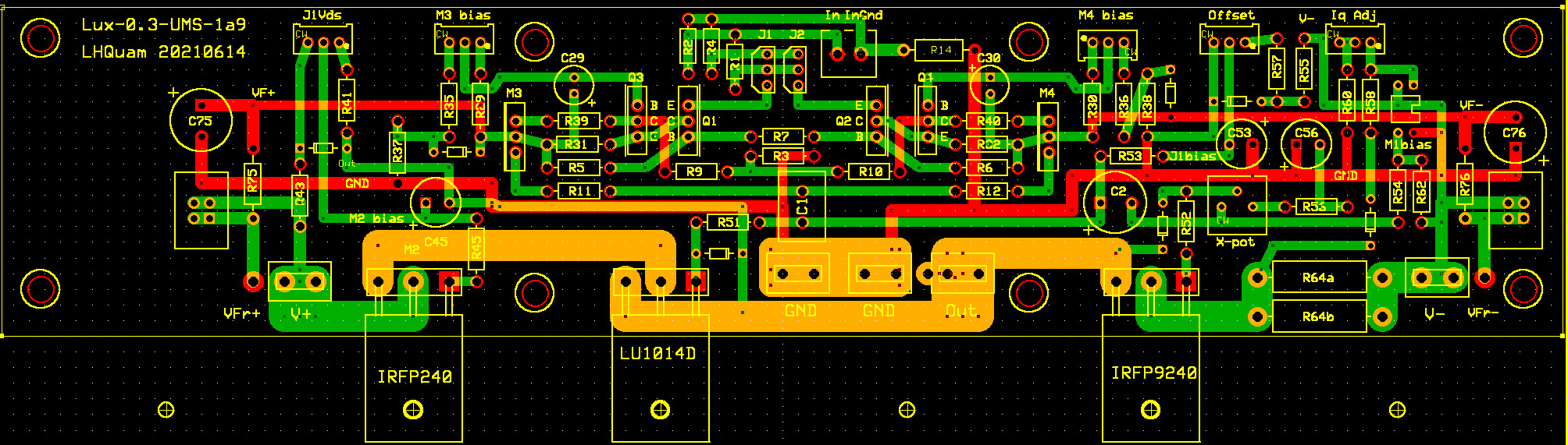

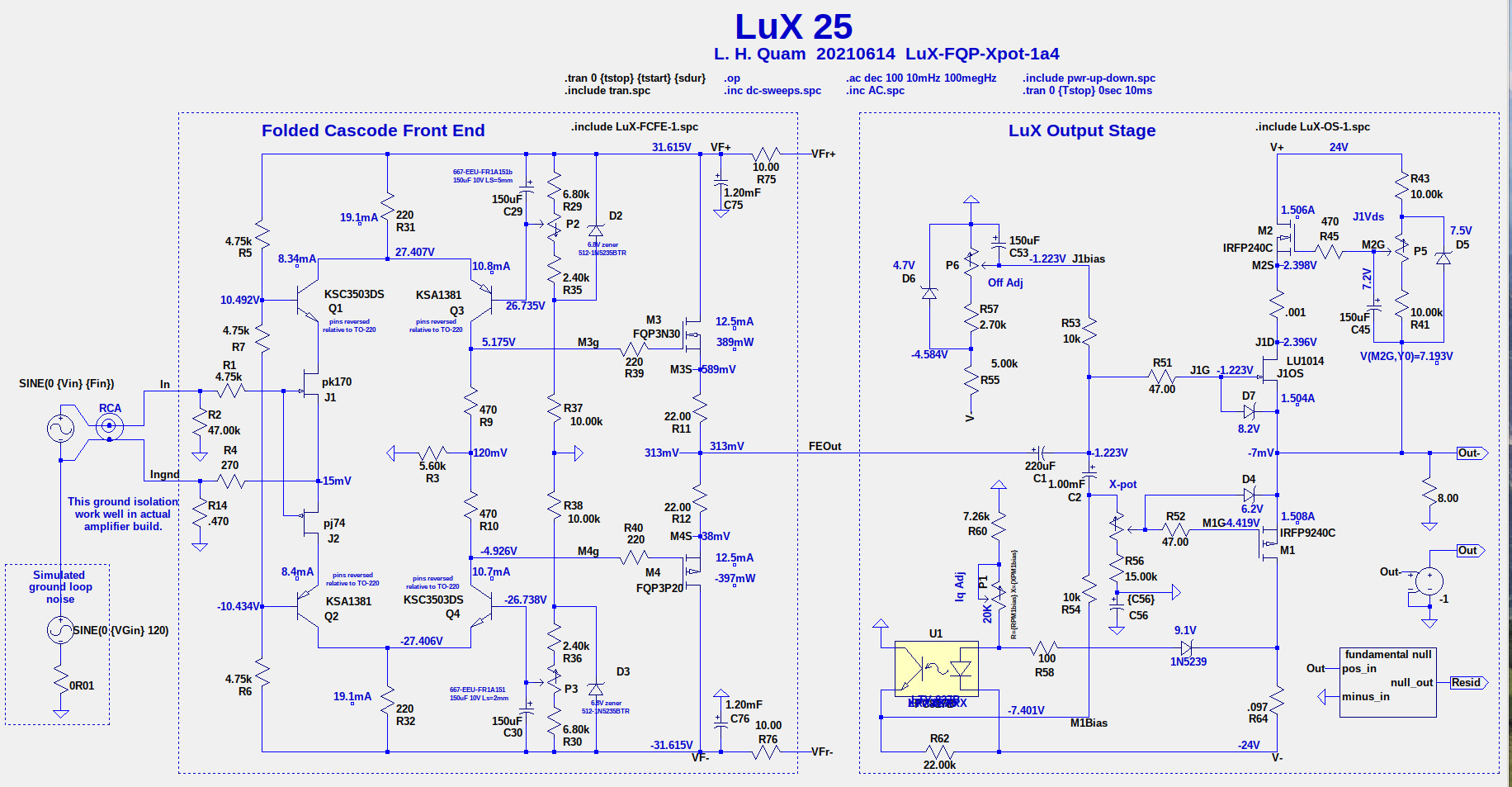

The LuX 25 Amplifier
I finally have a design using the LU1014D JFETs which behaves much like my SIT3X which the Tokin 2SJ182ES SITs, but at a lower power level. Here are to major properties:
25 Watts Class-A.
X-pot to achieve current source behavior of PFET at low power levels.
One DIYAudio Universal Mounting Spec. compatible PCB per channel.
+/-24V output stage power rails.
Two small +/-10V power modules to boost the voltage for the folded cascode front end to about +/-31V.
Power dissipation of about 75W-80W per channel.
It required many design iterations over a 4-day period to obtain a satisfactory PCB layout within my allotted board area, but I am fairly satisfied with the result. It still has a lot of parts, but the overall packaging is much simpler than the SIT3X.
I have not yet built this design.
