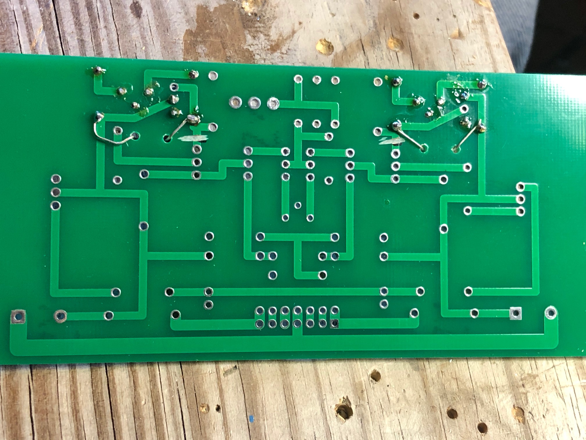

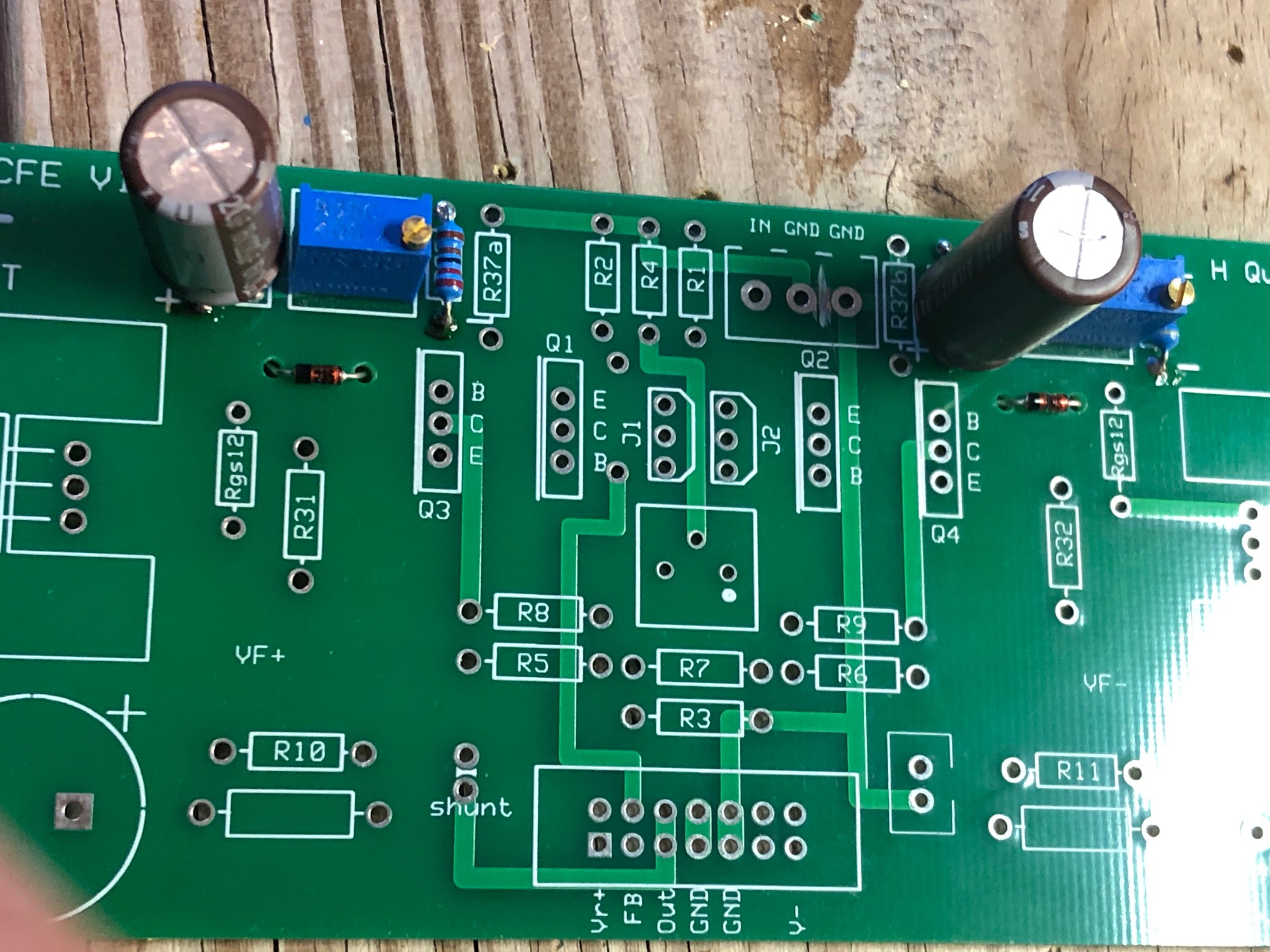

Started to stuff the FCFE boards with the Zener modification.
Cut 3 traces, drilled 4 holes. Didn't have a 150uF/10 volt, so used a larger 220uF/16 volt cap instead. Doesn't fit as well, (hides the R35b and R36b resistors which are put in first) but will do.
I soldered the resistors in first, then installed the new 6.8 volt diode in the new holes I drilled. Wrapped the diode leads around the resistor leads, then soldered.
If you don't solder the resistors in first, you have a wobbly mess to deal with and will have to solder them on both sides of the board as it is hard to flow solder past the diode lead wrap on the bottom.
Next will be the rest of the resistors, diodes, caps and active devises.
Here are photos of each side of the FCFE board.
If I have failed to do the diode mod correctly, please let me know.
Rush

Rush: Your PCB mods look to be correct. 🙂
The larger caps are fine, but eat up space. If the caps are installed first, then the resistors can be made to fit around them.

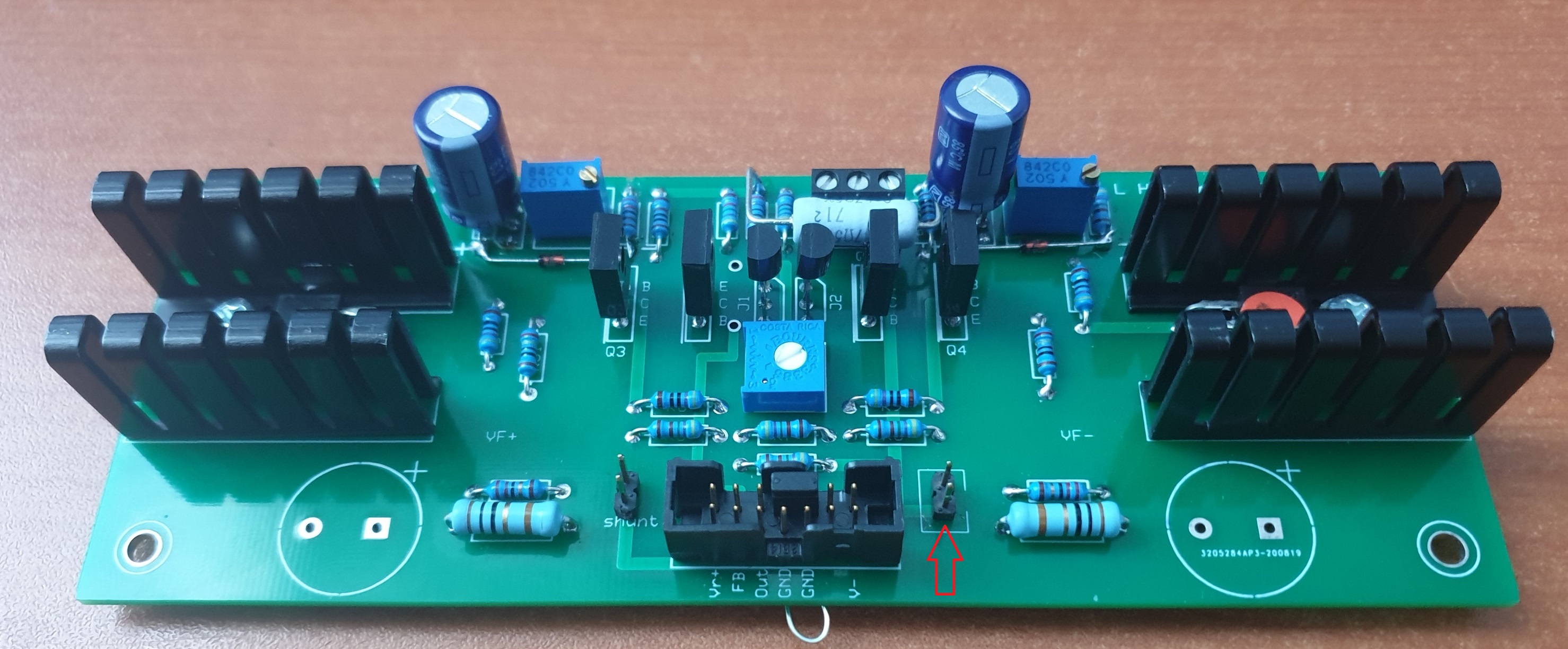

Those pins unused for normal operation. They connect to the FCFE output and ground to easily connect to an oscilloscope or spectrum analyzer. It the shunt on the other side of the ribbon cable connector is removed, the FCFE is detached from the load of the output board, allowing standalone testing of the FCFE board, using an external load resistor and spectrum analyzer.
Thanks a lot for the clarification. And to understand correctly. If I want to set 50 mA on R10 and R11 with the board disconnected from the output board, do I need to connect a load resistor to the FCFE board?
Thank you.
Thank you.
Thank you.
For "ordinary" adjustments and use it is not necessary to use the connector pins marked in red or to use any external resistor. The only reason that I added those connector pins was to simplify distortion measurements of the FCFE.

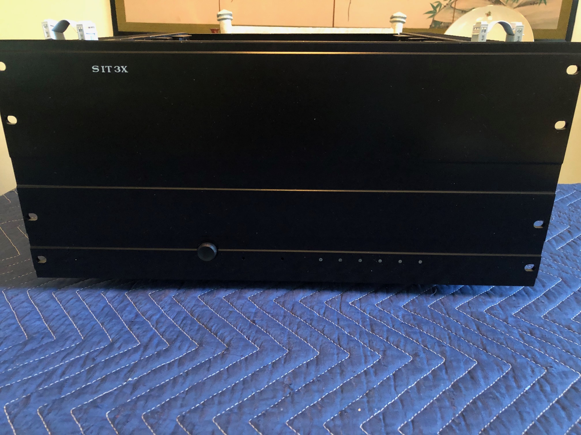

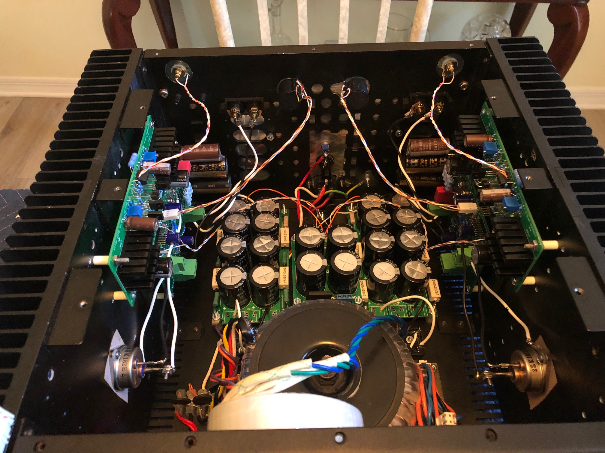

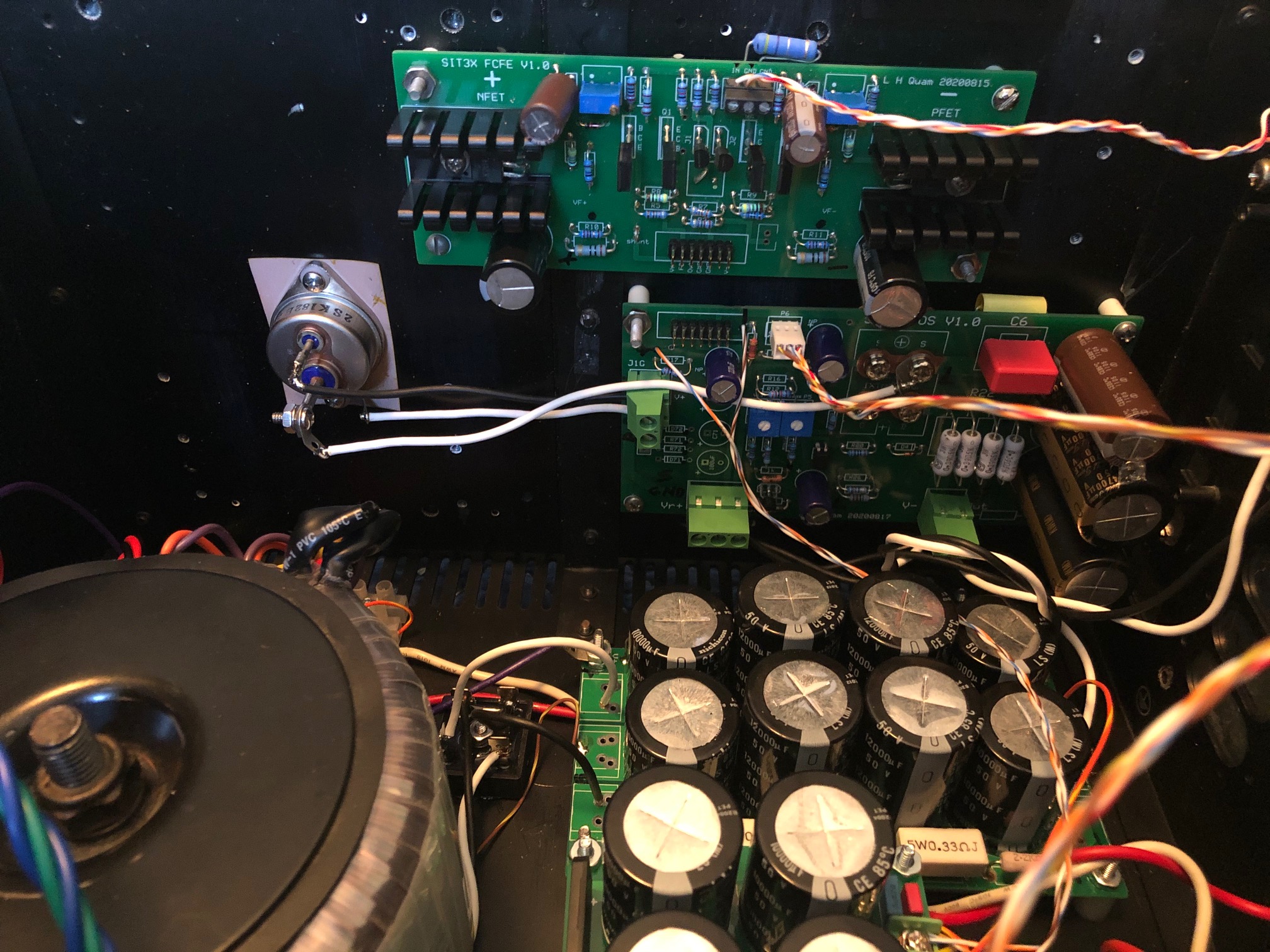

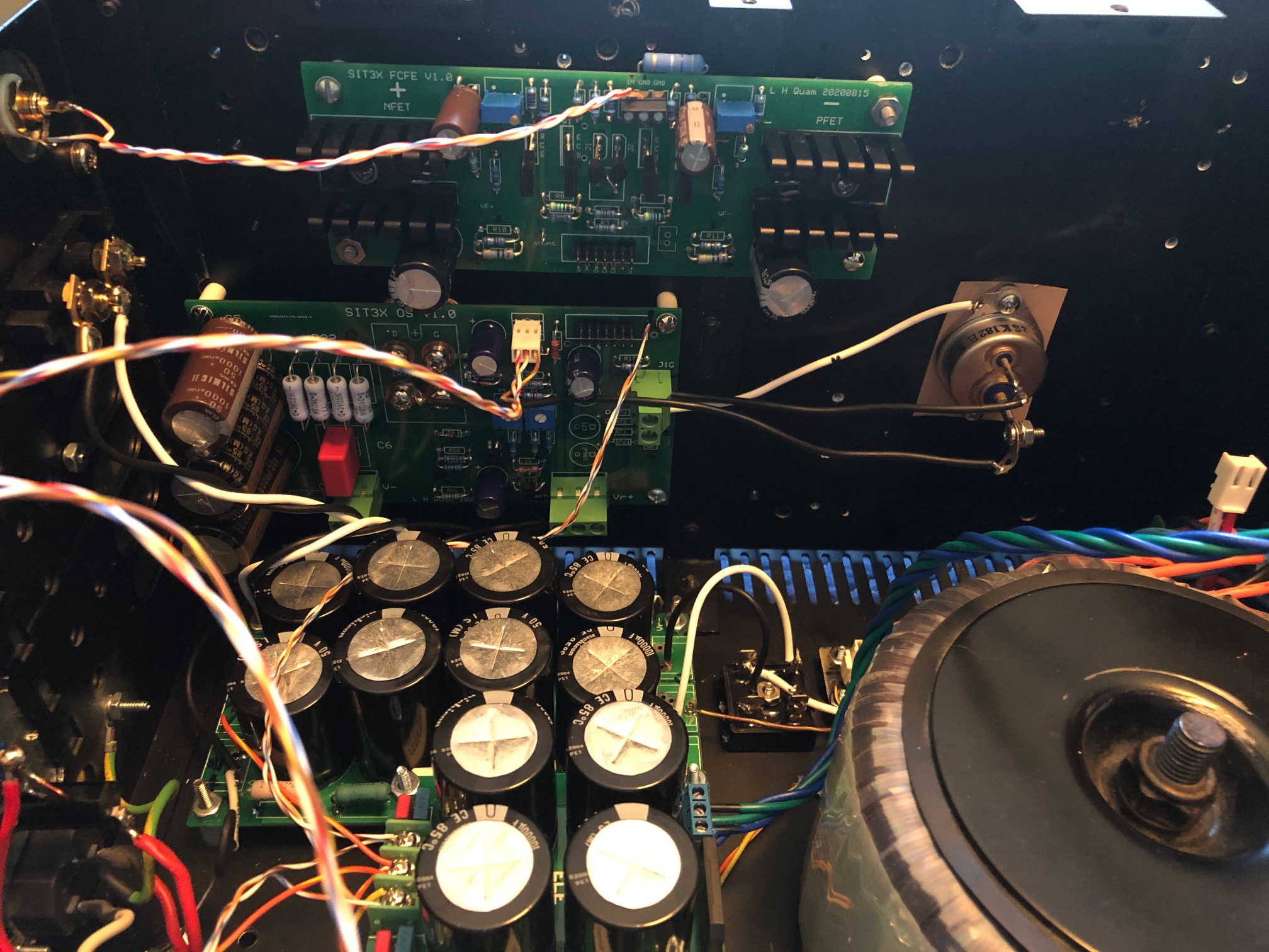

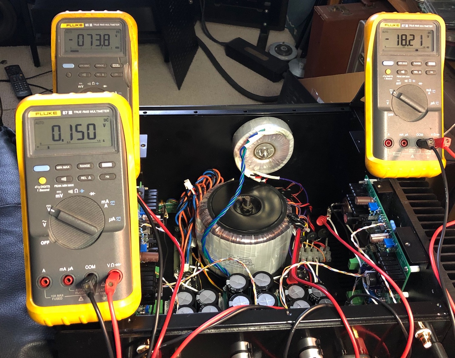

Up and running
Thank you Lynn for all your help getting my project off the ground.

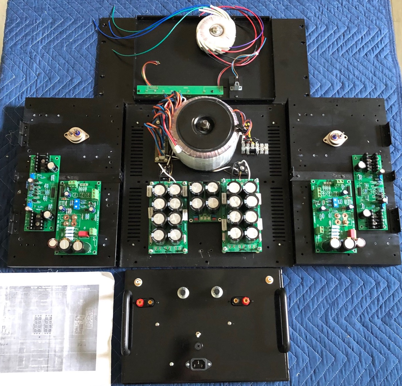

I am attaching pictures of the build as I went through.
Had a few issues that were mostly due to the lag-time between getting the boards stuffed and finishing the project. Lag-time = short term memory loss!

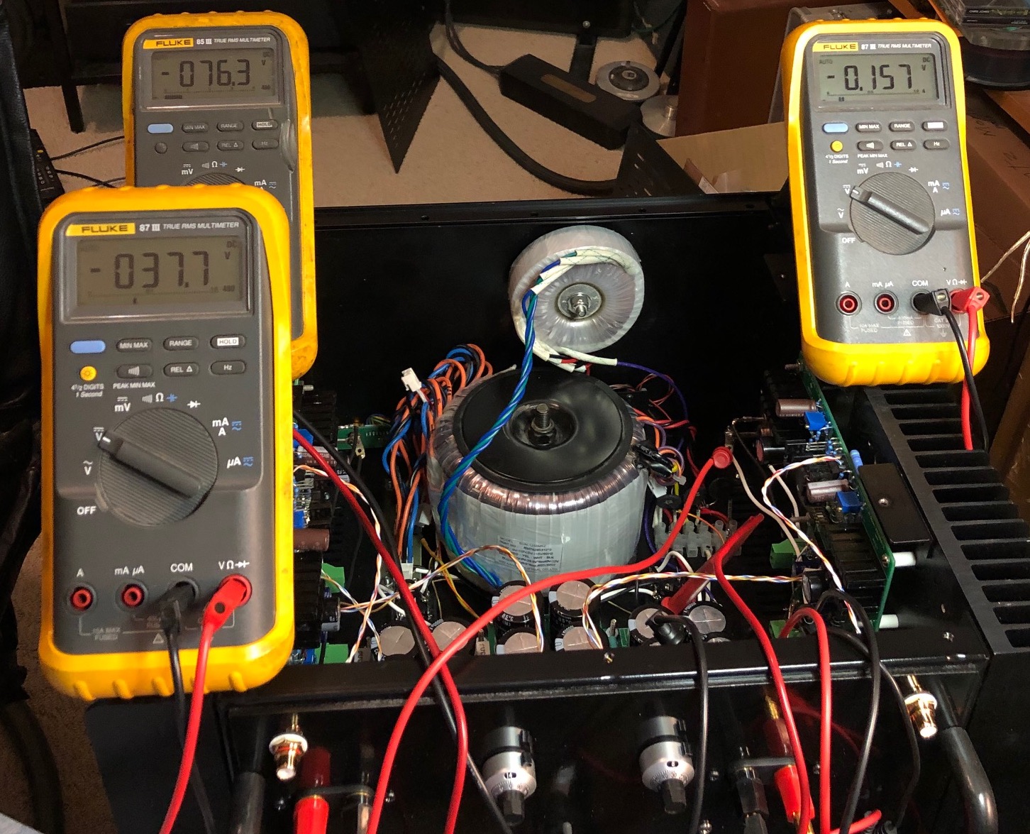

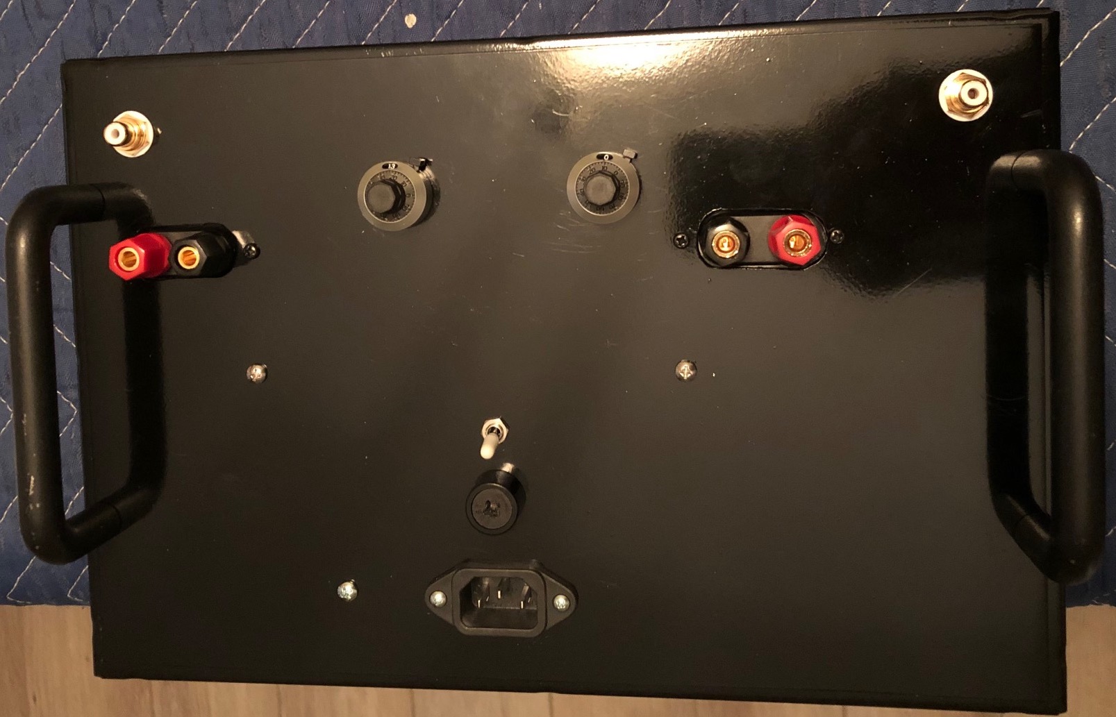

To start, I am building in a re-purposed Sonance 1250 Amp chassis, reusing the power transformer that has 6 each 29.5Vac-0-29.5Vac secondary windings. Using 3 paralleled windings on each side. The OS boards are configured without the cap multiplier, so a single rail of 0V to -73.5Vdc.
Also using a separate Antek 32Vac 50 VA for the fcfe boards (both sharing the same power supply in dual a rail voltage of +38.5Vdc 0 -38.5Vdc. CRC C=10k uF)
The ground of the fcfe power supply is connected to the 0 rail of the OS power supply. All tricky stuff to keep up with.
One thing is, I installed a 10k resistor where a 100k resistor should go: R23. The OS wouldn't bias up, after finding the mistake everything was good.
Also I forgot to add the jumpers on the back side of the fcfe boards due to time elapsing between doing the diode mod and installing the transistors. That caused some issues that Lynn was able to help track down and fix. But aside from that it all went pretty well.
The amp is biased at 1.65 Amps, 73.5Vdc rail. 120 VA and the heat sinks are hot to touch. About the same as my real First Watt F7.
How does it sound: It is one of the best I have, can't get second opinions right now, due to pandemic. Extended highs, authoritative bass, liquid mids.
I hope to see other builds soon.
Rush
