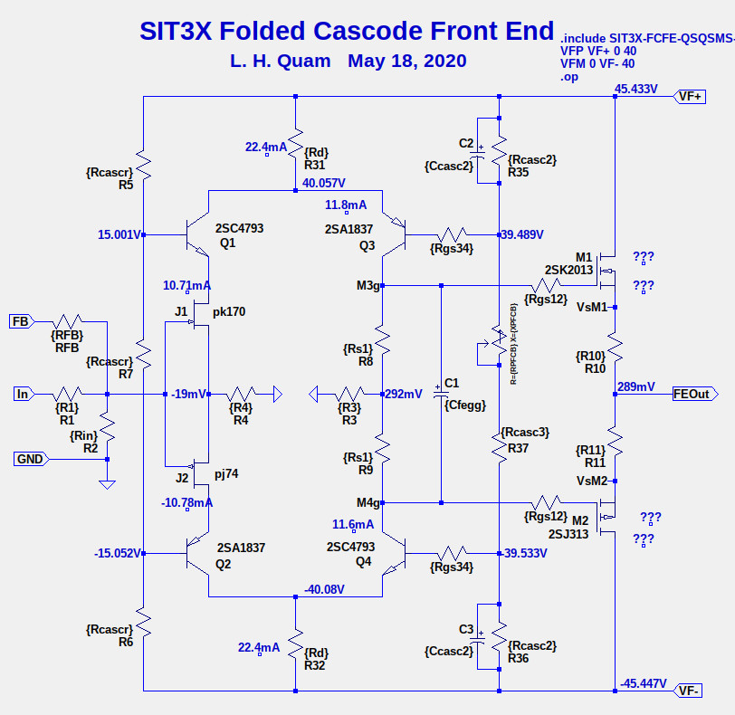

I just discovered an error in my thinking about the 2nd stage cascode devices. Their role is very much like that of the VAS gain stage of many amplifiers. Looking at Bob Cordell's "Designing Audio Power Amplifiers", devices like the 2N5551 and 2N5401 are used, and often cascoded. Those devices have very low capacitances. I stayed away from TO-92 devices because of possible power dissipation issues.

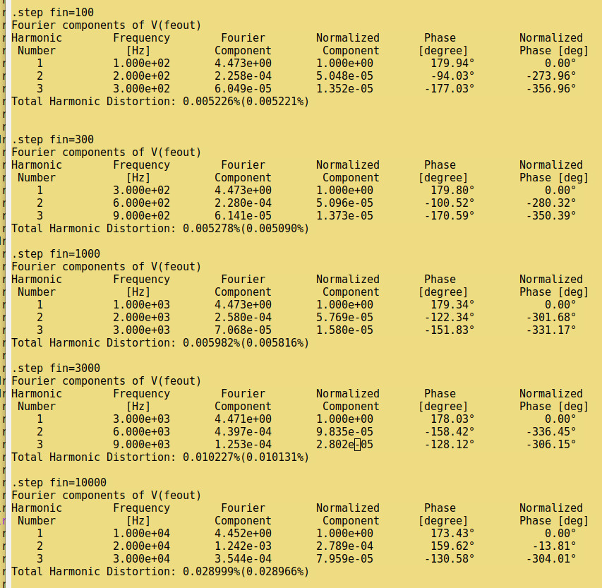

With the 2SC4793/2SK1837 devices I found that the FE THD increases by about 18dB from 1kHz to 10kHz, due to the performance of these devices at a gain of 10X with no feedback. Tomorrow I will run simulations with the 2N5551/2N5401 devices to see how they compare.

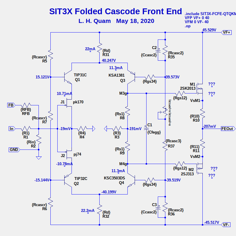

It may be worthwhile considering some modern equivalents, in particular the KSC3503 and KSA1381. High frequency / low capacitance.
I was able to find SPICE models at OnSemi.com for those devices: KSC3503DS KSA1381. I will give them a try.

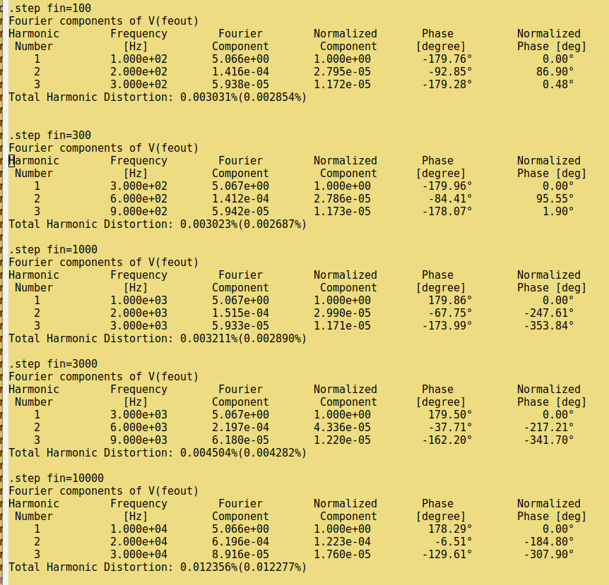

Big improvements to FE performance with KSC3503DS and KSA1381 BJTs. Here are the circuits and simulation FFT results of the FE configuration with 2SC4793/2SA1837 vs. KSC3503DS/KSA1381. The FFT listings are for 1W into 8R at 100Hz, 300Hz, 1kHz, 3kHz, and 10kHz.

Good news about the performance using the KSA/KSC devices. Just shows it is worth carefully evaluating the best components for any particular application.
When you changed to use the KS devices I see you also changed Q1 and Q2 to TIP devices rather than making these KS devices as well. Any particular reason? I appreciate that the characteristics of Q1 and Q2 may well be less important in this circuit.
The choice for the 1st stage cascodes doesn't appear to be very important. The TIP devices are readily available, as are other BJTs with high enough Vcemax. The only remaining scarce devices are the 2SK2013 and 2SJ313, which can be replaced by FQP3N30 and FQP3P20 with some performance hit.
