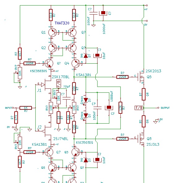

Why Wilson mirrors? Something simpler would still be an improvement over the resistors although whether this translates into better sound is a different question.
If one wanted to use Wilson mirrors then why not make Q3 and Q4 part of the Wilson mirrors? Of course it then becomes a different topology with probably different results...
It's good to see that we were able to get better performance by using different devices at Q3 and Q4. I think the latest sims used the TIP devices simply to show the relative insensitivity of Q1 and Q2 parameters in the cascode function. Having demonstrated that, I wouldn't use the TIP devices as my first choice. We have already mentioned several other device pairs suitable for Q1 and Q2, including a couple different options from Toshiba, as well as the MJE15032 / MJE15033. I think another set that might work well here is the KSC2690 / KSA1220, which have been shown to be good performers in other designs.
If I get a chance, I would probably also try the KSC2382 and KSA916. These are in TO-92L packages, a 'tall' version of the TO-92. These still use the ECB pinout and are drop-in compatible. There are a couple ZTX devices that I could try, but their pinout would require crossing two of the legs. No big deal, and more of academic interest anyway.
The more important topic of interest would probably be the suitability of the FQP devices as replacements for the 2SK2013 / 2SJ313. I'm curious what parameters set the older devices apart from the newer ones. I'm still interested in trying some lateral Mosfets in the M1 and M2 locations, but that will likely be on my own time.

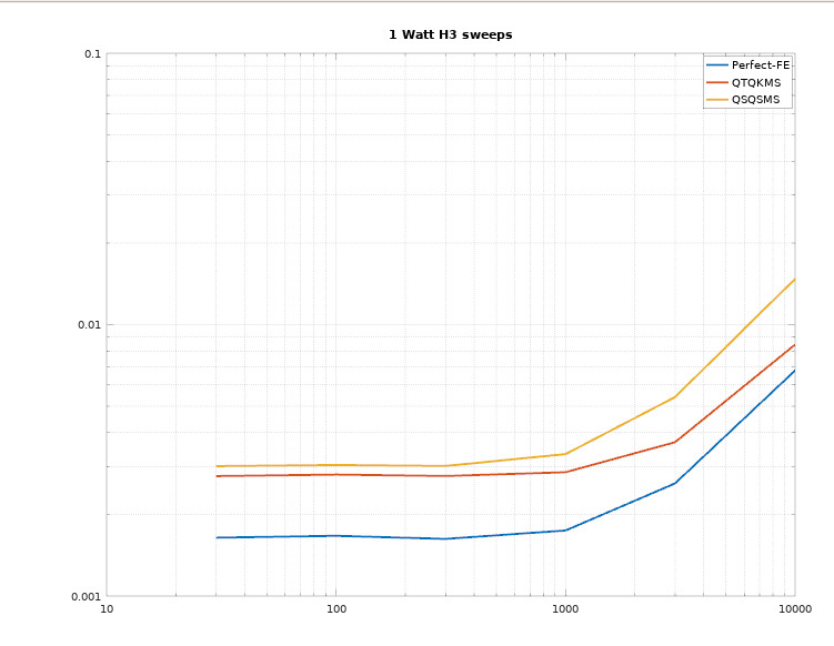

Here are frequency sweeps at 1 Watt into 8R of three configurations of the folded cascode FE:
- QTQKMS TIP31/32 KSC3503DS/KSA13812 SK2013/2SJ313
- QSQSMS 2SC4793/2SA1837 2SC4793/2SA1837 SK2013/2SJ313
- Perfect-FE perfect FE with zero distortion and zero output impedance.

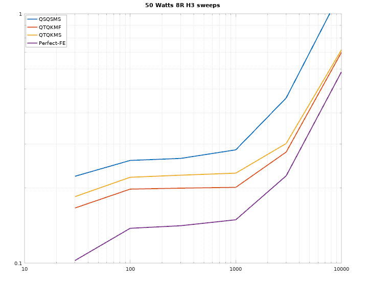

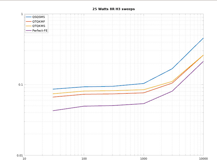

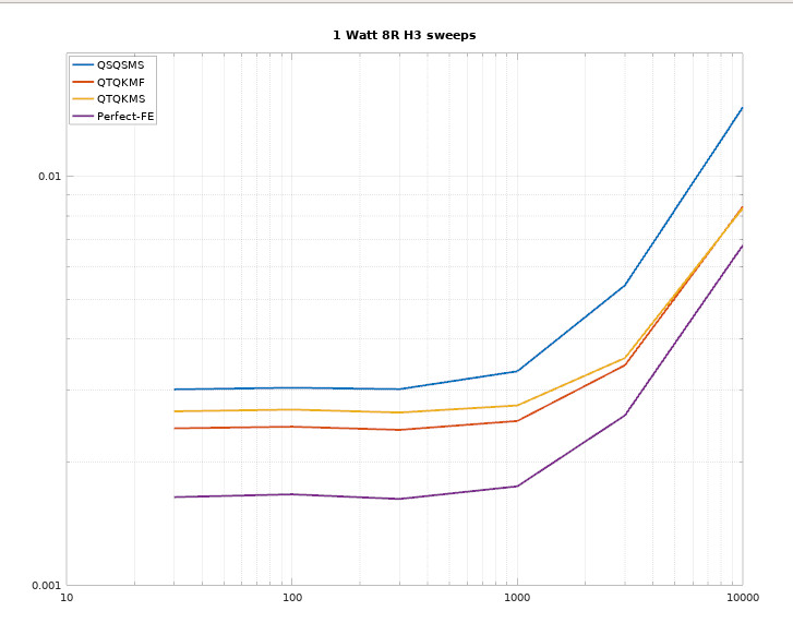

Here is a comparison of 4 different front transistor configurations of the folded cascode front end, at 1W, 25W, and 50W.
- QTQKMF TIP31/32 KSC3503DS/KSA13812 FQP3N30/FQP3P20
If your going to do something, why compromise when you don't have to?Why Wilson mirrors?...
...why not make Q3 and Q4 part of the Wilson mirrors?...
I did in my previous versions of Alice (pre/HPA) & Frank (power), I added the cascode to reduce the power dissipation of the mirror transistors and to reduce how much voltage it would see.

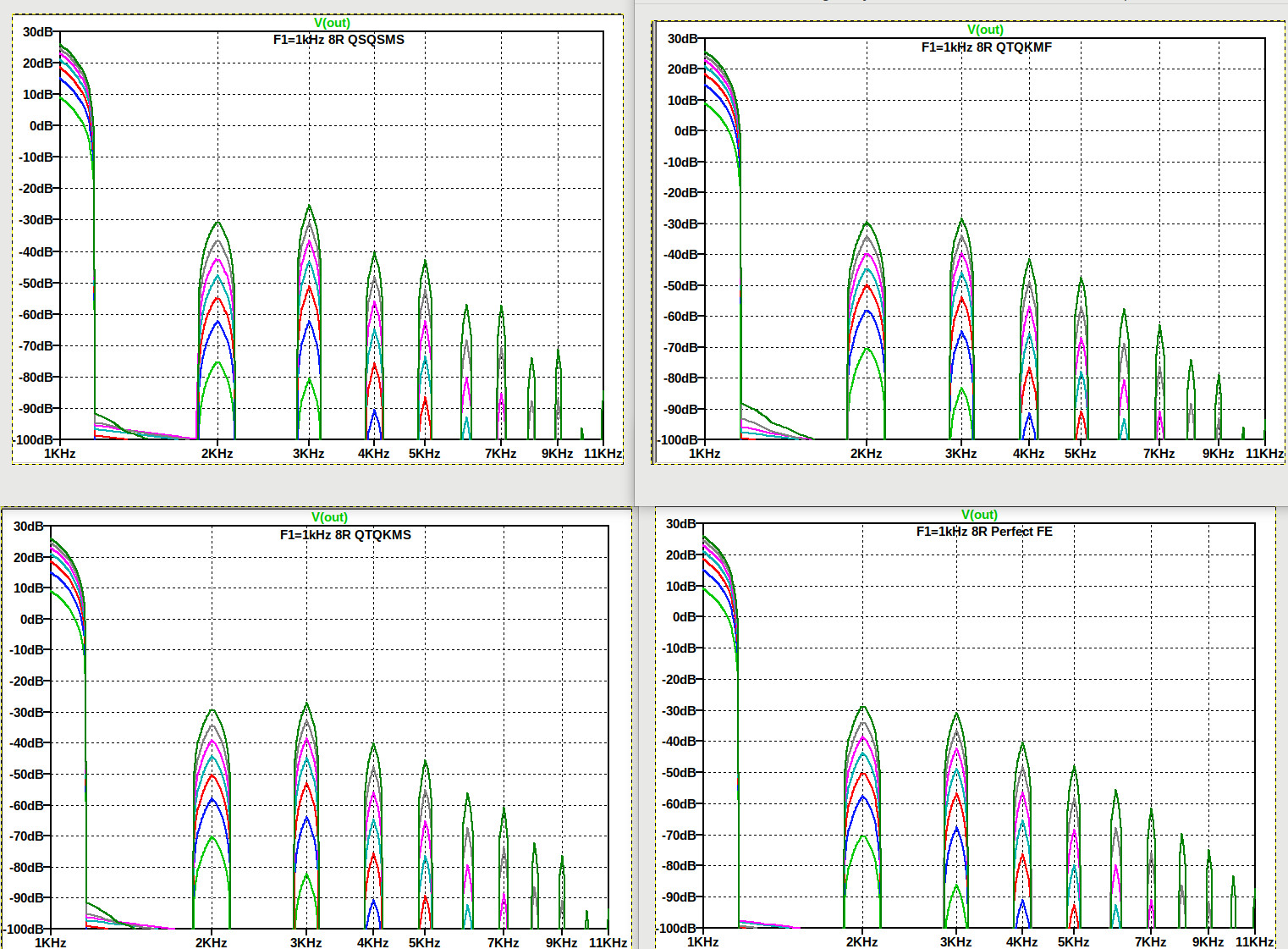

Here are some spectral plots at F1=1kHz into an 8R load at 1W, 4W, 9W, 16W, 25W, 36W, and 49W, for 4 difference front-end transistor configurations. You can see that all of the plots are very similar and exhibit the desired behavior of rapidly decreasing higher harmonics.

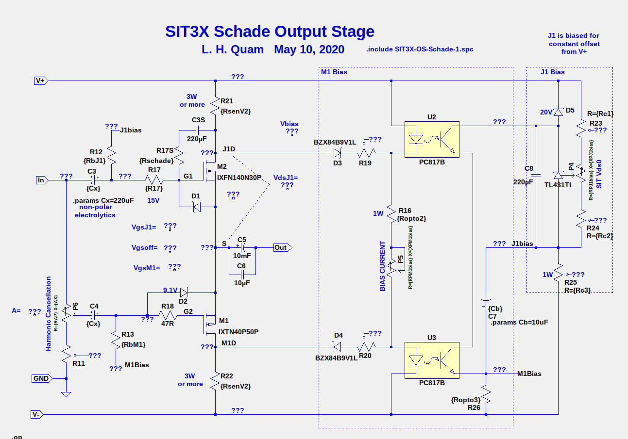

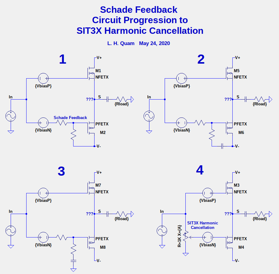

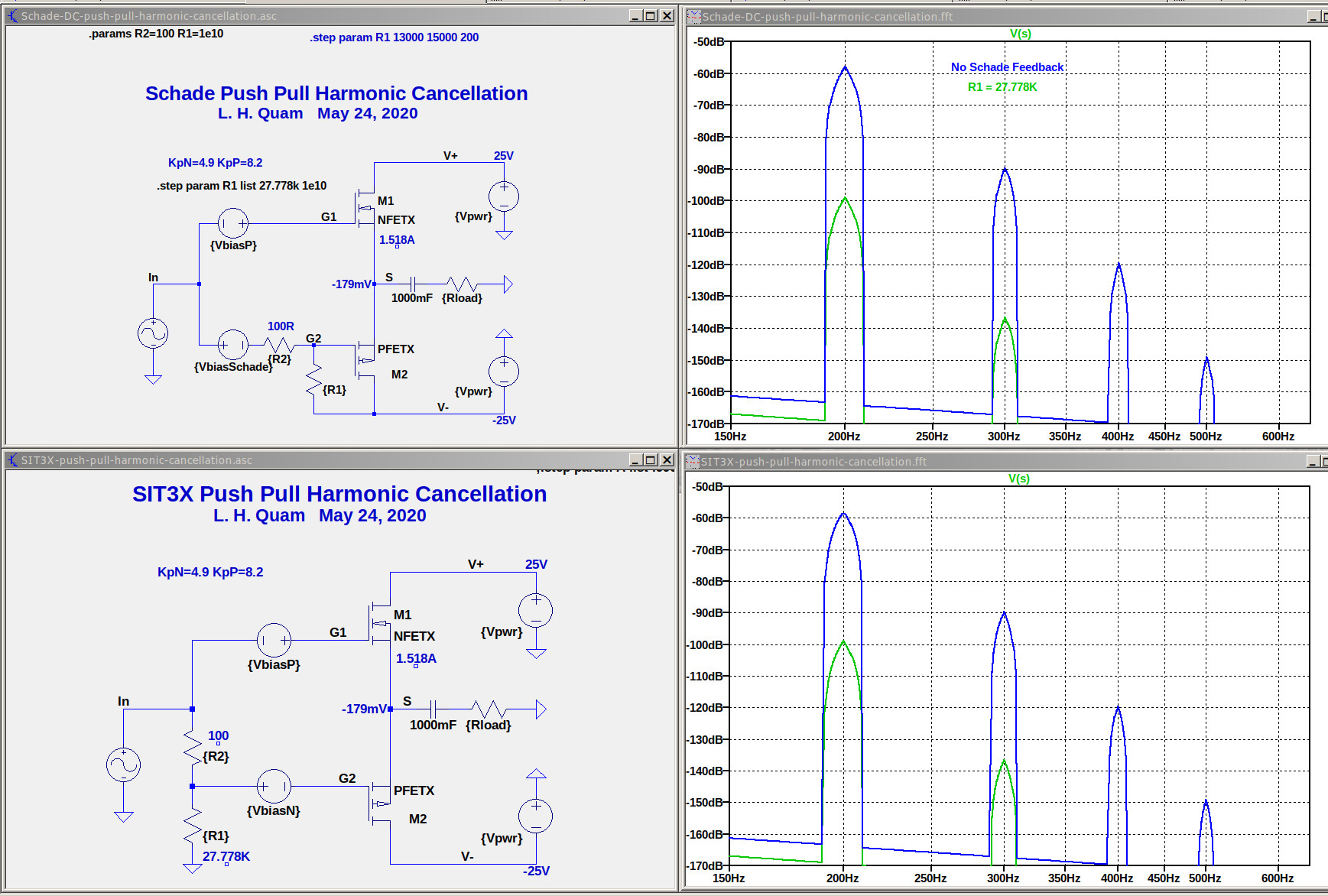

SIT3X Harmonic Cancellation is Schade Feedback
I recently discovered that my SIT3X Harmonic Cancellation circuit was not something new after all. It is equivalent to Schade Feedback as shown in the image below. The only real difference between the circuits is the position of the resistor divider in relation to the bias circuit, and realizing that in the push-pull common-drain circuit the FET drains have a constant voltage (expect for PS noise) relative to ground.

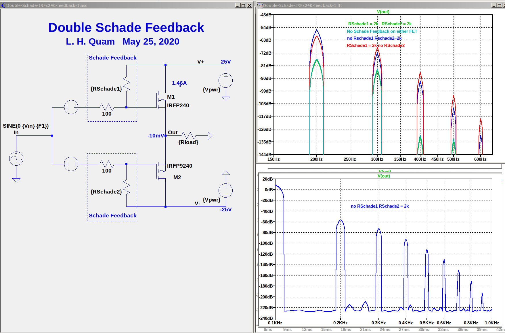

Consider the SIT3X-Schade-OS circuit shown below. Using the equivalence of SIT3X harmonic cancellation and Schade feedback, the 2nd image shown an equivalent double Schade output stage, and the spectral plots on the top-right show that nothing is accomplished by double Schade feedback vs. no feedback to either FET. However, single Schade feedback might be useful for "shaping" the spectrum as shown in the bottom-right, although the harmonics are larger than without the shaping.
Bottom Line: What is the point of the SIT3X-Schade-OS circuit? Single Schade spectral shaping can accomplish anything that the double Schade circuit can.
More to come -- there is more involved than spectral shaping. In future posts I will discuss the SIT3X OS in relation to circuit having the FirstWatt SIT-3 output stage topology.

I can see why the two approaches you outline are equivalent but I don't understand why the second is an example of Schade. Isn't Schade a type of feedback? I see only an input attenuator here and no feedback. Am I just being even dumber than usual? Can you explain please?
just relax it, looking at feedback as either something in overall loop or something in local loop
original Schade arrangement with pentode tubes certainly looks different than 2-resistor thingie, we already know as basic arrangement for Mosfets, but in the end it is same result- mysteriously made portion of signal at gate, practically correcting original modulation
I believe sole criteria should be - part's original transfer characteristic must be altered......... huh now we are really in shady area
it seems DEF is Schade too, from the start ..... but problem is to decide - who's Schaded there - Mos or SIT ?
