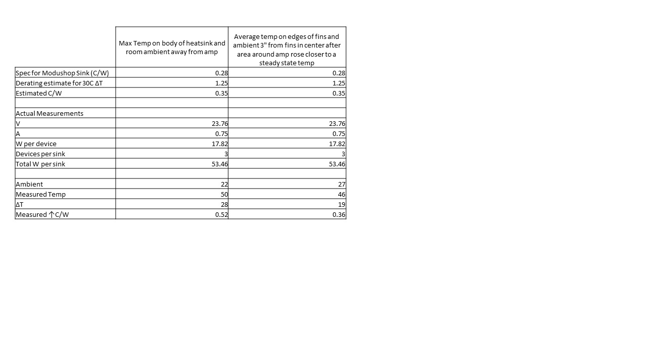

Today I remeasured power dissipation and ΔC of my ZD25 amplifier which uses natural convection with the HeatsinkUSA sinks. The power dissipation is 81.1W per heatsink and the temperature rise is 28C, for ΔC/W = .345C/W. The HeatsinkUSA figure of .34C/W/3" is for a sink of length 3". If all were linear it would imply .34C/W*3/7 = .146C/W for a 7" long sink.

Ben - Awesome paper! Thank you. Saved to my education file.
That seems to jive reasonably well with the article Ben posted.
0.34 x 1.25 (derating for ΔT from 30C) = 0.43
0.43 x 0.67 (correction factor from 3 to 7 inches) = 0.29
So, in your real world example, you're far closer to ideal / expected performance if we assume the HUSA sinks behave close enough to the paper.

Lynn - this is the current summary. I don't think I'm going to press too much further in terms of temps. It's totally fine as personal preference for me re: the ability to touch the sinks for as long as I'd like. I can see ~50W of dissipation per sink => 100W per side being sort of a "sweet spot" for me, but I could push it further. I just might for my own curiosity.
Summary - If I use the 25% de-rating along with the measured ambient temps close to the amp after it's been sitting all night with the temp on the fins vs. on the flat body of the sinks; the measurements agree reasonably well with the prediction.
Hope that's helped a bit. Hopefully some others can share some measurements from their amps. Again, thanks! 🙂
