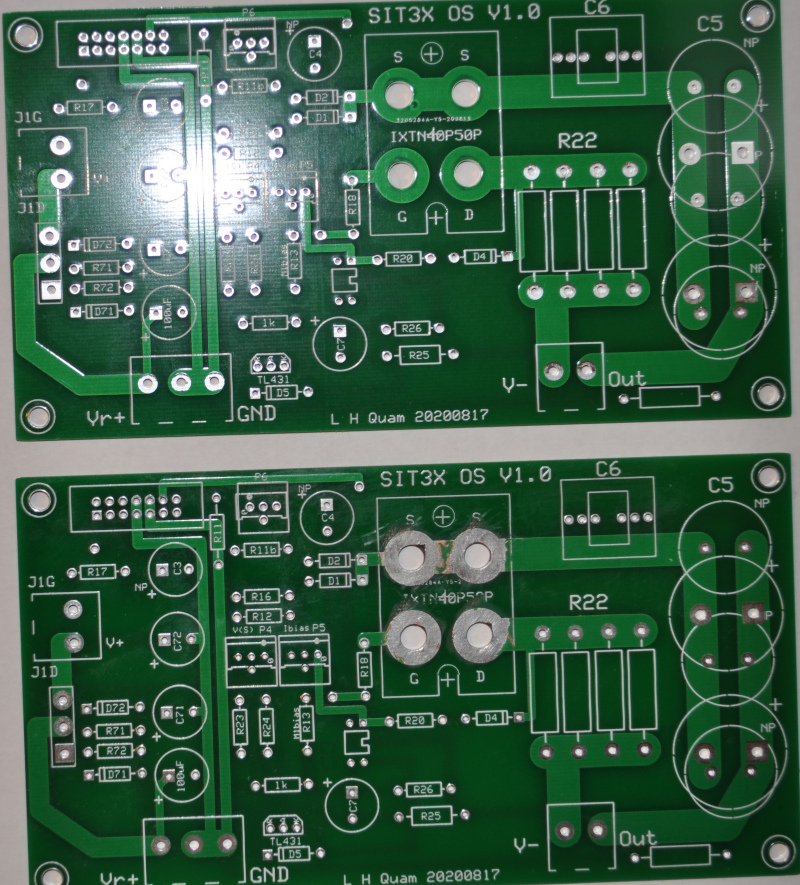

I received the PCBs yesterday and, as feared, there were some Gerber file conversion problems. The single-channel PS capacitor boards need some manual rework, but since there are 50 such boards, considerable time is required. The dual-channel PS capacitor boards appear to be fine.
Builders using the diyAudio Store 5U 400mm (or similar) chassis can go with either a pair of 32V, 300VA transformers using a pair of single-channel cap. boards, or with a single 32V, 600VA transformer using a single dual-channel cap. board. Let me know if you plan to use a single transformer with the dual-channel cap. board and do not need the single-channel cap. boards.
Similarly, the OS-left and OS-right need some rework to remove solder mask around the IXYS PFET terminal screw connections. This will probably require about 15 minutes per board x 50 boards, unless builders are willing to do this themselves. The rework requires removing solder mask around 4 holes on each side of the OS-left and OS-right boards, shown in before (top) and after (bottom) images below. The solder mask can re removed by carefully scraping with a sharp tool, such as an Exacto knife, or using a small wire brush on a Dremel tool.
As far as I'm concerned I am happy to do this on my boards, after all I need to feel that I'm doing something! Thank you for all your time.
Hi Lynn,
It doesn't sound like removing the solder mask would be too difficult a task so
I would be happy to handle it myself.
