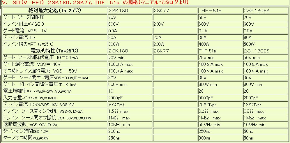

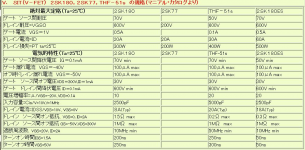

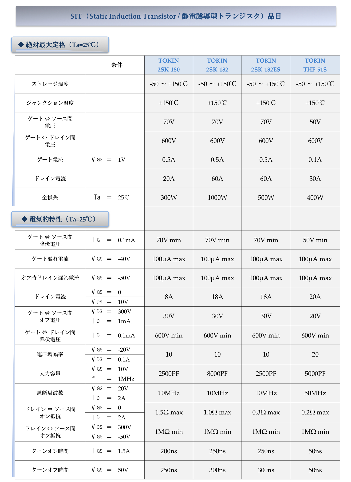

Does anyone have a datasheet for the THF-51? How do their characteristics compare to the Tokin 2SK182ES?
This might help.
Thank you AMPLIMOS one stage amplifiers amplificatori audio monostadio
I sent Woofertester a pair of my THF-51S for measurement. I believe he also measured the 2SK182, but I am unsure about the 2SK182ES. I'll shoot him a note to see if he can offer some insights. I trust his measurements.

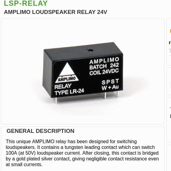

differences between them are much smaller than importance of fact of having any of them, especially if some NFB is wrapped around, and source follower is in case
relays in speaker hot
I don't care for that difference someone can hear when including decent relays in speaker line
life is too short ..... or, I'm choosing other areas to fully develop my OCD![]()

The Tokin parts that I curve traced are the 2SK182ES. The package looks just like the THF-51S.

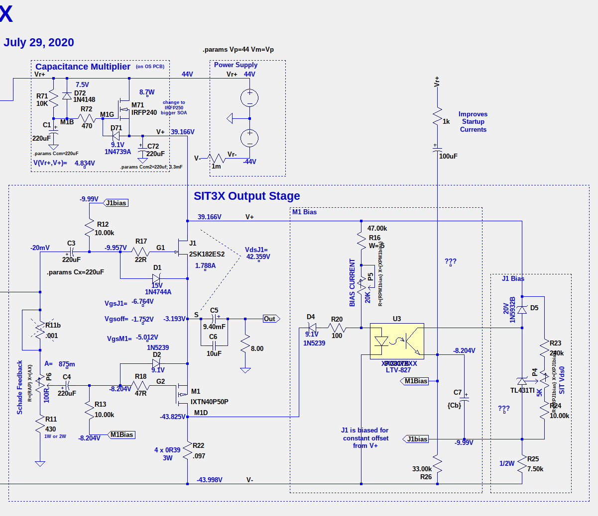

Hello @Ihquam
could you put please latest schematics online, or give a link to actual post?
JP

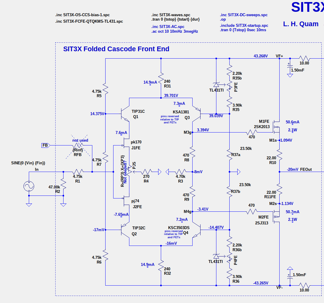

Here are schematics for the FCFE and the OS. Best guess at the BOMs will be posted shortly. I hope to test the PCBs and BOMs by ordering parts using the BOMs and populating the new PCBs with them before posting the "final" BOMs and shipping PCBs to forum members. In this way I can test the correctness of both the new PCBs and the BOMs.
