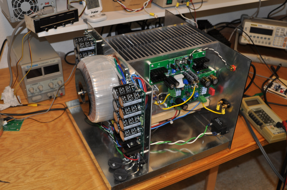

The SIT3X board sets were originally designed for the packaging configuration shown below. The HeatsinkUSA sinks are of the 10.08" series with length of 7" and fin height of 2.5". Over the years that I have used them, I can confirm that the ΔC/W figure of .34C/W/3" is good.

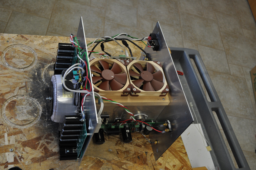

With a little bit of help from quiet PC fans, there is no problem with 150W or more dissipation per heatsink. I am currently using a pair of Noctua NF-F12 fans with 155W dissipation per heatsink and get ΔC=18C. I plan to replace those fans with lower RPM Noctua NF-S12A FLX fans to make it even quieter.
This packing arrangement is very simple to build: 2 x 1/8" aluminum sheets for the back panel and the power supply, and a galvanized steel bottom fabricated by a local sheet metal shop.

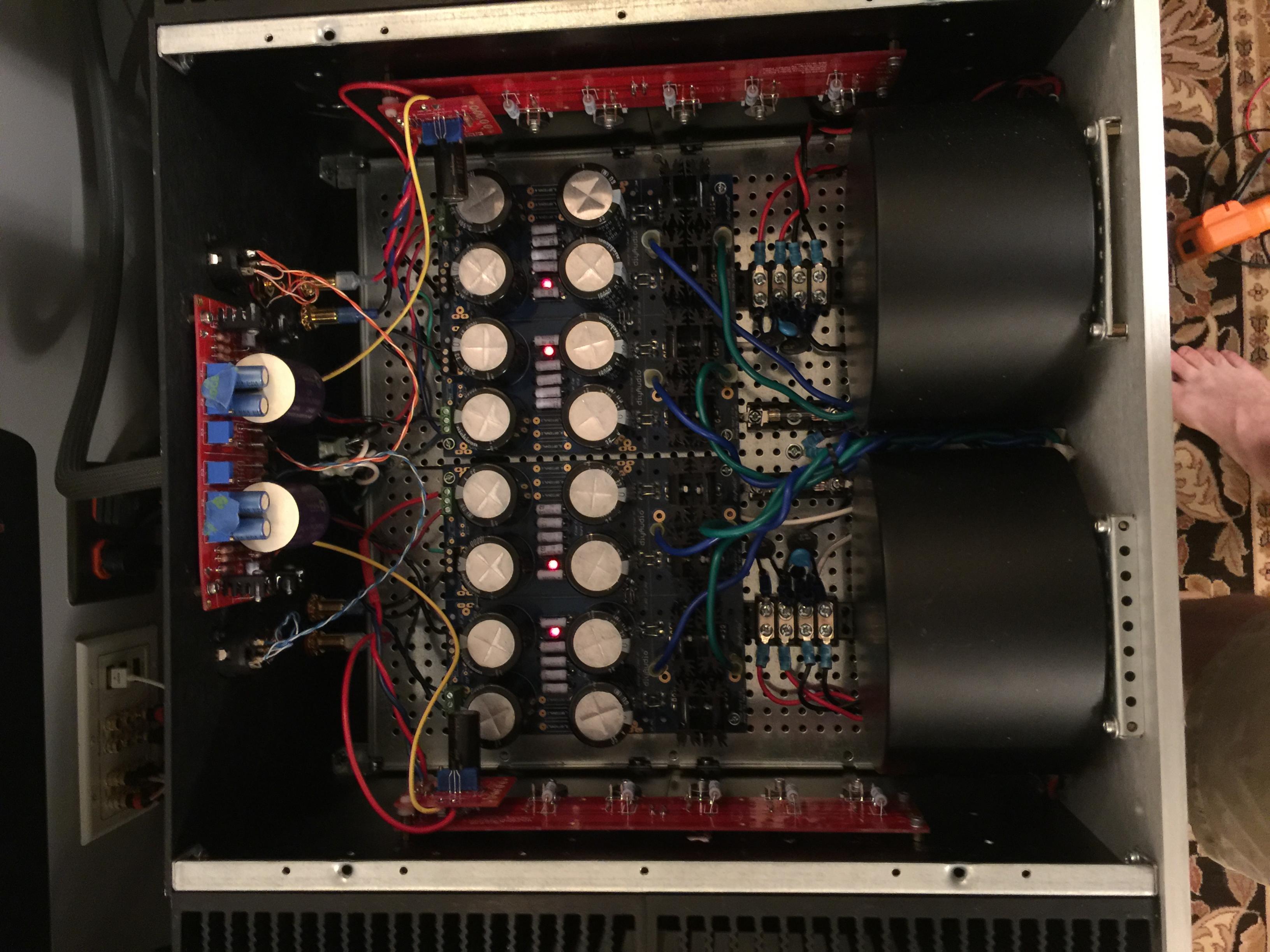

OK - Since I know measurement method is kind of "everything"... Here is how I took the measurements and the conditions under which they were taken. Note - amp has been on for several days. It sits in "free air" on the standard anti-vibration feet. No obstructions over the amp at all. No forced / fan cooling. I re-measured rails and bias again just to be sure. Nice to see it's still rock stable. 😀 After I re-checked bias and checked device temps, the chassis top plate was put back on and the amp was left to sit for ~30 mins before taking heatsink measurements.
1) Cheap Amazon Infrared Thermometer - Zoto PM6530D.
2) Emissivity set to 0.85 (Seems to be roughly correct for black anodized aluminum)
3) Current amp in chassis - BA-3. 6 Output devices per channel. 3 per heatsink. 12 total. Dual mono / fairly tight chassis with dual 400VA transformers mounted to front panel. See pic.
4) 23V76 loaded rails on each channel.
5) Bias - 0A500 (0V110 across 0R22 source resistors)
6) W per device - 11.88
7) W per heatsink - 35.64
8) Ambient Temp - 21.5C
9) Device Temps - (A bit hard to get consistently) ~53C to 54C. Measured @roughly 3 inches away. Temp taken on top of plastic casing.
10) Using ceramic insulators + goop under FETs
11) Heatsink Temps

51 - 21.5 => 29.5C Temp rise
35.64W per heatsink
So... My "real world" situation seems to be ~0.83 C/W
However, this is my first time doing this... Any number of things could be incorrect from the most basic calculations to my measurement technique.
Love to hear some thoughts.

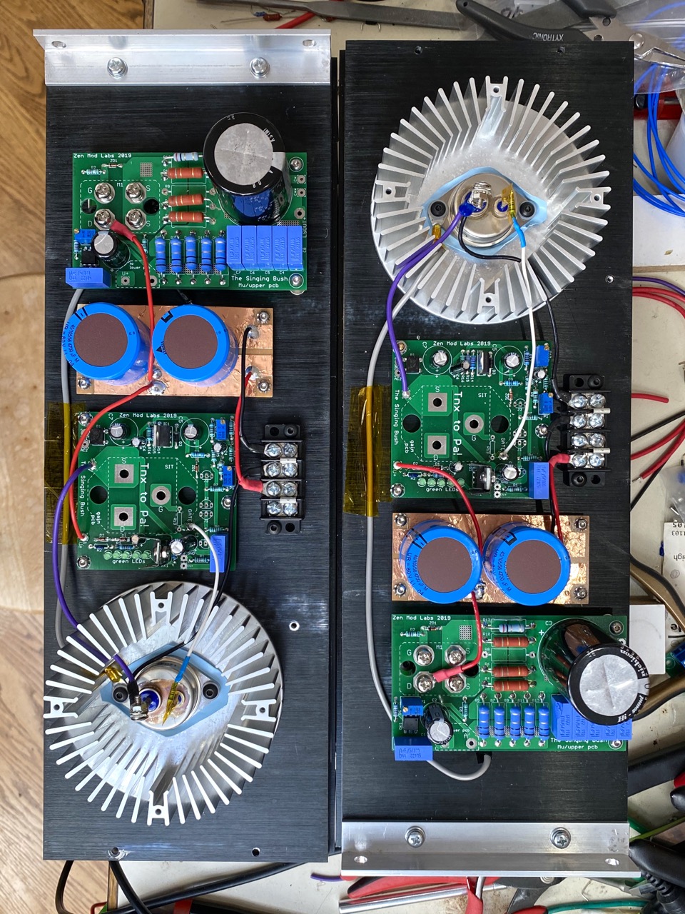

For comparison, here are two channels of Singing Bush ready to be incorporated into the rest of the chassis. I think there is just enough room for the SIT-3X boards + hockey puck SIT itself. I know these heatsinks are good for 120 Watts, without the circular add-on. I'm confident in using them for the Singing Bush so far.
I have a second chassis that is identical to this one, including another pair of circular LED heatsinks to augment the capacity for the SITs. If I understand the operating parameters of the SIT-3X correctly, this should be sufficient for that as well. They may get a little bit hotter, but I think will stay in the 50 to 55 °C region. I will need to look at some options for mounting a pair of power transformers inside this chassis.
