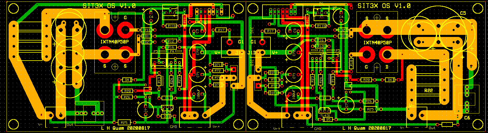

This is an update of the PC board progress. After looking at a number of issues with packaging my existing OS boards on the 5U 400mm heatsinks I was not satisfied about using the OS board in the 180degree rotated configuration. As a result I am laying out a left-to-right mirror image version of that board so the access to pot adjustments and connections to the SIT are acceptable positions. The ribbon cable connections to the FCFE board will be the same and the OS-left +OS-right board pairs will work for either "normal" chassis with heatsinks fins pointing outward, dual mono, or my prototyping chassis with the heatsink fins pointing inward forming a heat tunnel.
I do not expect the overall costs for the board package to increase very much.

Monoblocks:
It should be possible to do monoblocks, with the SIT on one heatsink and the PFET and OS board on the other. But, the SIT gate stopper should be close to the SIT, probably a resistor soldered to the wire from the OS board, with the connection protected by shrink tube, and jumper around the place for that resistor on the OS board.
