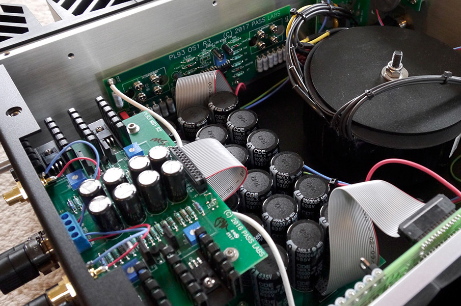

I have some price quotes from Bittele in Ontario Canada Turn-key PCB Assembly and Manufacturing
who I am likely to use to fabricate the PCBs. Of course, the price per board depends of the number of boards in the order. I have quotes for quantity 15 and quantity 30. Here is an estimate of the cost per board set (2xOS+2xFCFE+1xdualCAP), not including shipping:
- batch of 15: (enough for 7 board sets) $71
- batch of 30: (enough for 15 board sets) $46
- Rush set + N x cap boards
- twitchie set
- damuffin set for 5U chassis
- TungstenAudio set
- arky set
- asphalt set + cap boards
Would be nice to have a spot for thermistor’s for 240V and 120V On supply boards.
Lynn is trying to make the boards as small as possible, removing Diodes and Thermistors, as they can be placed on chassis where there is room.
Keeping the board in the 6" x 7" range allows it to be placed over the 1000VA transformer and not extend into precious chassis real estate.
Rush
I also intend to use some of the extra dual cap. boards cut in half for my future prototypes which will be built with the fin-to-fin chassis configuration. That power supply configuration requires narrower single channel cap. boards.
Rush

My objective is to allow the PS capacitor board to be placed wherever the resulting power supply related noise is minimized. I am not sure that directly over the transformer is the best place because of strong magnetic fields coupling to the board traces and the wiring to and from the board. I might be better to stack the FCFE board over the cap board, as in the XA25 layout: http://6moons.com/audioreviews2/passlabs3/2.html
Rush
