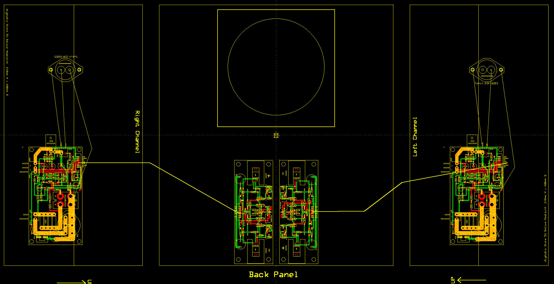

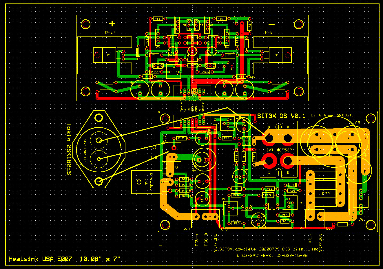

Am about ready to order revised versions of the SIT3X FCFE and OS PCBs. I have made revisions that look to be compatible with installing in a chassis with suitably large heatsinks, such as the diyAudio 5U chassis with 400mm depth. The image below shows right CH heatsink, top-view, and left CH heatsink.
I need to get an idea of how many are interested in purchasing the boards. The first run of 4 each boards will cost me about $360, but will also produce Gerber files that can be used by a lower cost PCB fab facility. The cost will depend on the vender and the quantity ordered.

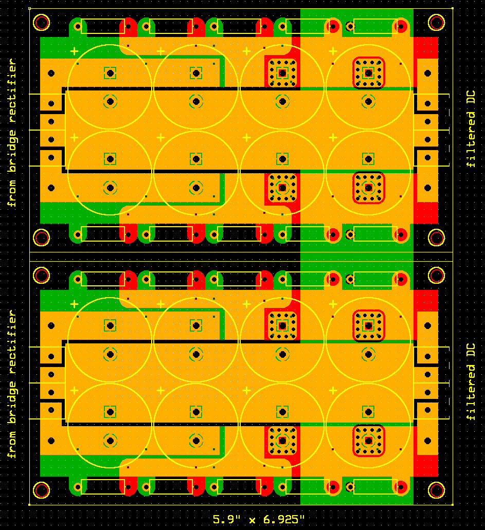

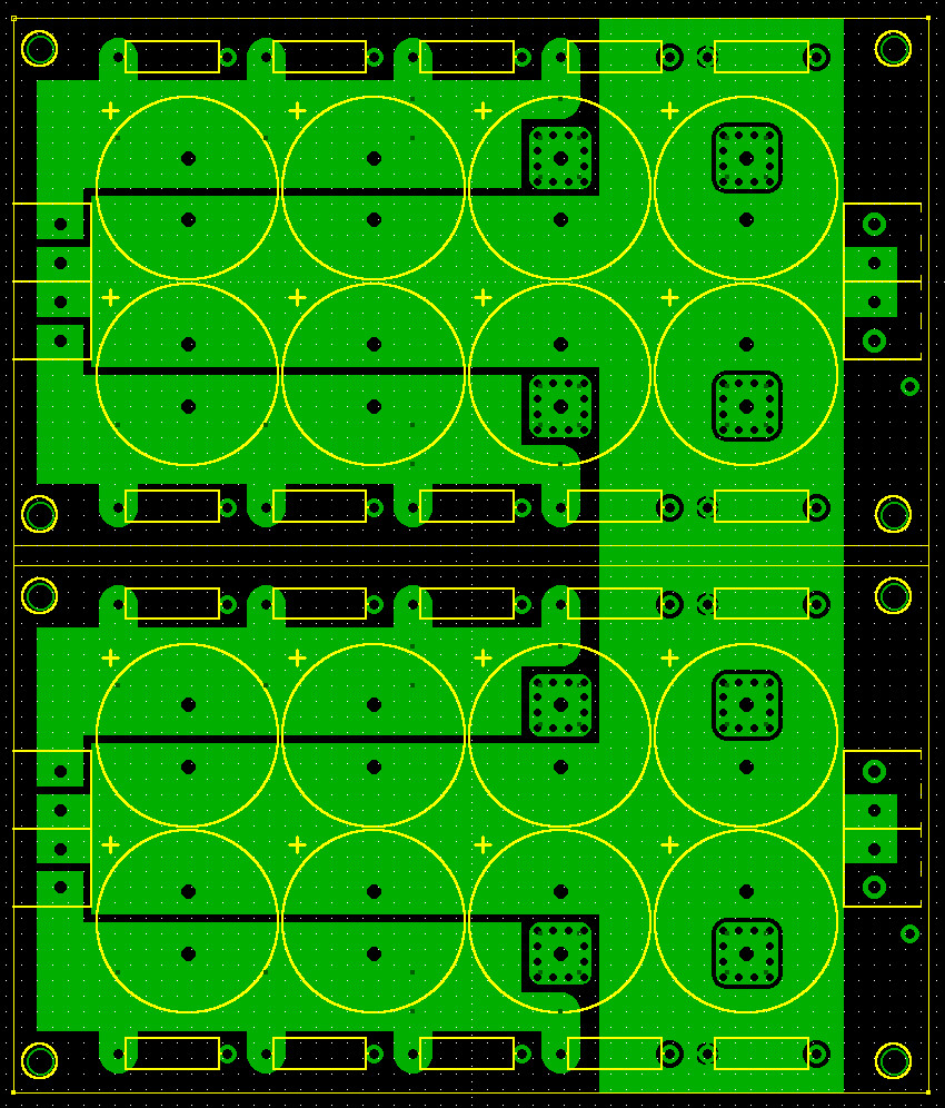

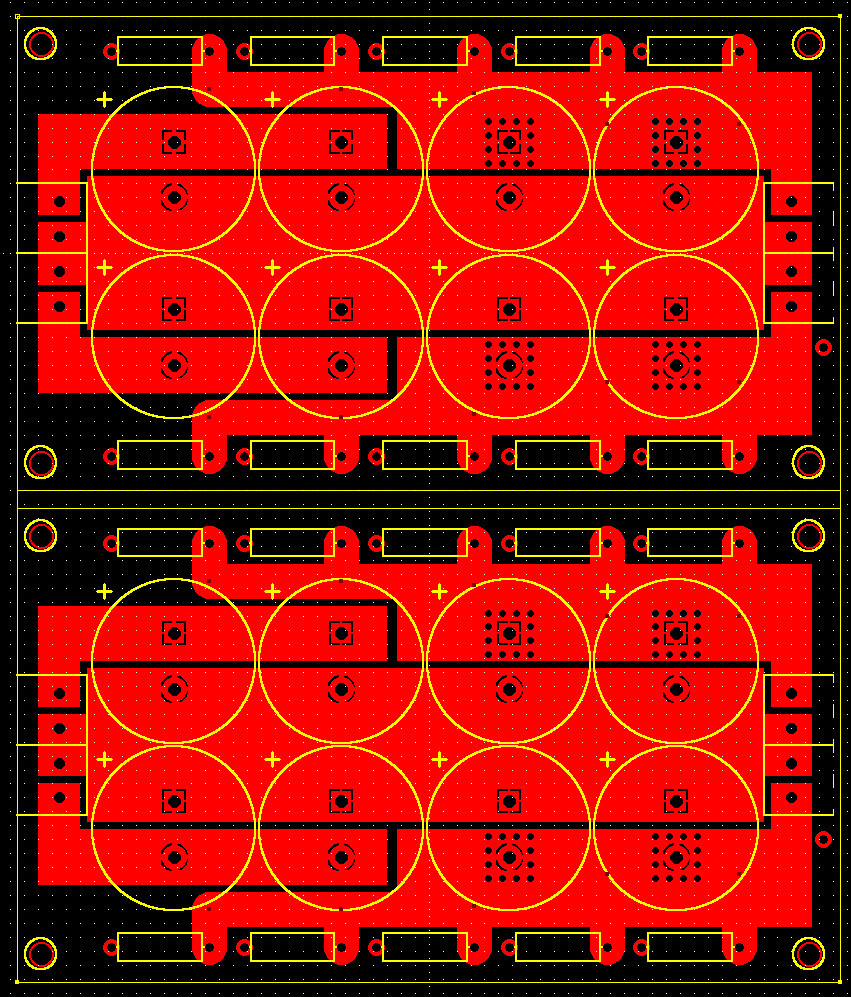

I have designed a new power supply capacitor board for the SIT3X (and other amplifiers). The board is to be fabricated for a stereo pair of channels, but can be cut in half into two separate boards.
The board was lair out using ExpressPCB, but the cost of fabricating it by them would be excessive. I am looking for a volunteer to convert my layout using a design program to can export Gerber files. The layout is shown below, in 3 images:
- Both sides
- Top side
- Bottom side
I could explore the cost of getting the PCBs made in India, to exact spec. It would be a fraction of the cost.
Yes, but they want Gerber files, which I cannot at this time generate.
Fab house can generate Gerber files and submit Layout and Drill details for verification before proceeding to manufacturing.
