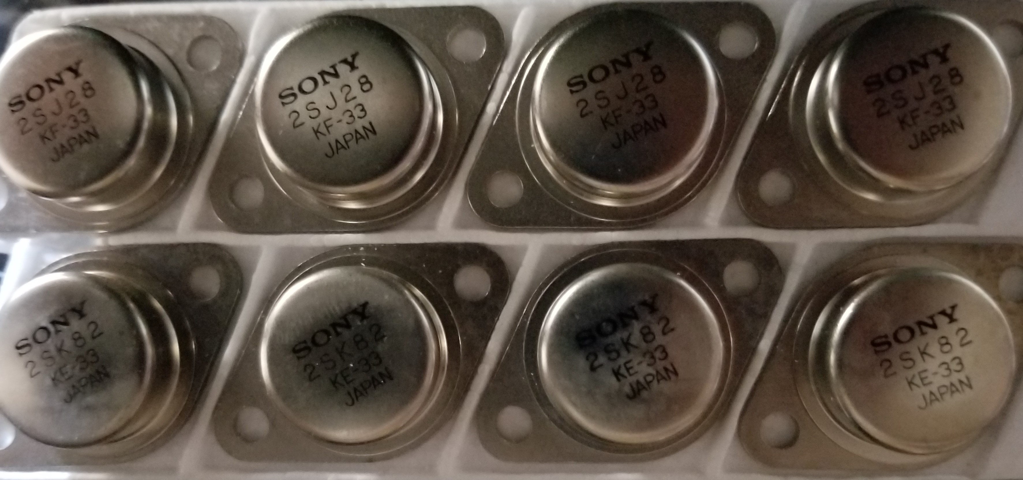

Sorry to be a bother. I am trying to sort stuff after my latest move and came across these. Could some kind soul please direct me to the correct thread, where I might be able to put these to use. Thank you!
You can use them as a gain device as well. Check Michael Rothacher's LuminAria and my All SIT 50W+ amp thread. You can also find 2SJ28 thread. Excellent device, indeed.
