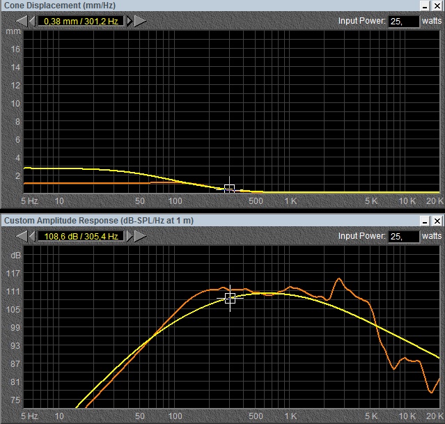

Coax-LF excursion
Just a quicky;
Curious how the Coaxial LF would be moving about in our concept (leave out the lows). I chose 300 Hz, as per the next concept, have the mid-driver (our Coax-LF) drive the "sensitive range" of 300 - 3500 Hz give or take. It's where our ears are at best and, as can be seen in our competition solutions overview (to be extended), is an excepted practice / finding of other DIY-members. It also may prevent the experienced horn-honk-ring as stated by some to be a coaxial no-go, I would think that will sit around 1000 - 2000 Hz. These frequencies are often experienced as fatiguing and overwhelming if applied wrong. The Coaxial horn may sound harsh here, so leave it out...
The picture shows both our current preferences, the Eminence Beta10CX (orange) and the Faital 8HX200 (yellow) in a 6 liter closed box (to sit within the Transmission line) High-passed @ 300 Hz applying 25 Watts resulting around 110dB. The 110 dB is the target SPL since our TL runs about this level with the Hypex 3-amp I intend to use.
It's a whopping 0.4 mm max predicted.
kind regards.

- The POOR man's Tannoy DMT - AKA "The PM-DMT"
