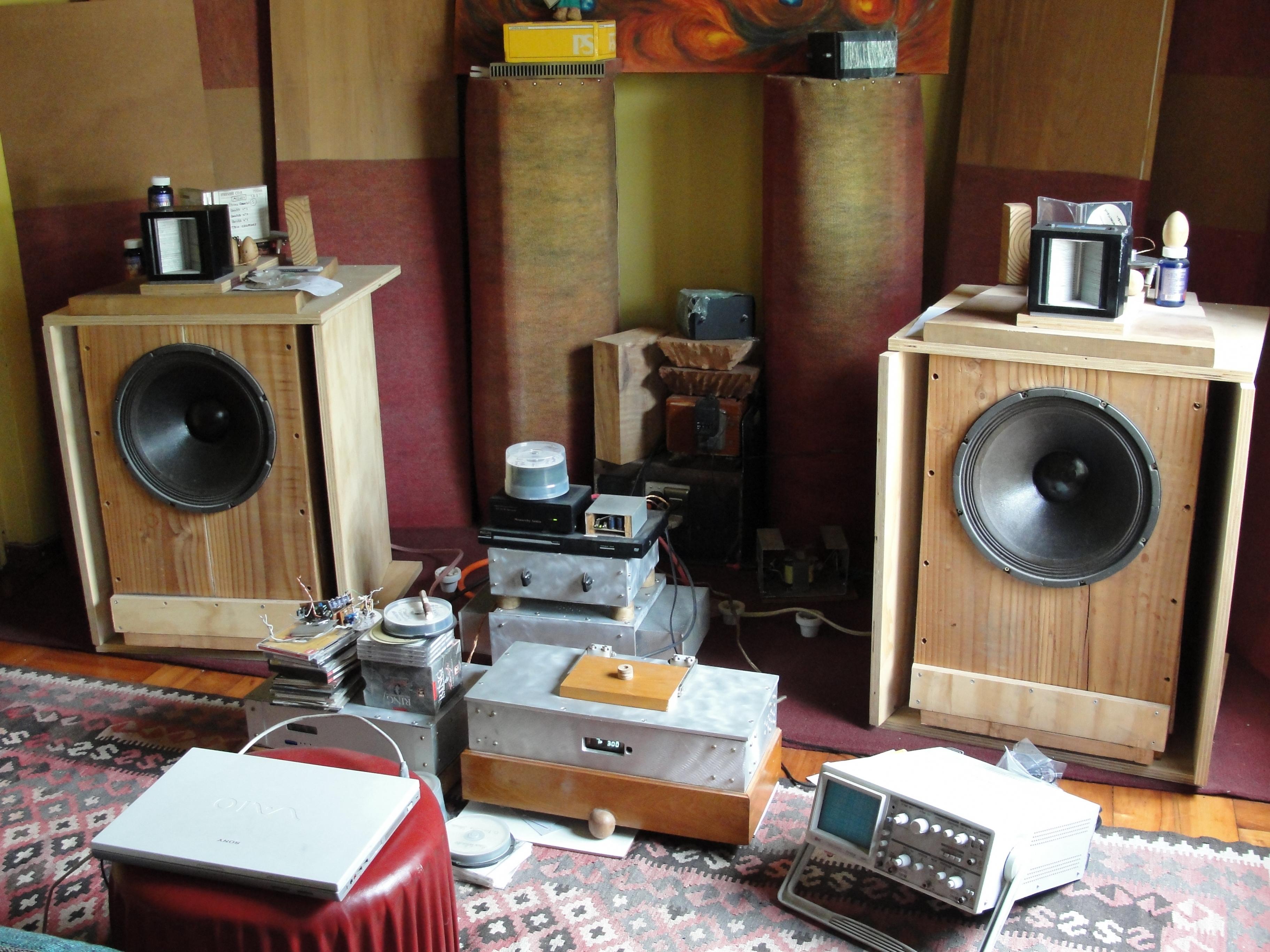

IMHO, if you want to make loud noise, go for the dual woofers + bass reflex. If you care about musical reproduction, go for single 15" coaxial plus parallel slit ports, like some Tannoy and Onken 360. Do not save on good quality plywood or better, real wood.
I adapted some heavy wood woofers to a kind of Onken 360 (previously bass reflex) and the bass is more correct. The original Onken can be modified to have extra wider bass horn and even a midrange horn, like the Autograph's one, could be added. :)

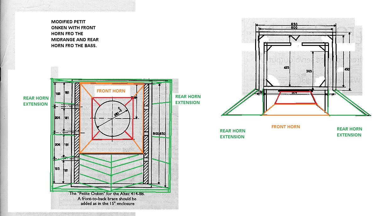

Hey Max,
Thanks to bring this up.
I am a BIG Horn fan and have build some in the past. One of them was a "correct version" of the Electro Voice Eliminator 1. What I did not understand at that time is that commercial companies need to cut corners to build affordable loudspeakers. Now a days, asking 20 - 60 K-euro's is apparently not an issue, which I can understand, but was a reason for me to dive into this an see if we could come up with an alternative for those that cannot afford.
Your topic;

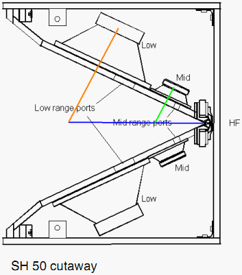

1 - We could incorporate a modern version (the tapped horn from Tom Danley) for the low range. That would make it bigger (you need to have a ¼ wavelength of the lowest freq. to play within the cabinet so to speak) and difficult, but not impossible to do. It makes the horn way shorter and still behave like a horn. No matter what, you need to squeeze a complete horn (or better the most importent part and enough of it) into a box and use the surrounding to make a complete again. They will always be kind of "little" monsters. The tapped horn front AND back loads the driver making a much better coupling (equal both ways of the cone movement) of the driver. The tannoy's have a low freq. back load and a mid frequency front load. Different animal partly.
Draw back of the corner loaded folded horn you mention here, is just this fact, it MUST be corner loaded (it's folded from the driver point to squeeze the length into a rather small cabinet (ahummm) and at the end of the horn path, use the wall to extend the horn. Since it's a trick used to make a smaller (part of the horn) version of the real thing (which would be immense). ADDING the fact that I aim for Studio control room ONLY here, where they will be placed some 2 meters form the console (flush mounted in your face so to speak) makes that It's not the same target. The tapped horn could be placed anywhere, although corner loading would make it LOUDER, not run LOWER.
Talking of the devil, while I write this down, THAT's a Synergy horn. :D horn loading ALL drivers, with the LF tapped, the MF front load and the HF at the start of the horn. I added a drawing of the animal.
2 - We could mount the coax in a mid range horn (conical or exponential) within the cabinet, that would not add up this much in volume (details to be seen). I haven opted for a coax as it acts like a point source in the MF to HF domain, so no acoustic cancelation, comb filtering issues. NOT the fact that the HF will be horn loaded, which is a kind of draw back as you correctly point out.
Come to think of it, then a Transmission Line would maybe be a better option, which is also a ¼ wavelength monster, but only back-loads the driver. a 12" would require at least a 100 liter cabinet to start working. Also does not require corner loading. Charles did that for the LF in combination with a 12" Tannoy coaxial.
So maybe no Bass reflex and horn load the coax. But, no offence, now we need to do apples by apples. A wrong designed horn will sound AWFULL, so will a bass reflex. A correctly designed horn will sound loose and natural, may out perform a correctly designed BR but a correctly applied BR could turn out nicely. They just completely different animals. It's also our ears that come into play here, our perception of sound works very odd in our brain.
But hey, lets first there to get an idea on paper.

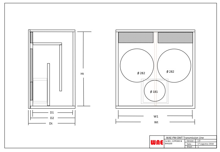

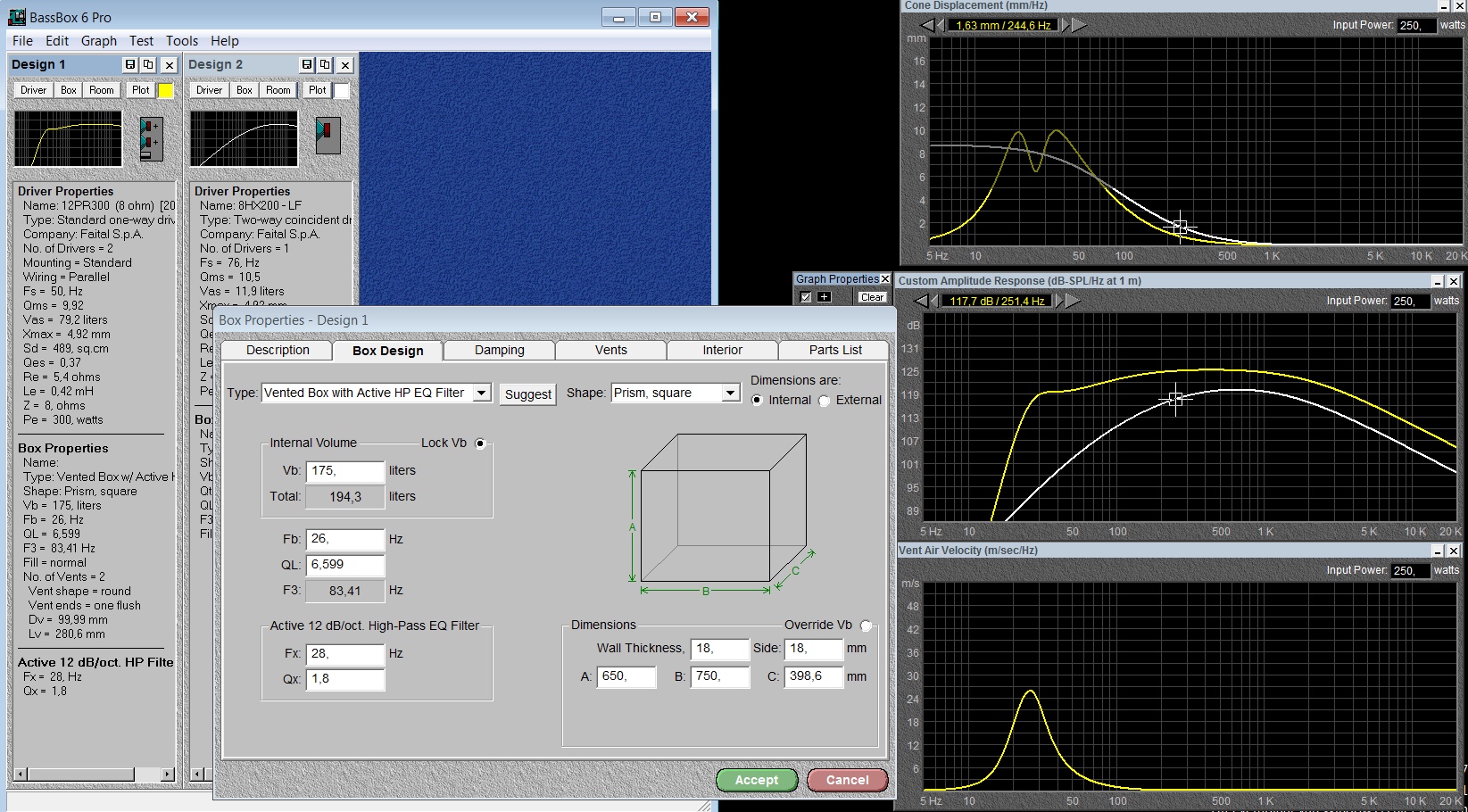

OK,
Just a rough sketch
Using Faital's (because I have them in store) 12PR300 & 8HX200.
This is the bass reflex version. I feel a strong urge in getting a TL version as well.
30 - 20.000 Hz +- 3 dB. Don't mind the x-max warnings here, the Faital can handle this with ease, xlim = 14 mm.
Note the Coaxial hardly moves at 1,6 mm @ 250 watt. Need some eq'ing as to be expected.
See attachments for details, drawing in pdf NOT TO scale (yet). Gives a first idea.
KInd regards.
  • WAE-PM-DMT-v1.pdf
