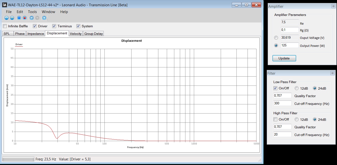

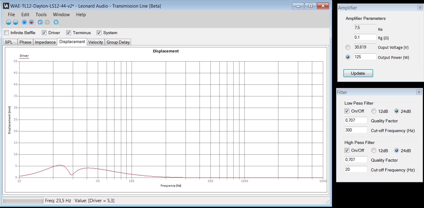

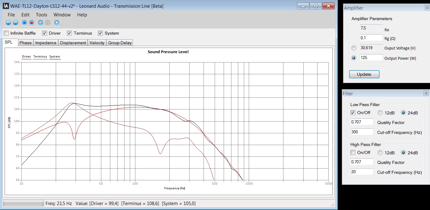

As promised, I would dive into filtering the 12" in the TL yes or no.
The outcome is clear and simple, looks like a must do. Remember we want to use the Hypex, which gives 250 watt at 4 ohm (which is 2 12" drivers.
Resulting in 125 watt per driver, so that's what I used.
I simulated 2 cases;
1 - With a high pass @ 20 Hz, Q = 0,7 and 24 dB / oct
2 - WITHOUT this filter
That's the only change I applied.
See the attachments, the first is WITH high pass, resulting in 5 mm excursion around 23 Hz as a max.. The second shows WITHOUT the high pass, tells it all. We will kill the driver in the end. Reaches 10 mm around 20 Hz, which is it's xlim. Now it may not be likely we have loads of material that require full blown 20 Hz, but we want a solid Studio monitor that can take a beating.
Conclusion: High Pass required.
Also, attachment 3, this is what the SPL influence is WITHOUT the high pass. A rise off 1 dB around the tuning freq of 28 Hz. Nothing spectacular so it's not SPL we need the high pass for.
kind regards.

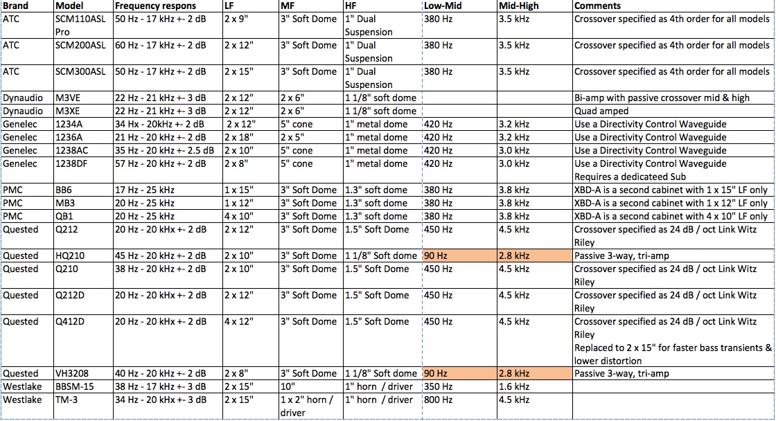

Crossover frequencies of the competition
As promised, I would scan the WWW. Did and found some facts in sharing the same strategy in between each company in this overview. I did scan for 3-way, Main Monitor (not mid-field or near field), active systems. ONLY used the official web-sites and the documentation they provide.
There may be other brands, but this is kind of popular. In case you want to point to some others please do so.
Looking at the big picture, they go kind of the same route by a margin;
- ALL use Bass Reflex except for "the Transmission Line Guys" PMC
- All have 2x LF, most in one box, some in 2 boxes with a LF only add-on which appears to be the same as the Full range cabinet.
- 12" is very popular
- NO ONE uses coaxials, well Genelec does, but NOT in the Main monitor section.
- ALSO found my point raised in the previous post, most cross between 300 and 400 Hz to MF and around 3kHz+ for crossing to HF.
- Most use a 3" Soft dome as the MF, for that area.
- Frequency response is not always measured the same way, take that into account.
Attached is the overview.
Note: the 2 orange coloured fields hold some strange values, crossing to a 3" at 90 Hz, Hhmmm
The comment field shows some specific details.
kind regards.

Me-geithain speakers are coaxials, but they are using dome tweeter front of a woofer. You missed Tannoys from the list surely coaxials sound great but perhaps there are some aspects that are more important in studio world where coaxials lack? Might be the ~1-3k crossover point one has to use due to the woofer starting to beam, conebreakup issues, dynamic nature of the horn and things like that which can be avoided with a different design like a three way with smaller mid driver. After all studios are more controlled listening environment than homes or live venues where coaxials can be seen.
Hi wae, I don't know much about DMT 215, but I guess it is staggered woofer configuration like UREI 813C, without low cut for the MF unit, so coax part would be a full range, so if you’re doing something like 3 way, I’m afraid it would be different from your original concept.
If your goal is accurate reproduction like studio large monitor, I also would like to note that professional studio large monitors are designed for soffit mounted in acoustically controlled room, and won't sound as expected if they are put on the floor or on the stand in our living room.
