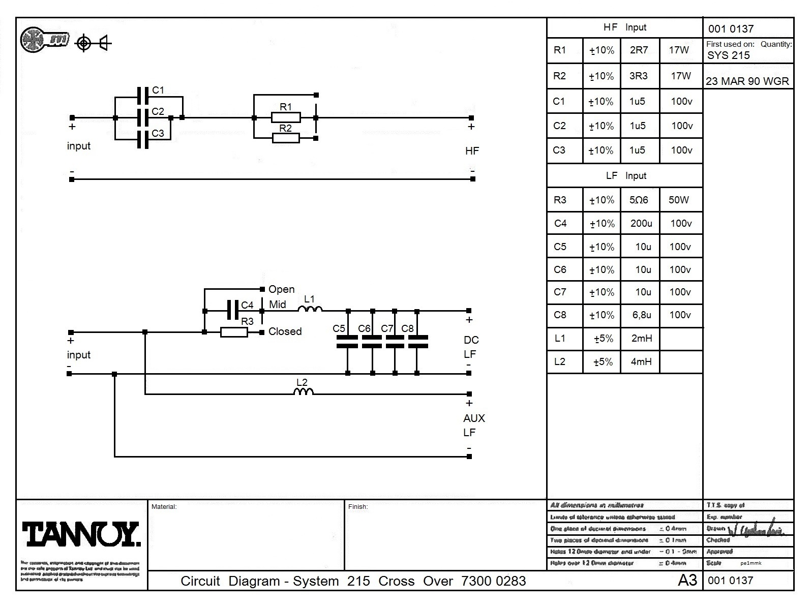

DMT 215 cross-over and Where to cross what
This appears to be the cross-over for DMT 215 setup.
It will be an interesting issue, placing the drivers (distance) and since we will be using 2x 15" (or 2x 12") of which one is the Coaxial we need to think of how to use the 3 drivers (2x LF and 1 HF). ALSO, I want to have the LF's to be identical, so NOT using one Coaxial and some "other" LF to fit in. Looking at the DMT's and FSM's, they always use LF with identical characteristics. I did read an article by Tannoy stating that they started the FSM and DMT by experimenting with 2 coaxials, of which one had the HF disconnected. This way you would use 2 identical LF drivers, sound the same, behave the same, parameters and electrical behaviour to the amp the same.
In our case, using 2 coaxials and add 1 HF to one of them, we could use a 1 ⅜" bold (long enough to fill the hole) to close the screw-in gap for the HF of the other coaxial. :p
The coaxial is a point source by default, crossing to the HF should be related to the LF's capability on producing "HF" (more like Mid Freq. / anyway as low as possible) and the ability of the HF to play low enough. Lets call this LF the coax-LF.
Blending in the other LF (Lets call this the sub-LF) with the coax-LF is an issue (acoustical interference). My view on this: The distance between the acoustic centres of both drivers (32 cm for the 12" / 38 cm for the 15" when placed tight against each other) makes for the ¼ wavelength giving the max frequency to cross the LF's. That would be some 250 Hz point (give or take).
Am I right here? (I would expect this to be the case).
If we would go 3-way (Charles advice) this freq. will be the Low Pass of the sub-LF and the high pass of the coax-LF. Adding a low pass to the coax-LF which is the high-pass of the HF would make the principle of the filter complete.
If we would go semi 2-way (my first thought) then the coax-LF would not get a high-pass filter. The ¼ wave distance between both LF would determine the low-pass of the sub-LF to avoid the acoustical interference. So both LF's would play the low notes up until the low-pass point of the sub-LF. Gives a more solid LF, which is what we need.
Looks like the filter opts for Charles way.. (I am not a cross-over expert, learning here:D) but shure looks like it.
3-way summary;
sub-LF < 250Hz
coax-LF 250 - 1500 Hz
FH - > 1500 Hz
semi 2-way summary;
sub-LF < 250 HZ
coax-LF < 1500 Hz
HF > 1500 Hz
that is IF the HF would be able to go not lower than 1500, we have some that can go to 1200 Hz.
:nod: or NOT? Comments?
