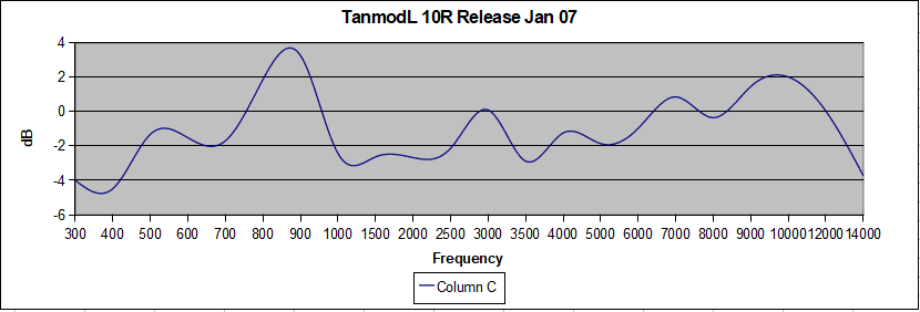

I don't have the individual measurements to hand. I managed to dig out the final measurement. You can clearly see the resonance at 900Hz. This was a passive xover and very hard work to achieve this level of performance. The microphone I was using was a button electret which couldn't be trusted entirely. Note the absence of any mid band suckout which can plague coaxials. Disregarding the one peak, it came out at +/- 1.5dB for most of the important mid range. Now I use B&K 4165 mic as I found that once a speaker gets to within +/-2dB, 0.5dB trims can be heard and need to be measured.
The peak does not manifest itself in a bad way. It actually makes drums sound more dynamic than they really are. No speaker is perfect and I have encountered some truly dreadful 'studio' class monitors.

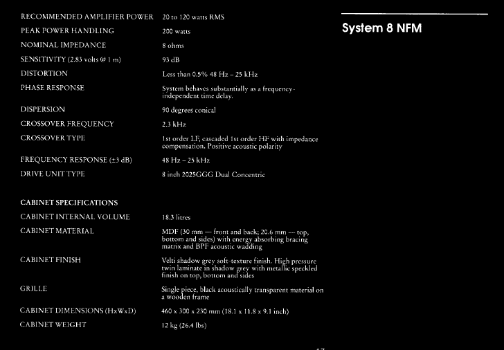

As a follow up, I dug out some more info. The brochure for the NFM8 indicates 2.3KHz for the crossover, but the driver is listed as the 2025. It also states low order crossovers so this would explain the higher frequency.
Another point is the frequency response. The one I posted may not look as flat as people claim for other designs. It is a single measurement, not averaged. What it does indicate, is that with DSP +/- 1dB maybe possible.
In another thread someone asks what should be the design goal. Not all measurement methods produce the same results which complicates matters. The Saturn had a review with a frequency response plot. This showed mild midrange depression. However, when I measured it, the mid range depression was severe. So either my method differed from MLSSA which is commonly used, or Tannoy had a different crossover revision.
I don't have access to MLSSA, so cannot compare directly. However, it seems to me that MLSSA does not reveal all the gory details because it is an indirect method. I use gated sine wave which reveals edge diffraction effects from the drivers themselves, not only the cabinets. I also make measurements at less than 1 meter which accentuates defects.

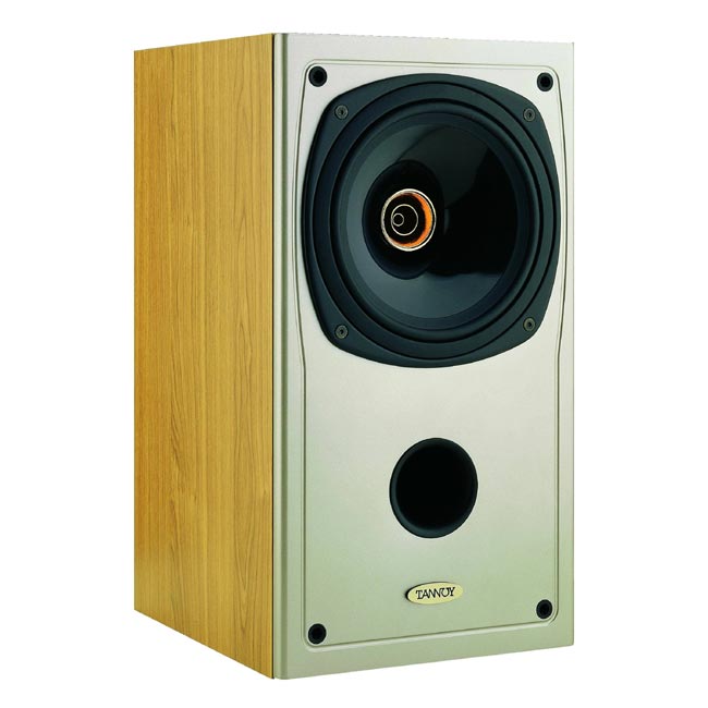

Correct, how-ever I have the Series II, which has a 2036 Driver and passive filter Second Order Low, First Order High @ 1700 Hz. There is a spreadsheet at the Tannoy Hilberink site I got the info from, which is consistent with my series II brochure.
Must be quit a different driver, also higher Pe (from 120 to 200 Watt).
The lowest cross-over I found, Tannoy used on DC's is 1000 Hz, highest 2500 Hz (on the the 2033 & 2041). They go all the way up from 1000, 1100, 1200 etc.
