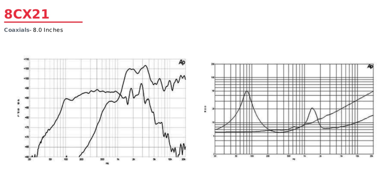

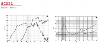

Did a quick peek, look worth diving into. See attached image as found example.

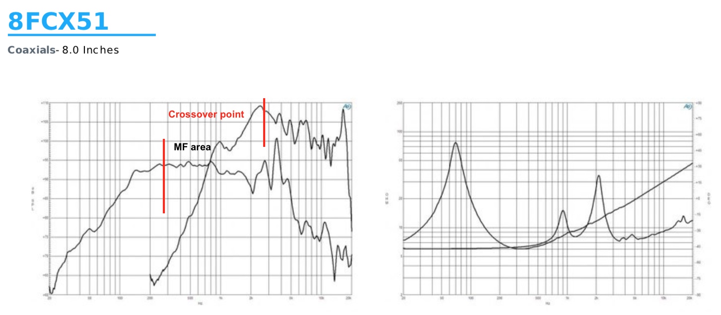

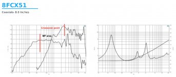

Thanks tmuikku,
Never heard of Fulcrum, but shure fits in this approach. I also did find that they use B&C, but most likely have their own version with a horn added for the HF. Have to check whether Hypex supports FIR filters. I did see a FIR config file for ICEpower amps.
SO, also did have a quick look at B&C (I use some of their components) and found a nice LF and Coaxial 8" versions form B&C.
MOSTlikely, I will start with the 8" PM-DMT, 2x LF and 1 Coax for 270 euro's. The work very well in a transmission line, where the Coaxial 8" need 3 liters to sit in the Transmissionline. ALSO, the required LF offset for the B&C 8" leaves enough room for the COAX to sit between the LF and the terminus of the TL 😀

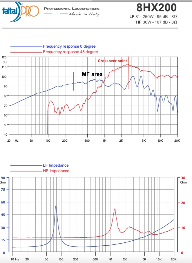

I Wae,
Your plan seems like a good one to me ( in fact it is not very disimilar to what i plan for my next loudspeaker which is itself influenced by a commercial product availlable at the moment! 🙂 ).
About FIR, well in the Fulcrum/Presonus approach it does make sense to counteract the effect of horn in the area just below crossover point. This is the most interesting point in their strategy in my view and could renew the interest in the Urei approach of coax.
Not sure it can be as interesting for a Tannoy approach coax. Once you hipassed the medium you really limit the most objectionable point (lf mod of the cd through the cone) of the principle. The second objectionable point is the smoothness of transition between horn and cone of medium which induce some issues in the high.
Maybe FIR could help about that but i doubt it. If you plan to use FIR only for filter duty it may help with potential break up issue with the woofer or protect the CD but nothing more to be gained imho. Tannoy gave some nice evidence that asym not too steep xover slope are efficient if the woofer is well behaved. Abit of delay to compensate for driver offset and this could be all needed for a quasi perfect point source.
Don t take me wrong though i use a FIR filter with my present loudspeakers and plan to keep/use it with my next speakers which are going to use coaxial.

Which Coaxial... B&C OR Faital Pro
Did not spent much time on the project last weeks, BUT this one question keeps running around in my head:
"Which of the 2 coaxials are we going to use in the test version of the PM-DMT???"
B&C 8CX21 OR Faital Pro 8HX200. 😕
The idea was to use the Coaxial in a sealed box within the dual TL box and HP the Coaxial LF (= our MF) around 300 Hz, then cross the MF to HF around 3 kHz (2k2 or higher is specified). Which means I "don't care" about the behaviour of the MF and HF OUTSIDE those working areas.
- Price wise, the B&C wins with around 100 euro's cheaper.
- Since we will use a sealed box, the LF part (being our MF in this concept) is not that critical. ALTHOUGH the B&C wins here, being slightly flatter, see "MID AREA".
- The HF of the B&C is VERY rough, as can be seen in the frequency plot attached. Looks like the Faital pro wins here. Having said that, I could correct this with the DSP. Which brings me to my doubts here, is a flat frequency response by design of the driver (it's behaviour) "the same" as a DSP corrected originally "non flat driver response", resulting in a flat response.
The DSP processes the signal anyway being a 3-way system, but for the B&C we need to correct at least 4 !! areas using VERY high Q-factor filter settings, where the Faital could be passed almost straight through, with a gain reduction of 1 area.
I don't care that much in spending some time figuring out the optimal DSP settings.
- Dispersion wise, I don't have enough data at this point in time. The Faital seems to do well with around 100 degrees@2kHz to around 60 degrees @ 20kHz (-3 dB). I don't have detail on the B&C at this point in time. Provides enough sweet spot area when placed correctly for a good sound stage around the mixing desk.
- HF impedance behaviour more or less the same in the range we will use them.
- Since we use a DSP anyway, filter wise it isn't the complicating factor. Passive filtering is another ball game I suspect.
MY feeling: Although more expensive, Faital 8HX200 wins as far as the HF is concerned.
YOUR thoughts ??
kind regards,
Frans
YOUR thoughts ??
kind regards,
Frans
