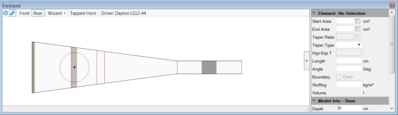

12" TL version design for the PM-DMT

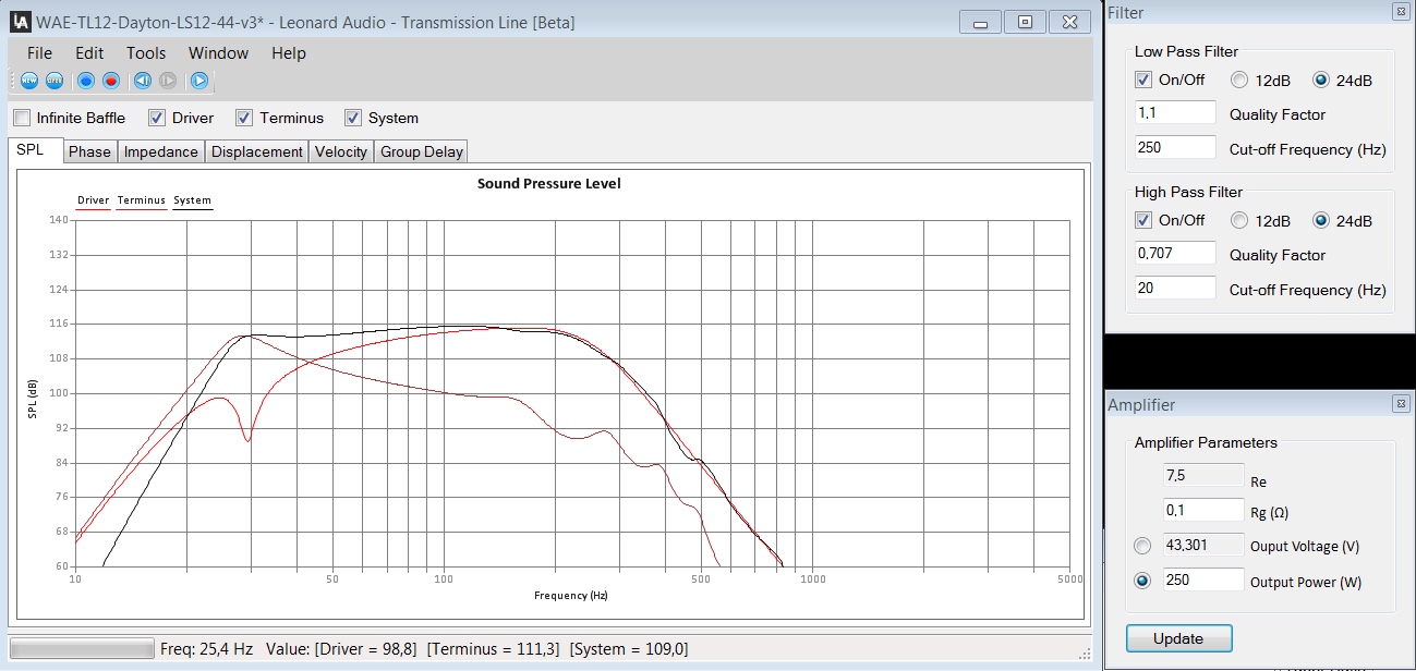

As previously discussed, it would be nice to have a 2x Transmission Line LF.
Here is a nice start with a Dayton LS12-44, which has a flat cone, comes at around 140 Euro's, sexy..
Apart from being sexy, it appears to love TL's. +-3 dB point is around 25 Hz in a cabinet with internal dimensions of 76 High, 57 Deep and 35 wide (centimetres that is).
I used Leonards TL software. Also, to figure out where the damping needs to go, I slice up the TL, so to be able to find those places by adding High damping as a check. That way you can see the effect in the Freq. response and xmax. Typically, I find that there a 3 (almost obvious) spots which require some kind of damping.
- The closed end of the TL (works for almost the entire spectrum).
- Right around the driver (tame the low-mid 1e order? dip, which is also controlled by off-setting the driver)
- In the last segment at the open end of the TL, control the high end of the spectrum).
kind regards.

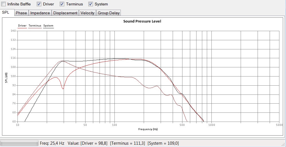

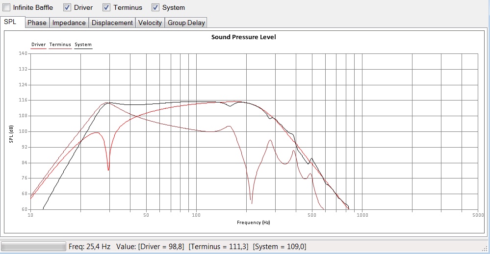

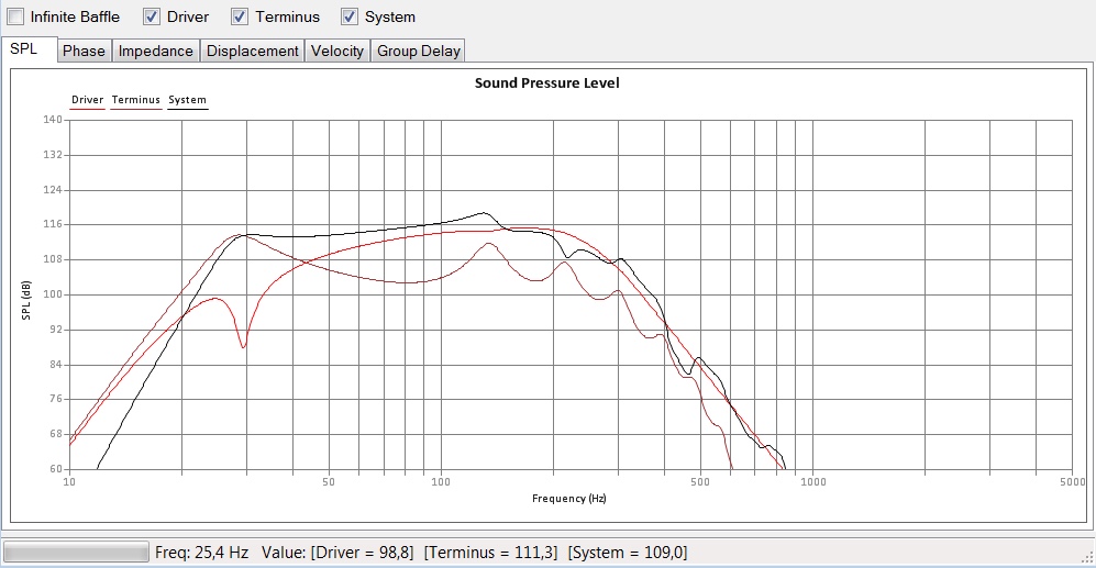

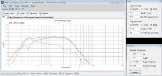

Damping a TL with Leonard software (as a start)
I guess that should be "at least 3 spots...". To be completely honest, I still have to build my first TL, which as I understand will improve my panel fixing skills by a nice margin. It would take a lot of adding / changing and removing damping material while listening and measuring. Construction of the test TL so that one side panel can be screwed on and off a lot of times without leaking. 🙁
Just hoped that by doing it as described in my previous post. If we can design a TL with this software and take our trust in it, why would applying damping material with the same software be WAY off. So, as a start I currently trust the software and therefore the damping starting point.
Question will always be, HOW does it SOUND. Most likely, we could damp all the live out of the TL and still have a nice graph. So testing and measuring comes in as a must.
What I did here is apply the bare minimum and have the SPL level as least influenced as possible. Assuming that this would keep the TL alive... 😀
I added 3 frequency graphs to show the different effects;
- First graph with NO damping in the last (open ended) segment
- Second graph with NO damping around the driver
- Third graph with NO damping at the closed end of the TL
Look at the SPL level in the effective area we want to use (25 - 250 Hz). The damping at the closed end impacts the SPL mostly.
comments / corrections always welcome.
kind regards.

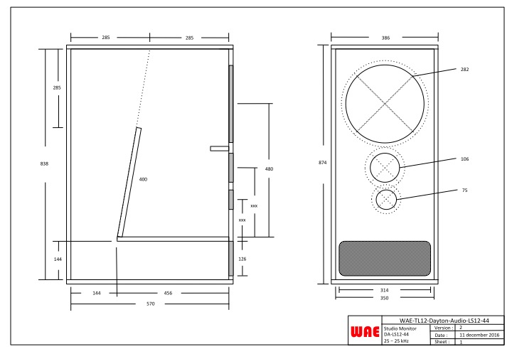

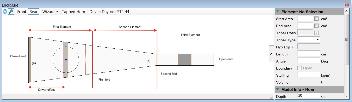

The TL design squeezed into a cabinet
Next, I made a sketch of the cabinet that is to hold this design.
Personally I like this 2 fold, 3 element version. It is very simple to put in to a cabinet.
Looking at the picture I added of the TL design;
The second element will be 180 degrees turned and placed against the first element. The third element goes against the bottom of the first and second element. Both the first and second element have the same length. The length of the third element is the sum of the closed end size (a) and the smallest side of the second element (b) and the thickness of one panel (18mm).
Note: the dotted line can be ignored, it's a slice of the first element that I used to determine if another damping spot was required. With the Leonard software, you can split an element. You get an new element within the existing element so to speak which you can move around and change in size. Adding damping to this slice shows the effect on the frequency graph.
Second picture is the design, in this case still with a separate MF and HF driver. For our PM-DMT, we need to put hold of the closed cabinet for the coaxial into this design. It's about 3 litres, so not a big deal.
Note: Sizes could be in-accurate, have to do a final calc. 🙂
kind regards.

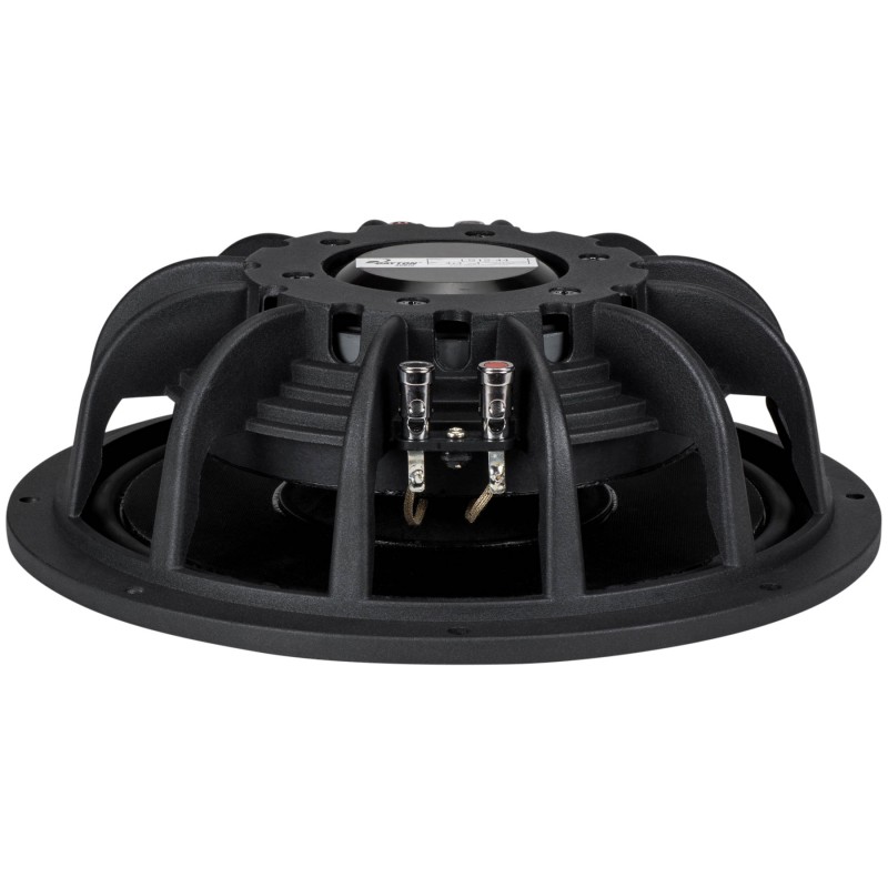

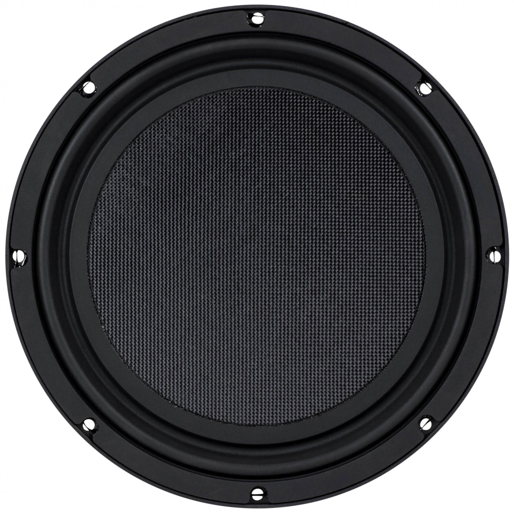

This is the Dayton LS12-44. Something different

For the Hypex (250 - 250 100 watt), the Dayton LS12 & Faital 8HX200, it would give;
LF = 4Ω (2x 8Ω parallel) @ 250watt = 115dB
MF (Coax LF) = 8Ω @125 watt = 116dB
HF (Coax HF) = 8Ω @ 50 watt = 124 dB (estimated)
So the HF needs to be tamed as te be expected. It will only handle 30 watts max = 122dB (@32watt). So it needs only 8 watts for 116 dB.
So we need 250 - 125 - 8 watts at the above given load which will give 115 - 116 - 116 dB. We're safe.
Side note: 116 dB @ 2 - 3 meters distance is quite a handful, AKA loud enough I guess 🙁

Next step:
I will make up a detailed design. The Coax needs to sit IN the TL, which will only take 2 -3 liter. I'll check but most likely, since we want to use the 8HX200 above 200 HZ or so, a VERY small closed box will do. (build a closed box that follows the contour of the loudspeaker). 😎
p.s. I already did check to put a small (3 liter) object within the TL in Leonard software, ZERO Impact.
kind regards.
- The POOR man's Tannoy DMT - AKA "The PM-DMT"
