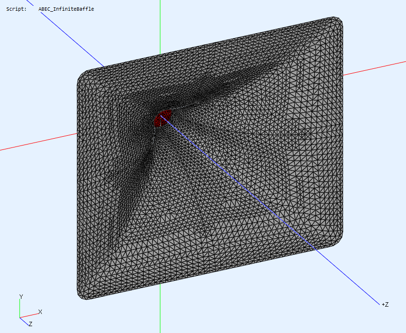

This is the biggest one yet, and also the best performing. Adding a big ol' roundover really smooths out the frequency response and the polars. This waveguide measures 28.1cm x 31.2cm and the overall enclosure size is 38.3cm x 49.2cm x 30cm.
Horizontal polars. Magenta line is 45 degrees. Beamwidth is about 120 degrees from 500Hz to 2khz, then gradually narrows from 120 down to 70 degrees from 2khz to 10khz.
Vertical polars aren't a whole lot different than the horizontal polars. It's challenging to make a wildly asymmetrical waveguide in ATH.

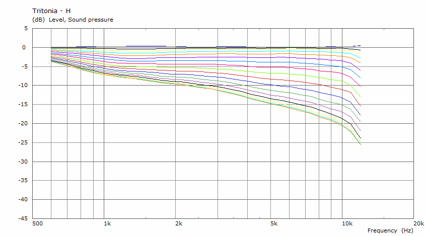

You can put an SB26 into a Tritonia waveguide and get this result, very even between Horizontal and vertical

And the back can be made flat quite easily if you want to unitize/synergize/MEH it, is there a reason you want it to be highly asymmetric?

Hasn't mabats easy way thread pretty much dispelled the notion that "driver parameters are a very large part of a proper horn design"? Seems a proper horn design is a proper horn design irrespective of what driver you mount on it? Maybe driver parameters are a part of a horn system but not the horn itself. Also maybe I'm wrong.

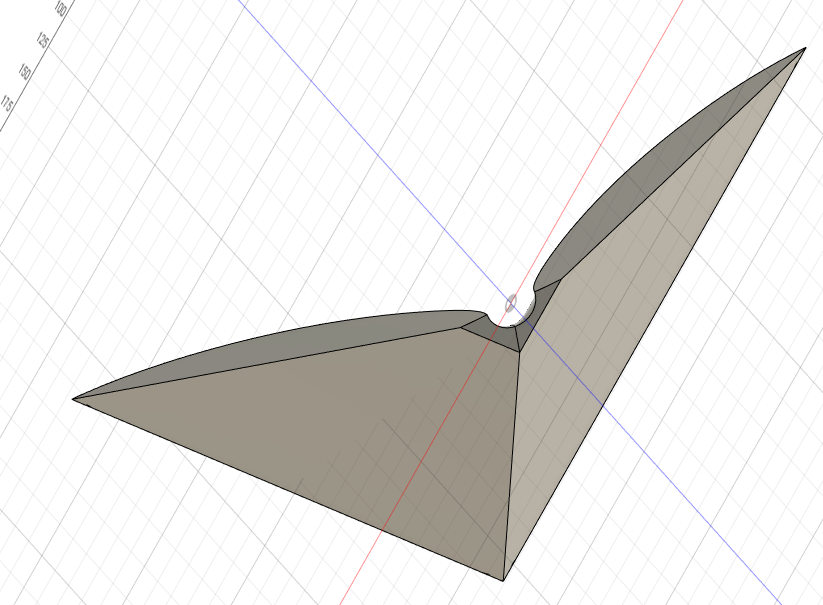

Here's a pic of the waveguide
It's very reminiscent of the JBL progressive transition waveguides popularized by the late great Zilch, but mine is symmetrical and made for a SB Acoustics SB26 dome.
Here's the predicted horizontal response. The PT waveguides (and my waveguide) have a little bit of a diffraction slot, which increases output a few dB on the low end, at the expense of lumpier response. This waveguide has more consistent directivity than the one I published two weeks ago.

Here's some sims from Mabat of his "Tritonia" waveguide. They look very very good. Not that being on an infinite baffle and NOT having a diffraction slot will smooth things out. I made an engineering decision to use an enclosure (of course) and a diffraction slot to improve the loading.
I understand that desire, I wouldn't have spent so long designing my own otherwise 🙂The Tritonia looks really good, and I may well go that route. I guess part of my resistance is that I want to say I designed the waveguide I'm building lol
I do think you are barking up the wrong tree with the slot though, the Rad Imp weirdness shows up in the frequency response and you seem to have "loaded" the 12K region which I don't imagine was your intention.
