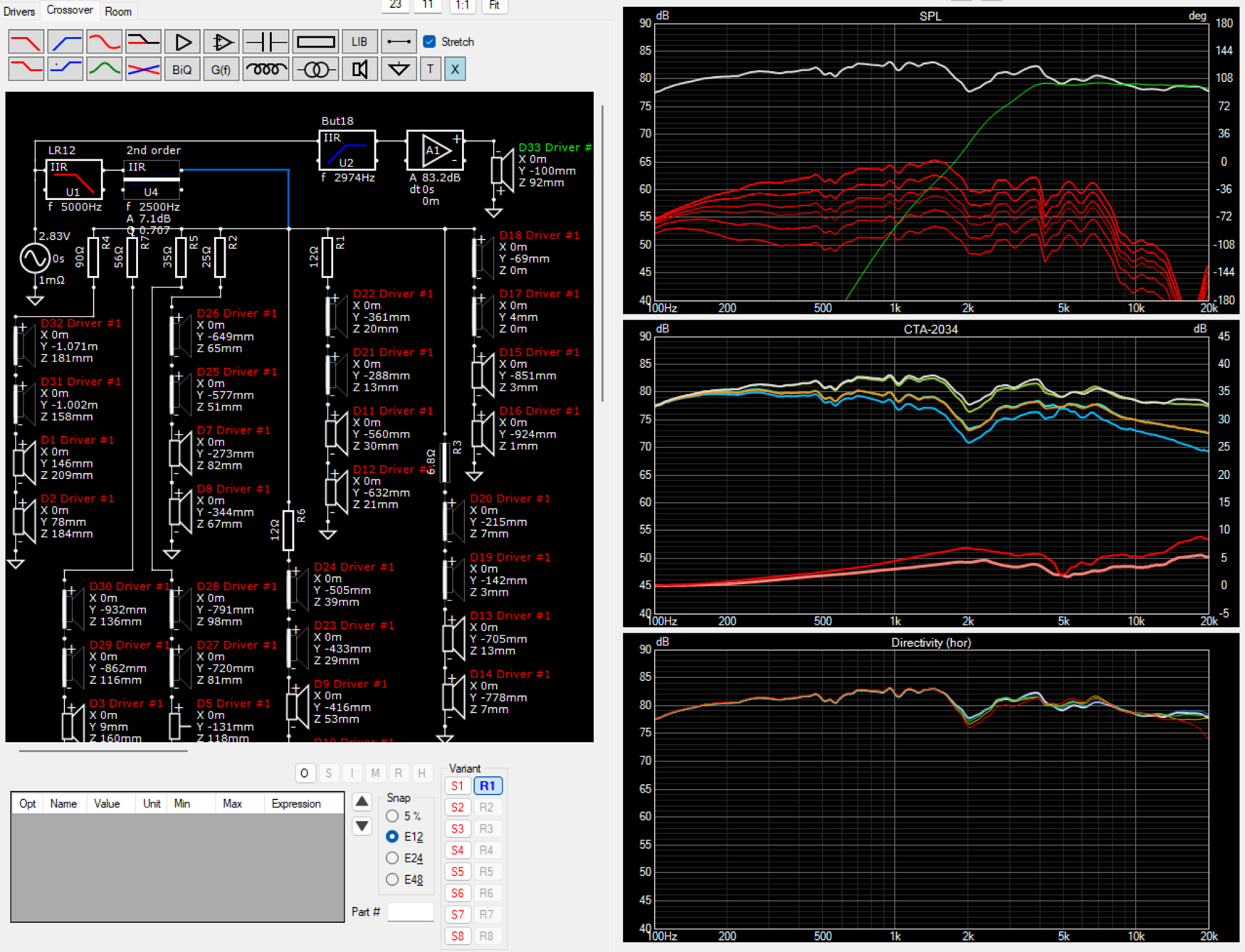

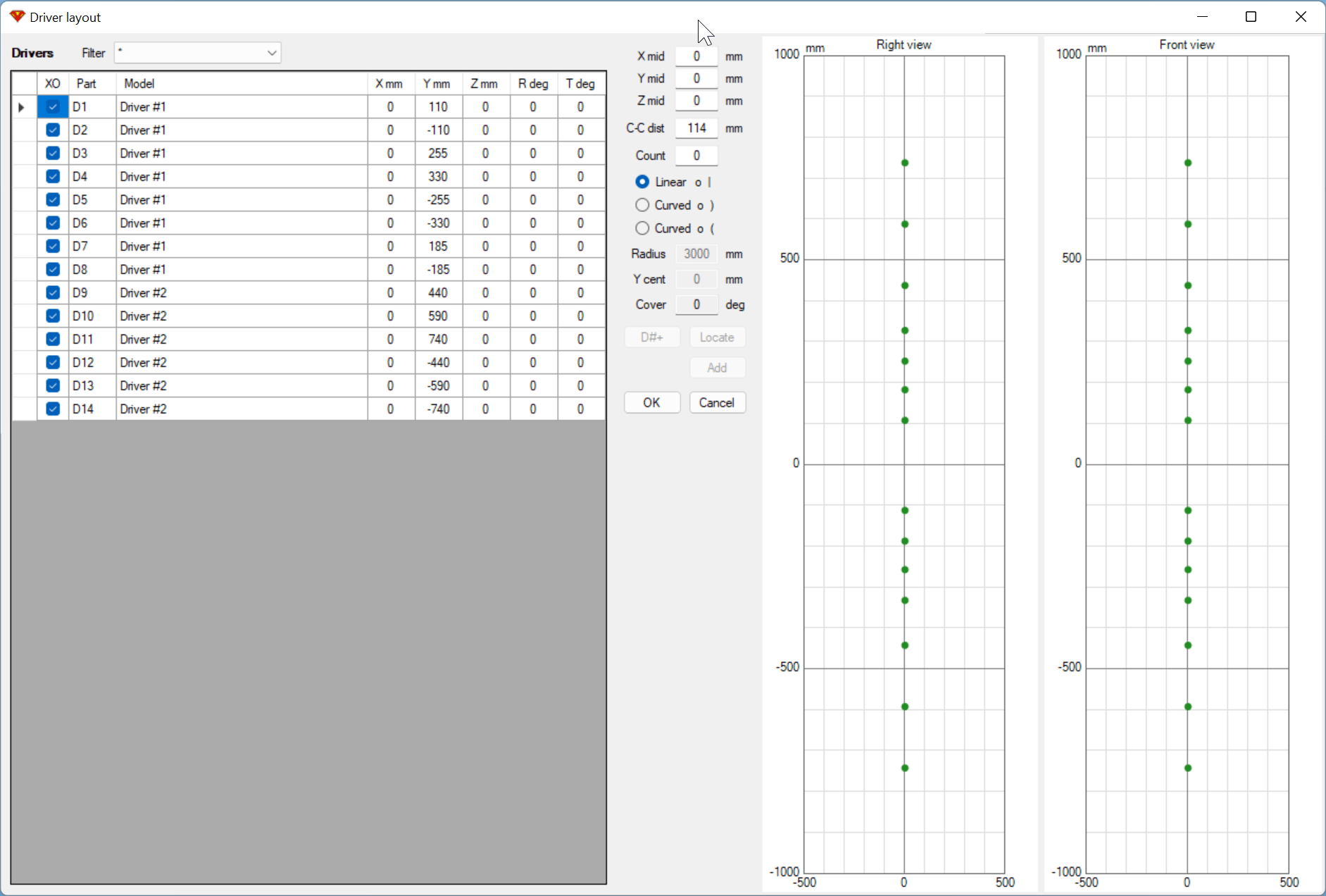

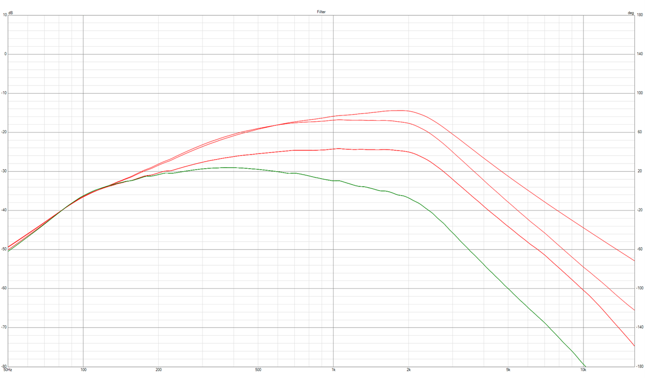

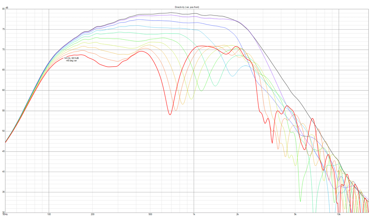

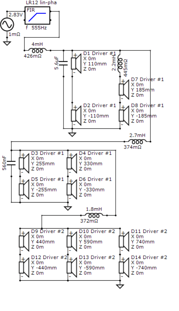

Leveraging some inspiration from Dave Smith's thread (https://www.diyaudio.com/community/...heir-behavior-through-simple-modeling.388279/) I came up with this shaded array that might work well with a tweeter in the center - as long as the vertical directivity of the tweeter is very narrow. A ribbon or planar might work.
The first file that's attached is a zip file with the VituixCad project, along with the ZMA files for the drivers. For the frequency response, I just modeled the Dayton ND64 midranges as if they were ideal pistons, since I'll be using them below a frequency where they beam. (They start beaming about 6khz.)
Random observations:
1) I intentionally left a gap in the center of the array. The idea was that a tweeter or a Unity horn with narrow vertical directivity would go there. I was pleasantly surprised by how high the array can play; I'd estimate that it can play up to about 2500Hz using 2.5" midranges, which is pretty good performance I think. I think I'll actually modify it to use larger woofers than 2.5", on the assumption that there are plenty of tweeters that can play down to 1500Hz.
2) There's a gnarly off-axis null between 600Hz and 1khz. Not sure if this is a concern. I tried messing with the polarity of a few elements, and was able to make the null go away, but when doing so, it makes the vertical directivity too wide, which probably isn't what I want. Basically you can get response that's a bit like a Bessel array by flipping the polarity on one of the fourteen elements.
3) I used a mix of 2.5" (Dayton ND64) and 5" elements (MCM 55-3870.) The idea is basically that the outer elements in the array don't need to play above 500Hz, so why bother using an expensive 2.5" woofer? A single MCM 55-3870 has more output than two Dayton ND64s and costs half as much.
4) I intentionally did everything using passive components. I'm not keen on paying for ten channels of DSP and amplification. The cost of inductors gets ugly in a hurry and is one of the reasons I'll probably redesign this project. For two speakers, the inductors alone cost about $100.

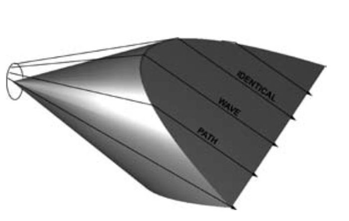

Hello, I don't speak your language, and I hope my translator will do a good job.

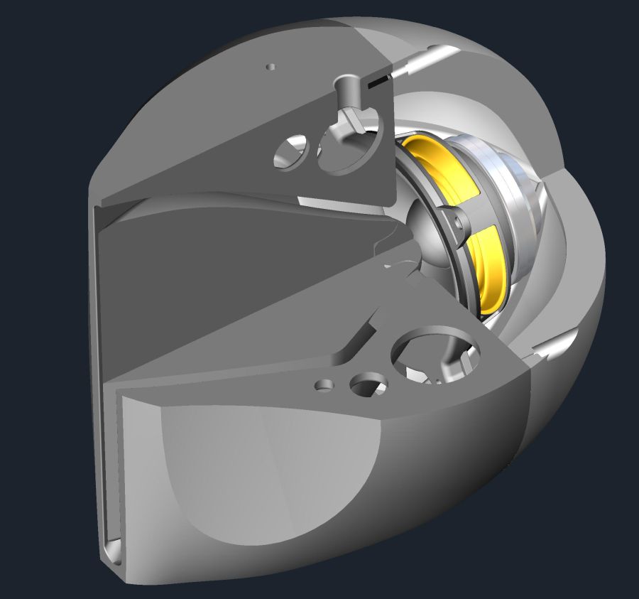

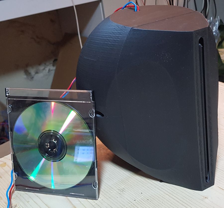

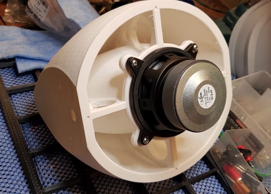

I use a waveguide inspired by the "DOSC" invented by Mr Christian Heil.
My prototype is equipped with a 4" loudspeaker with a waveguide. I obtain at the output a cylindrical wavefront with a regularly decreasing amplitude in the high frequencies. The directivity is 180° on the horizontal plane and very low in the vertical plane.
The loudspeakers are stackable to cover the desired height. There is no interference between the speakers, because it is a cylindrical wave stacking. The height of the speaker is 8 ".The floor and the ceiling are not affected by the sound waves. To further reduce reflections with the side walls, I place the loudspeakers face to face in recessed from the back wall.

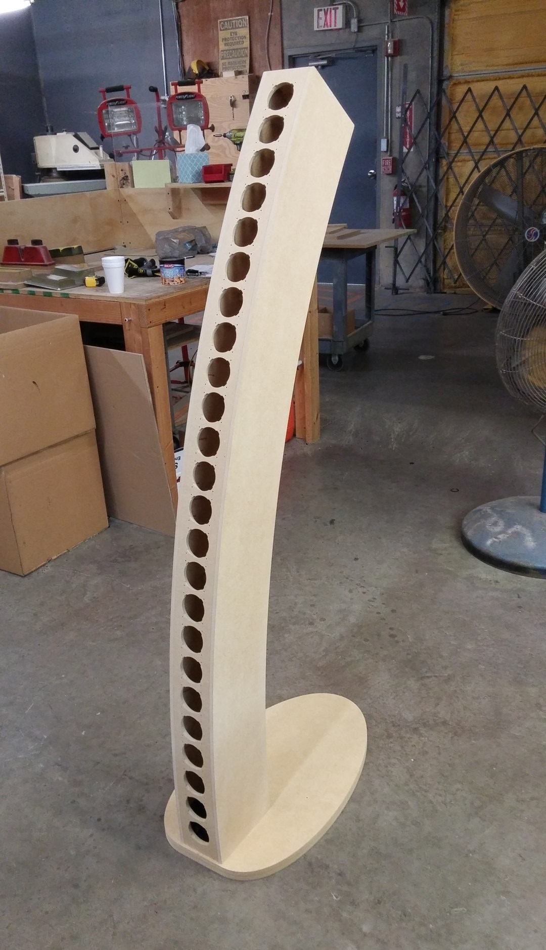

I've built a few of these, my latest one is documented here:
https://www.diyaudio.com/community/threads/square-pegs.217298/post-6972282

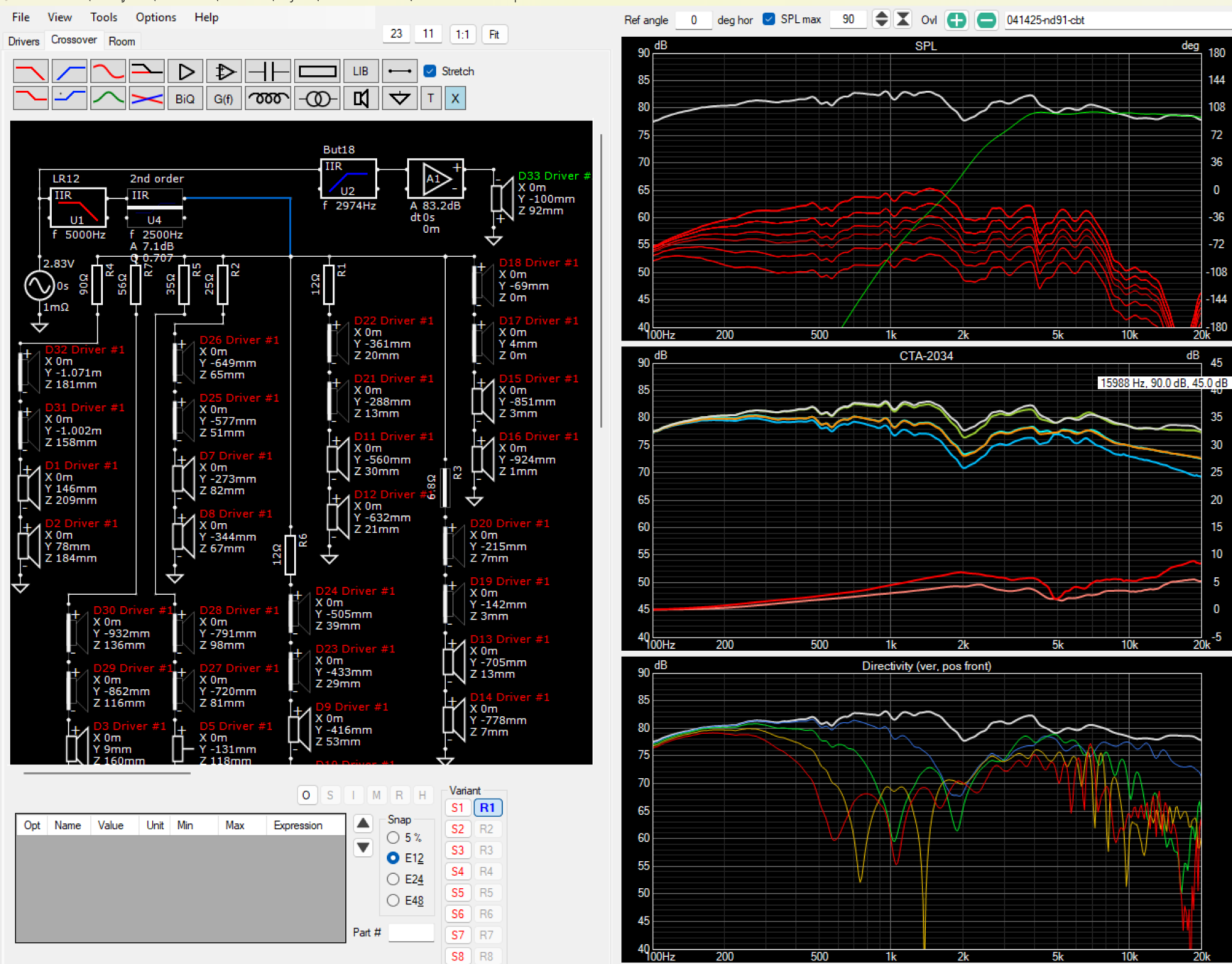

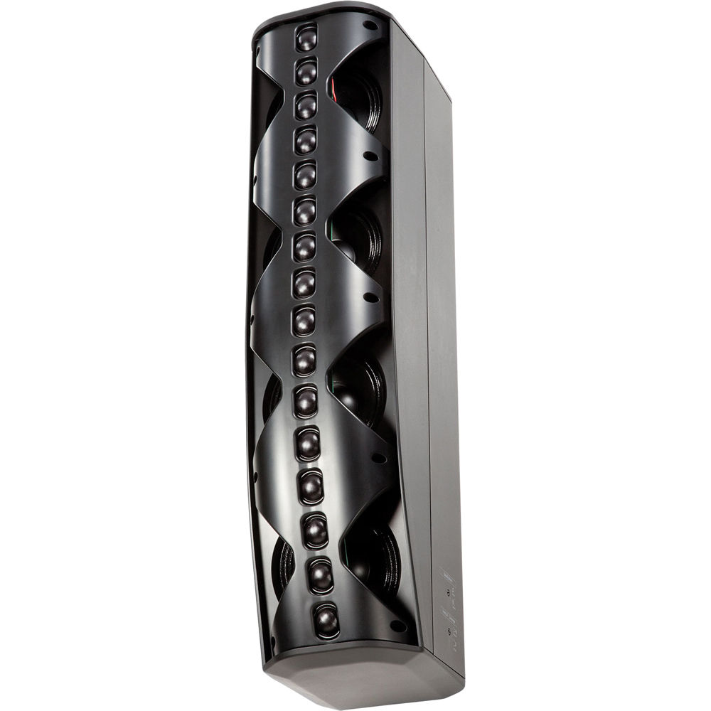

For the longest time, I thought it might be possible to add a tweeter to a CBT array, but the more I mess with them, I am just STUMPED.
Unless someone can show me otherwise, it's really hard to see how it can be done.
This was my latest attempt.
Visually, it would look fairly similar to the Parts Express CBT24, except that the length is 75% as tall.
The big difference, between the PE speaker, is that my speaker adds a ribbon located 32" above the floor.
I tried various other locations for the tweeter, and nothing worked as well as putting near the drivers that are attenuated. What I mean by this, is that in a CBT array, the loudest drivers are on the floor and the quietest are at the top. This seems really counter-intuitive; you would expect it to be the other way around. But the idea is to use the floor as an "acoustic mirror" and that demands that the loudest woofers are on the floor, and each woofer gets a bit quieter as you move UP. (Most of the home audio CBTs depend on that "acoustic mirror.")
Here's the issue:
If you look at my vertical polar response of the design, you'll notice that there's a dramatic WIDENING of the beamwidth between 3khz and 6khz.
The reason that this happens is that the wavefront produced by the tweeter has become spherical. Basically, the wavelengths are bigger than the ribbon, and so they radiate spherically instead of in a planar wavefront.
There are many ways to solve this, but none of them are good:
1) You could use a full-height line of tweeters, like JBL does with the CBT70J and Keele used with the CBT36. A full height line of tweeters would match the beamwidth of the full-height line of midranges in the CBT.
2) You could use a single ribbon tweeter with a very high crossover with a very steep slope, possibly with a slope as steep as 48dB/octave or more. Basically minimize the interaction as much as possible between the mids and the tweets. I'm not keen on this because I find high order slopes to sound weird and unnatural. Even if I set the xover at 8000Hz, I worry it would be audible.
3) One idea I had, was an "MTM of CBTs." Basically have a CBT array dedicated to high frequencies in the center, flanked by dual CBT arrays of mids, one above and one below. This solution falls apart because the center-to-center spacing is all wrong. For instance, if you had a 40cm tall tweeter array flanked by TWO 40cm tall midrange arrays, the crossover for the tweeter would be a maximum of about 425Hz. Even worse, it's not really a CBT, because there's a 'hole' in the center, due to the presence of the tweeters.
Anyways, check out my pics, you can see what I've been banging my head against a wall on.

you can model CBTs in Vituix using diffraction models carefully working out the height, title angle, and shading coefficient for each driver. IIRC, I did it in my long simulation thread several years ago. If you want to keep trying, that will save you some sawdust. You should by now however be convinced its a futile effort. I don't think you can match tweeter directivity to the rest of the array without a full equally curved line of tweeters. Dayton makes DMA48, a 1.5" driver that might serve well full range if you use enough of them. The best approach I know of for a tweeter at center of an array is David Smith's expanding array which he described near the end of his line array thread here, a year or so before his recent passing.
Hard problem... One option would be to use a coax driver for every element in the array... 24 coax drivers would be rather expensive though.
That might be better than some options but ultimately wouldn't work because of the CTC between coax tweeters
It would be no worse than the baseline CBT. Every full-range driver in the array acts as a tweeter anyway, so there is already an interference pattern at high frequencies.

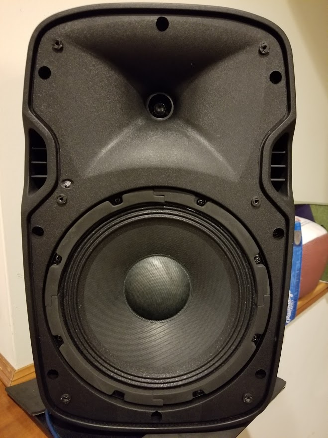

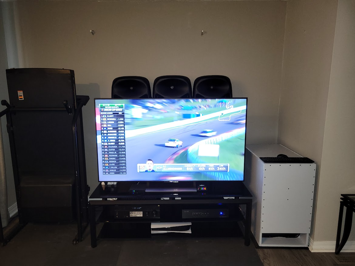

I kind of want those wheels for my Dodge Mirada... I'm sure they cost more than my whole car tho!
On top of all that, if I got bored of the 708Ps I could sell them for 75% of what I paid for them.
I bought some Behringer two-ways a few years back and I don't regret that purchase one iota. Had some people over for the fourth of July and those little Behringers managed to do PA duty for the party. (I didn't have enough time to set up my Yamahas, which would have been more appropriate.)
I WISH my 8" 2 ways looked similar to the JBL 708P's.
Which Behringer 2 ways did you get?
The Behringer B215XL and Mackie C200 threads on avsforum.com are the reason why have 8" and 15" PA 2 ways in three 5.1 systems.
I'll never go back to regular speakers again. PA 2 ways are cheap and I'm no audiophile. The Road 18" bass bin has a Yamaha driver.
Nope.
NC535 is correct; even with coaxials, the spacing of the tweeter is the deal-breaker.
This is why the JBL CBTs have the tweeter on a 'bridge'
The Danley SBH (Skinny Big Horn) uses a prosound coax, but it puts a paraline on the tweeter to create a flat rectangular wavefront, like a ribbon
The Radian coaxials would work well, but they're $$$

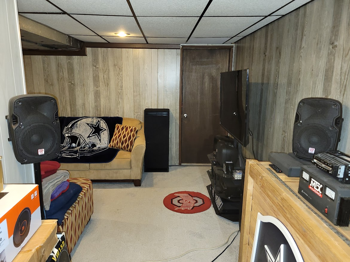

I built a 3D-printed line array. Each speaker is equipped with twelve Asian Neo 8. The height is two and a half meters.
I don't want to do any acoustic treatment because the ceiling is glass, and we have natural light, which is also pleasant.
The line array works above 250 Hz. I use a Ripole for the bass. The sound level is well distributed throughout the room, and the listening position isn't exclusively in the center of the speakers. The attenuation at the back of the room (ten meters) is only -3 dB. You don't feel the room reverberation.
It looks better, but when measured, there isn't much difference.

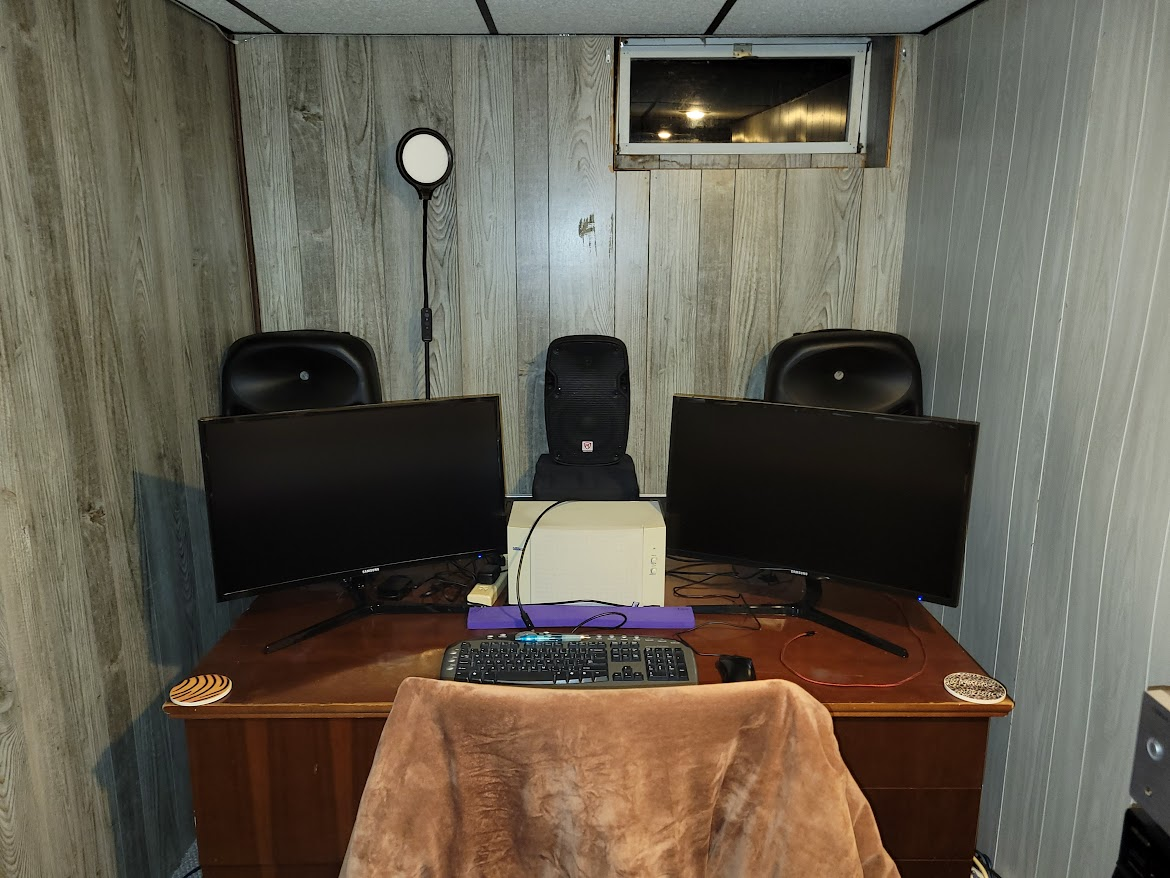

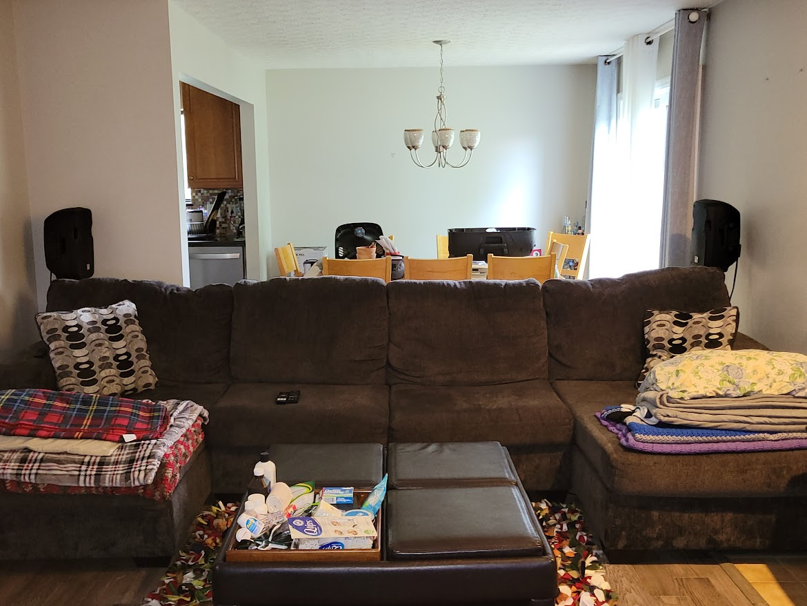

That's really nice!
Our rooms are similar; I have a big ol' sliding glass pocket door that faces the backyard where my pool is.
