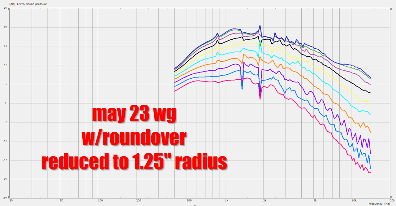

Here's the exact same waveguide as post 159, but with the roundover reduced from 44mm to 30mm radius.
The difference is really subtle - but it's measurably worse.
A big ol' roundover really seems to do a lot, so I think I may try an MTM with a smaller waveguide and a giant roundover.

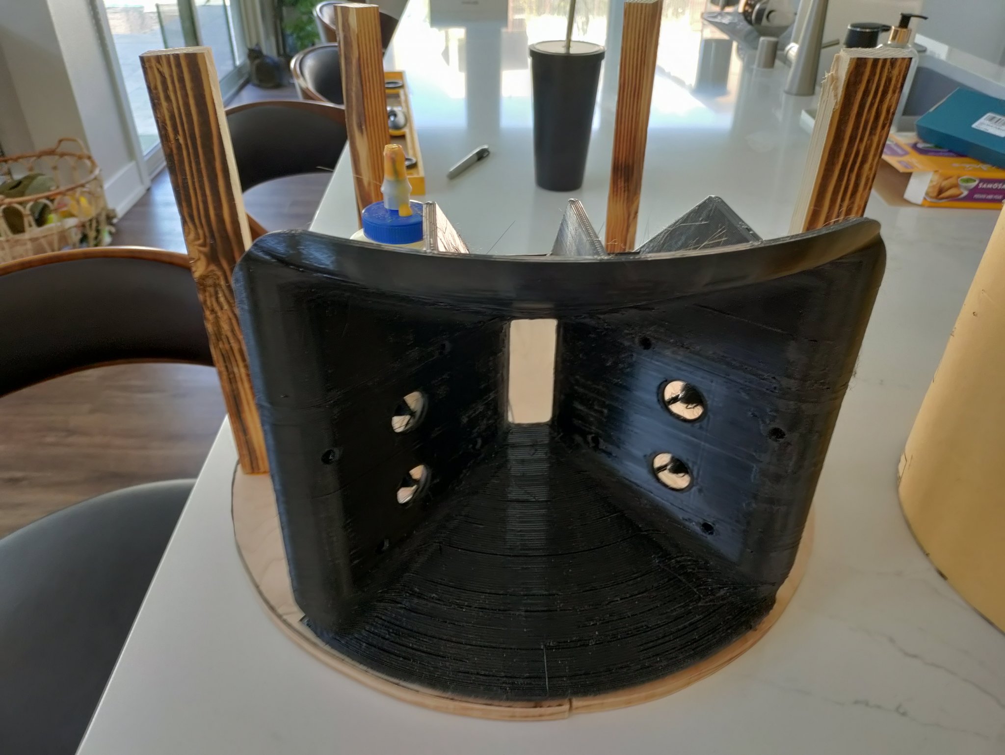

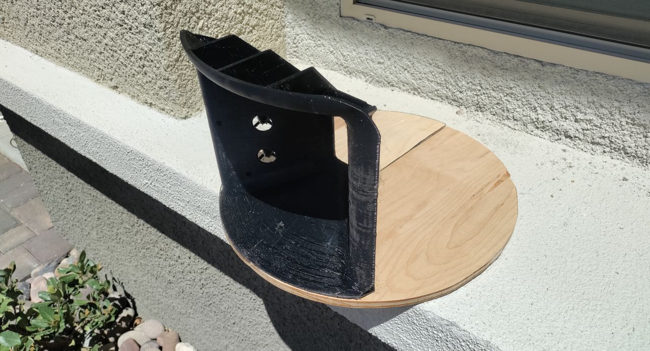

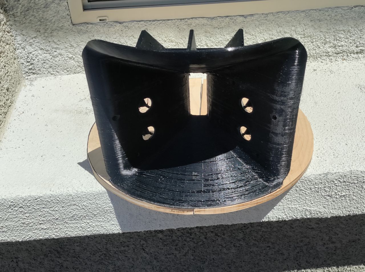

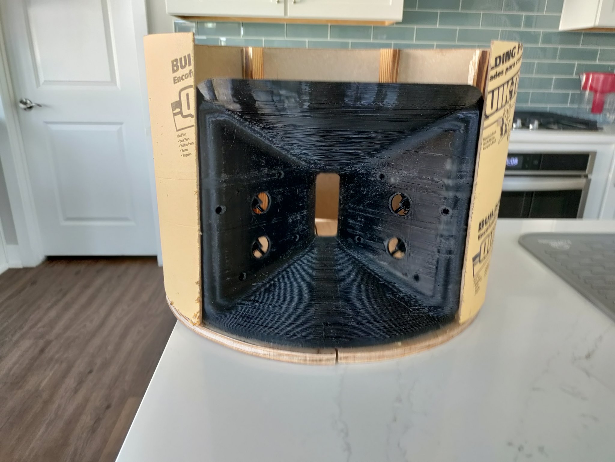

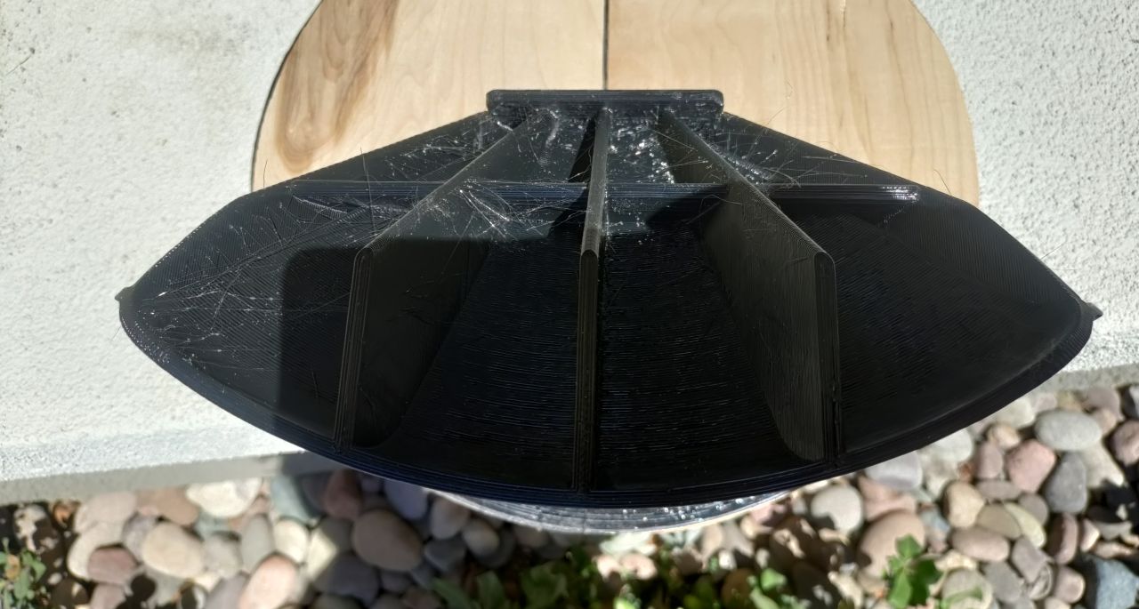

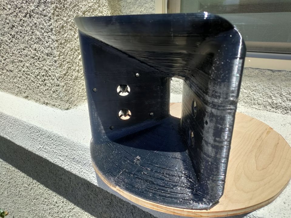

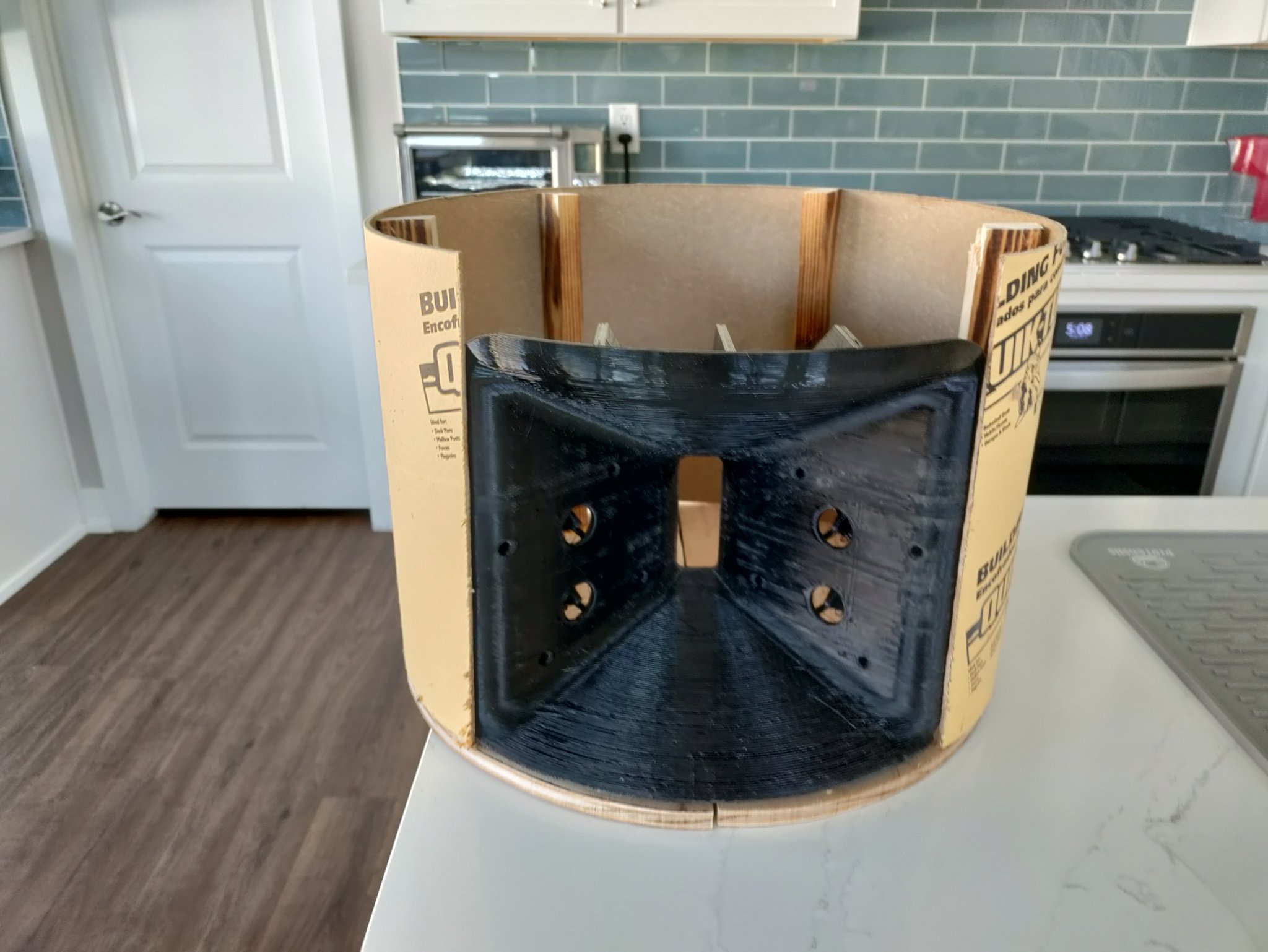

I took another crack at making a Unity horn that's basically embedded inside of a cylinder.
I think it was over on the ATH thread that somebody suggest using a sphere to reduce diffraction. Trying to make a sphere turned out to be impractical (I tried) so I settled on a cylinder.
One of the big changes here, versus my prior designs, is that the overall diameter of the cylinder is 400mm (16")

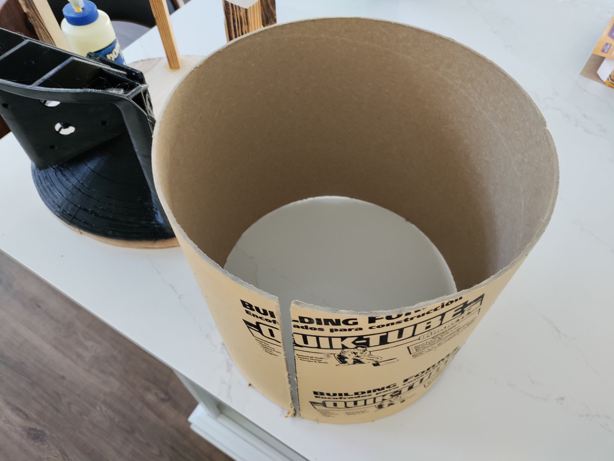

This was "do-able" because I realized that you can take a 12" sonotube, slice it vertically, and turn it into a 16" cylinder by using a waveguide that spans ninety degrees of the cylinder.

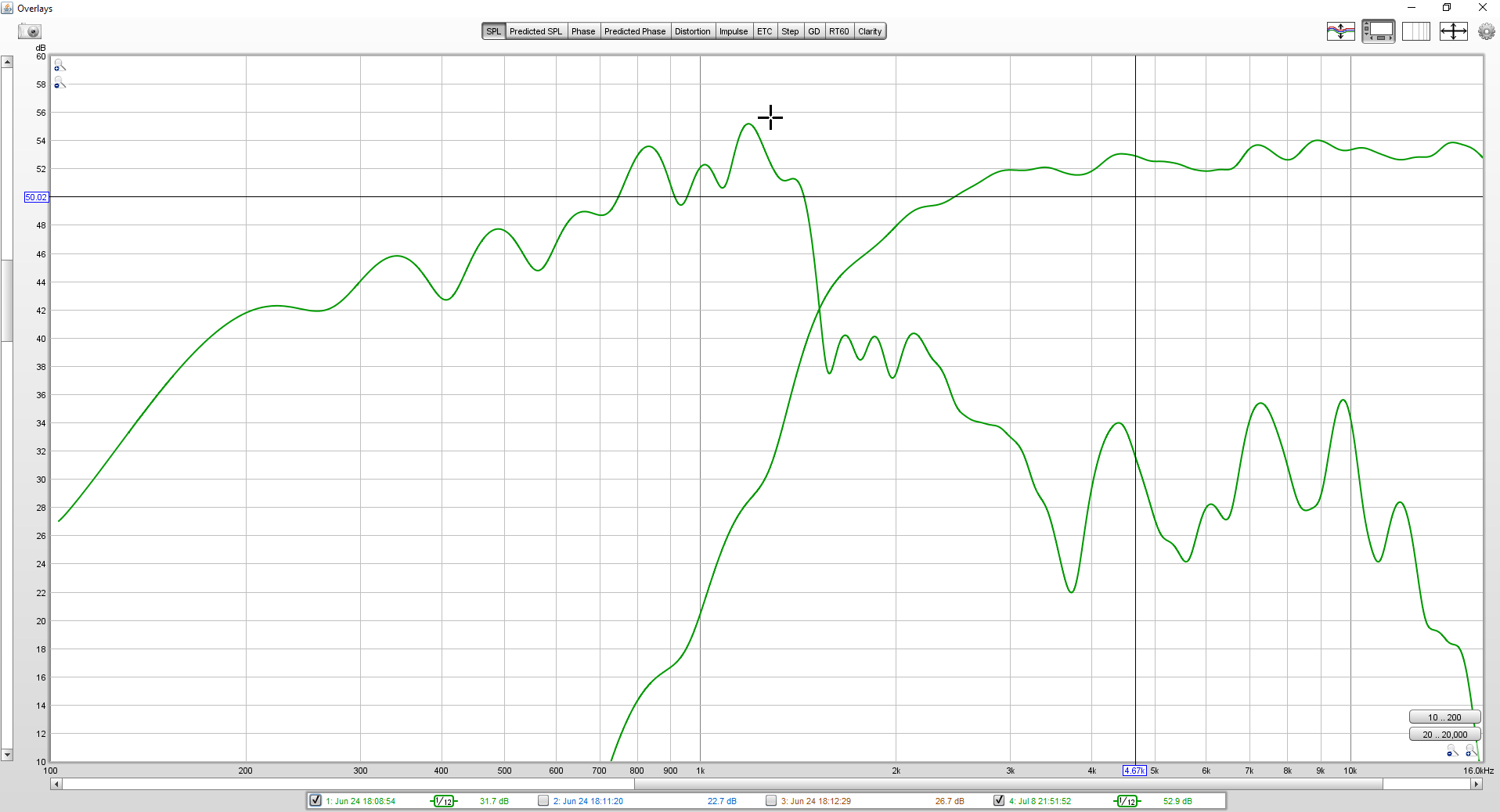

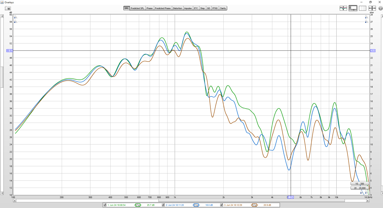

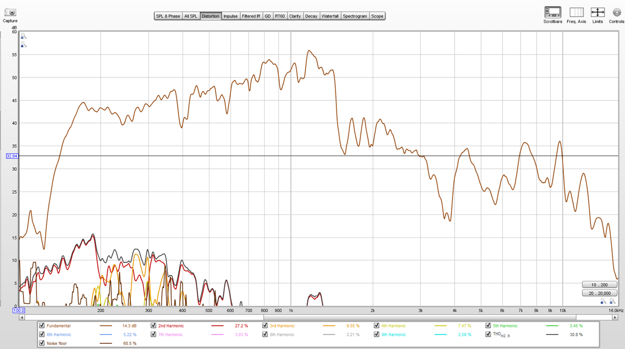

Here's the distortion and horizontal polars of the midbasses alone.
I did these first because the high frequency extension of the midbass will determine whether the design is possible or not. Basically if the midbass can't reach about 1500Hz, the design won't work.
It looks like it will, so that's good. But it's admittedly tight (fingers crossed.)
Another thing that's important here, is that the midbasses AREN'T beaming, until 1800Hz. This is important because the midbasses are mounted horizontally.
The overall roughness of the response is because I did a quick and dirty ground plane measurement, with a long gate. Once I get the time to mount the tweeter and measure it off the ground, response should be smoother.

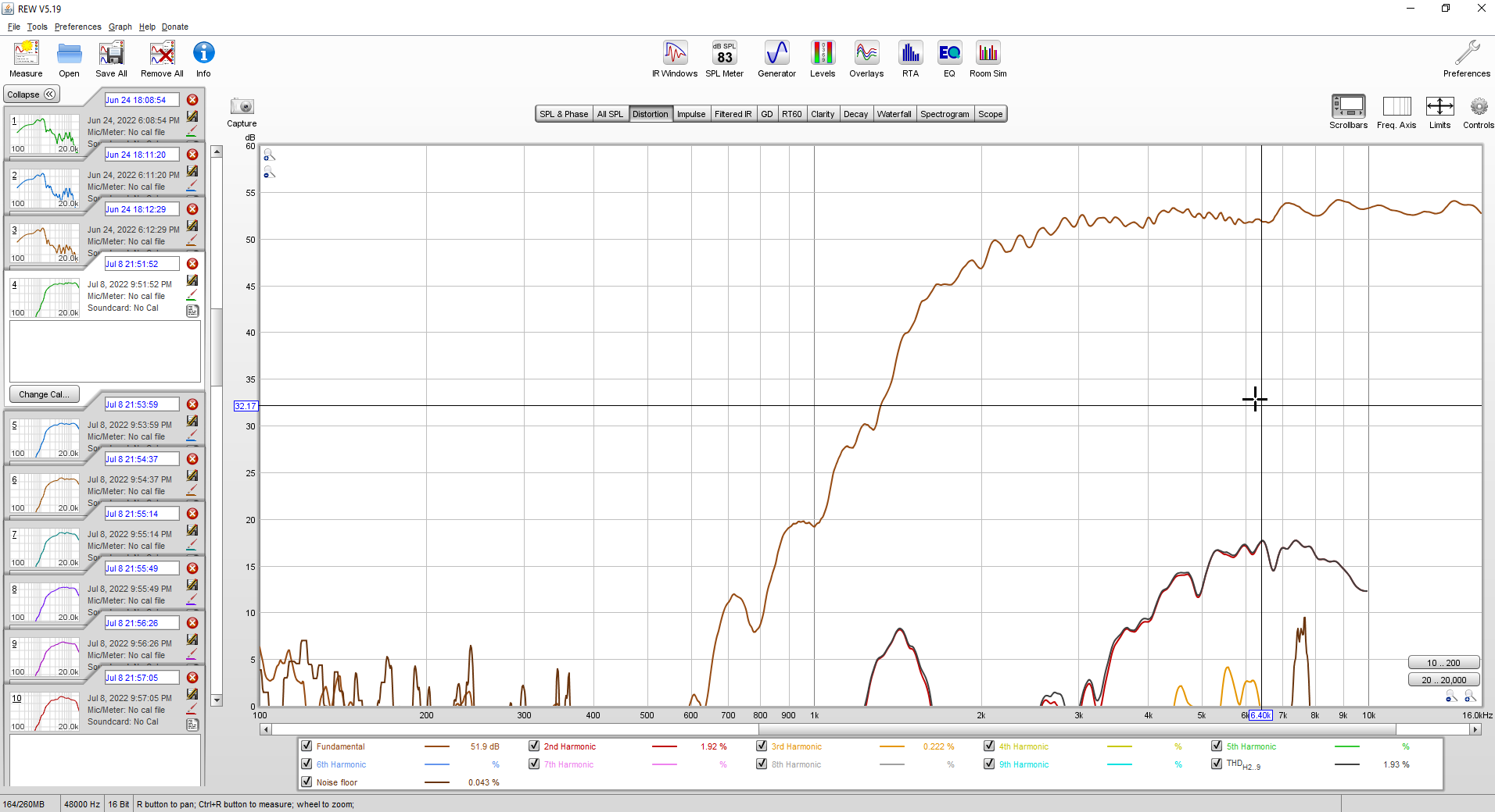

Here's the polar and distortion measurement of the Airborne RT-5002 AMTs that I'm using, from a project I did last year: https://www.diyaudio.com/community/threads/the-nightmare-before-labor-day.374570/post-6799374
As with any two-way Unity Horn project, the tricky part is getting the midbasses to play high AND low. I'm making things extra difficult for myself by using an AMT lol
My thought process here, is that I tried a dozen different ways to limit the vertical directivity, but it's tough to beat a ribbon, planar or AMT for that:
1) Paralines have limited vertical directivity, and I built some new ones a few months ago, but the response was rough: https://www.diyaudio.com/community/threads/square-pegs.217298/post-6978174
2) If you can live with broad vertical directivity, a dome or compression driver will work fine. But the Airborne AMT is generally smoother than both, and smooth treble response is proven to sound ideal. Also, the CSD of AMTs is tough to beat.
This is the speaker from last September. If you look at the frequency response of the AMT, you'll note that there's a GIANT "step" in efficiency at 2khz.
https://meniscusaudio.com/wp-content/uploads/2015/11/RT5002-Data-Sheet.pdf
In the spec sheet, the "step" is at 3khz.
I have no idea why it never occurred to me until this morning, but that "step" is because the wavefront is becoming spherical. (Why didn't I realize that last year???)
Basically the "stock" ribbon has a vertical opening that's 100mm tall. 3400Hz is 100mm long. So what's happening is that the AMT can still play down, possibly to even 1khz, but when it radiates spherically you basically have to double the input power to compensate for the wavefront being spherical. Above 3400Hz, the wavefront is planar, causing the efficiency to be higher.
The mouth of the waveguide from last year was about 175mm tall, which is why the "step" began at 2khz. (2khz is 175mm long.)
The mouth of the NEW waveguide is 230mm tall, so if I'm "lucky" then the "step" may not begin until about 1500Hz. Which would be fantastic, because it means I wouldn't need to use a ton of EQ to "fight" the "step" like I did in the speaker from last year. (If you look at the EQ settings posted above, I was using a whopping +12dB of EQ in the octave from 1-2khz, and you can see that impacted the distortion performance, manifesting itself as 2nd harmonic distortion from 2-4khz.
Basically, if I can avoid using tons of EQ from 1-2khz, it should increase power handling by about 1000% and lower distortion by about 10dB.

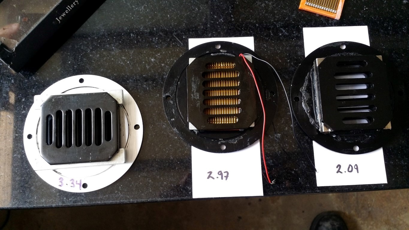

If this helps I'll pass it along. Aurum Cantus makes one of the better sounding AMT's. I did a lot of design work on AMTS a few years back and I am starting again. The one you are using is not the greatest. I am guessing that you are in proof of concept phase. So this is information for you back pocket. When and or if.
I thought the main issue with Airborne is quality control?
I know that Oskar on this forum created some mods to lower the distortion level. But my RT-5002s appear to be epoxied together and I'm not keen on prying them apart.

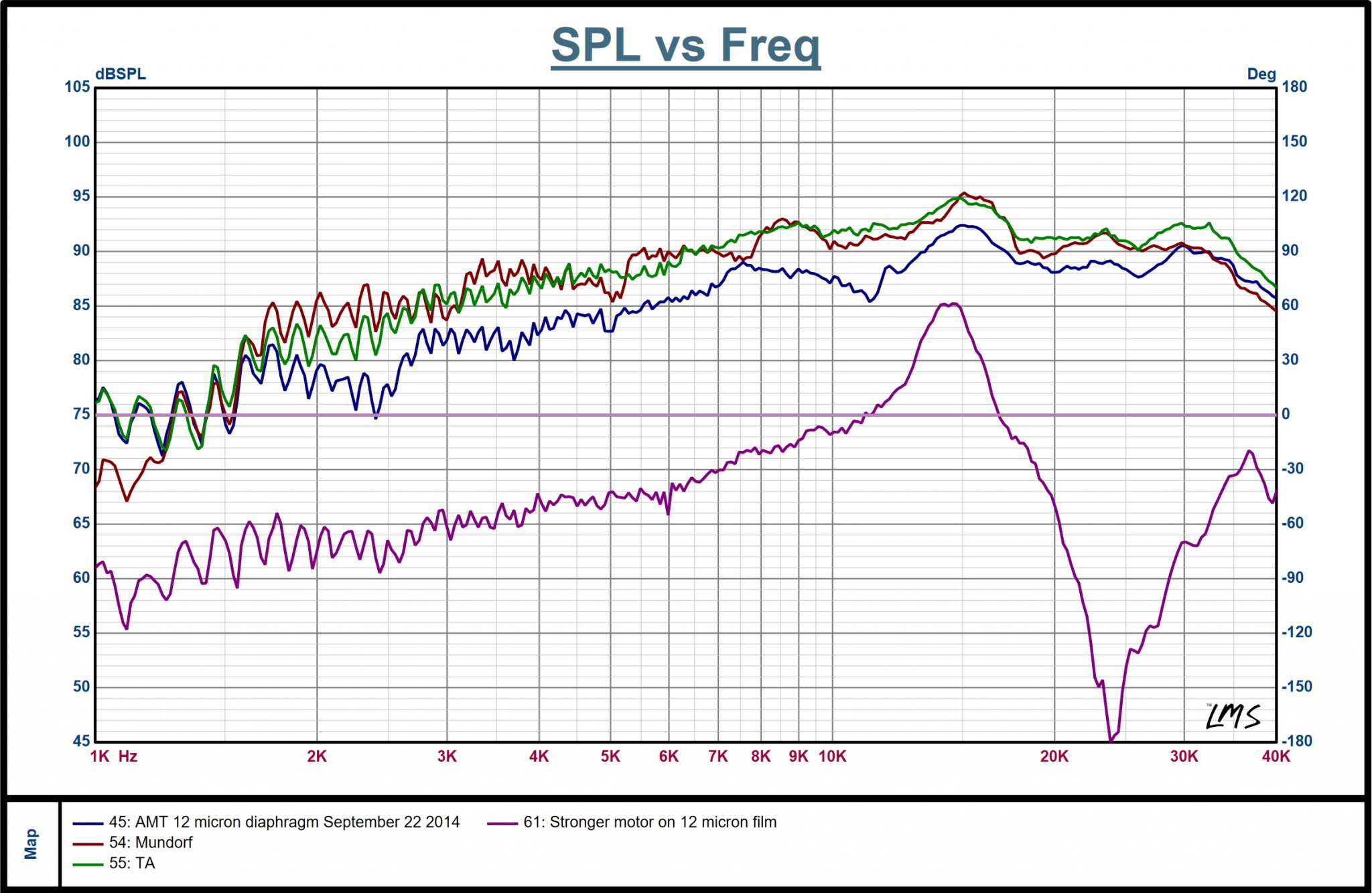

For comparison's sake, here's the $182 Aurum Cantus AST 2560:
And here's the $118 Airborne RT-5002:
Note that my measurement is equalized, and the AC measurement isn't. I'm hoping I can reduce the amount of EQ with a much bigger waveguide. The new one is more than twice as large.
The Aurum Cantus AMT is flatter in response and has wider bandwidth. It's also 54% more expensive. The Aurum Cantus is about 3-5dB less efficient.
To me, I get the impression that the folks at Airborne basically chased a high efficiency spec, which impacted how low it could play. My fingers are crossed that my big ol' waveguide compensates for the efficiency "step" at 3khz, where efficiency drops by 10dB because the wavefront is becoming spherical.

Yeah, the driver doesn't have the motor to drive it much below ~3 kHz, so going to be a typical sub tuned < Fs situation of trading a lot of efficiency for BW, so with no ribbon/planer experience, curious how much a relatively huge air mass 'plug' will roll off its upper BW.
I measured so many AMT's when we were doing the R&D I can tell you a few points. Anything that is yellow is polyester. It can have nasty peaks in the response and distortion that is very noticeable in the places you want it the least! The Aurum Cantus, whom I have no affiliation with at all is not made from polyester. They use something else. It took a while to figure it out. It is much heavier than the normal AMT diaphragm. As for Hygiea (Airborne is made by Hygeia) having quality problems, it is epic unit to unit is all over the place.For comparison's sake, here's the $182 Aurum Cantus AST 2560:

As you probably know Greg, the B in the gap is small. And that is pretty much how it works. Even with substantially greater B available the way an AMT works is that there is very little L. Very little actual voice coil. And the stronger motor can do some interesting things to the response.Yeah, the driver doesn't have the motor to drive it much below ~3 kHz, so going to be a typical sub tuned < Fs situation of trading a lot of efficiency for BW, so with no ribbon/planer experience, curious how much a relatively huge air mass 'plug' will roll off its upper BW.
Measured in kilogauss The far left is the standard motor that we did for PE back in 2014.
Nothing fancy for measurements. In a lab, comparative only. The measurements were made at 1.5 metres. Lower trace is purple and the strongest motor. We offset it a bit. But you get the idea. To much B will dampen the response in some areas and peak it in others. The AMT diaphragm is basically both the damper and the diaphragm. And that can be a tough nut to balance. You will notice in the Aurum Cantus measurement the bandwidth is greater. I can tell you that the mass is higher, the diaphragm is substantially more compliant and the B field is higher. It is a balanced design. You get what you pay for. Mundorf is the only AMT that actually uses Kapton and you can see the resonances for yourself. Even if we did nearfield measurements it was very apparent.

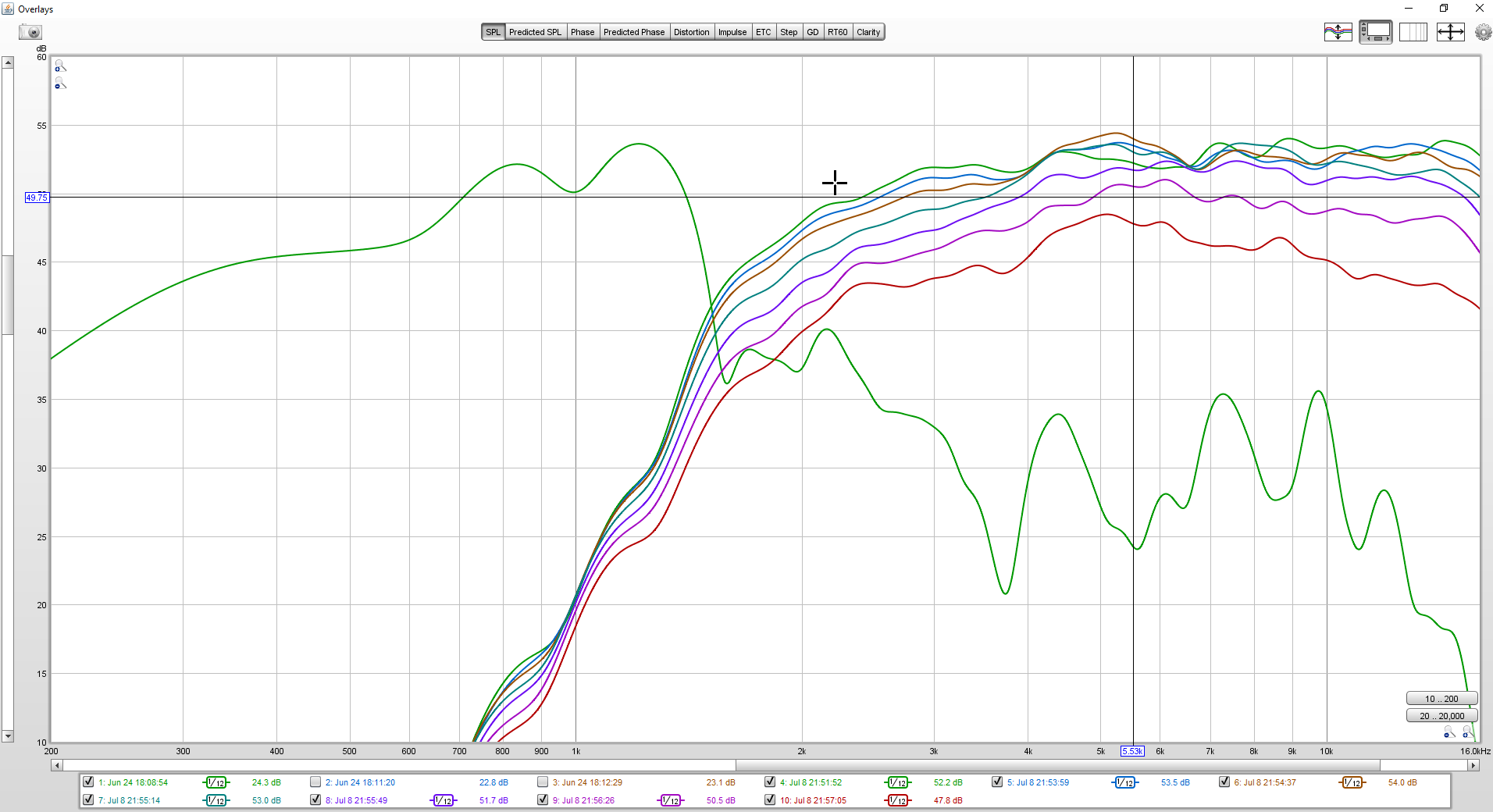

Here's the polar response of the AMT in the enclosure. Looking pretty darn good if I do say so myself. These measurements are from zero to 45 degrees off axis in 7.5 degree increments.
I was aiming for a beamwidth of 90 degrees and it ended up being about 80 degrees, which I can live with.
I need to upload the filter settings. This response is equalized.
One of the great things, was that the design didn't require a ton of EQ to bring up the low end. As described in my post five days ago, the AMT requires a relatively large waveguide to prevent the wavefront from expanding spherically. Basically if the waveguide isn't large enough, your efficiency will drop like a rock.
Distortion peaks at about two percent at 6khz, mostly second harmonic. TBF, AMTs like the SB Acoustics Satori have lower distortion, but also cost more than twice as much. One big criteria for me in this project was excellent polar response, and big wide AMTs like the SB Acoustics beam quite badly. That could be a feature or a defect depending on how you see things, but I wanted something with wide-ish beamwidth.
