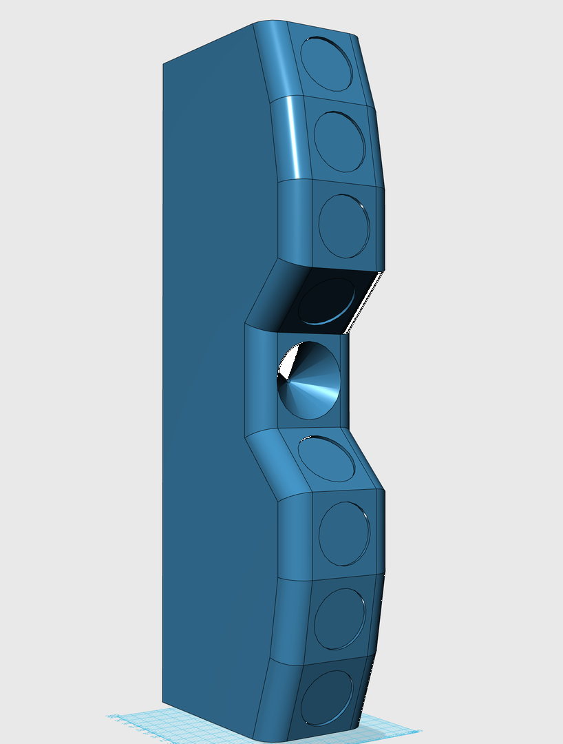

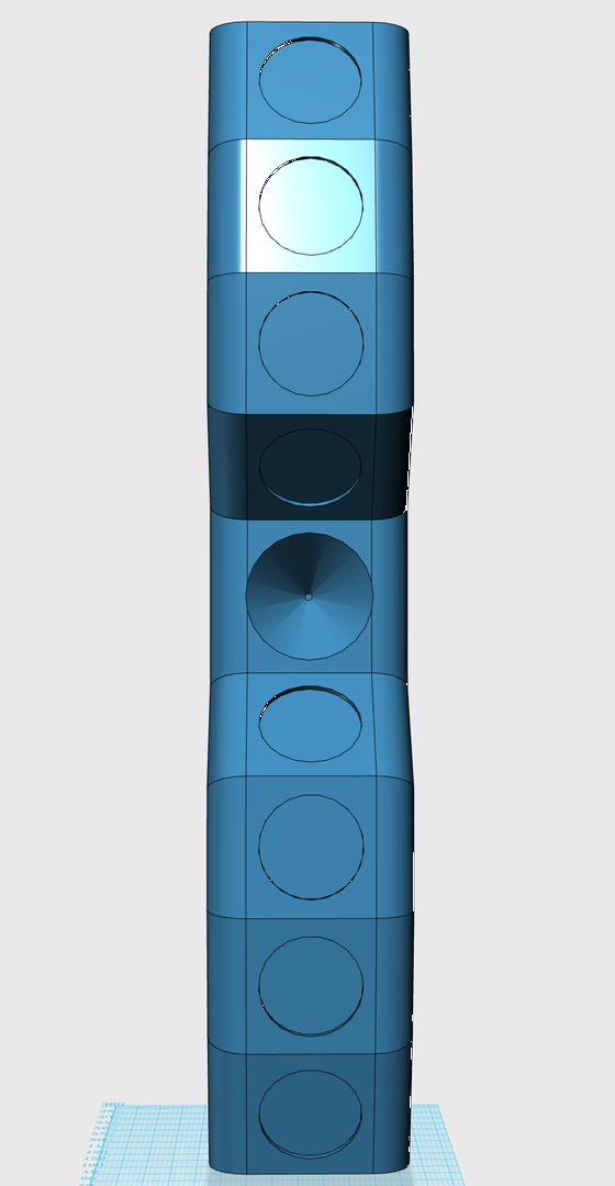

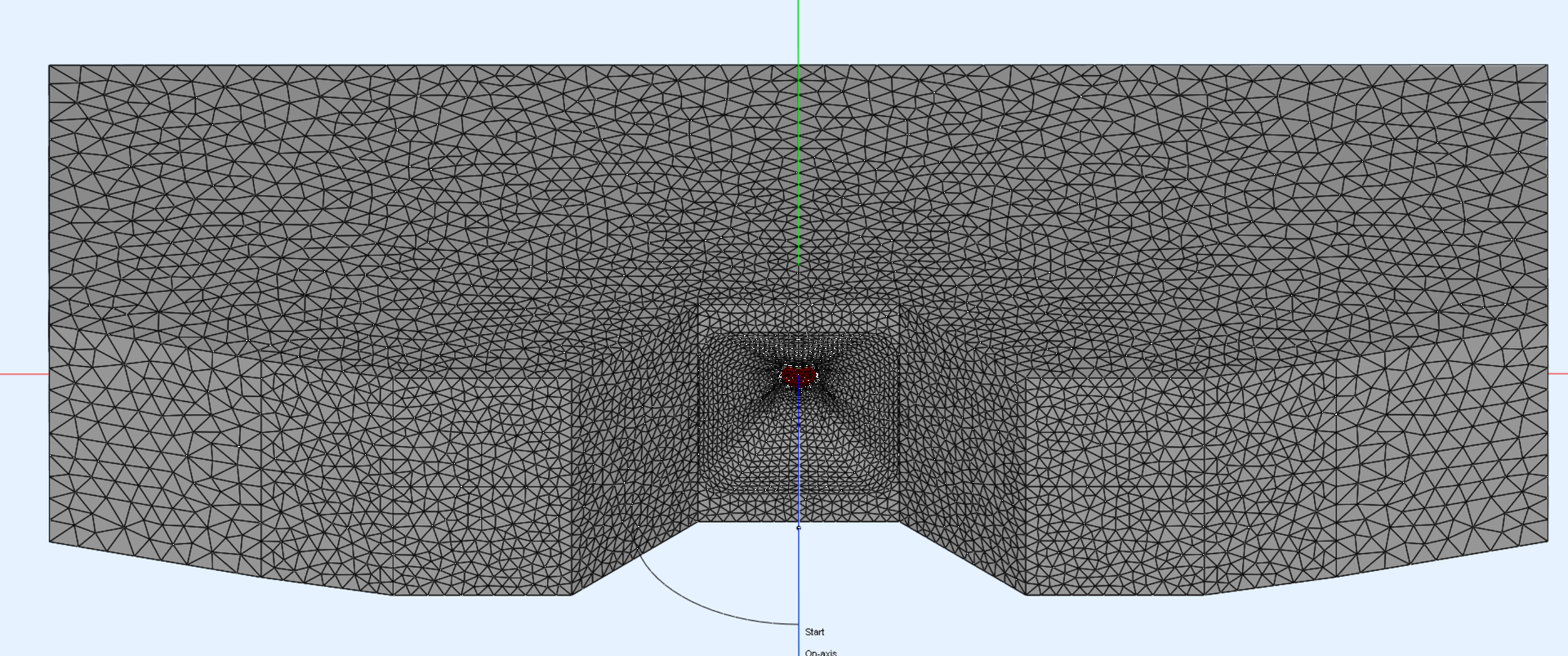

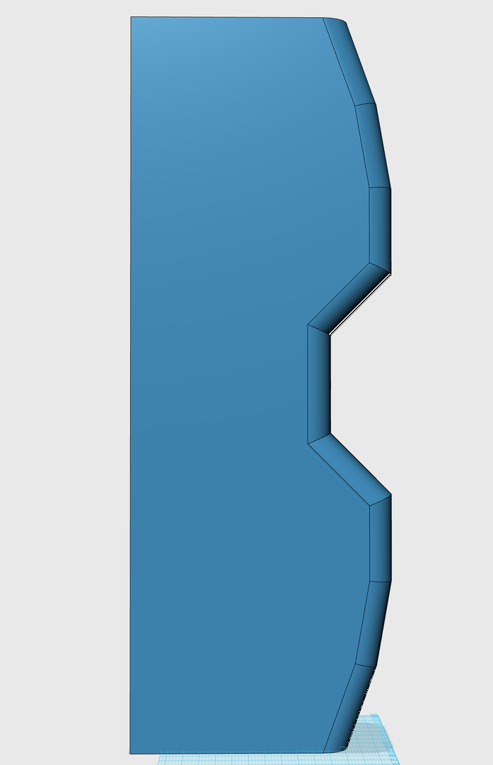

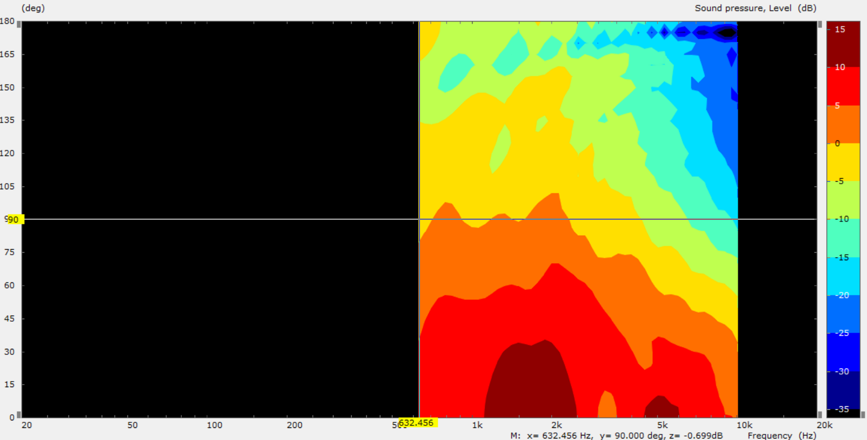

Here's an enclosure and waveguide I'm working on.
As usual, I'm using the shape of the enclosure to change the wavefront shape. The way that it works is like this: https://www.diyaudio.com/community/threads/loudspeaker-enclosures-are-waveguides.363630/

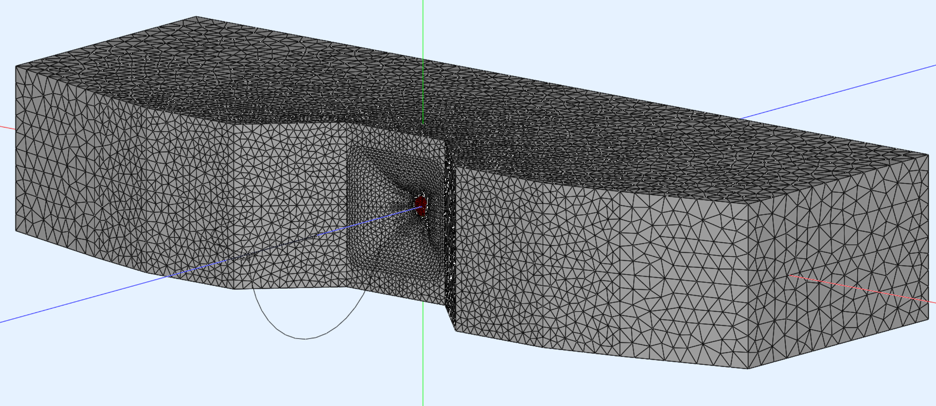

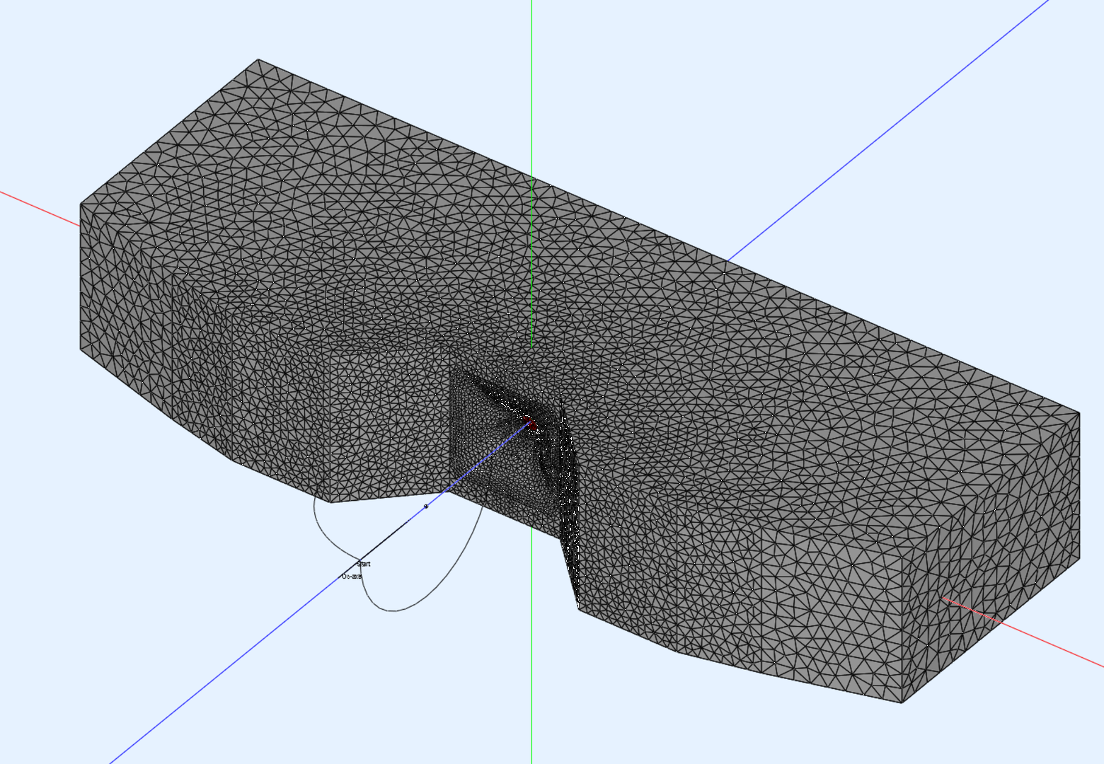

Attached are some pics of the enclosure modeled in 3D, and what it looks like in Abec.
Here's the model that you can simulate using ATH and ABEC.
Spoiler alert: before you bother modeling this, it doesn't work well. I am posting it because maybe it will save someone the trouble of finding out the hard way 🙂

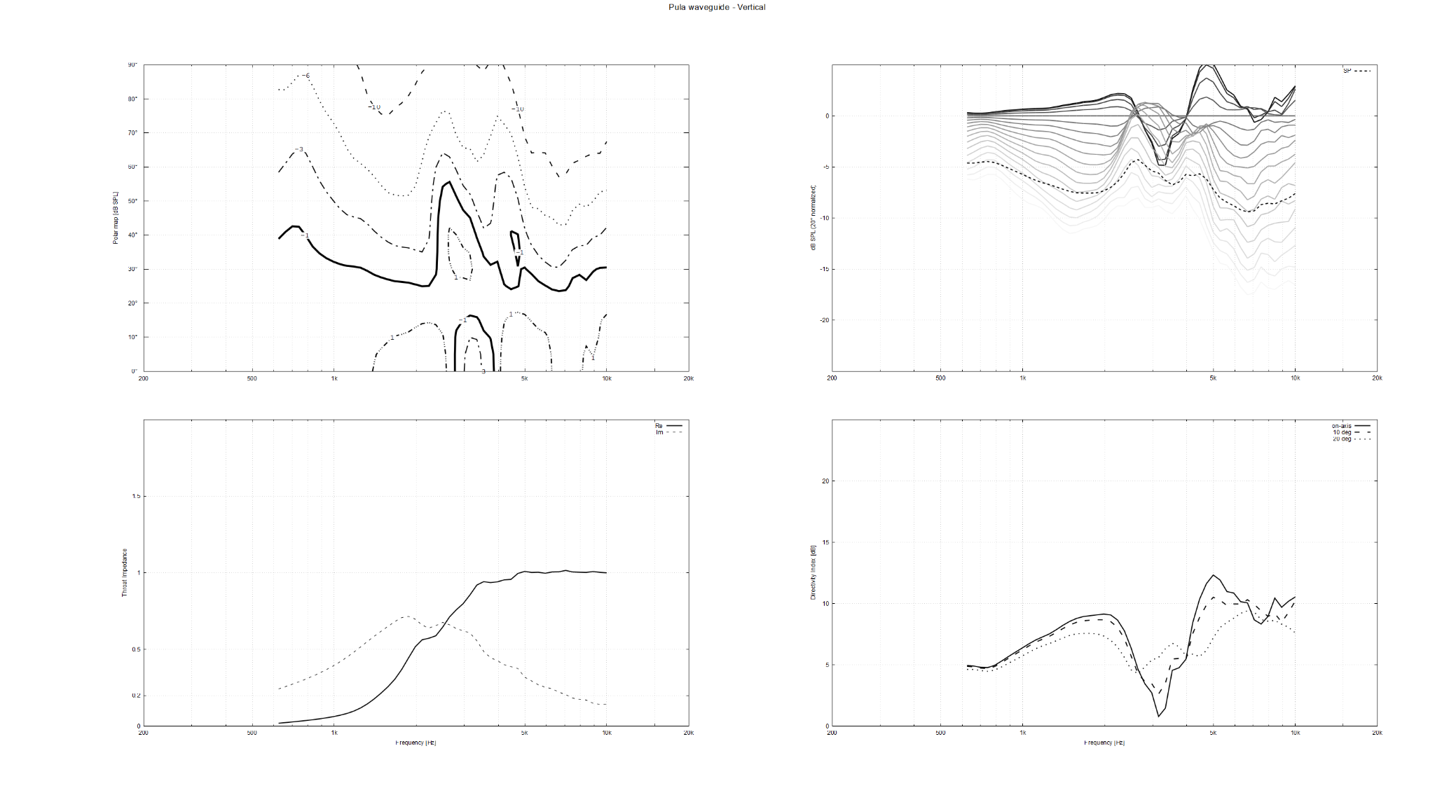

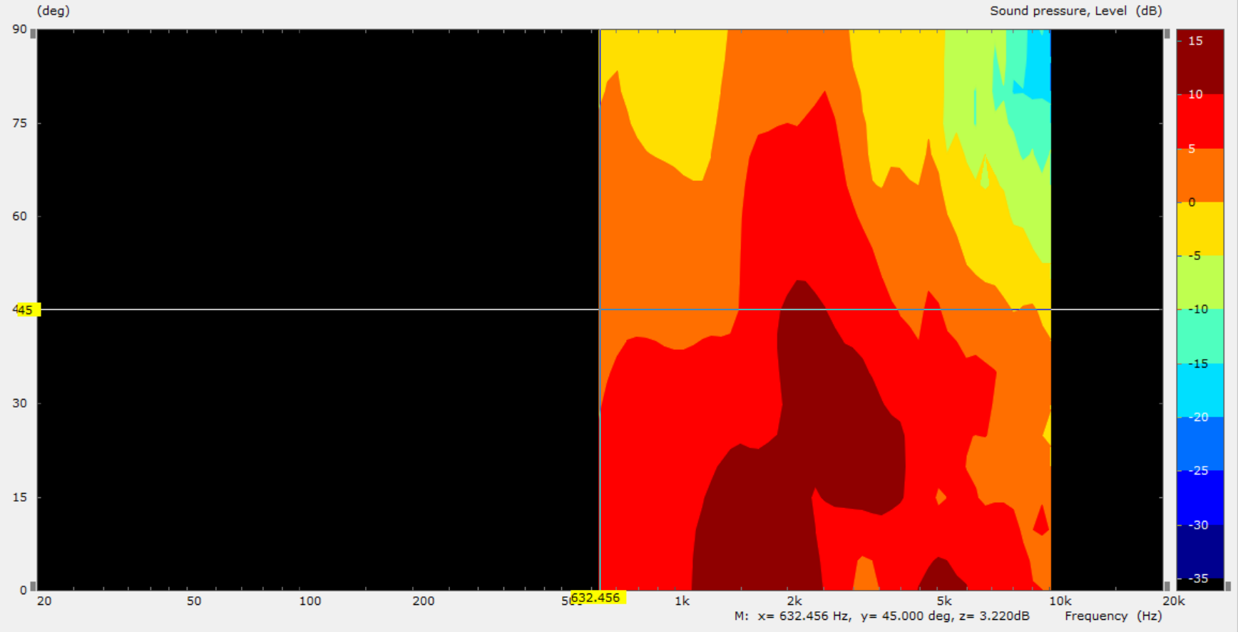

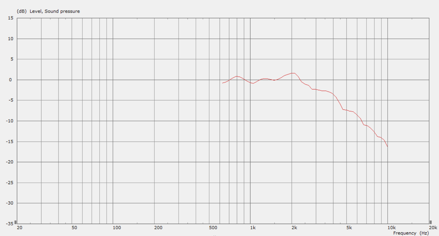

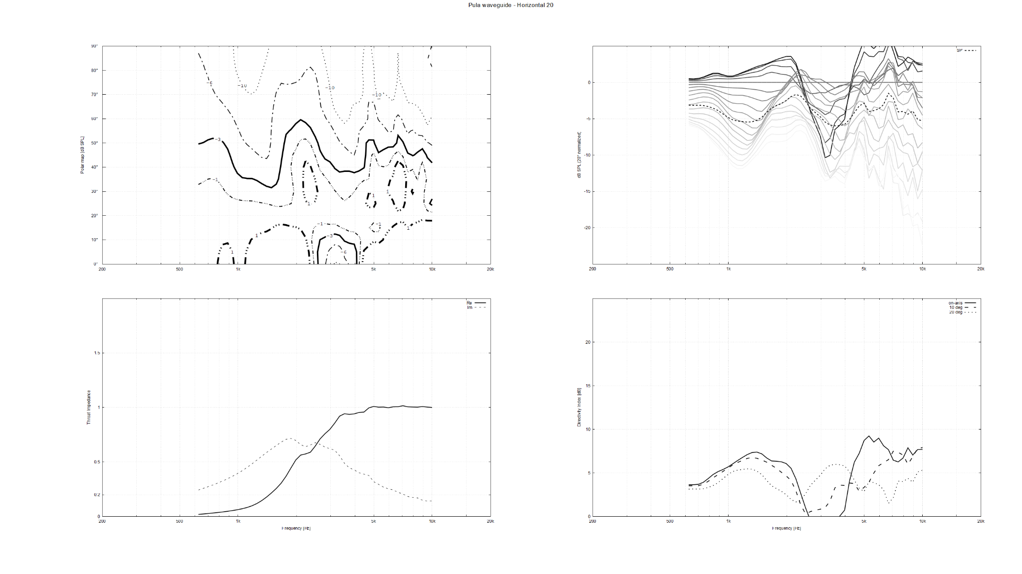

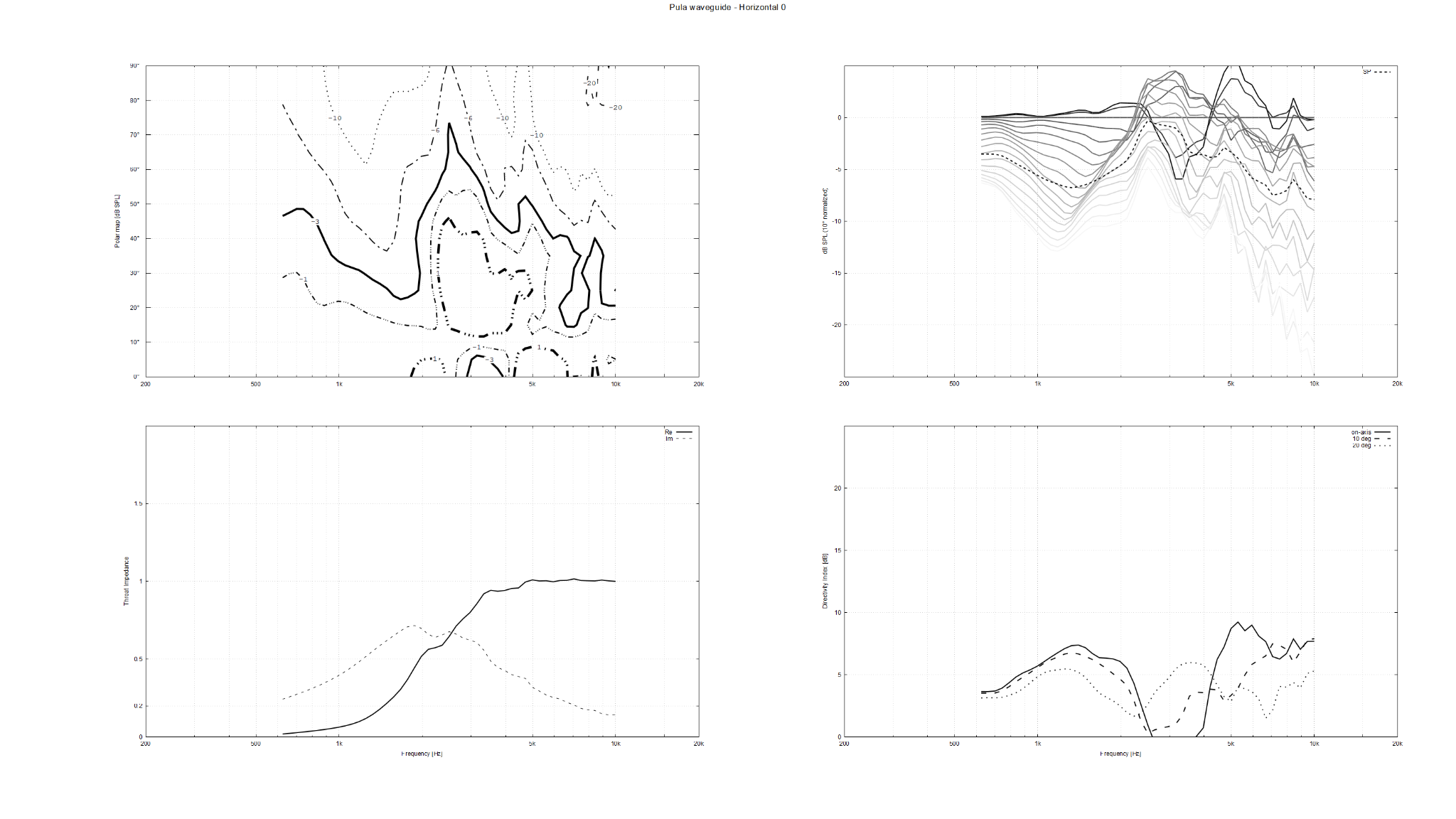

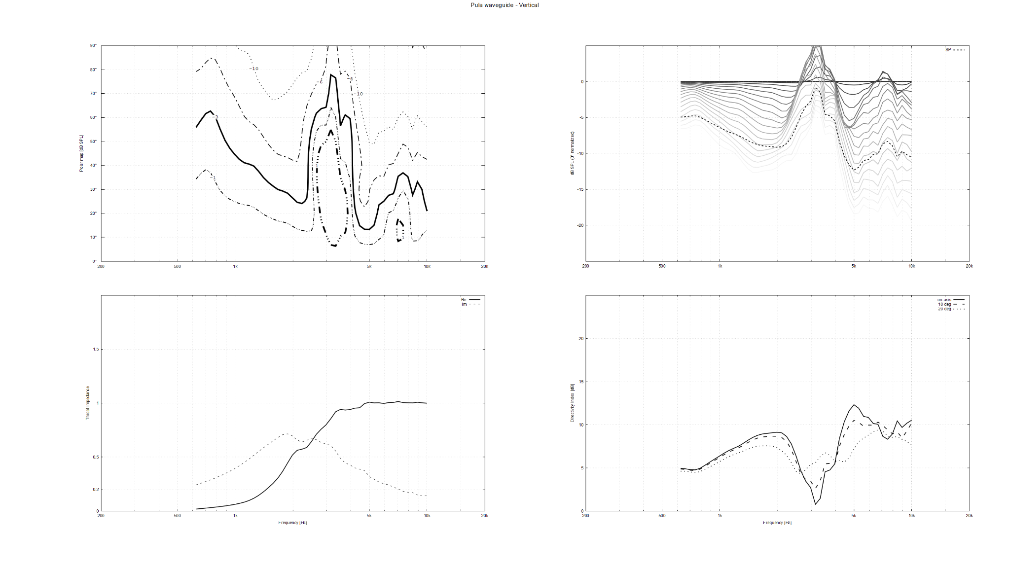

Here's some simulations of the waveguide and enclosure from my last post.
As noted, they're comically bad, but maybe it will save someone from trying it.
If anyone is wondering what I was attempting, my idea was that the angled part of the enclosure, above and below the waveguide, would allow the waveguide to control directivity to a lower frequency. Similar to a conventional waveguide with the left and right side cut off, leaving the center 'slice' alone.
The attached sims are:
1) vertical and horizontal directivity maps
2) vertical and horizontal on-axis frequency response
3) The vertical and horizontal reports produced via ath. These are normalized at zero and twenty degrees.

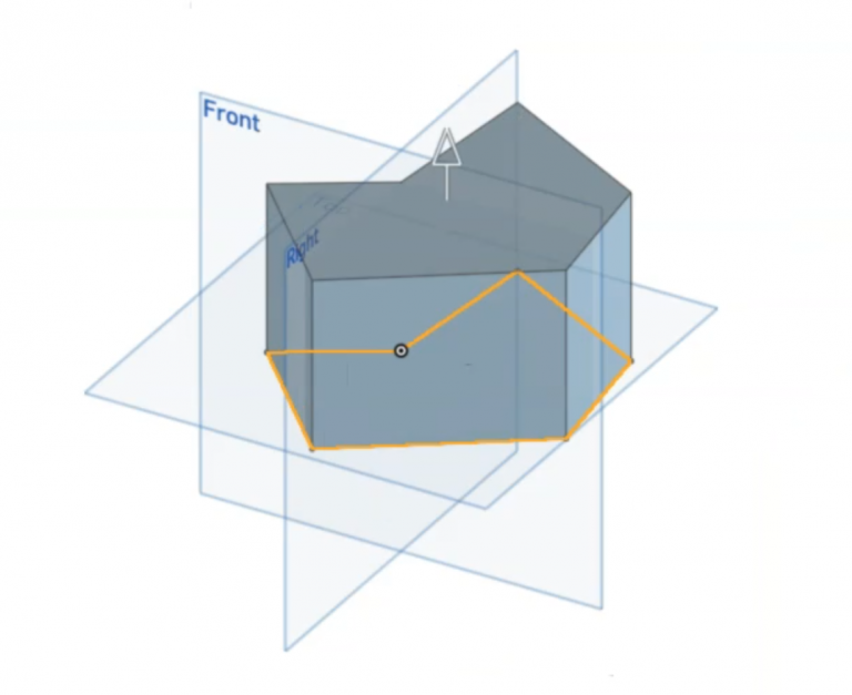

Something to note, is that the "vertical" and "horizontal" are swapped. This is admittedly confusing. The reason this is, is because the User-Defined Enclosure plan in ATH basically "extrudes" a two dimensional shape.
Similar to this:
Similar to this:
