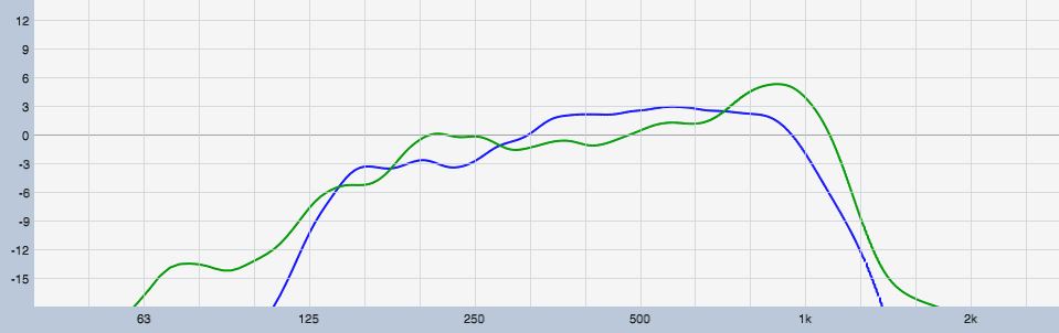

Anyway, here are four 4" mids' raw measurements, on two horn patterns with the same horizontal widths.
Both have the same size ports, both with ports 3.5" from the throat .(measured along horn walls).
90x60 (green) and a 60x60 (blue).
Drivers were different, but i don't think that would matter significantly to the comparison.
(4fe35 (green) & 4ndf34 (blue))
As you can see, both reached 1kHz handily, with the wider horn reaching up a little higher, which runs counter to your observation.
So i'm wondering how you came to your conclusion?

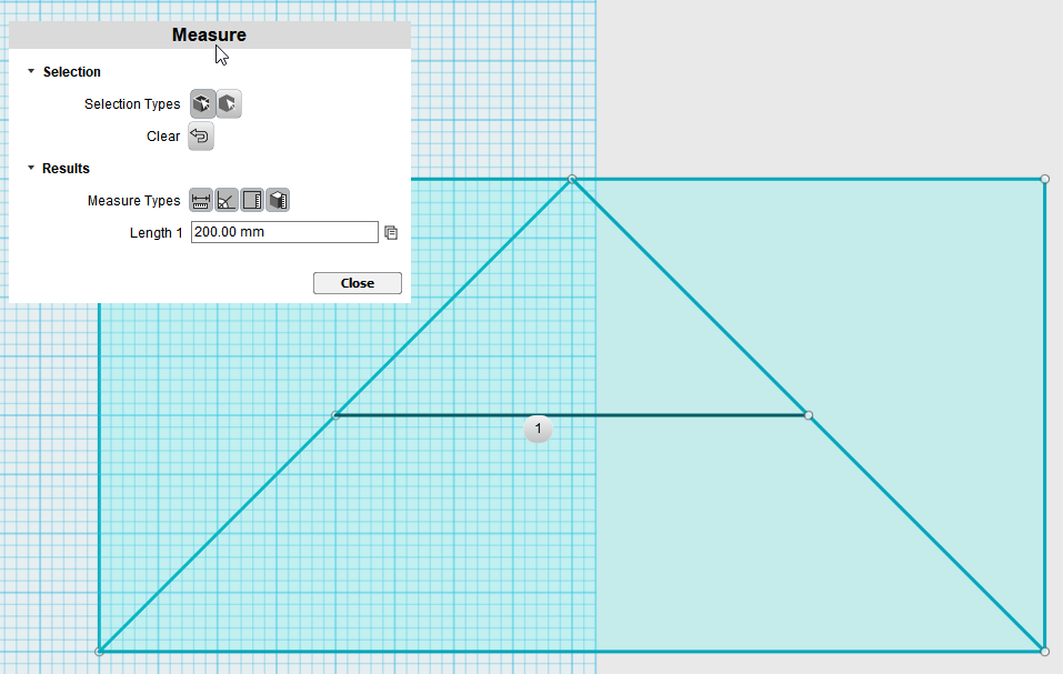

In a nutshell, I'm talking purely about geometry here:
As the wall angle gets wider, the mids have to get closer to the throat, or the xover point must get lower.
In particular, this is because the Unity design stipulates that the midrange taps need to be within about 1/3 wavelength across their bandwidth.
If you use a wide wall angle, like 90 or 120 degrees, it won't be possible to satisfy that requirement unless you do one of two things:
1) You use smaller midranges.
or
2) You use a diffraction slot.
I am not Tom Danley, but I would speculate the reason that the horns with a wide angle, like the SH-96, use a 4" midrange instead of a 5" midrange is because of this. (The SH-96 uses six 4" midranges while the SH-50 uses four 5" midranges.)
Conversely, if you're willing to use a diffraction slot, you can go with mids that are fairly large. The VTC boxes use 8" and 10" midranges. (I would argue that the Paraline is a diffraction slot.)
Due to the pathlength differences, if you go with a diffraction slot, you might need to use DSP to get the wavefronts to line up, and the VTC boxes do that.
I attached a crude picture which describes what I'm talking about. With a wall angle of 90 degrees and midrange taps that are about 9cm from the throat, the midrange taps will be 20cm apart. If you want the midranges within 1/3WL, that will set your upper frequency limit to 567Hz. Narrowing the wall angle will allow you to raise the xover frequency.
Having said all of this, a lot of my DIY unity horns bend these rules quite a bit, because I'm willing to throw away some efficiency. Once the center-to-center distance is about 1/2 wavelength, the speaker is starting to behave more like an MTM than a Unity horn.
I must still not be understanding you. Because nothing i've read, or measured on my various synergy builds, would support either of those two conclusions.
Yep, although i'd change 1/3 wavelength at all frequencies, to 1/4 wavelength. I think nearly everybody tries to stay under a 1/4 WL.

Why is it more difficult to fit mids on wider wall angles? If anything, the geometry seems a little easier with wider. Or at least it seems easier on the two different horns I'm working with right now, 90 degrees and 60 degrees.
(I could have fit four 5" on either, no prob.)

I included an illustration with my response:
973109d1628452632-nightmare-labor-day-2021-08-08-12_56_46-aug-8-waveguide_-png
With a wall angle of ninety degrees, and the midranges 9cm from the throat, as measured down the centerline, the midrange taps will be 20cm apart. If you wanted to keep the taps within 1/3wavelength, then your maximum frequency for the midranges would be 567Hz.
It's that simple.
If you intended to use a xover point of about 1350Hz, you'd have to use smaller midranges, make the wall angle narrower, or both.
Or you could just leave it as is; but keep in mind that with the midranges this far apart, it's no longer behaving the way a Unity horn is supposed to behave, because the midranges are too far apart. Not saying it won't work, but it WILL cost you efficiency. The polars will suffer too.

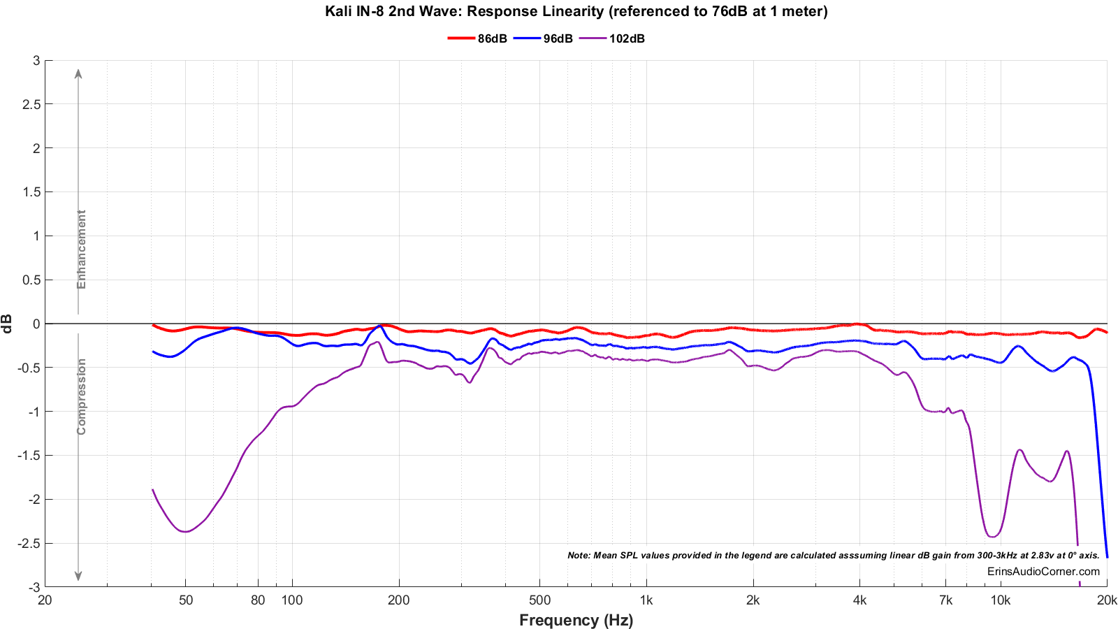

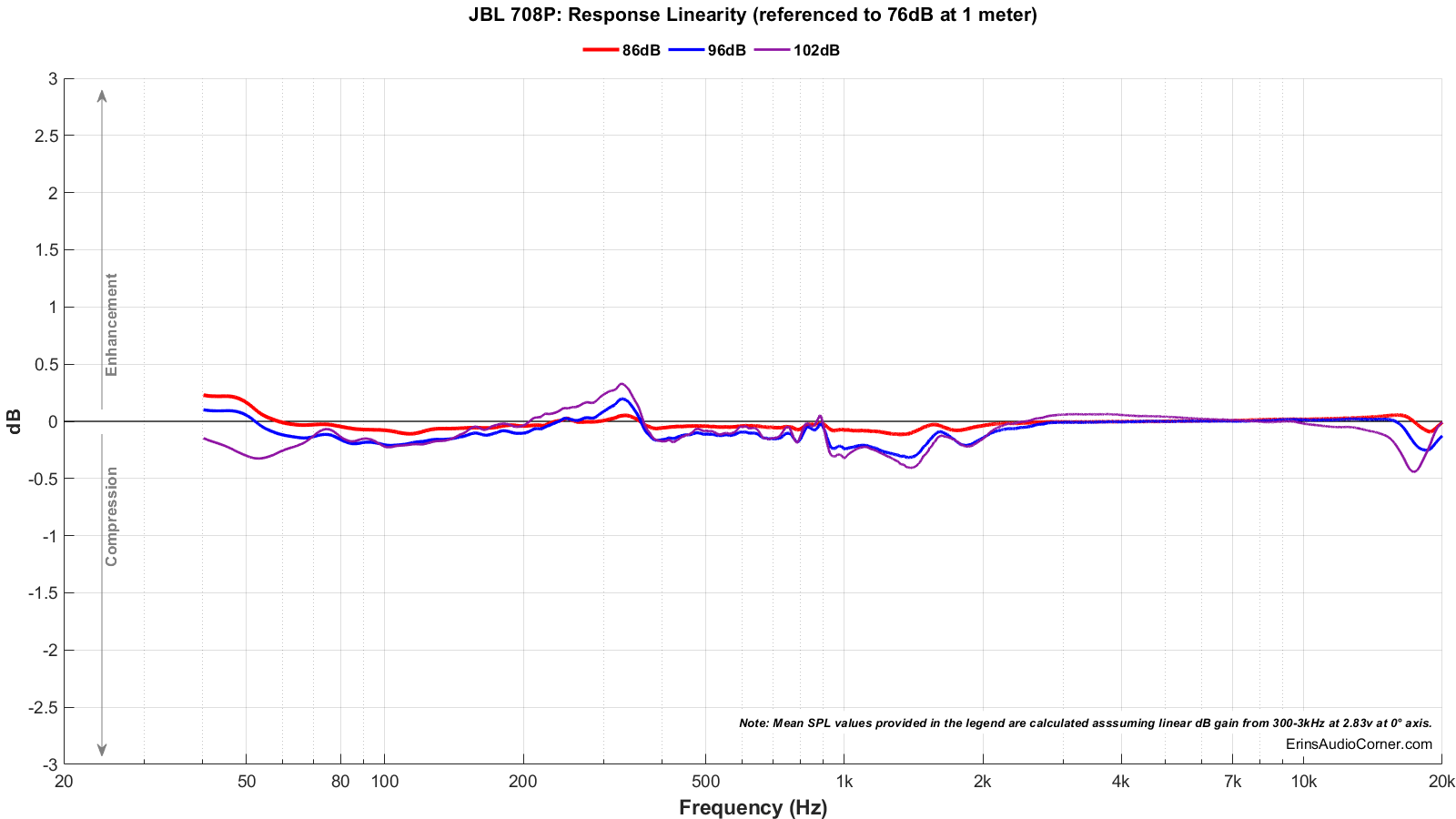

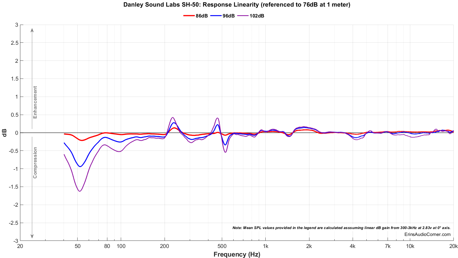

First off, here's "instantaneous compression test" for the Kali IN-8, JBL 708p, JBL M2 and Danley SH-50, in that order.
