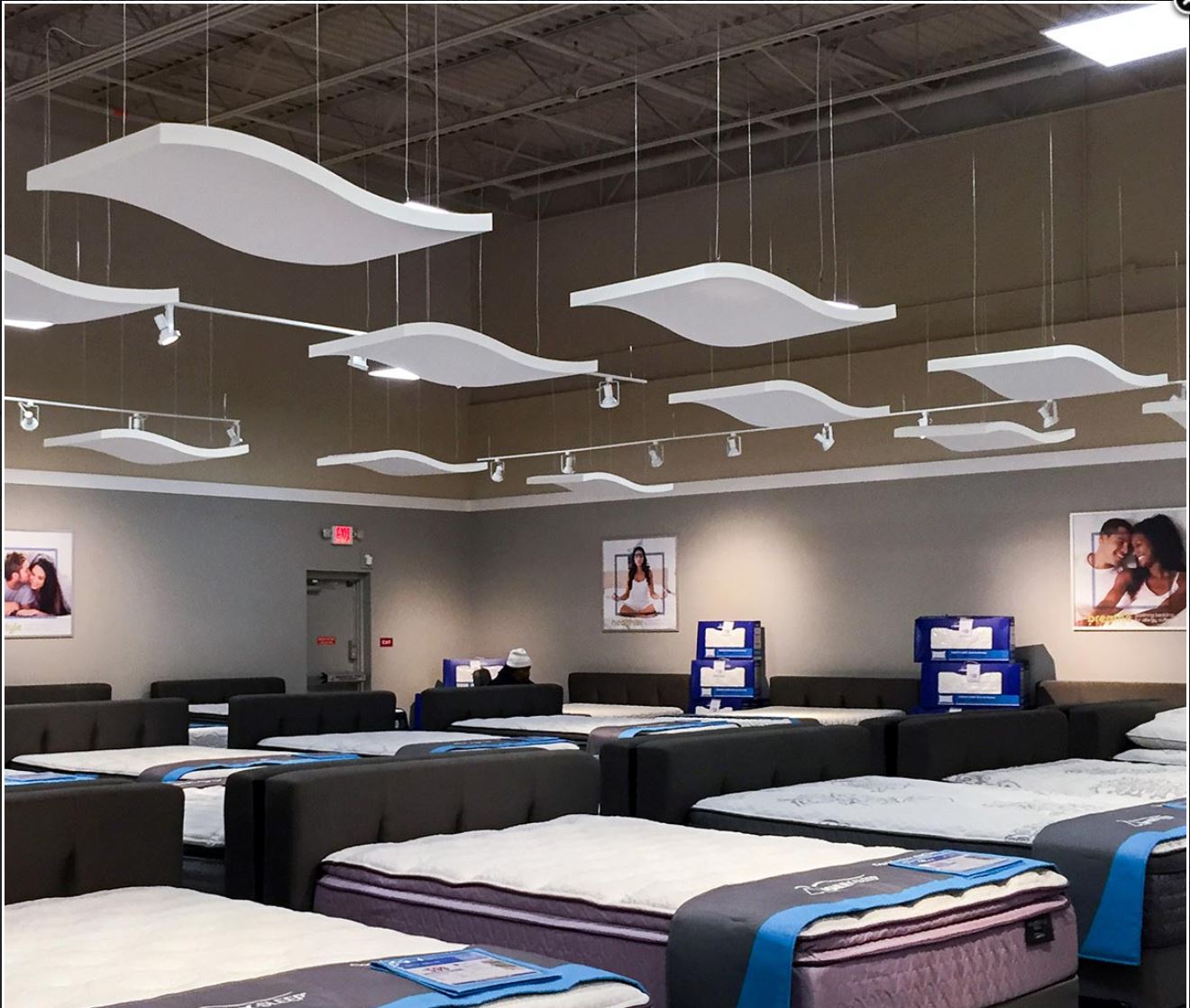

Maybe hanging a bunch of WhisperWave panels from the ceiling will dampen some of the slap echo. They come in many colors. It worked in one of my offices.
If it were my house, I think my ideal solution would be something similar, but more continuous: a wall to wall grid, or layer of perforated panels.
Basically, build a second ceiling slightly under the existing ceiling.
e.g. "Stratopanel has a recycled gypsum core sandwiched between two layers of heavy duty recycled paper."
e.g. "Ecoustic® Blade is a highly-functional acoustic system designed for use as ceiling and wall claddings."
