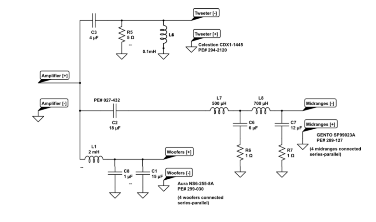

I was nervous about making the speaker a three way, because I don't think my Waslo Cosynes are as "dynamic" as my Yamaha DXR12s. The Cosynes use an array of four 2" midranges. The Yamaha uses a 12" prosound woofer.
I feared that if I made a new speaker that ALSO uses four 2" midranges, it won't be as "dynamic" as the Yamaha.
But I think there's some improvements I could make, compared to the midrange section in the Cosynes:
First, the midranges in the Cosyne cost one dollar. They DO work, but they're hardly exotic.
Second, I noticed in the xover that the highpass filter is a simple 1st order filter. So I can likely increase the power handling and reduce excursion, compared to that.
Third, the midrange enclosure for the midranges in the Cosyne is a paper tube. IIRC, it's sealed with a glue gun. That's not a very rigid enclosure by any means, and I may be seeing losses there. It's possible the glue is failed, which would cause the midrange alignment to be "off."

Come to think of it, it's very likely that the Cosynes are lower in distortion. For instance, one of my *gripes* with the Cosynes is that I'm constantly riding the volume level on my remote control. If the speaker was at it's limits, it wouldn't be blasting me out of my seat.
Actually, WAIT, I take that back lol:
It just hit me that the last paragraph may be wrong:
When I set up the Cosynes, I measured the entire system, including the subs. It measured pretty flat.
Everyone in the entire house was immediately annoyed by the amount of bass. I made some tweaks to improve the integration. The response was even flatter than before. I didn't reduce the LEVEL of the subwoofers, I adjusted the phase of one sub to minimize a room peak.
That improved things a lot.
But then I found that everytime I watched a movie, there were scenes where I was just getting blasted out of my chair. The quiet scenes with dialog were very hard to hear and the action scenes were shaking the house.
First I reduced the level of all the subs by 6dB, then a few days later, *another* 6dB.
And keep in mind, I'd measured the room in the first place. So it's not like I was "guessing" on this.
So at this point, the subs are significantly attenuated, compared to the Unity horns.
I'll bet what may be happening is power compression on the midranges.
Each Unity horn has four 2" midranges. They're a dollar each.
My subwoofer arrays has dual fifteen and a single twelve, two amps totaling about 1,200 watts.
Power compression would be particularly likely, considering that my room is REALLY big, the volume has to be at least 300% larger than my old house.
And this wasn't an issue at all at the old house. At the old house I "only" had 300 watts on the subs.
So what I may be experiencing is that my new subs have a lot more headroom, due to the quadrupling of power, and now it's exposing limitations in that array of four 2" midranges.
If I could get another 6-10dB in headroom on the midranges I think I could live with that, and that should be do-able.
All of this is a bit academic and not something that would be a problem if it wasn't for this huge room. The acoustics in this house are astonishingly terrible. A wall of glass and 20' tall ceilings:

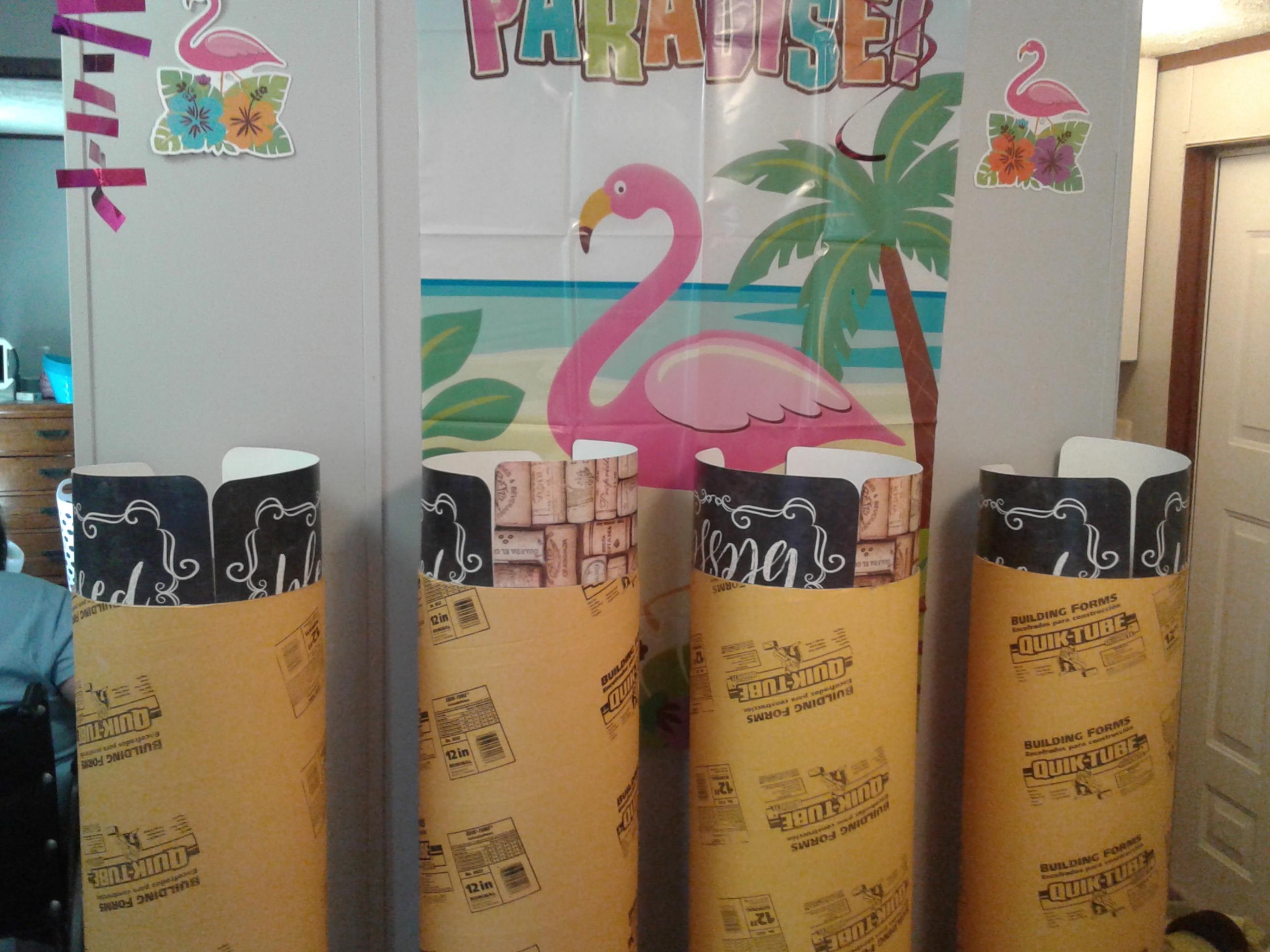

Ugly, but these work.
I will have them to the ceiling
Placemats will be the inner liner to put another tube on top.
Ps, all the tubes are a different size.
I will cut a strip out of the back of the upper tube so it will fit regardless of larger or smaller.

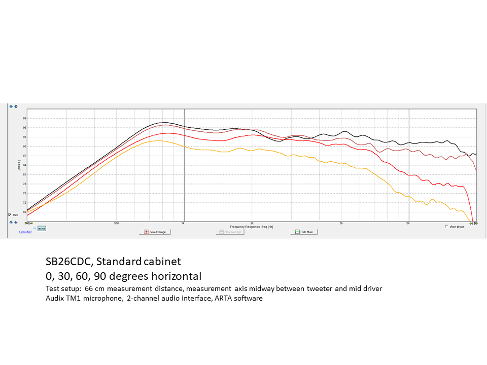

Apologies if post #73 and post #74 were meandering all over the place.
Over the last two weeks, I've designed about five different waveguides for this project, and kept running into issues. In particular, in order to fit the midbasses on the waveguide, the beamwidth became too narrow.
This waveguide, for instance, was simulated with ATH and ABEC and I 3D printed it and measured it. And it performs "ok" but I'm really trying to get the speaker to a point where I have narrow vertical beamwidth and wide horizontal beamwidth.
The obvious solution, of course, is a wide speaker like this:
My current speakers (Waslo Cosynes) have a waveguide that's fairly similar. And they're great I like them a lot... but I want to have my cake and eat it too. I want super-wide horizontal beamwidth, with lots of "spaciousness." But I ALSO want narrow vertical beamwidth, so I can listen to my music and movies without waking everyone upstairs.

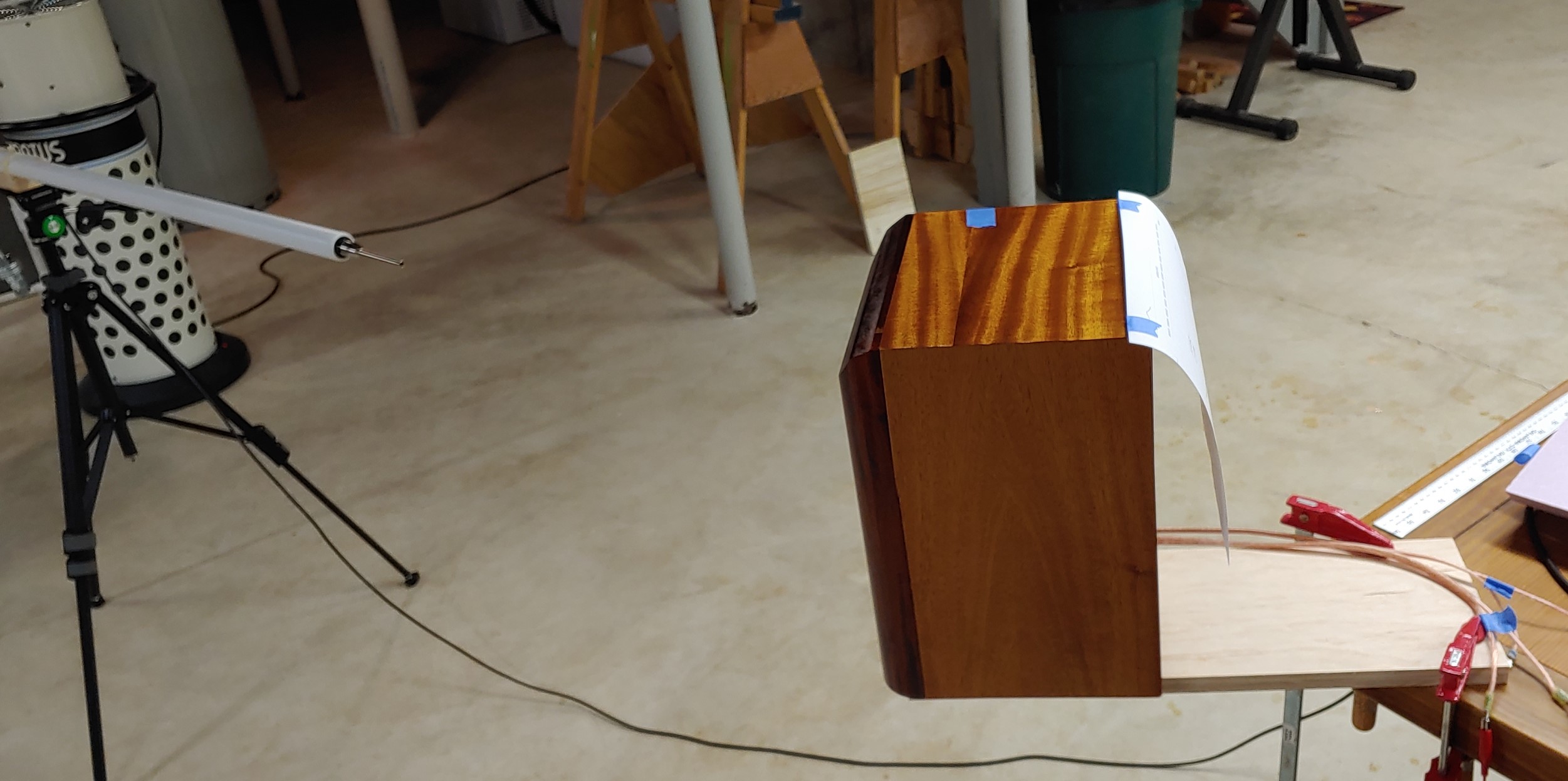

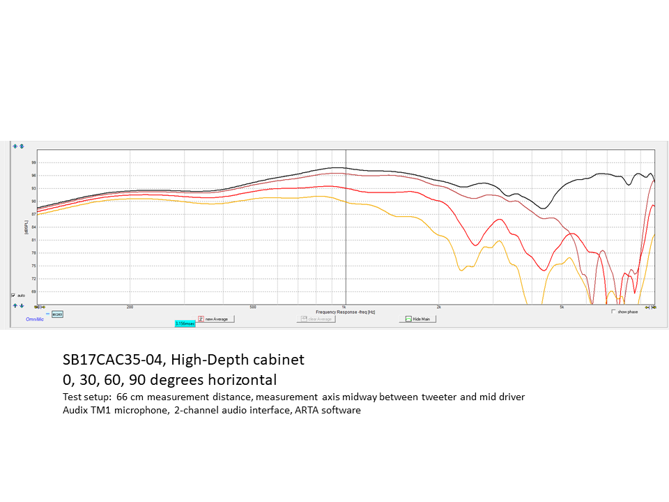

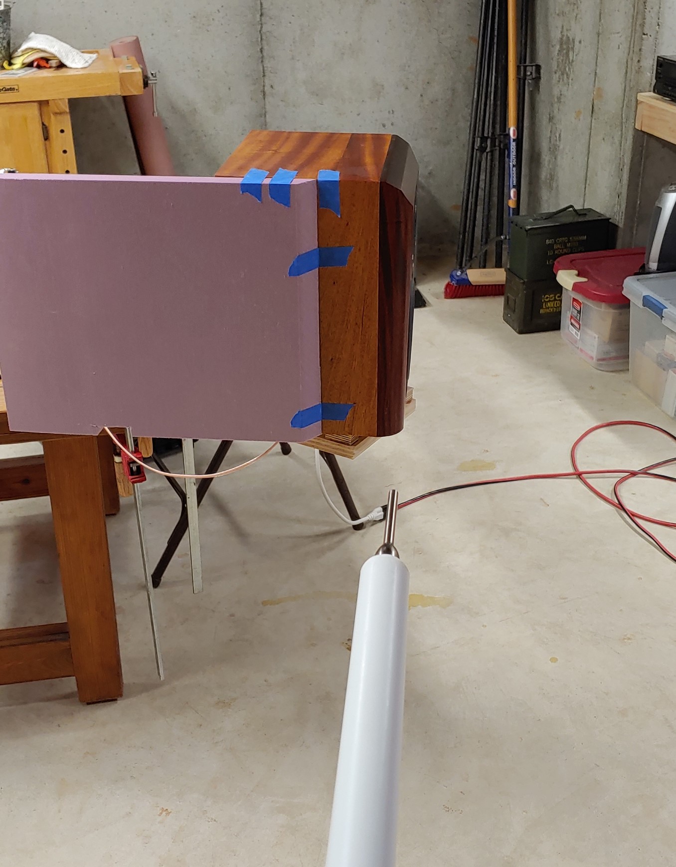

One way to pull off this trick, which might not be obvious, is to curve the baffle of the waveguide.
JBL does this in the M2 and the 4367, and Grimani takes it to the extreme in the Alpha; the waveguide is basically radiating from a cylinder. S.A.W. was even so generous to post Spinorama data showing what happens when you stick the same waveguide in a baffle with a flat face. (Spoiler alert:
the curved baffle works better.)
Possibly the most interesting speaker, and set of measurements, is this diminutive experiment:
This speaker is TEN CENTIMETERS WIDE. Normally, we would expect to see an abrupt change in directivity at about 3400hz (because 3400Hz is 10cm long.) What I think is happening here, is that the shape of the enclosure is helping to mitigate that step.
Again, I know I've posted about a million threads on this concept, but I'm kinda obsessed because I want to "unpack" why speakers like the Revel Salon exhibit directivity control down to 500Hz, despite the fact that their waveguides are less than 15cm in diameter. I think it's the baffle shape and enclosure dimensions.

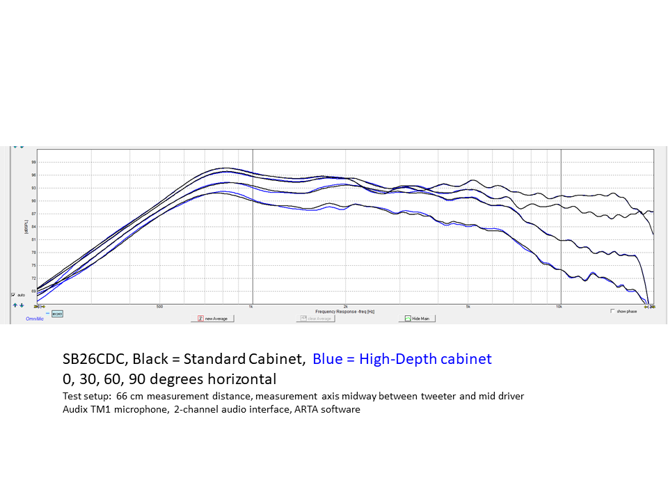

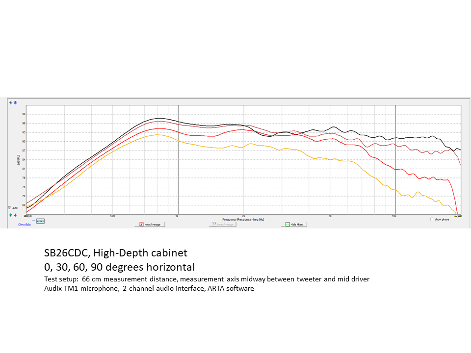

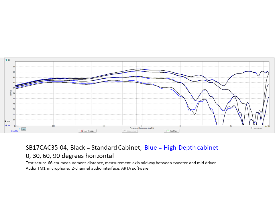

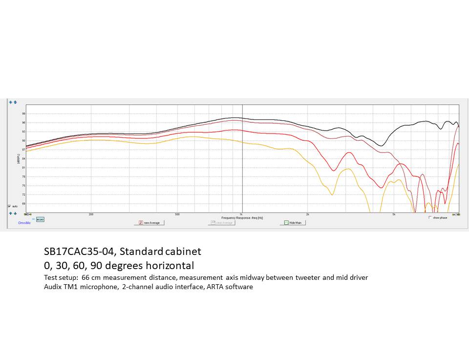

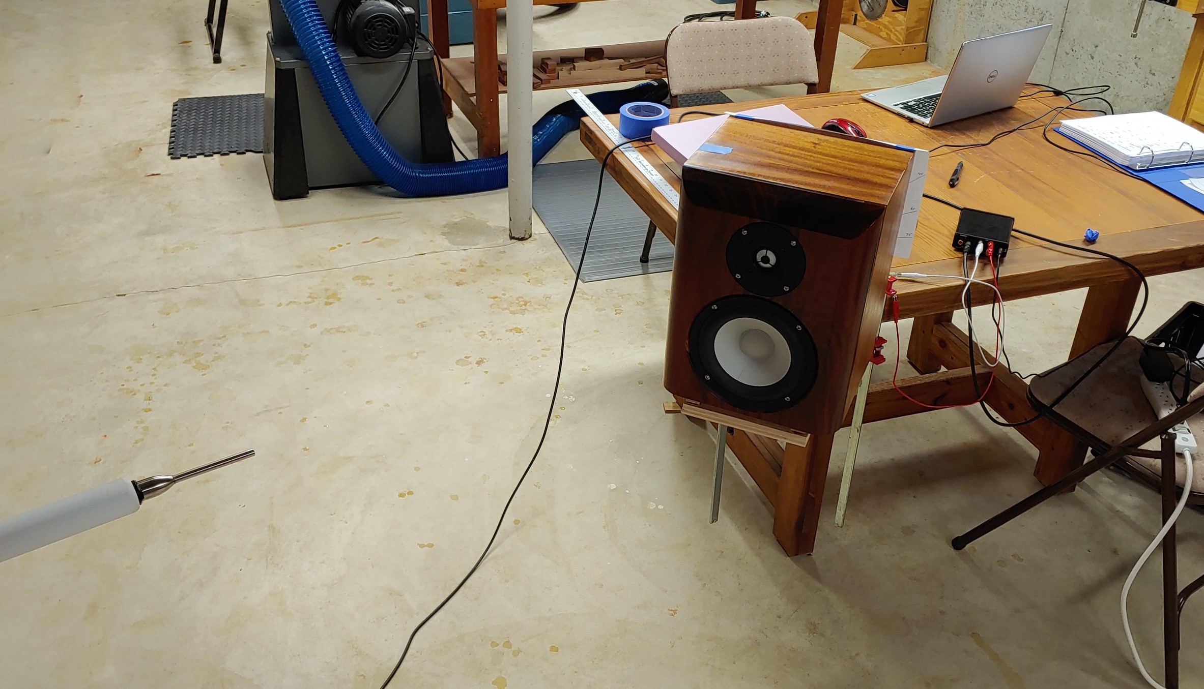

The next photo shows a modification where I increased the depth of one side to 20 inch. I used XPS foam board cut at a 45 degree bevel, about 4.5 inch from the front baffle.
I made measurements of both the mid driver and the tweeter at 0, 30, 60, 90 degrees, for both the standard cabinet and the high-depth cabinet. Switching between the mod and non-mod cabinet was tedious, but I did not want to change microphone positions at each angle, so I applied and removed the mod for each angle. That is why the angular increment is 30 degrees – I am lazy…
Although I used ARTA to make these measurements, I still like using OmniMic software to display FR curves.
I was expecting to see differences between the standard cabinet and the high depth cabinet starting at 30 degrees, and becoming more pronounced at 60 and 90. But what I found was barely any difference at all. Plots #3 and #6 in particular are illustrative. You can see the standard cabinet 0, 30, 60, 90 curves in black and the high depth cabinet 0, 30, 60, 90 curves in blue. At 0 and 30 degrees the blue and black lie on top of each other. At 60 degrees there is a very slight difference, and at 90 degrees there is perhaps a 1 dB difference in the mid woofer response and about 0.5 dB difference in the tweeter response.
My results do not verify your various measurements over the past year (in several threads). I am trying to come up with a rationale as to why this would be. One possible cause is that my mod did not simulate the entire cabinet being 20 inches deep, just the near side wall. I would not expect this to be an issue, but perhaps it is? Another idea is that this head unit is dimensionally similar to a small bookshelf monitor, and you have been discussing much taller speakers. Perhaps if I started with a 9 inch deep tower speaker and modified it to be a 20 inch deep tower, I would have seen more effect.
I would very interested in your thoughts.
