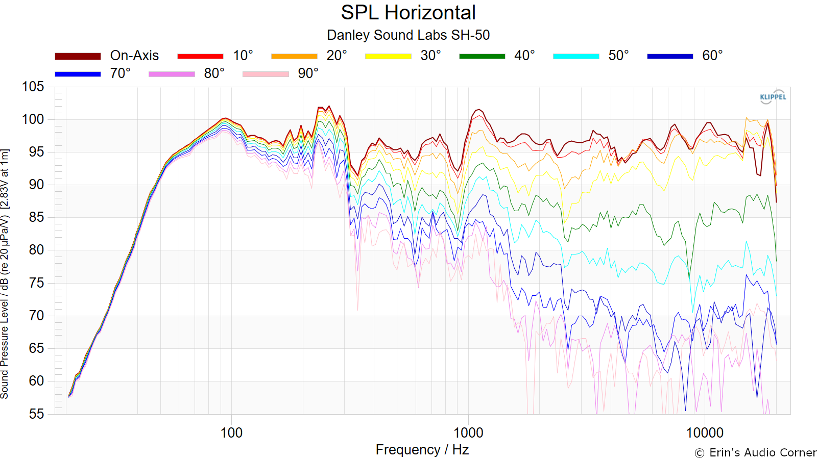

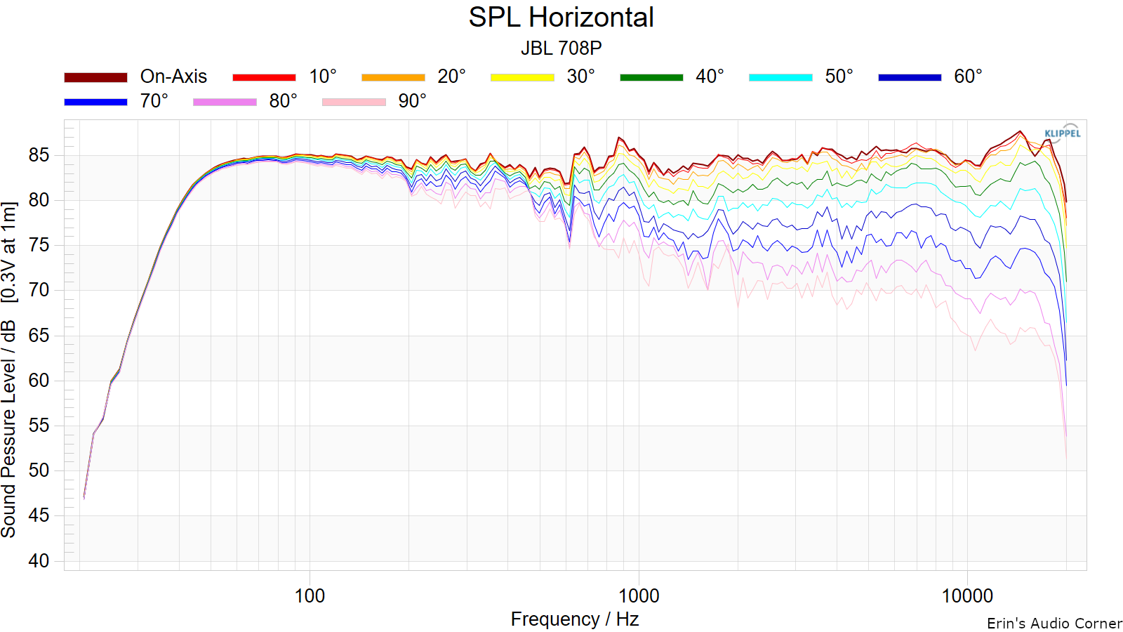

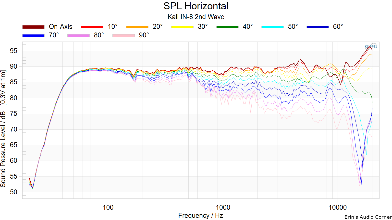

Second, here's the "horizontal polar response" for the Kali IN-8, JBL 708p, JBL M2 and Danley SH-50, in that order.
Data courtesy of Erin's Audio Corner.

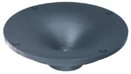

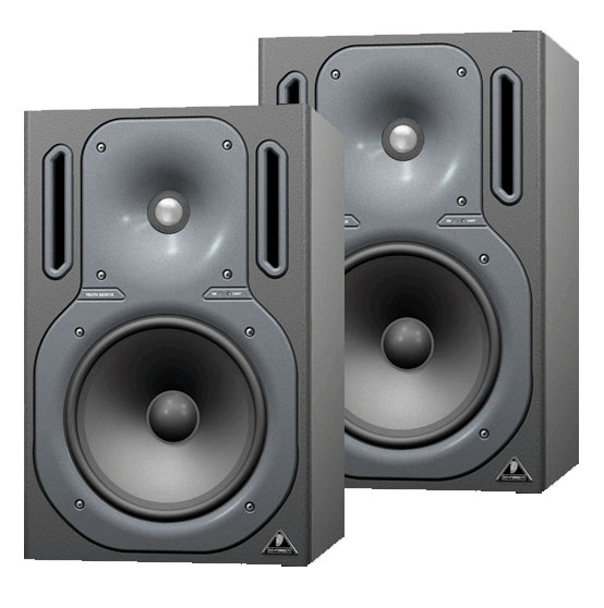

That horn kali looks good, but i like a hf horn to be more like the Berenger truth b2031's horn better (first pic), very "soap dish" as you say, working towards no reflections.
or the lowly pyle round mcm horn (2nd pic) from long ago (take 1 3/8" screw on).
I just can't wrap my mind around the jbl's throat peak to spread reflections.
Why not have no reflections ?

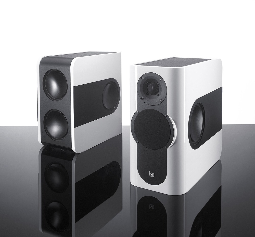

I am starting to wonder if we'd get better results putting the woofers on the side or on the back of the enclosure. Similar to the Kii Audio Three.
The Grimm Audio speaker is definitely in the ballpark of things I've been looking at. In particular that one could separate the woofer from the midrange and put some "space" around the midrange enclosure, in particular so that diffraction off the midrange enclosure reduces the beamwidth.

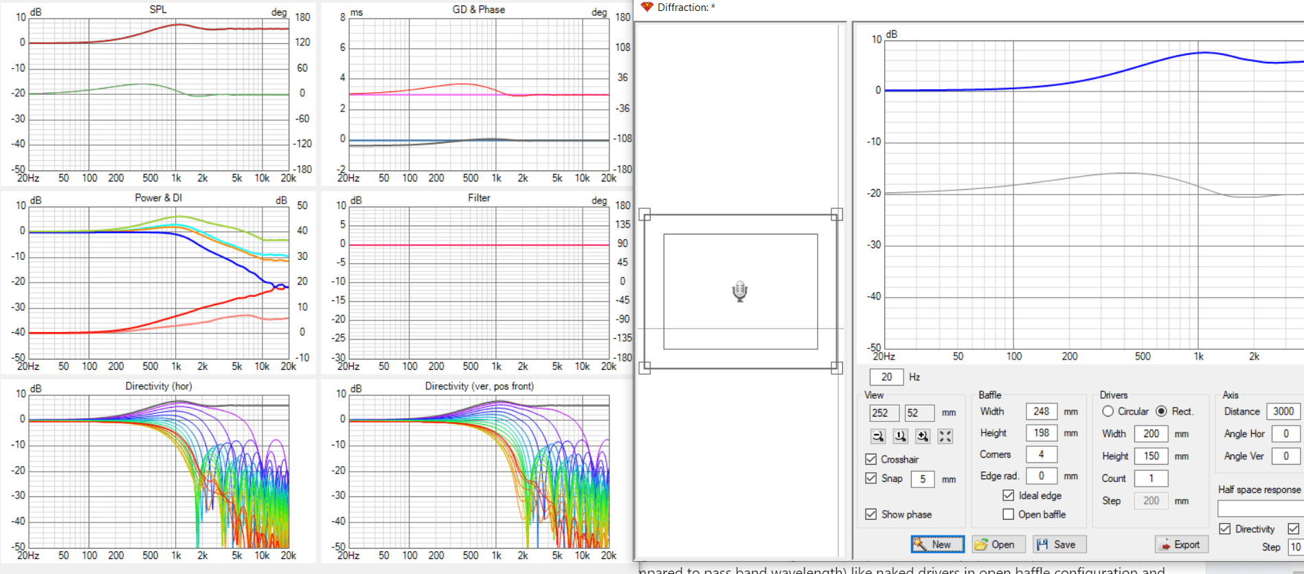

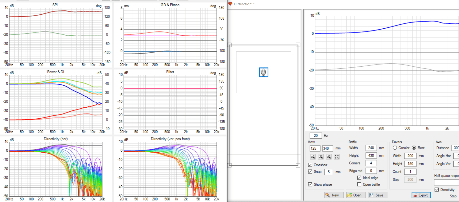

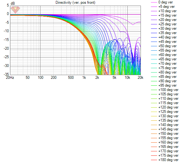

To me looks like "main diffraction hump", at least partly. See vertical polars on the attachment which is just an ideal flat source on ideal baffle instead of waveguide on a 3D box.
This diffraction related issue can be completely solved only by having sufficiently large roundovers to make the whole thing approximate a sphere. Any radiator on a baffle, that doesn't have sufficiently large roundover for the wavelength will show this and there is at least one on any physical size loudspeaker object and especially on the vertical axis which has multiple drivers on it making the baffle/object bigger than the transducer supporting longer wavelength and would require bigger roundover. However there are some tricks that help on it if it is a concern, like having smallest structure in comparison to wavelength. In this regard yeah, big waveguide only on the face, then woofers on somewhere else than making extra baffle for the waveguide would reduce the issue but not make it completely away unless the construct was a sphere.
Some thoughts: It is a "tough" issue and really hard to get away if not impossible as we have to have physical size on the loudspeaker. We could make the speaker as big as room to move the problem to room size wavelength, or smaller than highest frequency of interest but that wouldn't leave mucho bass. One would make this completely disappear with midrange wavelength (tens of centimeters) with speaker that is a sphere (enough). Problem is that on multiway speaker we often have two drivers playing same (midrange) baffle sized wavelength and the problem usually spans for pass band of both drivers. We could always use minimal physical size transducer (compared to pass band wavelength) like naked drivers in open baffle configuration and then crossover to smaller one below the diffraction, longer than driver diameter wavelength. This is 3 / 4-way system and eventually at tweeter we'd have to confront the diffraction as we must play past the shorter than transducer size wavelength. Luckily wavelength is short and small roundovers would do. If the open baffle transducers are nulls (90deg to side) of the others there is minimal amount of diffraction, less is just not possible except perhaps with electrostats that don't have driver magnet and structure causing some.
Very good freestanding (or perhaps enclosed) wave guide seem to be able to make diffraction almost disappear (see ATH thread, plenty of examples) but if there is woofer on same baffle the roundovers just have to be big on the vertical dimension, top and bottom lip, bigger than on the sides. We might be able to make system without much diffraction with freestanding waveguide on top of small woofer box, but there are no sims yet, or measurements so it is just a hypothesis currently. Fluid posted some few years back I think, which showed good freestanding waveguide had surprisingly low interaction with a box even if at quite close proximity. Still, the waveguide is probably used only to about wavelengths its mouth diameter and the woofer has to play up to that as well, making both objects size of the wavelength and both interact with each other pass band at the crossover wavelength.
See, tough 🙂 It is all about wavelength and how it interacts with physical objects, and we currently have to have some physical objects to make the sound. OB speaker can be made so that there is (practically) no issues in this regard as explained earlier. Or fullranger on a sphere, or multi-way on relatively big sphere, or just relatively close to sphere, and all with their different set of compromises.

edit. the same sim but with minimal baffle, vertical narrowing of the first example is gone.

I think the reason that this is happening is because the baffle is TOO HIGH. In the sim shown, the baffle height is seventeen inches. 794Hz is seventeen inches long. So what's happening is that the tall baffle is broadening the radiation in the midrange.
Here lies the nugget for good problem free sound I think, realization that most if not all problems we encounter with loudspeaker builds pretty much all pile up in the midrange, practically sized speaker enclosure dimension wavelengths. All woofers from 15" to 3" are midrange sized, their cone resonances, beaming, all happen at midrange. Enclosures have issues like standing waves, panel resonances, bass reflex pipe resonances, diffraction, all midrange. Then we have at least one crossover somewhere on the midrange on multiway speaker land. Try to cram them all transducers to a physical structure that would have nice pattern to all directions, all with decent SPL and bandwidth requirements for the whole system, everything affects each other being on the proximity. Count in influence of the room, which controls the lows and highs we can quite easily control with a waveguide but the mids between require large objects to impose control over. Worry about visual appeal, size and cost constrains etc. Fun soup 😀

Regarding the diffraction hump, I agree with Timu that its inescapable but reducible with roundovers. In my sims, I've found for systems with waveguides, the range coming out of the waveguide is practically immune to the effect. Its the midwoofer you need to take care of. Since I am going active cardioid, the issue is how much of that diffraction hump remains after DSP equalization. Vituix tells me, then I choose roundover to keep it to my target limit. In my latest simulation with 18 mm roundovers, I'm seeing less than 1 db, which shows as a rise of response off axis as the crossover to the CD/waveguide is approached. Given all the other things that will appear when my simulation is given a reality check with a prototype, that seems the point of diminishing returns. Thus I don't think this is much of a problem, at least not with DSP.
I have yet to explore the effect of cabinet depth on the response via ATH/ABEC. but that is on my list of things to do. It would be interesting to know how the depth of the cabinet affects the response off axis...
As a follow on - here is a normalized line chart exported from a copy of timuikku's sim. The high end of this is what you would see after equalization, right? Between 1khz and 3 khzHz, you see a tiny bit of response rise just off axis. This is all that remains of the diffraction hump. A crossover to the waveguide around 1200 Hz or so will remove it almost completely.
Horizontally the freestanding guide doesn't care about the woofer box. Vertically it is a different matter and will look worse, but no worse than a flat baffle, the vertically spaced drivers present the same issues.
