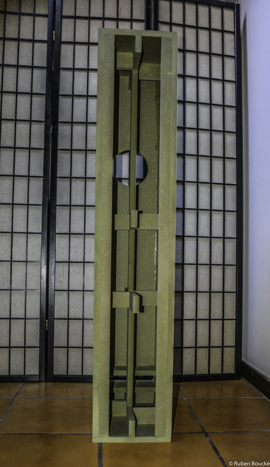

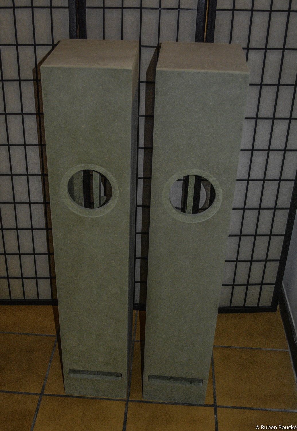

And finally i got some wood cut, (no plywood as it's not availeble in good quality due to covid), but for a test of my first own MLTL design mdf is ok. I finished sanding today and i'm going to paint the front and sides (back is still of for stuffing) in warnex as this must be a cheap build for testing...

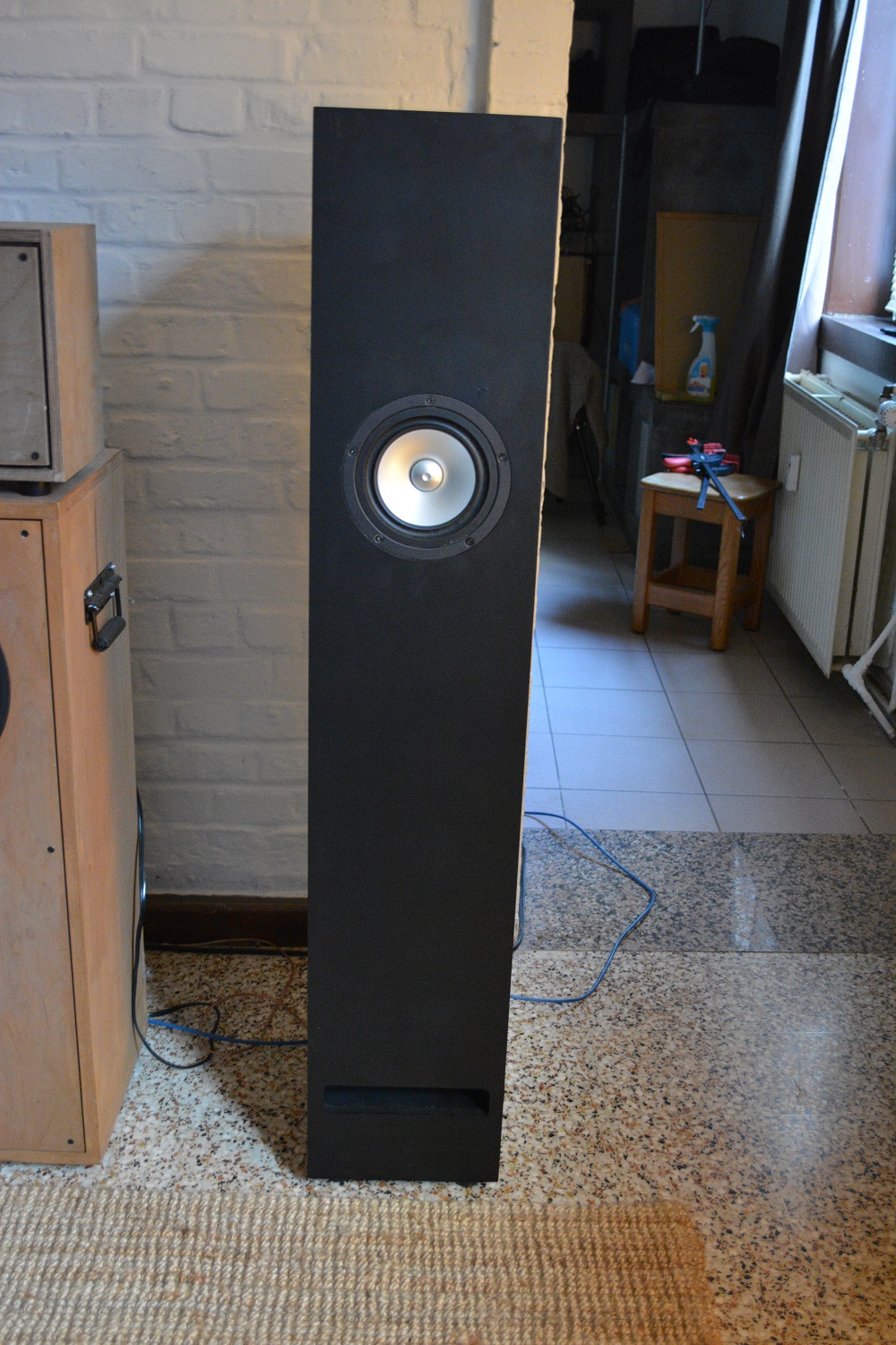

Finished one roughly (still need to paint the back fully) and played in mono for an hour and it seems that being rather anal on my calculations and overthinking all way to much paid of... They sound real good, even next to my big setup with a Alpair 10.3M and a Scanspeak woofer. They got plenty of bass and a well balanced and detailed sound, even without any filtering. Now finish the second one and do some more testing...
Later one i will probally rebuild them in plywood and finish them with regards for the looks, now it's just a mdf rough testbuild painted with Warnex i still had in stock... It's the first MLTL own design and i rather loose 60€ on wood and cnc than 250€ for quality ply for that...

6 days of burning in and I can safely say these drivers are an absolute steal for the money.
I tend to agree, they are an absolute steal. +95% of the performance of the Alpair 10.3 that costs more than double the price, but without the resonance on top that needs to be tamed, and with a solid bass in my MLTL.
